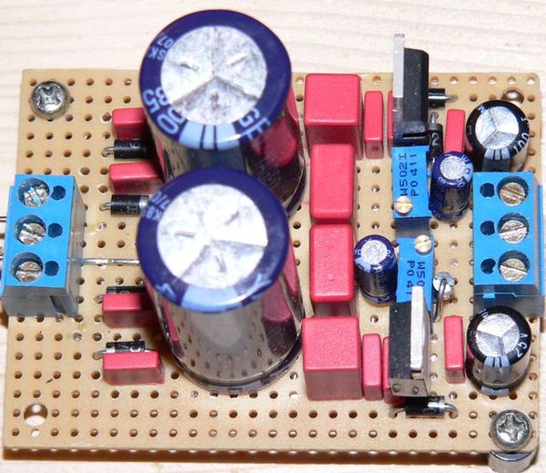

i agree, there's a nice plan of a 317/337 psu on nuuks' page: Preamp PSU @ NUUK
And this is it in nature, a little bit updated (protecting diodes, caps in parallel to the rectifiers, some small elkos around the regulator chips).
Michael
Michael
slackman said:Hi,
Now that's a well made and compact supply for a prototype board! Great job!
It seems to follow Nuuk's reg layout, which is an excellent one.
Some tips for regulated PS that have been reported as improving audio quality:
1) Put a small cap, 1 to 10uF, in parallel with large adjusting resistor (P resistors in Nuuk's circuit). It improves noise.
2) Try a small cap, like 47uF, at the output and see if it improves noise.
3) Put a small resistor in parallel with output, like 1K or so, when you are feeding very low current chips. You can eliminate this if your current demand is constant and greater than 200mA. In any case watch the regulator's temp. Some regulators seem to be less noisy when facing a minimum constant current.
Don't forget the D resistors that you can see before the rectifiers.
If you want to go an extra mile, split the F capacitor in half it's value and put something like a 2~5 Ohm 5 watt resistors in series with +/- power lines.
Do not use resistors AFTER the regulators, as that will affect output's impedance.
Carlos
