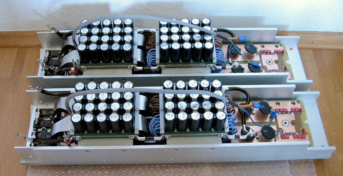

> CCCCC-R-CCCCC-R-CCCCC-R-CCCCCCCCCC
That's not enough C's for me !!
Patrick
PS
What you see is only 1/3 of the caps for one of my AXJ monoblocks.
Another 1/3 is hidden below, and yet another 1/3 is mounted close to the power modules.
All hand matched to 1% of course. We bought 1000 in total (220uF 50V Panasonic FC).
PCBs are double sided 205um thick (normal PCBs are 35um).
And this was 2004.
