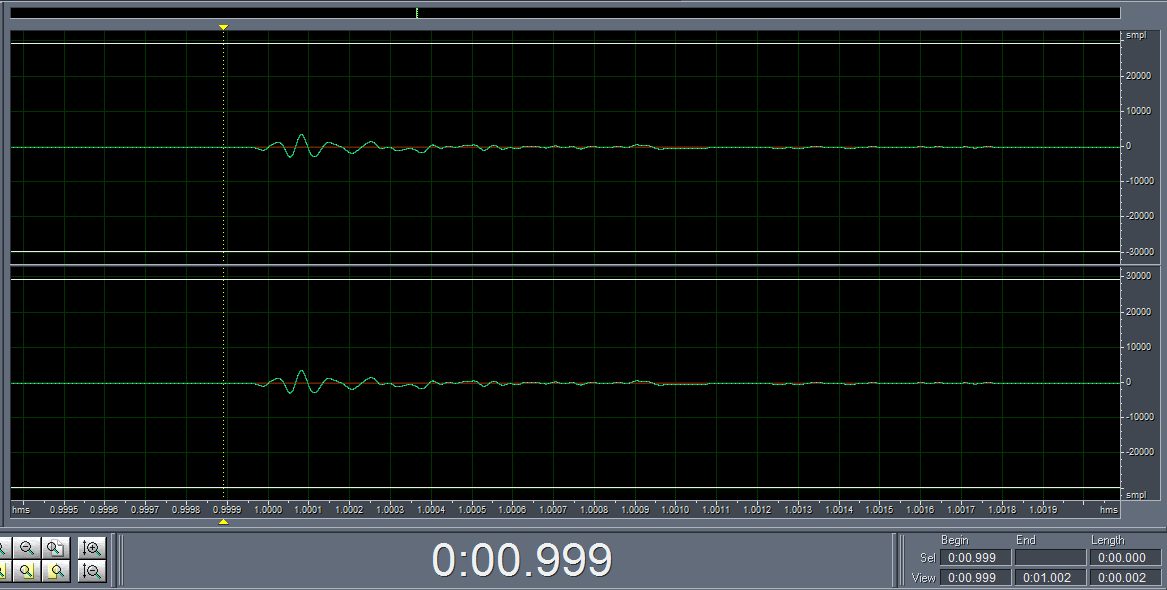

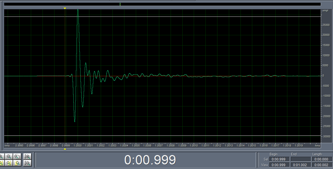

I hope this time it might be the measurement that you have suggested. 2 impulse responses, same mic and speaker position in both measurements, small acoustic change. Difference of impulse responses shown as well.
I still assume this reflects in frequency domain (and it does) as well, as frequency and time domain are necessarily dual representation of the same thing.

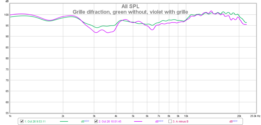

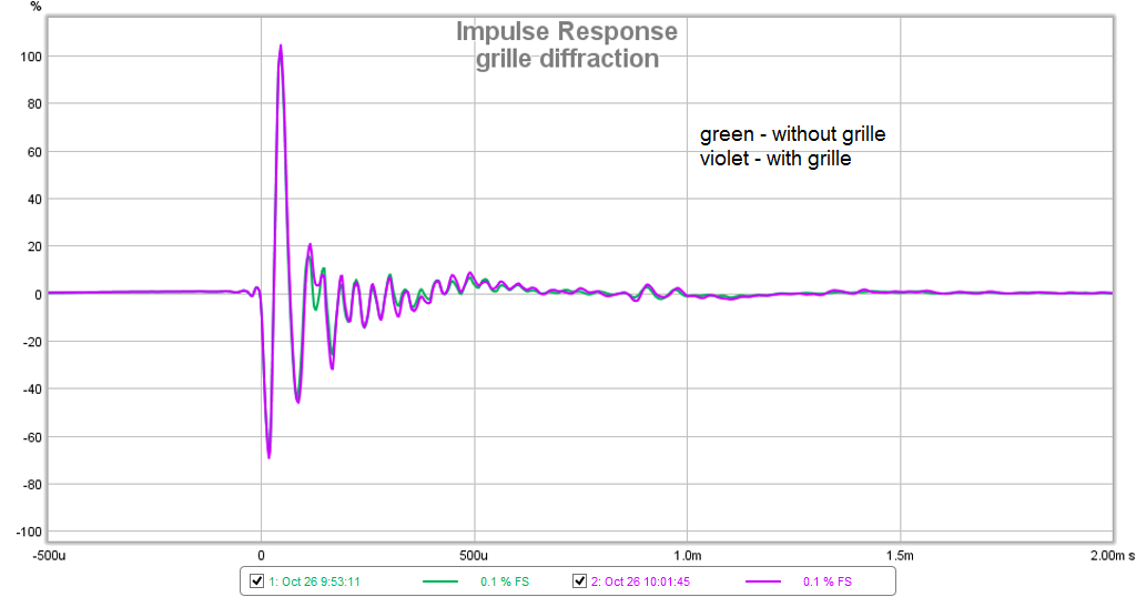

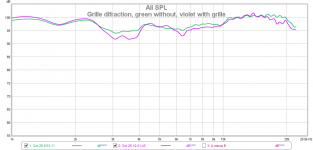

OK, this is a similar measurement in both time and frequency domain, these measurements form a pair. The difference is that the green one is without grille and the violet one is with grille. The front baffle is 20cm wide and it is measured at a distance 44cm from the front baffle, on tweeter axis. We may call it a "grille diffraction".
Yes, of course you can see the difference and this might be diffraction, but it might also be just absorption, that would depend on the grill. That's a pretty bad grill IMO. I suspect that you can hear that, although to be valid, it would have to be blind. But I think that the point is that one can see differences in the impulse, which do have a correspondence in the frequency response, except that with the impulse response you can tell at what time the problem occurs, something that is not readily apparent from the frequency response. In this example the time is not large, but sometimes it can be. The greater the time lag of these kinds of problems the more audible they become AND the more audible they become at higher SPLs. That's why I look in the time domain as well as the frequency domain.
