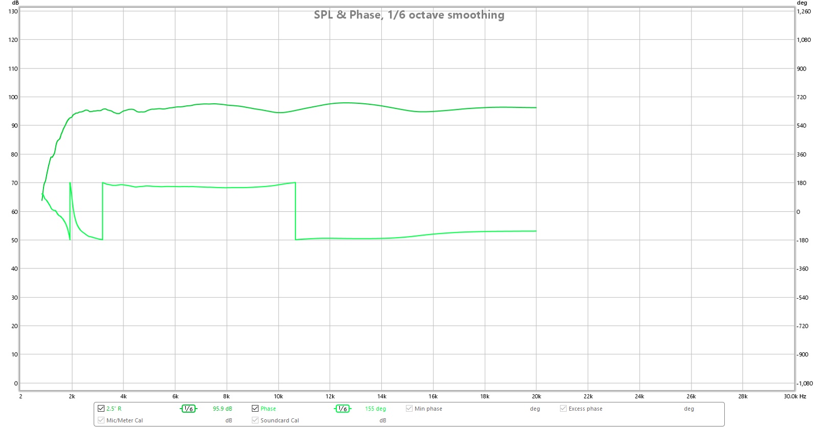

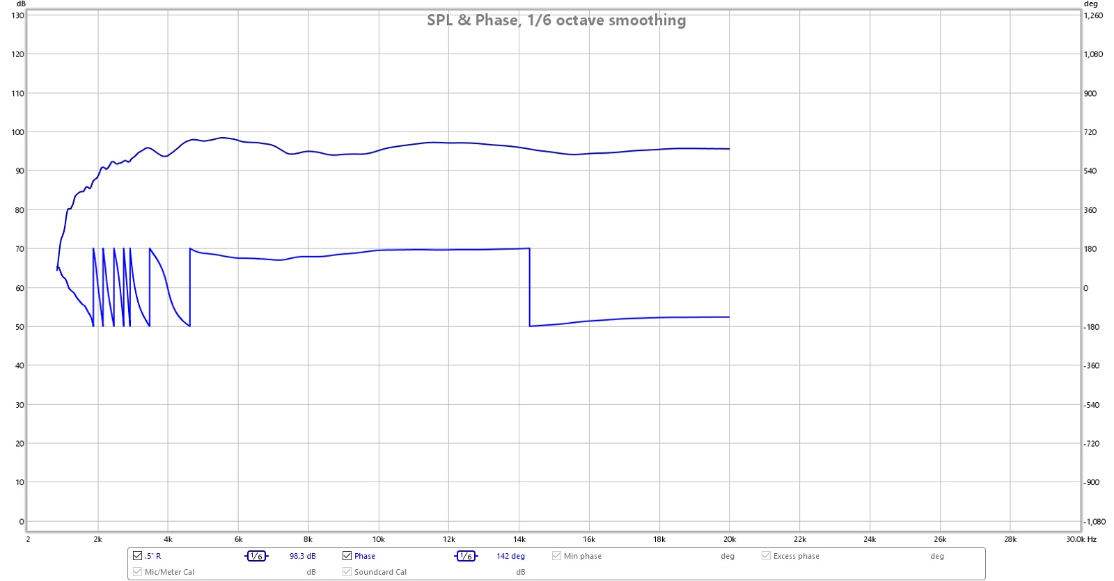

This was done with a SS d2604 soft dome at 36" from an active 4th order xo. I am quite surprised at how much worse it is in the 2k-3k range. To be fair the blue one is partially surface mounted in a 2 way box (round tweeter set in an old accuton square cut out) has 1/2" round edges on the sides and the box is setting on another speaker box that is sticking out 1.75". ugly. And the green is mounted to a squat baffle (6" tall) w/ chamfered top and bottom 30 deg. and curved sides with a 2.5" radius and no box sticking out below. Not the point really to go into the boxes but FYI... critical range for the tweeter...
