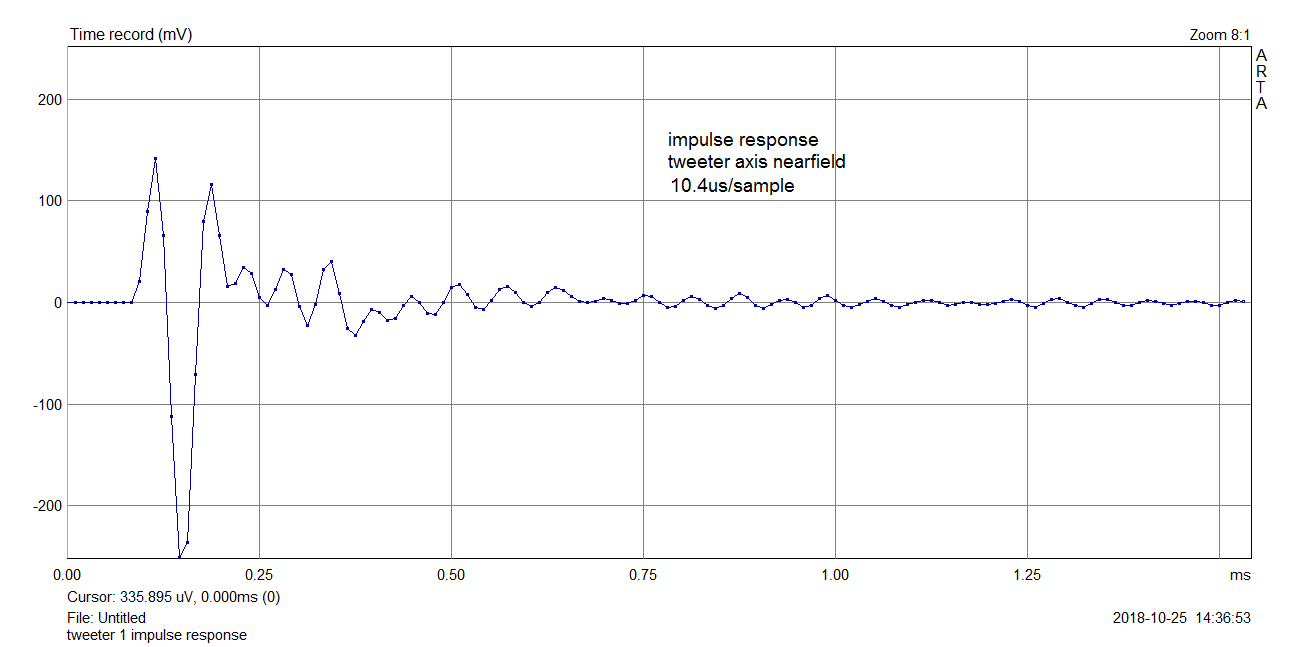

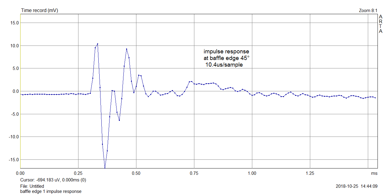

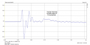

But looking at just a single impulse response does not allow us to find what is diffraction and what is just ringing.
One more try, 2 measurements of a "true 1 impulse response" in a time domain (not derived from MLSSA or sweep). First is nearfield on tweeter axis (like 1cm from membrane), second is close to baffle edge at 45° angle. As mentioned before, 16.8kHz ringing is inherent to this tweeter type.
Hi Pavel
I think that you misunderstood the two impulse comparison. You would have to leave the microphone in a single location and modify the source to do the comparison. Moving the mic simply changes everything and once again there is no easy way to sort it out.

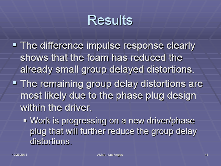

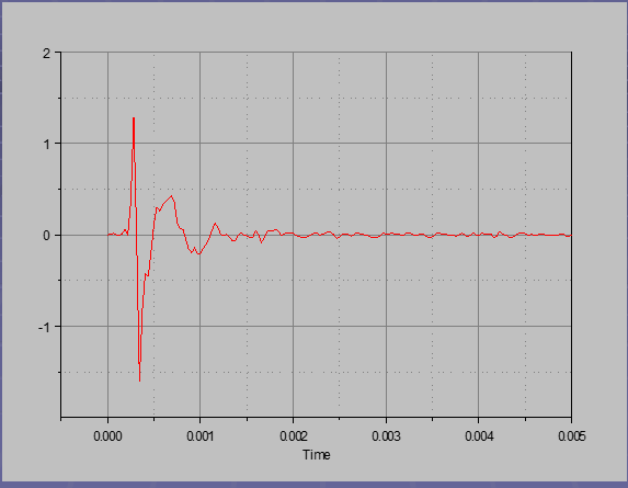

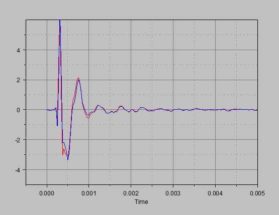

Attached are three pages from a PowerPoint that I did ten years ago. It shows a comparison of a waveguide impulse response with and without a foam plug (red without foam.) The next plot is the difference curve. Since the foam has some small delay to it the two impulses do not line up exactly, which results in the large double pulse. The interesting part is the difference in the impulse in the .5 - 2.0 ms range where the foam substantially reduces this area. This is internal diffraction in the device.
(It took me > 1 hour to find this old doc. Maybe I'll post the whole thing on my website now that I know where it is. I have saved everything that I have ever done over some 30 years. It's just a lot of stuff and finding one particular paper can be tough.)
