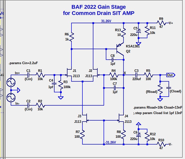

Has there been anything posted about the new differential input front ends for the common drain SIT Amps? In the video at about the 39min, 45sec point, Nelson showed a piece of paper containing a schematic and a PCB.

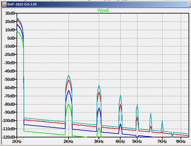

I did a screen grab of the schematic from the video and generated an LTSpice simulation.
It looks very good. I loaded the output with an 13nF capacitor which is about right for the gate of the common drain 2SK18ES.
I'll bet you twenty dollars that Nelson's version does NOT include any PNP transistors in the TO-126 / TO-225 package. No KSA1381s, no BD140s, no 2SB882s, no KSA1220As.
You might be right, but with the higher rail voltages, the power dissipation of the BJT will be more the 200mW which is more than I like with TO-18 parts. The KSA is a $0.56 part. The KSA also has excellent gain and bandwidth.I'll bet you twenty dollars that Nelson's version does NOT include any PNP transistors in the TO-126 / TO-225 package. No KSA1381s, no BD140s, no 2SB882s, no KSA1220As.
In the schematic of post #108, don't Q2 and J4 dissipate the same amount of power? If a TO-92 is okay for J4, isn't a TO-92 also okay for Q2?

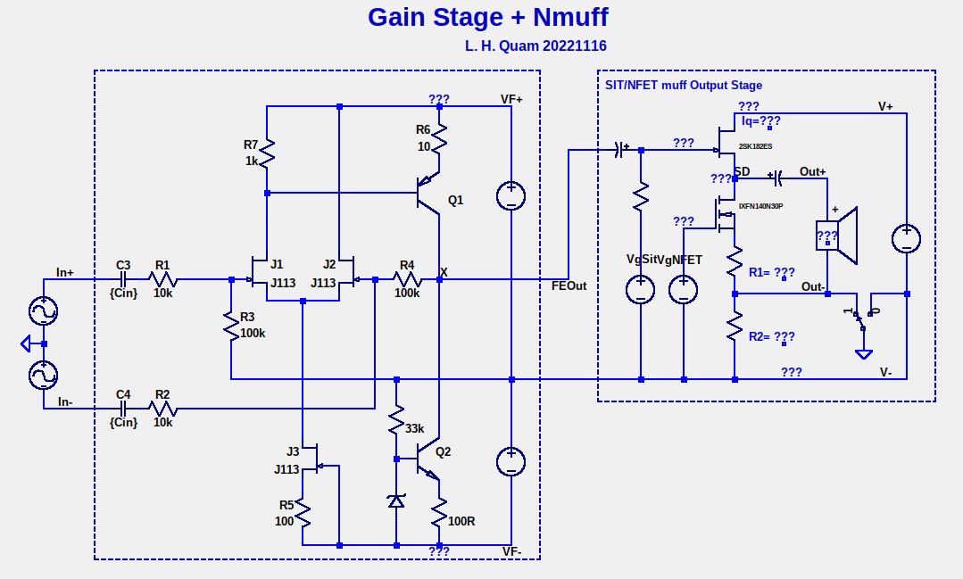

I have solved the issue with the NFET muff Out- being "hot". You can float the power supply negative side V- and ground Out-. With a minor modification to the BAF 2022 SIT AMP gain stage the circuit behaves the same either with V- at ground or Out- at ground.
Below is the schematic, with the idealized Nmuff output stage.

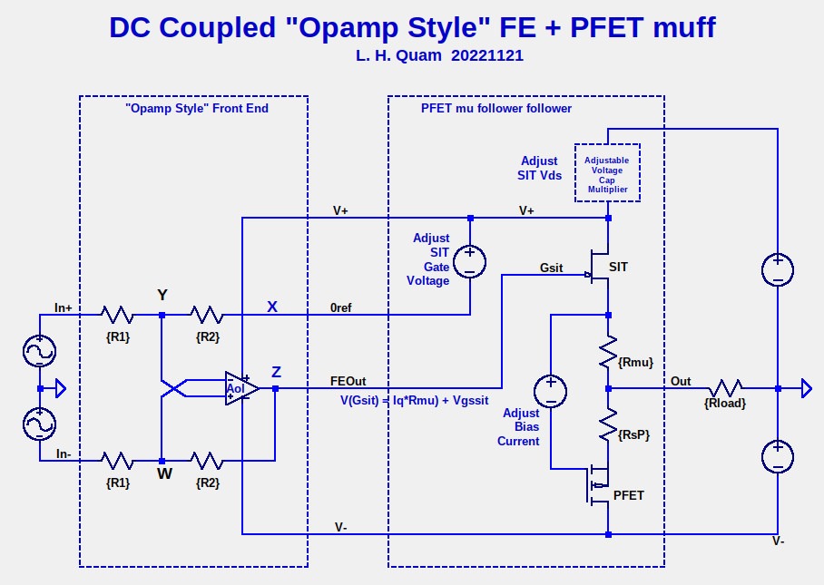

Here is an idea to think about: A totally DC coupled front-end gain stage combined with a PFET topology mu follower follower (Pmuff).
In the schematic below an opamp symbol is used to represent a differential amplifier build from discrete components, such as the "New Stasis Front End" https://www.diyaudio.com/community/threads/new-stasis-front-end.363701/post-6429624. The topology is that of an opamp, but with modest levels of open-loop gain (Aol perhaps around 500).
The Pmuff circuit is that same as shown in the "BAF 2022 SIT Amplifiers" https://www.diyaudio.com/community/attachments/baf-2022-sit-amplifiers-pdf.1101782/, except for the capacitor coupling and use of two power supplies, each of half voltage.
Won’t Y and W be sitting at the SIT offset voltage. So you would have that voltage at your input?
These equations are not the DC state, i.e. assuming the inputs are at ground.Won’t Y and W be sitting at the SIT offset voltage. So you would have that voltage at your input?
Aol is the open-loop gain, Acl is the closed loop gain
x=((Aol+Acl+1)*z)/Aol
y=((Aol+Acl+1)*z)/(Acl*Aol+Aol)
w=z/(Acl+1)
When Aol is infinite:
x=z
w=y=z/(Acl+1)
If Aol is relatively high (over 100), then the DC level of FEout (Z) will follow X.
