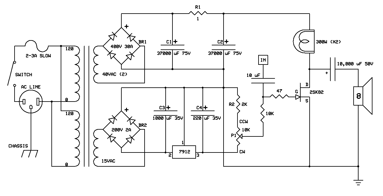

Would something like the Super Regulator board in the store be what you could use to provide and "control" the -3V on the gate? I don't suppose you could just stick a battery there for breadboarding the circuit? https://diyaudiostore.com/collections/power-supplies-accessories/products/super-regulatorRegarding the negative voltage on the gate (-3V), it is absolutely necessary to control this voltage when playing with normally-on devices or else maximum demolishing current will flow.
You could use a super regulator but it is over-kill. A trim pot/voltage divider is also needed to adjust the voltage as the -3V shown in the concept schematic is an example only, as the voltage needed will depend on each individual SIT.
A simple regulated supply as shown in Michael Rothacher's L'Amp will suffice:
Also check out ra7’s TDV amp thread for some exploration in simple biasing schemes
Thanks. Continuing the trend of just how stupid a question can I figure out to ask, looking at that circuit and reading some of the source material I'm guessing that Michael's choice of a transformer with 40VAC outputs gives you something like 55 VDC after rectification. The circuit Nelson suggested had 100 VDC to a single 300 W light bulb that I think drops the voltage to 18VDC. Michael's circuit seems to use two 300 W bulbs in parallel with ~55 VDC input. Does that also drop the voltage to ~18VDC? A voltage drop calculator I referenced seemed to suggest that, but I was just guessing at the resistance and current draw part of the calculator (https://elecurls.tripod.com/drop-res.htm). But it also seems like different requirements of the 2SK82 versus the THF-51S I would use might account for the difference in design?You could use a super regulator but it is over-kill. A trim pot/voltage divider is also needed to adjust the voltage as the -3V shown in the concept schematic is an example only, as the voltage needed will depend on each individual SIT.
Yes, different load lines for 2SK82 and THf-51S chosen by Michael and Nelson.

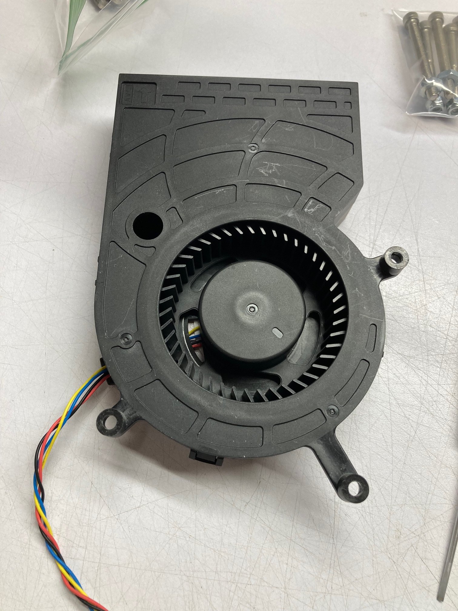

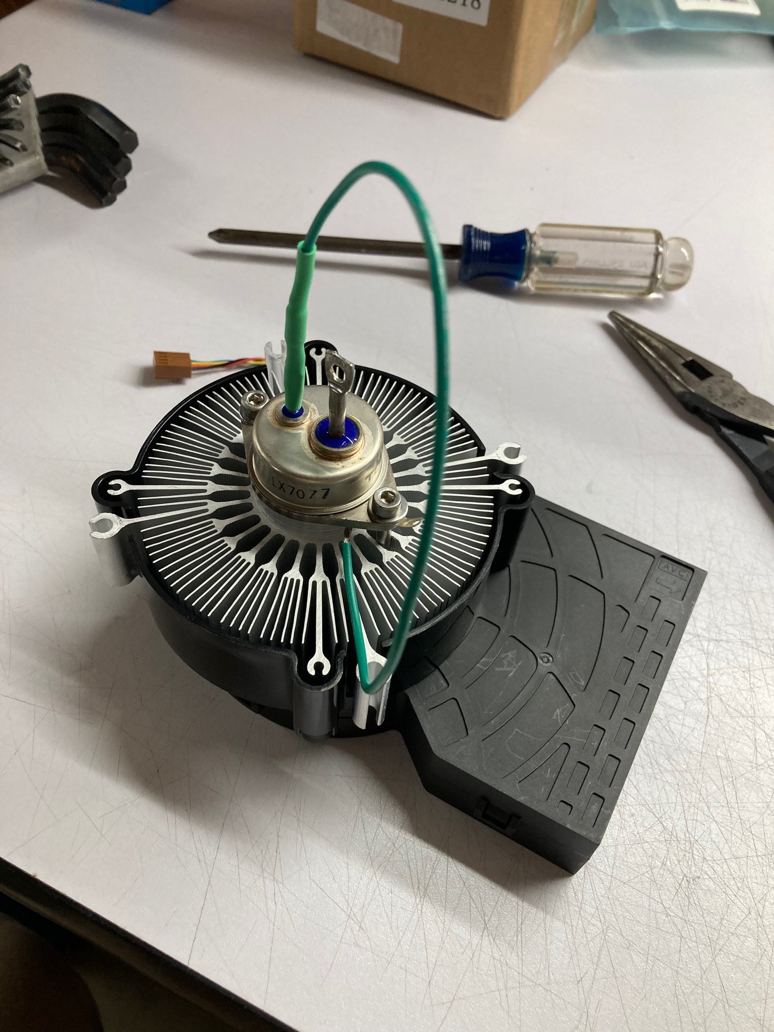

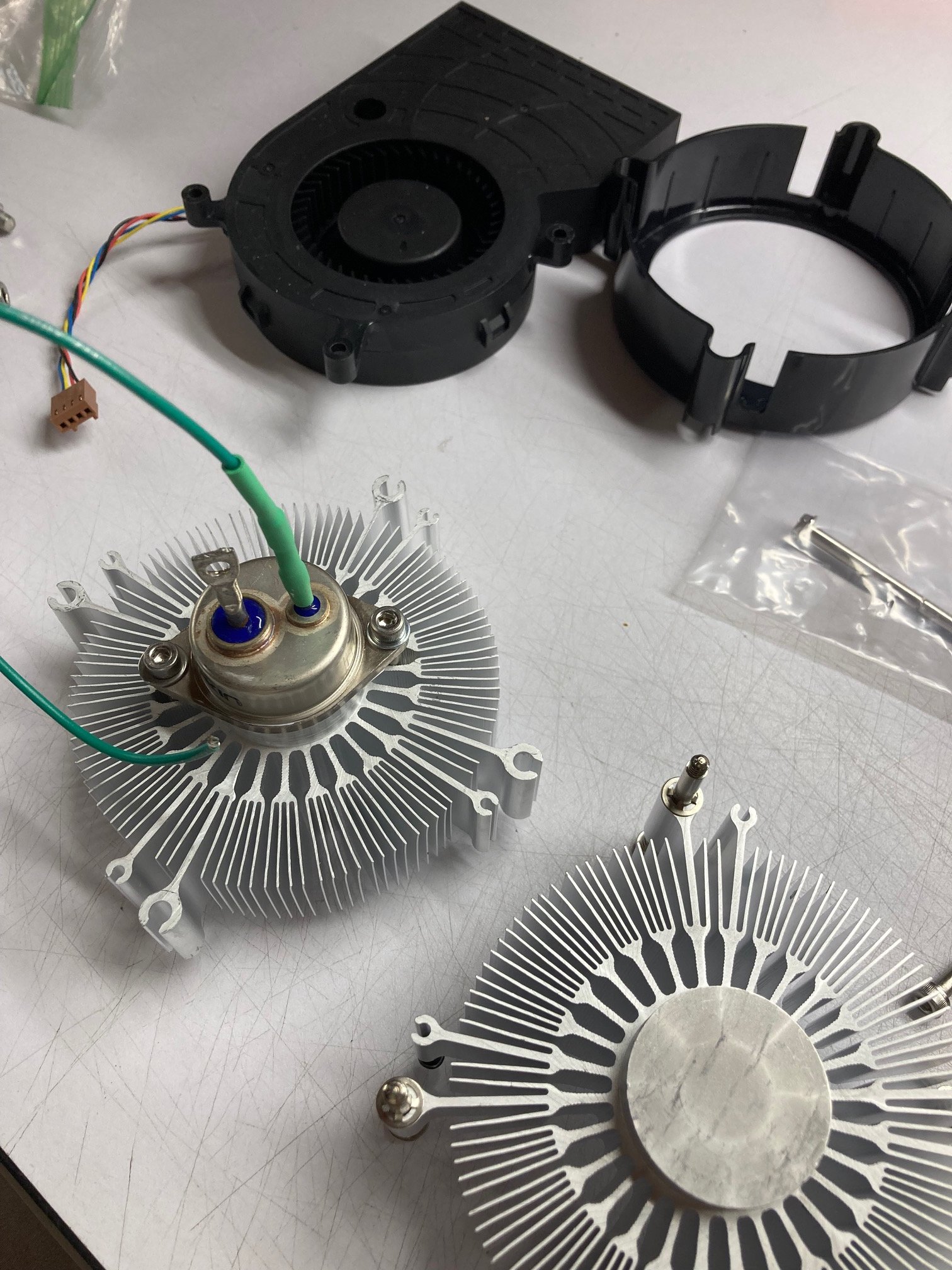

Here's a trash heat sink idea, a CPU cooler bolted to a THF-51S. there's a smol TO-3 mica and goop in between that's hard to see. I don't know what brand/model these CPU coolers are, these were gifted to me by a friend. Eventually I'll try to build an amp with these, but it could be a while.
During quiet passages, you can point out the distinct sound of the blow off valve to your friends! 😀
Gpu... grafic card maybe https://www.amazon.it/BAZA1233R2U-chassis-integrated-machine-cooling/dp/B0927CG3VYHere's a trash heat sink idea, a CPU cooler bolted to a THF-51S. there's a smol TO-3 mica and goop in between that's hard to see. I don't know what brand/model these CPU coolers are, these were gifted to me by a friend. Eventually I'll try to build an amp with these, but it could be a while.
This is a great idea and allowed these coolers to have a second life !Here's a trash heat sink idea, a CPU cooler bolted to a THF-51S. there's a smol TO-3 mica and goop in between that's hard to see. I don't know what brand/model these CPU coolers are, these were gifted to me by a friend. Eventually I'll try to build an amp with these, but it could be a while.
