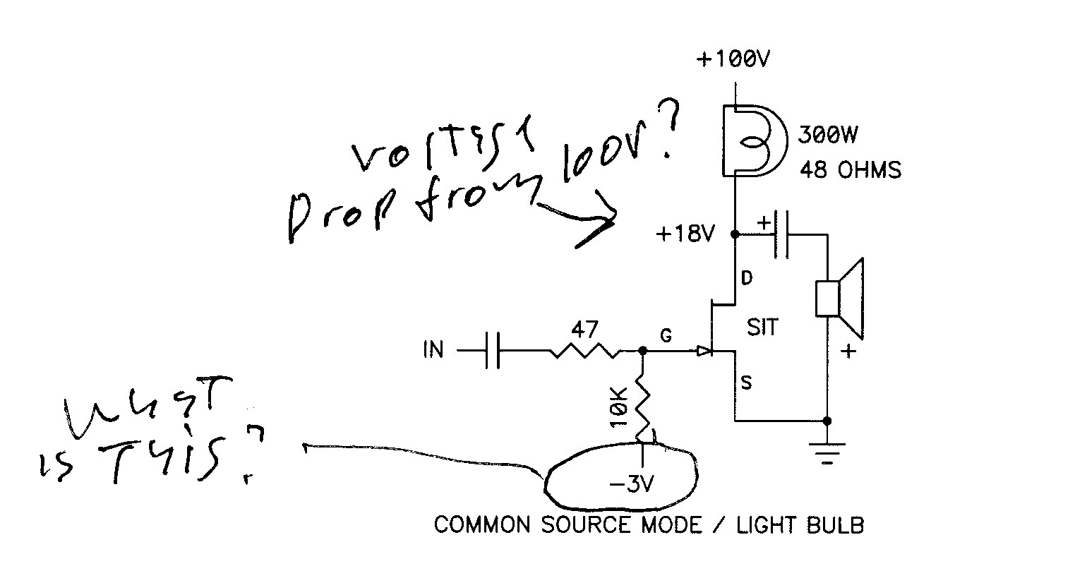

I bought 4 of the THF-51S parts when the whole "While They Last" thread was first started. Since my DIY skills more or less boil down to being able to solder and follow instructions, I don't really understand the circuits Nelson shared in the PDF. Specifically, can somebody tell me what the things I've noted in these JPEGs taken from the presentation mean? And I for one would be REALLY appreciative if one of the more accomplished members of the forum would actually share a complete circuit, with part specifications, that would make use of the THF-51S parts.
For starters all voltages are referenced to ground, that triangle of parallel lines.
V is a voltage source. Could be anything, including battery, solar cell,or a circuit detailed later in the piece.
The S laying on its side represents signal - a crude picture of a sine wave.
Basically, as simple as this circuit is, it works. Later in the piece some details are fleshed out a bit more.
The friendly people in this forum will be happy to answer additional questions, and the process will also help those who are more shy.

PaulInWA, Zen Mod's Singing Bush amplifier is based on the concept shown in the second schematic.
Singing Bush
In the first schematic, the light bulb drops voltage as it heats up. The -3V is to be provided by a negative voltage supply which is applied to the gate of the SIT to adjust and control the current through the SIT. Michael Rothacher's L'Amp is an example of this concept.

Nelson, Thanks for explaining those symbols. Obvious except when you don't know what they mean LOL.PaulInWA, Zen Mod's Singing Bush amplifier is based on the concept shown in the second schematic.
Singing Bush
