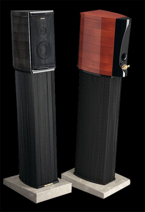

Wow, I am speechless. That's pretty amazing, although it's a little more than what I have in mind. I have attached a picture of the speakers I use, the Guarneri Memento's. Mine are in "Rosso". The stands that come with them are steel and hollow, and at least to me, not the best complement to the speakers' prowess.
When papa was presenting yesterday, and said - at 54:28 on Mike's video - "you can build it....you should rush out and acquire the parts and do it", I was sold. That's the power of a great idea, and this idea is truly a great idea. It has enough power as a Class A SE to easily drive my 4 Ohm speakers, and with judicious coupling, the speaker will live very happily on top of a structure that offers plenty of dissipation for the 90+ W, and position the speakers at the ideal listening height.
