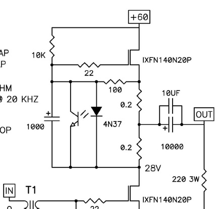

isn´t there a fault around the optocoupler in the slide about the Mosfet XFN circuit?
The anode and the collector of the optocoupler are connected, I suppose they should not.
The slide with the Yamaha part is o.k.
left wrong, right right….. 🙂
