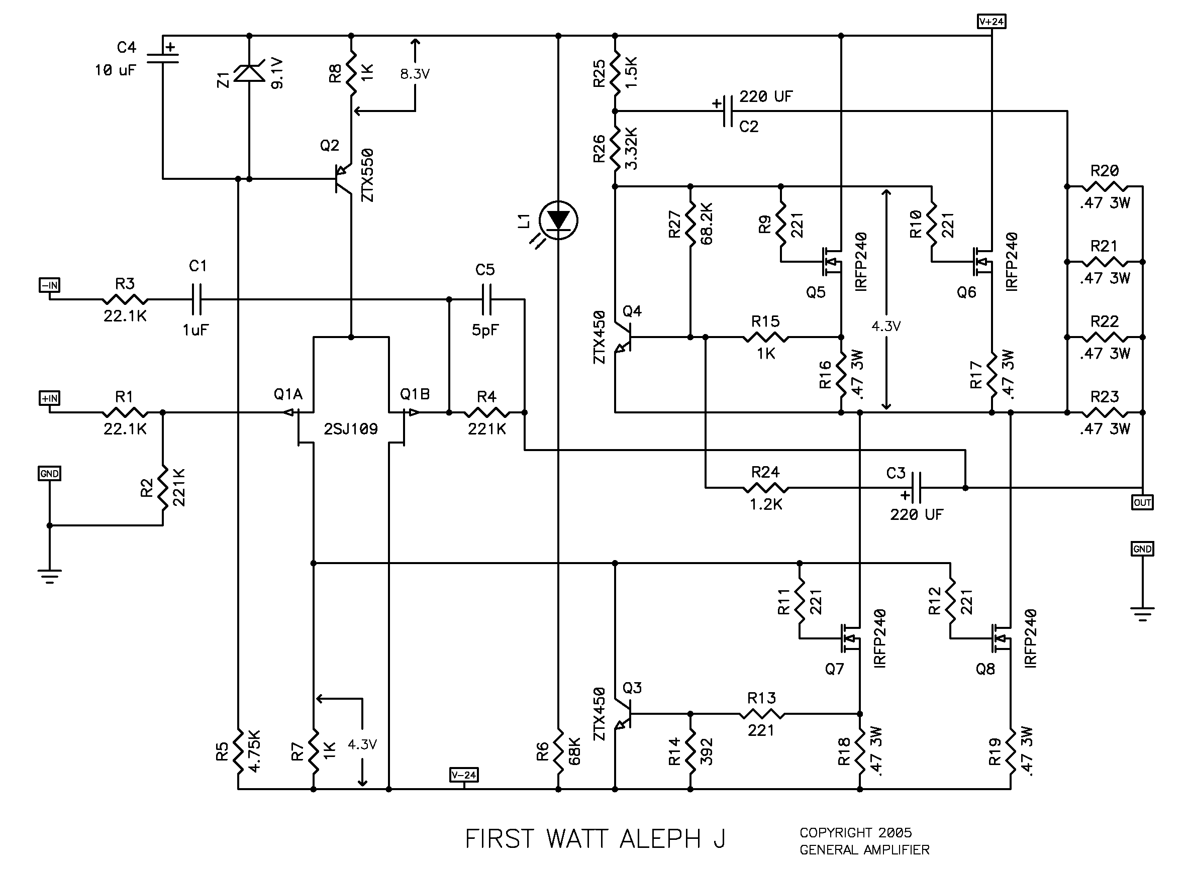

Classic long tail pair, this and the J2 are the only FW amplifiers using it.
:cool:
