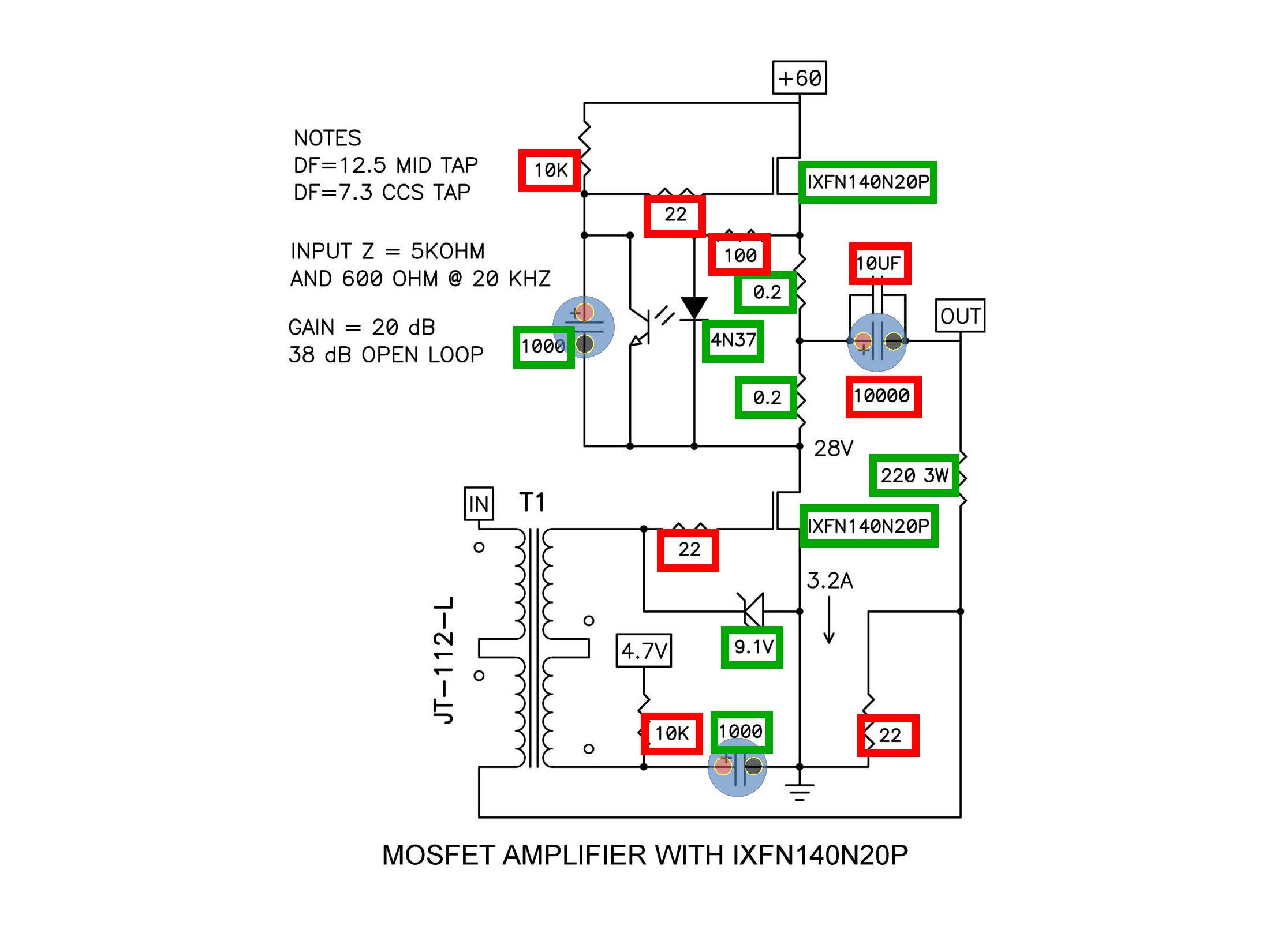

Am I missing the 100 ohm resistor that is between the photo coupler and the .2ohm resistor?
Bob
Hi Bob,
You are RIGHT - join the team of "What's wrong with this picture" finders. Attached please find rev2 of image showing missing 100R from S1/0R2 junction to the anode of the 4N37.

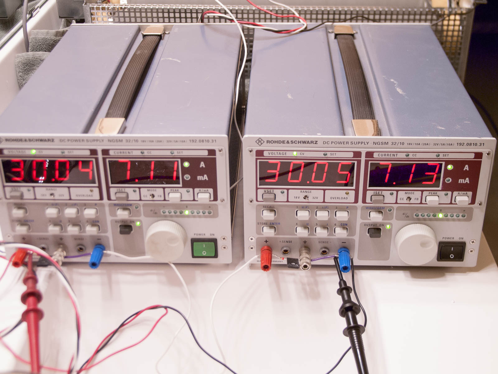

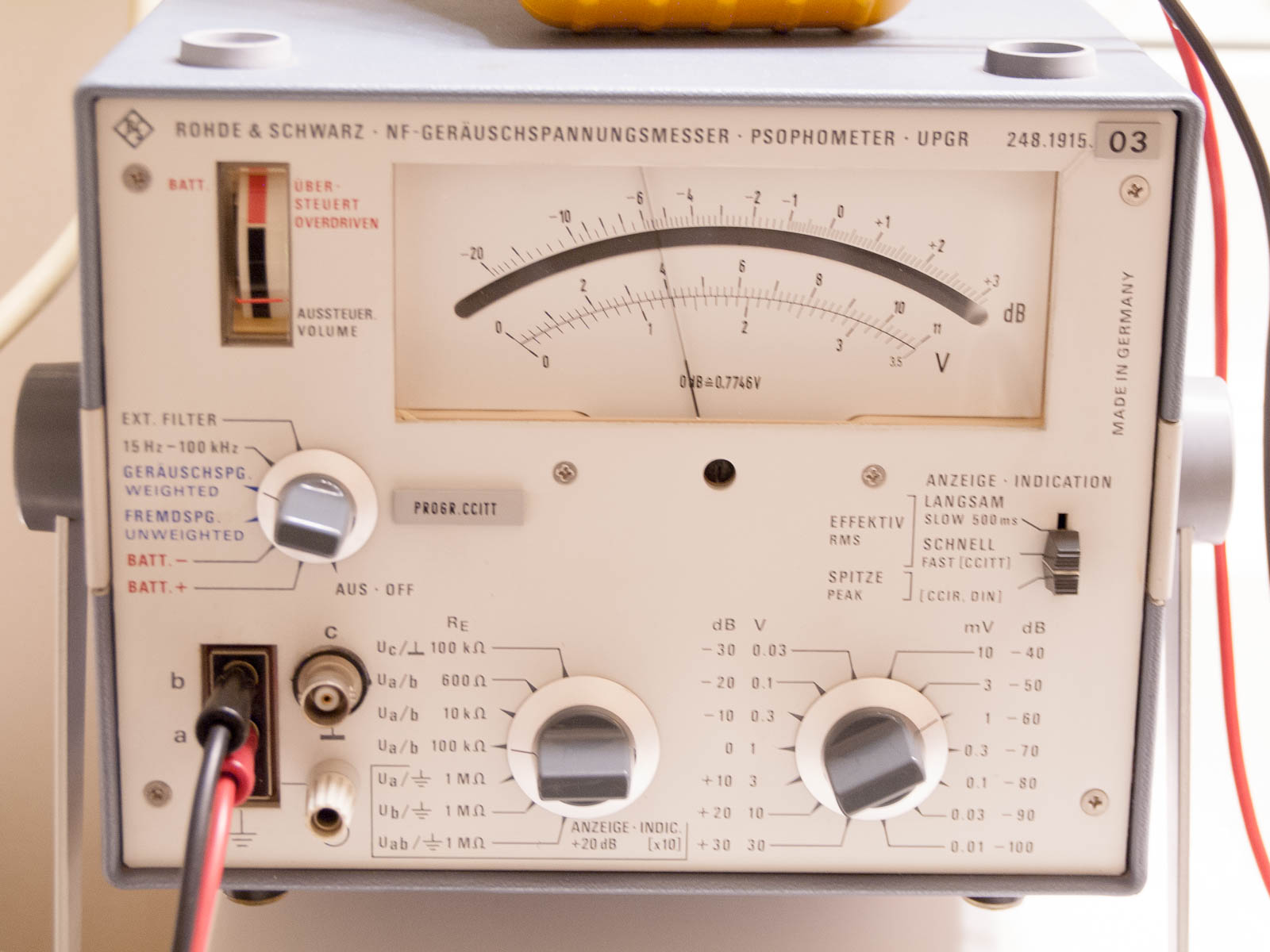

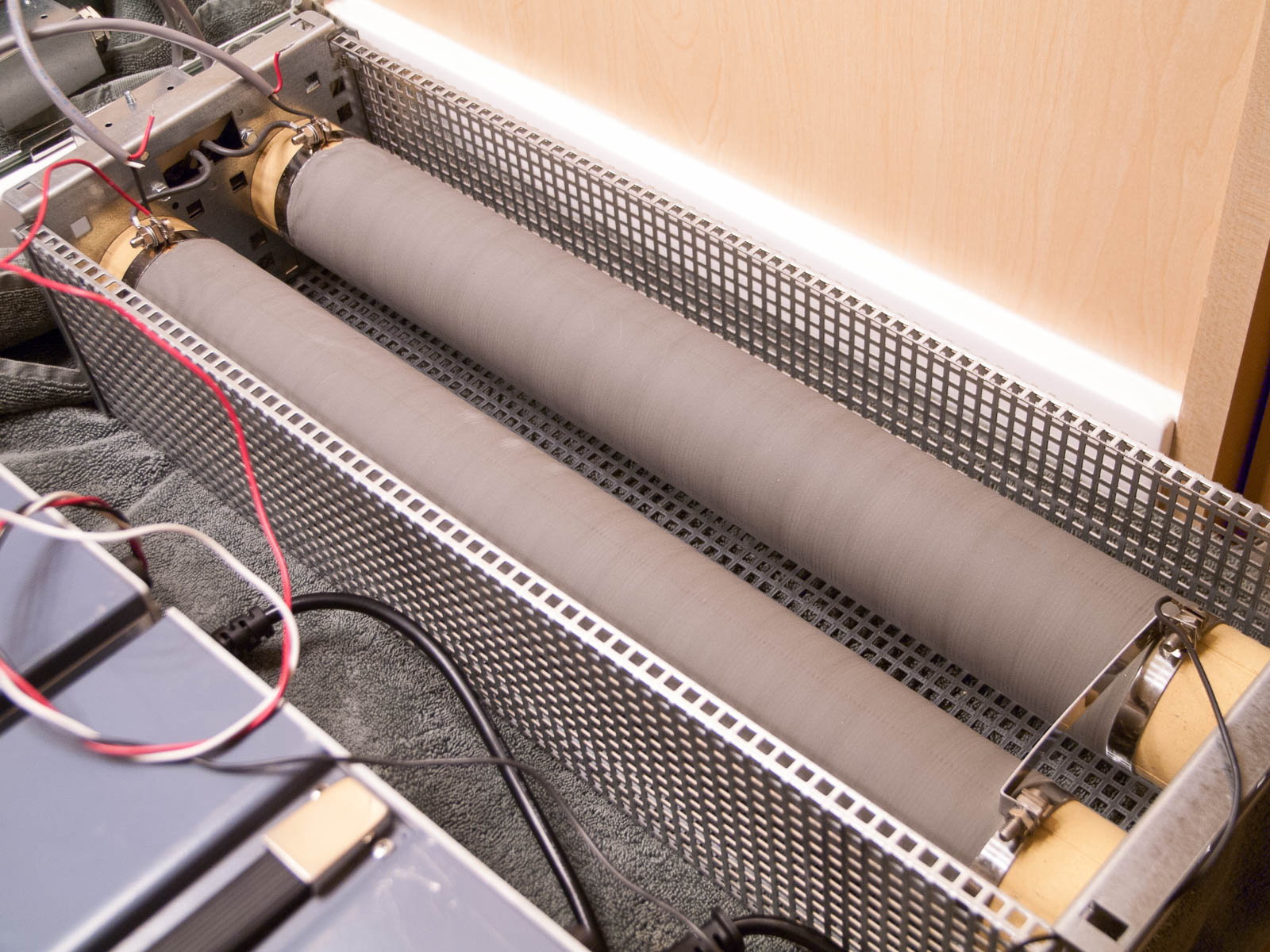

Attached are pictures of load-testing my serially connected bench supplies which produce +60V with 7.1A into a 1.5kW 8R6 current sink. The noise floor measured at 0.4mV or -68dB A-weighted which I think should do the job nicely. The bias voltage is also coming from a bench supply and it measures even lower.

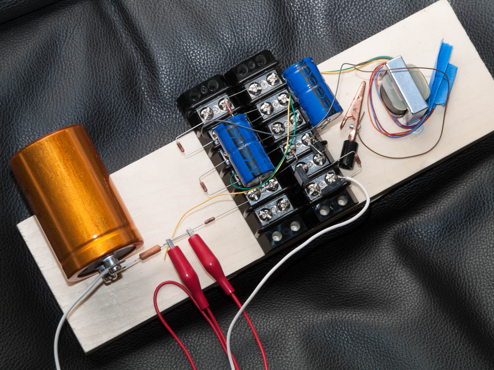

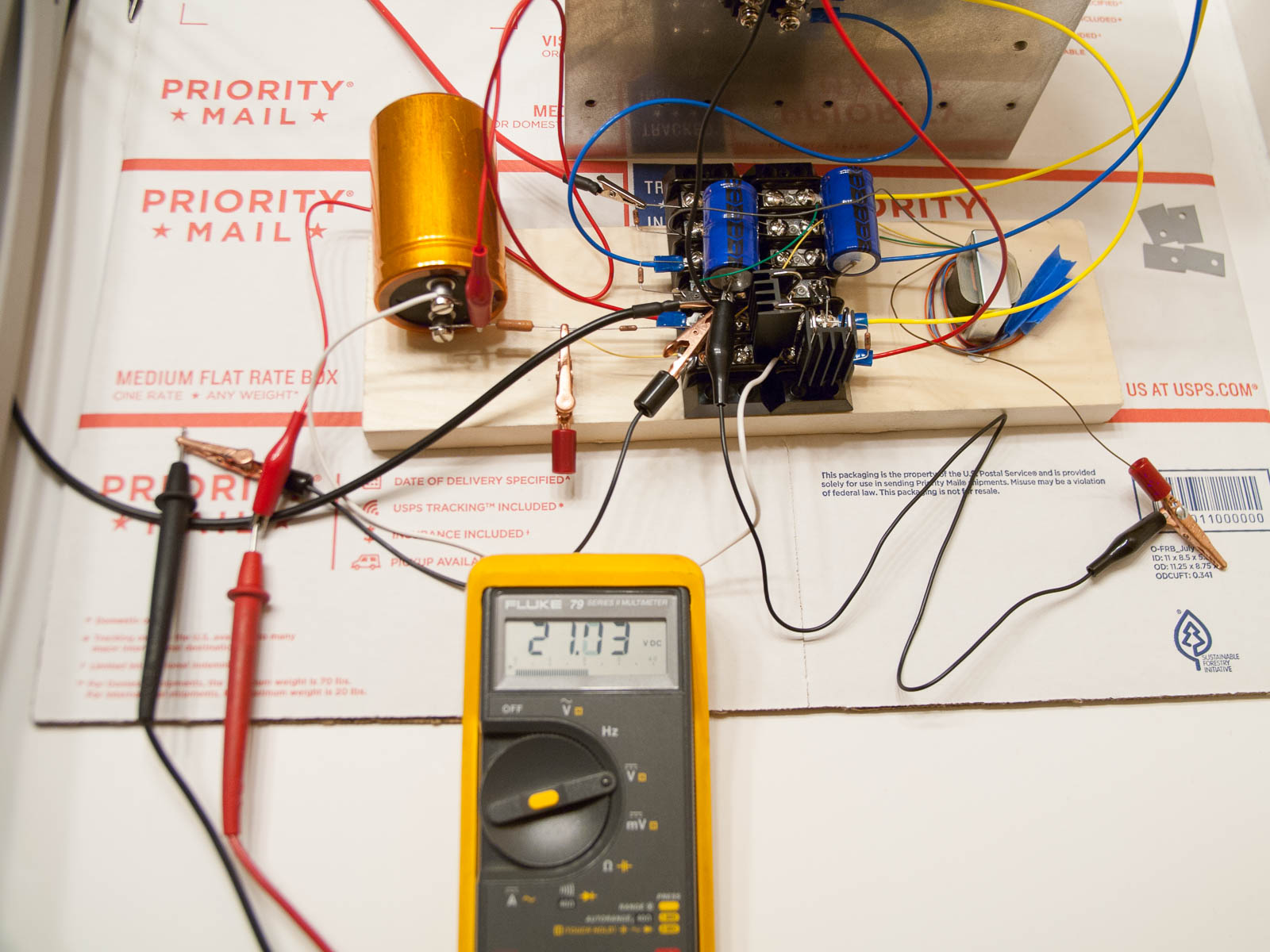

I got all the parts, hooked them all up, and checked all the connections and voltages:
Rail = +60V
Bias = +4.7V
I shorted the input to measure DC offset at the output, when I got 20+VDC!! Please see pictures.
What's going on? Where did I go wrong??

Bias is not exactly +4.7V.
You need to adjust the 4.7V voltage source until you get 30V at output.
It might be 4.75 V or 4.82V or 4.64V etc.
Make the adjustment and report back
did you expect some millivolt?
I expected it to be different than 4.7V (ie not exactly 4.7V). It will depend on Id vs Vgs of the device, which is variable for every device.

Are you measuring from before the output cap? There's going to be a large DC voltage there, it's a single-rail supply.
Measure DC offset from downstream of the cap.

I varied the bias down to +3.5V and the DC is still there. In fact, the DC voltage appears to drop quite a bit, and if I wait 30 seconds, it would be around +10V. As soon as I turn the bench supplies off, the measured DC voltage flips from +ve to -ve.
Never saw this before!
The +ve measurement is tapped right from the cap, and the -ve is tapped from the ground which is also connected to the source of the output mosfet.

The +4.7 is what's on the schematic, connected to a 10k. There was no +30 marked on the schematic that I have. Here is what I am working from:
You need to get 30 V measuring between the output resistors and ground. Keep adjusting voltage source till you get 30V.
I did say these suckers are very sensitive to small changes in Vgs.
On the speaker side of cap you should have 0V otherwise there is something wrong with your cap.
