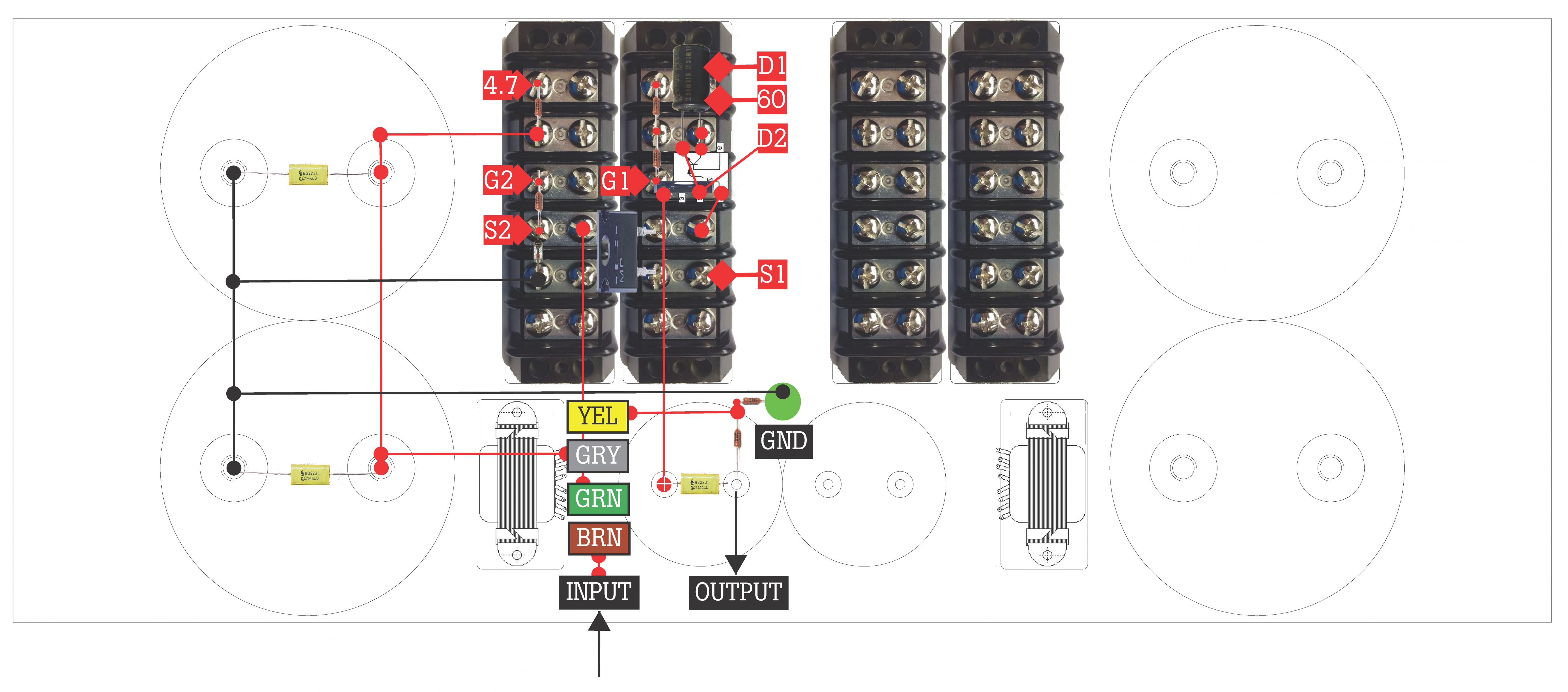

With additional guidance from Papa regarding the power supply and caveats, I made the decision to do my build using terminal blocks and a decentralized topology. The idea is to start with bench supplies then migrate to a PSU box, and keep the output devices and their heat sinks outboard as well, since the ones I chose are likely too big for a case.
The bench supplies passed their load test this week but noise tests are still to be measured with a better instrument that is on its way. Components are mostly on hand with the heat sinks now on order. So it was time to do an actual component layout. I took a run at the logic flow a couple of weeks back and with the help of 2picoDumb and Chul, the results were posts earlier in this thread. Now with specific component on hand, I did a life-size layout to scale to find out if there are any space or logic conflicts. A few notes on the picture, it's big so details can be seen, the PSU and output devices are not included, the 2 big cans on each side are DC Link film caps paralleled for the FB loop, and the small can is the output coupling cap.
Your generous feedback, comments and corrections are much appreciated!!
Thanks for posting this but if you don't mind
Could you say more about the DC link caps - Value?
Do they replace the 1000µF electrolytic?

Hi Bob,
Thanks for the kind words. Papa and members all helped me to get this far, and hopefully my adventure is helpful to those who want to go this way as well.
As for the DC Link caps, yes, the 2 490µF paralleled are in place of the 1000µF in the schematic. They are CDE 947C's rated at 800V and 70A so way over the top for this application. They are also big (90x120) and pricy (@$50) but I am very curious as to what they will do. There had been a flurry of comments on a few forums on their use but nothing declared them definitively as the holy grail or a giant waste of money. Given the simplicity and nature of this circuit, if it makes a difference anywhere, it will here.
Really interesting
I was thinking of using Elnas and bypassing with 10uF Obbligatos or some motor run caps which I have. Experimentation 😀😀😀😀

I think 2pD is right - anything else within reason will work. I've had good luck wiht SILMIC II's too, but no experience yet with Obbligatos. My plan for bypass is a 10µF Epcos flim and 10nF polystyrene although in this same position in the Nakamichi PA7, I also found the Mundorf eCap excellent.
