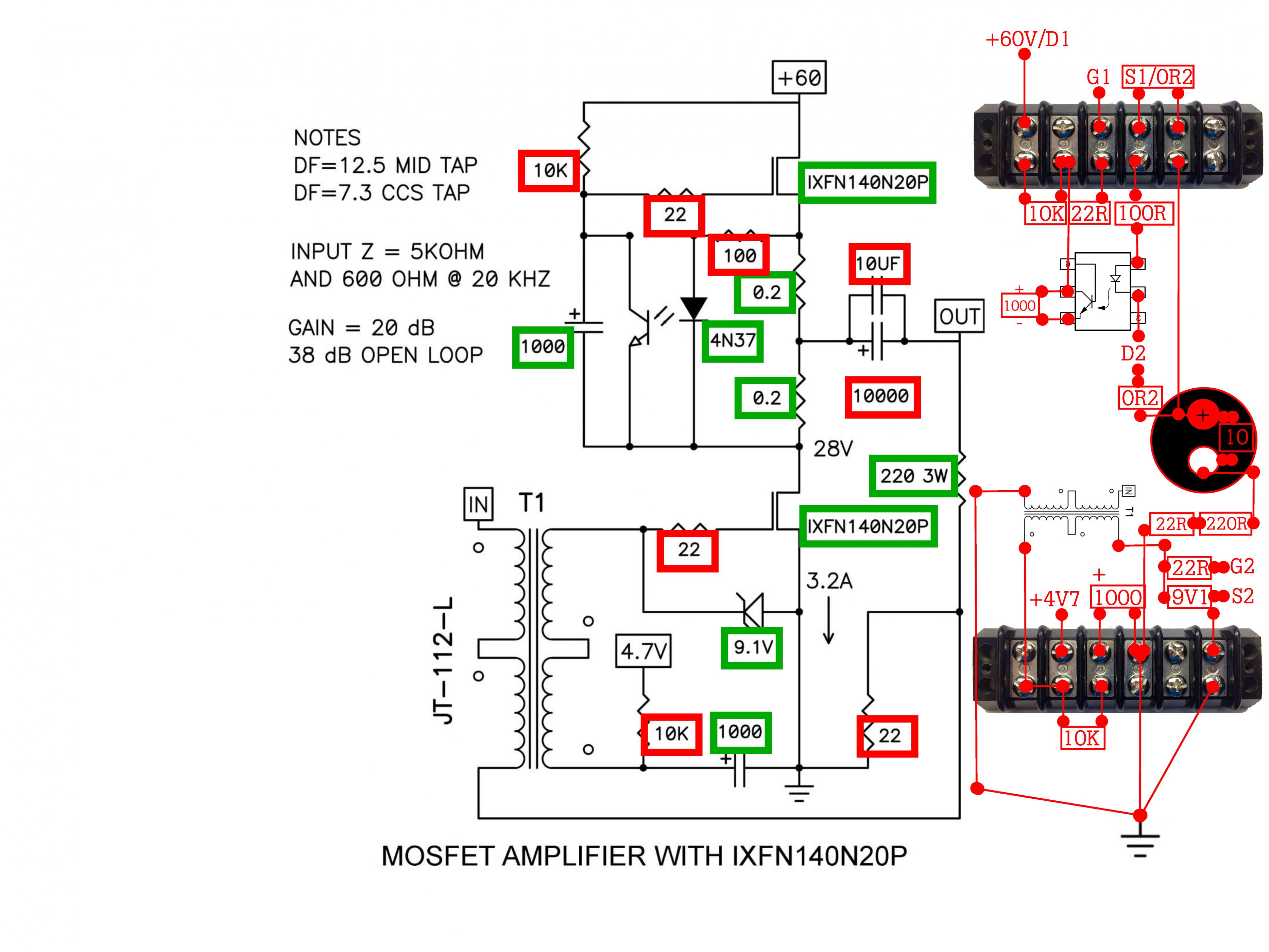

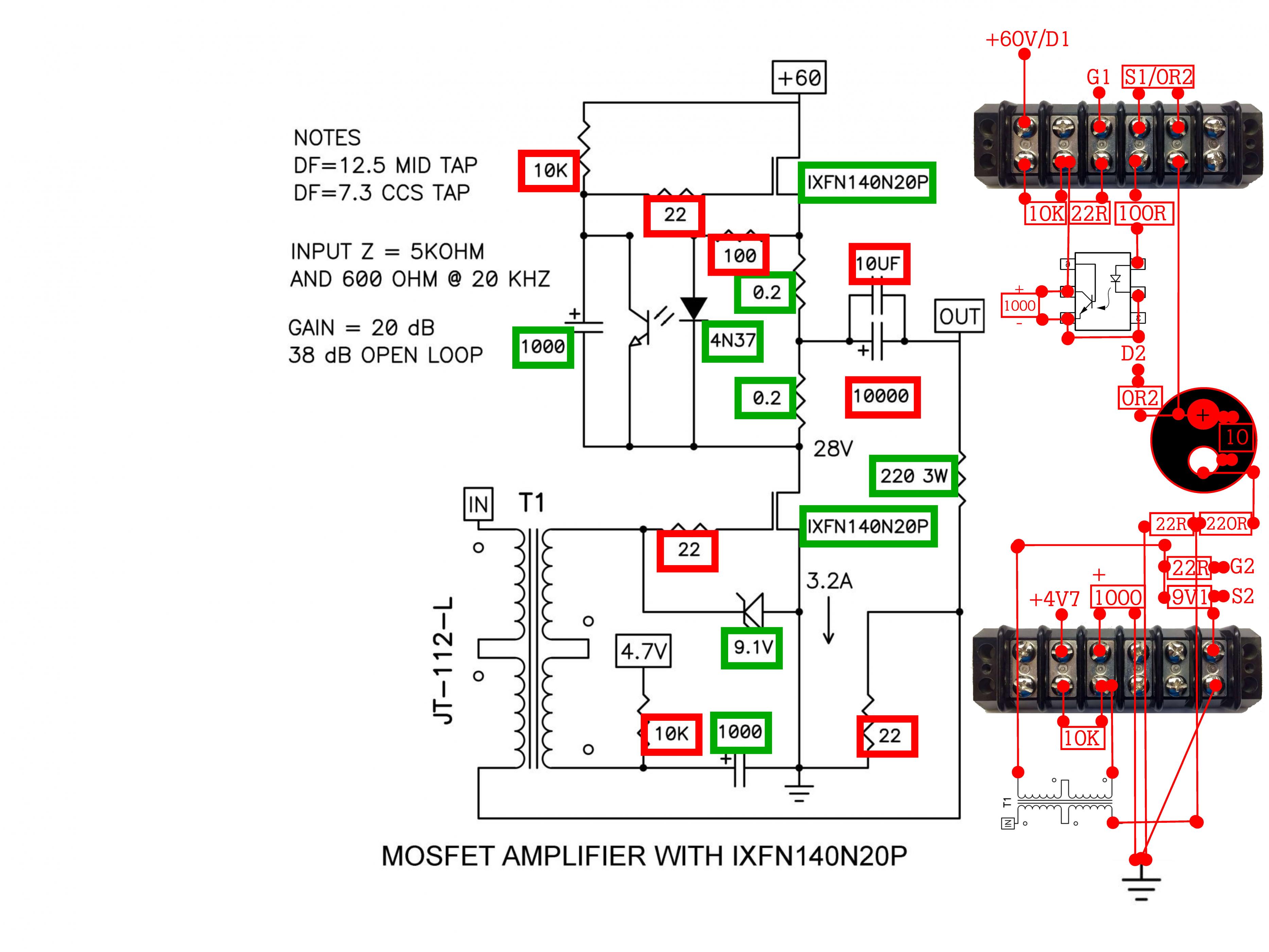

Gentlemen,
Thank you for your input - I knew my brains needed help!
2pD: you are right, and the attached picture reflects the change.
Chul: 4V7 goes "down" on the strip through the 10K attached to the bottom then "up" through the 1000µF, whose -ve is attached on the next strip, then goes to ground. Sorry these was no -ve sign shown on the 1000µF.
Hope this does it....thanks again, gentlemen!
If you look at 4V7 on your layout. it by-passes 10k resistor to bottom of transformer.
That needs to be corrected on your layout.

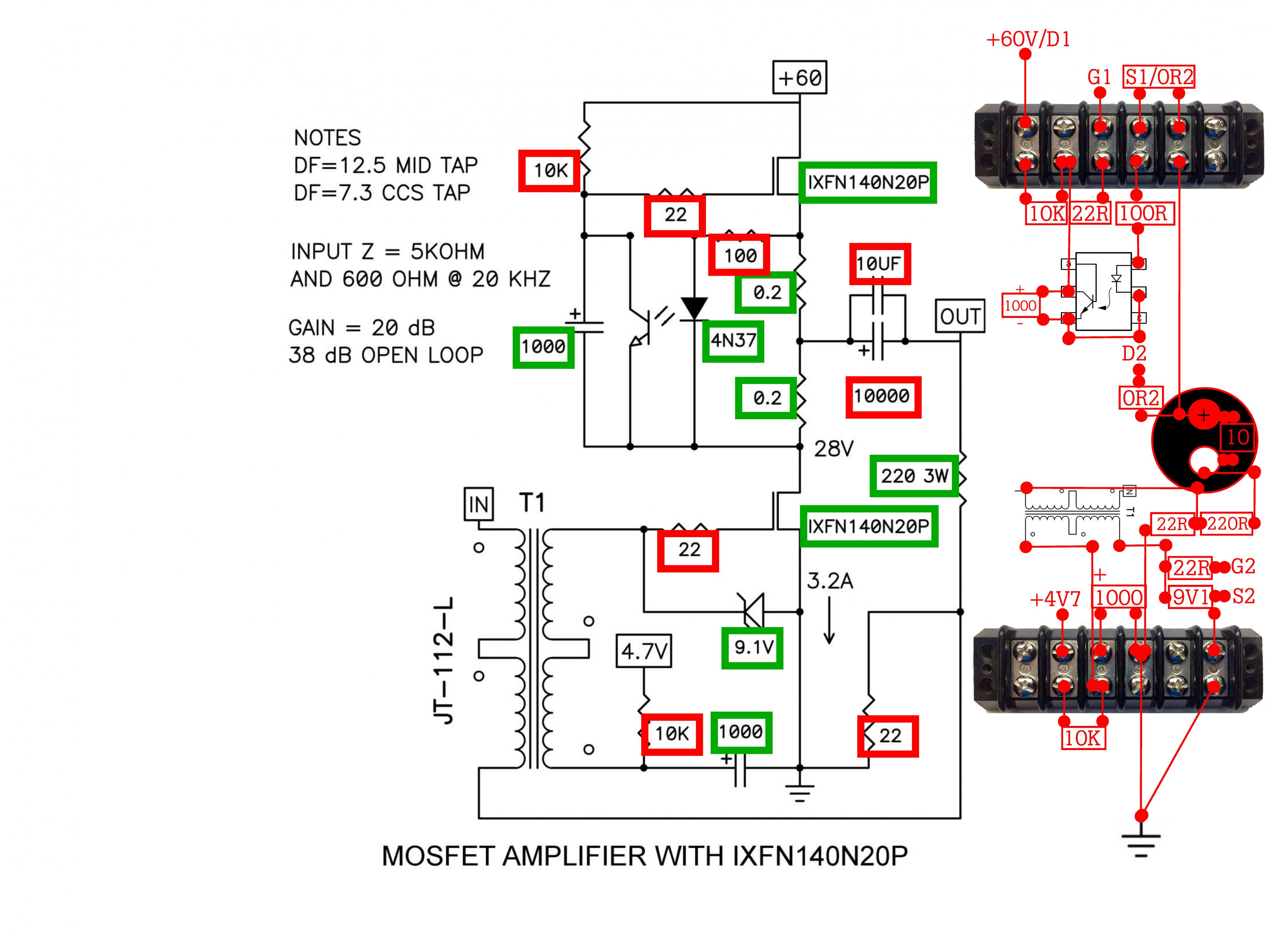

You are right again! Here it is.
I'm thinking of using this optocoupler 4N37 Vishay Semiconductor Opto Division | 4N37-ND | DigiKey
Bottom of diode and transister on 4n37 on your layout are not electrically connected to each other.
Needs correction.
It's now downright embarrassing - I should stick with software.
I've checked it one more time. Looks good.
Regarding 4V7 if you are using lab powersupply, you need to be able to adjust in 10mV intervals to get the adjustment you need. If you're supply doesn't have fine adjustment you might need to build either voltage reference circuits posted earlier.
Either way, you may as well start with what you have.

2pD
Thanks for the reassurance on the routing.
My bench supply for the 4V7 has fine adjustability in 1mV steps, and deviation of 0.5mV. With its low ripple of <1mV and remote sensing, I thought it would be a good candidate even if it may be a long run between the supply and the amp. With papa having weighed in suggesting bench supplies as a good first step, I'm going for it. Otherwise, I would have adopted your LT1431 or Zener regulator idea.
Thanks again for your look over, I hope the terminal block approach provides an interesting alternative to all those who plan to build this fabulous amp, and perhaps even experiment with creative case configurations beyond a boxy 4U/5U.
Sounds like you're all good to go.2pD
