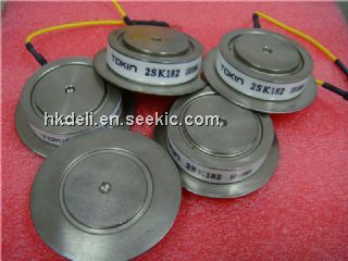

So to see if I understand - if one were to build the 2SK77B circuit with a substitution of 2SK182s for the unobtanium would the timing of bias voltage and gate voltage be a concern for theVFET or does the presence of the hockey puck in the CCS mitigate.

I haven't checked on 2sk77 vs 2sk182 to see the differences. If you were extremely lucky you might be able to easily substitute 2sk182 into Papa's 2sk77b amp schematic (a little different than the IXYS schematic we are discussing here)

I believe NP at BAF2015 mentioned that the use of the 2SK182 in the 2SK77b would require some tuning.

Also bear in mind they are probably only good for 40W dissipation so 40V or 44V supply and around 2A.2 picoDumbs
Nope, 2sk182e are 500W parts. And they should have a stable bias voltage before the high voltage/current come up.
Yeah. Brainfart. I was thinking of Sony 2sk82

Is it not safer to slowly raise bias with hv already on than to have full bias and then " turn on " hv ?
In that later case transistor will have full current as soon as hv is comming, I mean that transistor
is "open" by the biasvoltage ?

In the case of a depletion mode (normally on at 0 Vgs) mosfet, there maybe some conditions that you might want bias on first to protect the devices from seeing too much current, but if everything turns on together at the speed of light we're talking picoseconds or 3/5 of FA.Is it not safer to slowly raise bias with hv already on than to have full bias and then " turn on " hv ?
