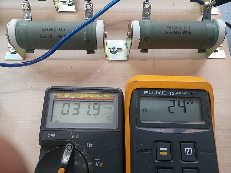

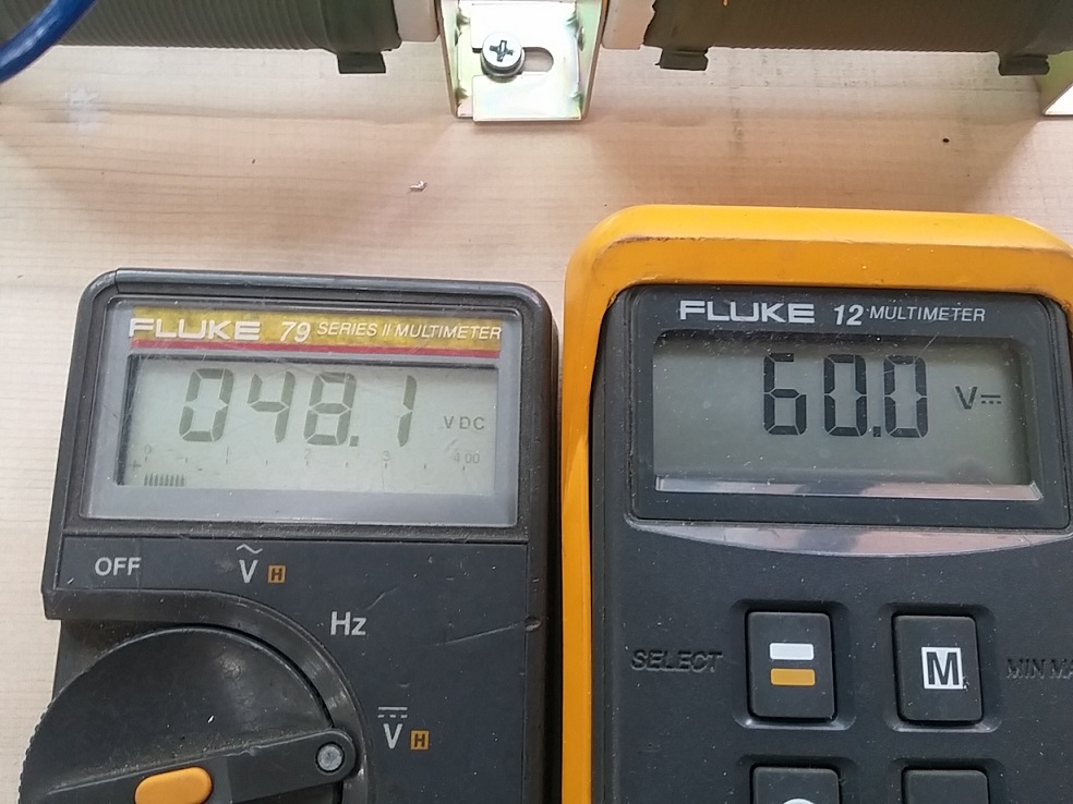

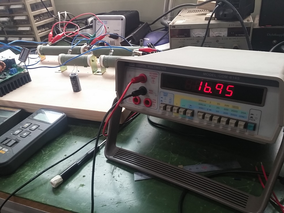

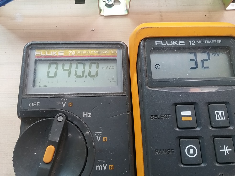

I will get that AC ripple voltage this morning. I have this 10 ohm 100Watt WW resistor for a load, since ripple may change with actual current?
Nelson wrote that 0.5ohm between two 47000UF would make a good supply, and I think this CCS remove some of the ripple better than resistor or choke load.
Just did this
Hi ci11,

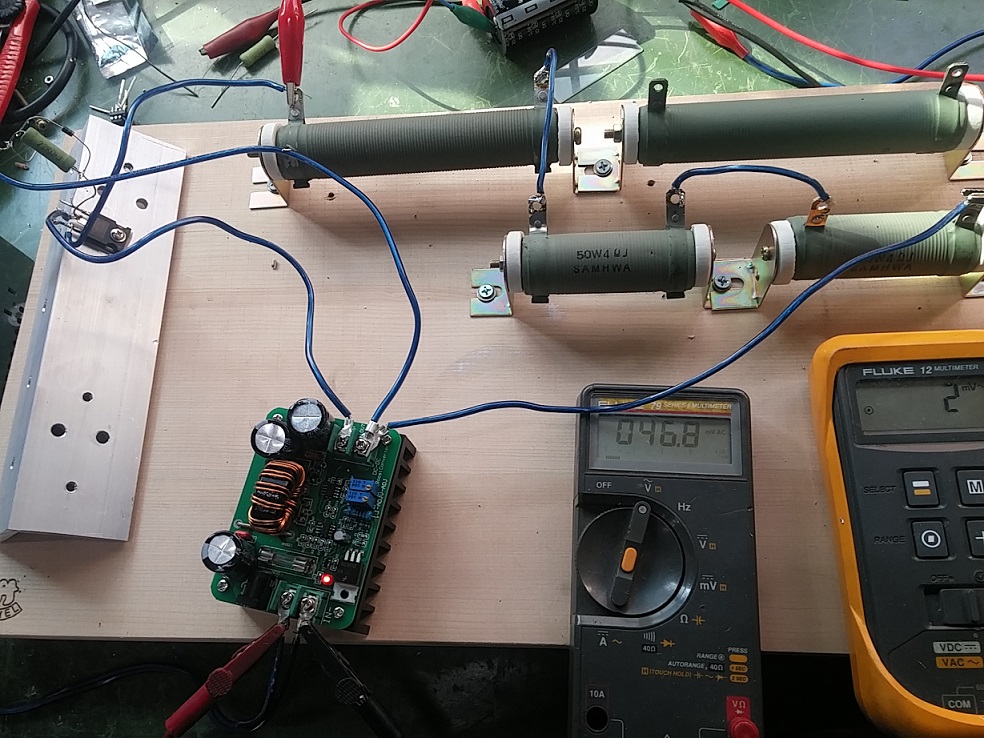

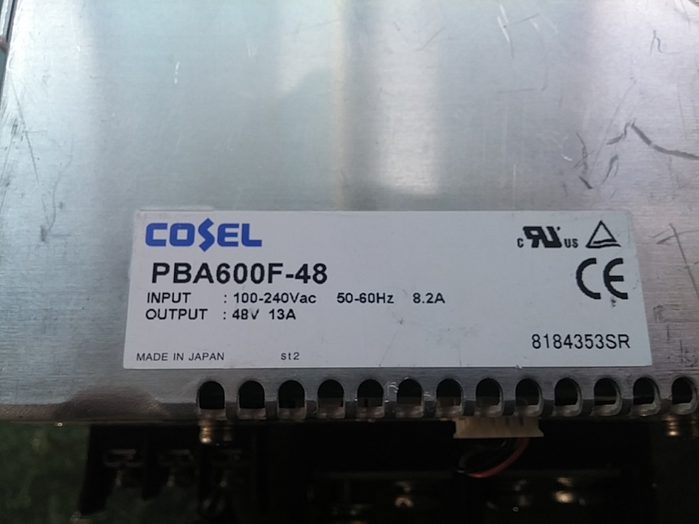

Please see the pictures. I used total 18 ohm load resistors(10+4+4). In short with 48VDC from SMPS and 60VDC from converter, I have 32mV from SMPS and 24mV from converter. I added 47000UF capacitor and this made it to 22mV.
This may be OK for me, since I use a very low efficiency speaker. But with Lowther or other full range we need quieter supply?

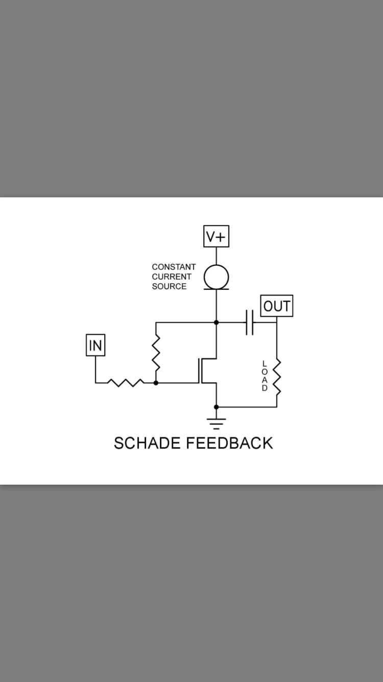

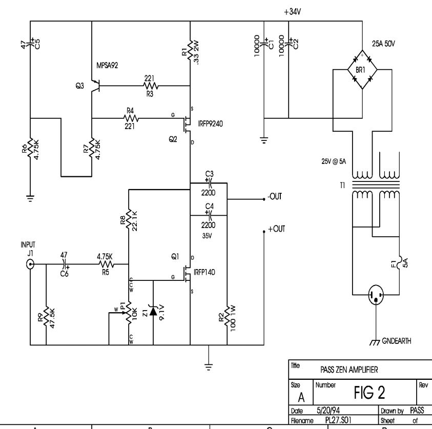

{snip} I don't think the original '94 Zen is an example of Schade feedback.
looks pretty Schade-y to me

Hi Chul,
Thanks for running the tests and the pictures. Looks like neither the SMPS and the boost DC/DC converter can cut it for this circuit.
When papa replied with the 0R5 between 2 47K caps, he also mentioned that both the R and C values can be changed. In my own back-of-the-napkin math, it was looking more like at least 272K and a 1R5 to get to around 2mV. I would be happier at this level since my speakers are 4 Ohm dipping occasionally to 2.
So thank you once again and it looks like more work ahead!

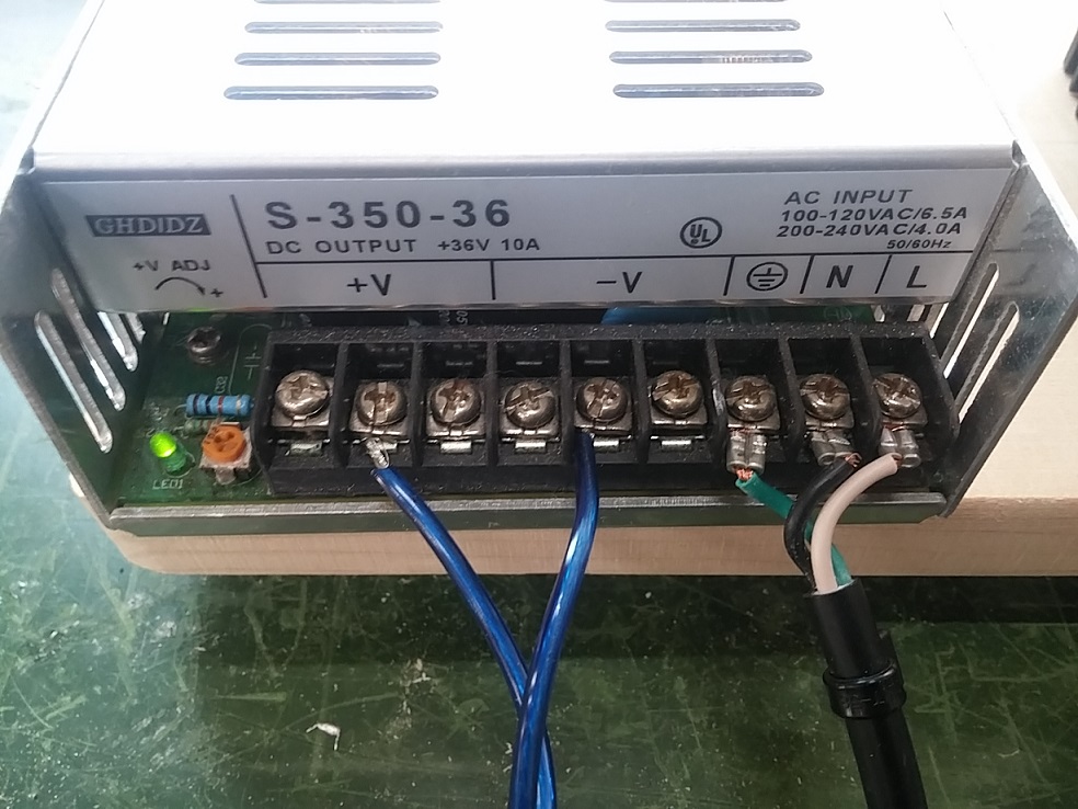

I tried more common type 36V 10A SMPS frm ebay, and I get 32mV. I am keeping them connected as it is for some hours.
I must not understand how we're defining "Schade" feedback. Perhaps you can help me there.

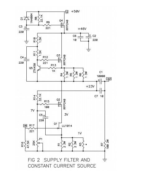

One more thing, we have all these "stones to throw at the walll"
I just tried the FET supply filter and it seems to work. A little more voltage for the FET (about 4V? this is OK with this converter) and a little more heat (I am OK ) ... We have 2mV now.
Of course I would go for simple linear CRC supply with right formula, but this is also fun to play.
Of course I would go for simple linear CRC supply with right formula, this is also fun to play.
Hi Mike,
I remember the same feedback from tube circuits, called partial feedback. The claim is the same, that it makes pentode work like a triode. I really liked this feedback with tubes. I do not know which name is the right one but I do not mind.
Check the resisotor between plate and grid of the output tube. This resistor is also used as a load resistor for driver tube. There is a blog on this on More Hybrid-Amplifier Design

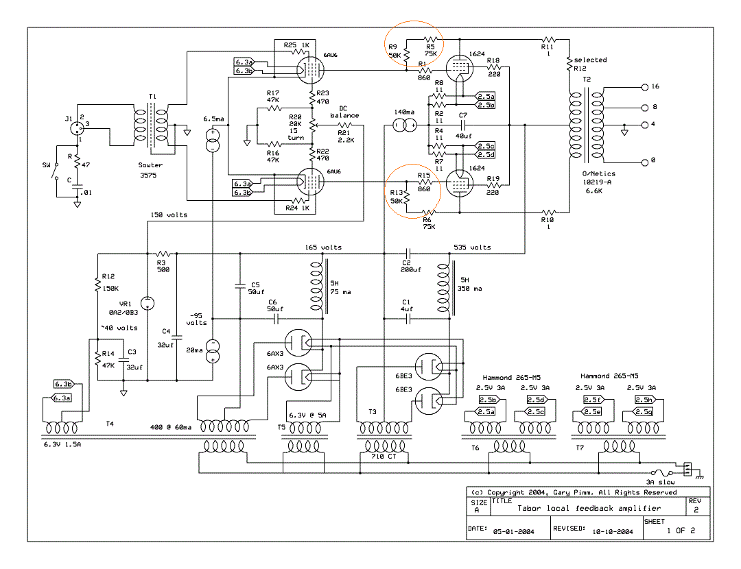

This thread has some useful background including the spice sim that nelson showed at the BAF:
http://www.diyaudio.com/forums/pass-labs/281233-schade-circuit-using-irfp240s.html
Also, I think i mentioned it earlier but in case I didn't: Thank you Mike, so very much for giving us the videos of BAF !!
yup , that goes long way back ........
O. H. Schade …… Beam Power Tubes , article about special feedback , 1938 | Zen Mod Blog

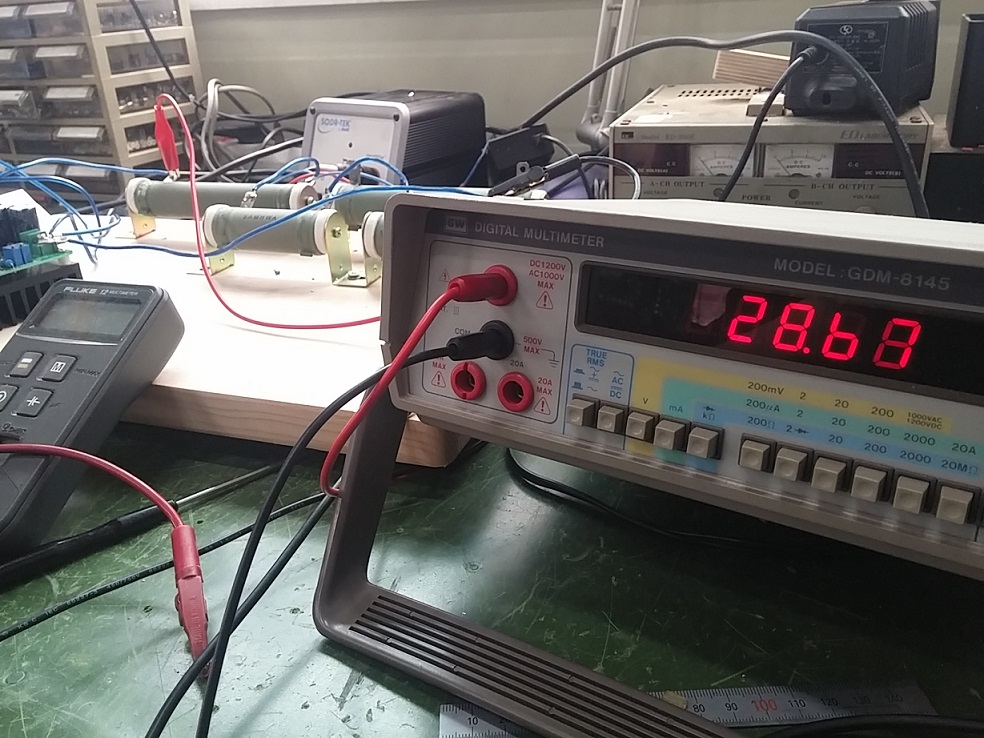

I've been watching the ripple and found that the readout is unstable. I tried other multimeter that I have and it seems that the ripple is not good..
29mV. after the converter with FET filter
17mV after the converter with FET filter + 47000UF
