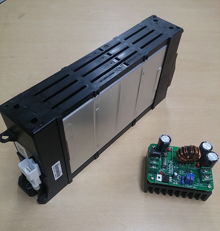

As you saw already, I am not getting that <10mV. Now it is 16mV with FET filter and 47000 UF cap. In my test setup the ripple from the SMPS is 70mV and after DC DC converter it is doubled like 140mV. After the FET filter it is around 20mV, with 47000UF added I see 16mV.
I kept the test setup on all day long and I now hear the noise from the SMPS itself. :( But I am building this amp and will try this supply first, I hope in the mean time someone find and share proven linear supply solution.
The wire wound resistors are 10ohm 100W+ 4ohm 50W + 4ohm 50W, total 18 ohm at 60VDC which makes 3.3A. At first I saw the smoke from the resistors after buring up some of the coating materialfor about 5 minutes (?) they are now OK. This is from my Son of Zen experience. :D It does not look safe but this WW resistors are OK to abuse as a dummy.
We talked about battey for this amp.. Well I have this 30V 15A Li-ion(8 of 4.2V 15A cells in series). This is a surplus from a canceled electric car project. But I cannot get them anymore. 4 of these can make two channel supply and give you about 4 hour listening? But managing these batteris with balanced charging, etc.. could be bigger project than normal linear supply with big caps........
