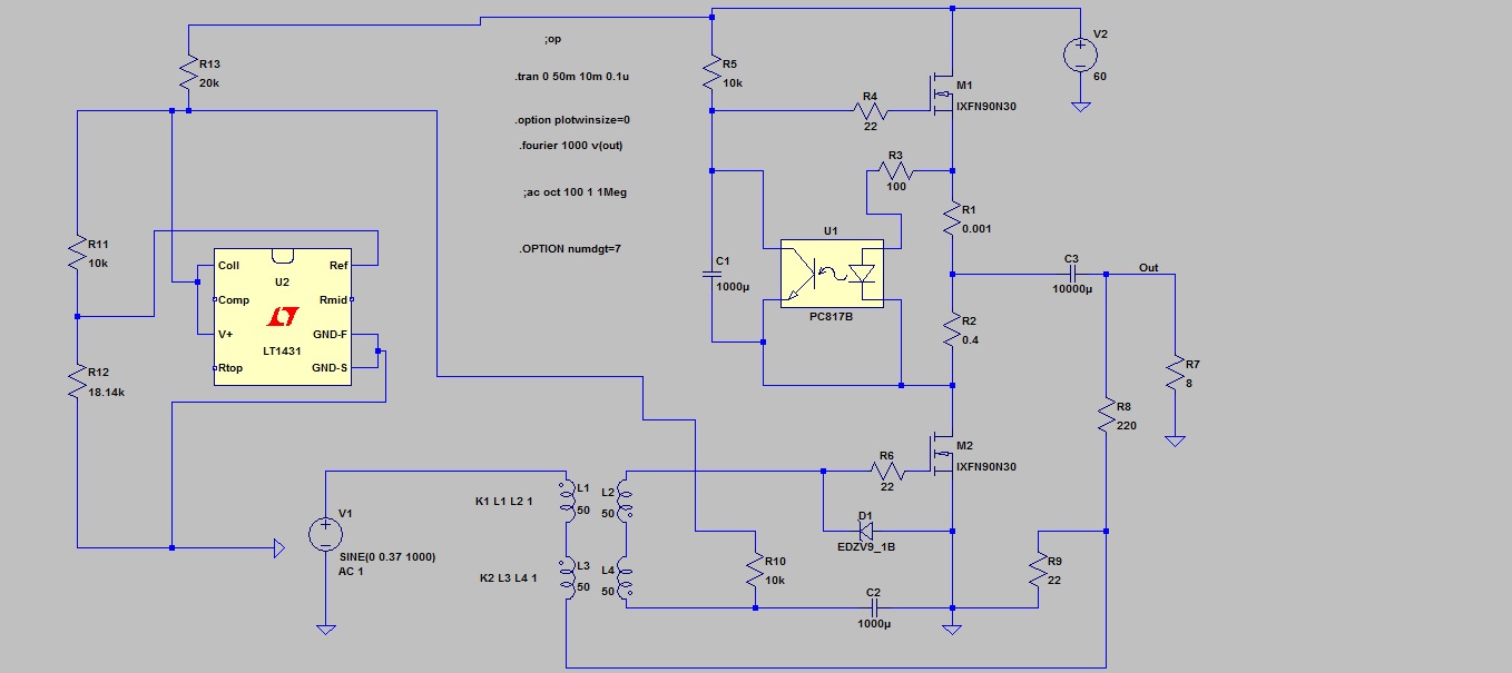

Don't know if Nelson has been waiting for us to get off our fat lazy *****, but here is what my brain can put together. It works completely fine.
R12 is a trim pot. It might be best to convert R12 into 10k resistor + 25 Turn 10k trim pot. You need very fine adjustment.

Why the very low source resistor of the upper MOSFET?

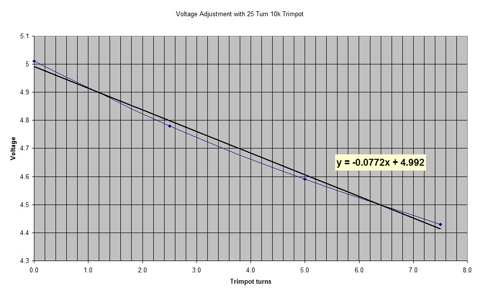

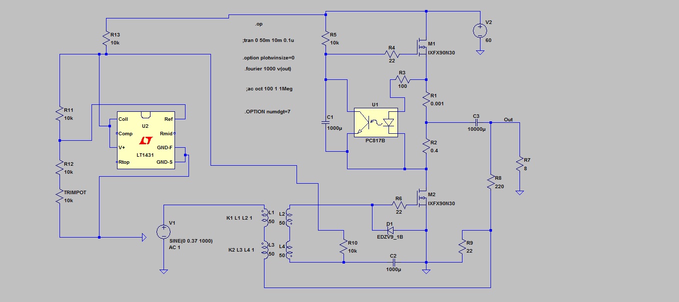

Adjustment with 10k resistor and 10k trimpot.
In my opinion 0.08V per turn is not fine enough, these suckers are super sensitive. I think we need to shoot for 0.04V per turn.
Change to 25Turn 5k trimpot
Just fooling around with Nelson's ideas. I would set it up with 0.2 and 0.2 as originally shown.
I just forgot to change it back to stock configuration
In my opinion 0.08V per turn is not fine enough. I think we need to shoot for 0.04V per turn.
