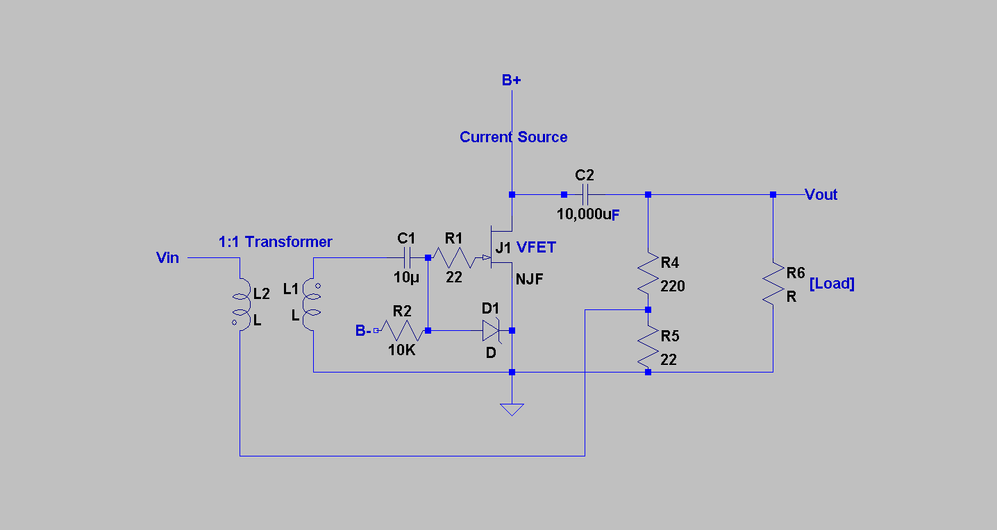

The attached and simplified schematic was shown by Mr. Pass at BAF 2015 using IXN....Mosfet; except a VFET is used instead. It "Schades" a solid state triode. Is there added value to this approach [though redundant!], and/or can too much of 'triode'ing" be detrimental to sonics?

Papa's amp is setup for push pull up to 2 x bias. The top device acts as a source follower it's not your regular ccs.
Edit: I think I misunderstood what you are trying to discuss. I'll think about it.

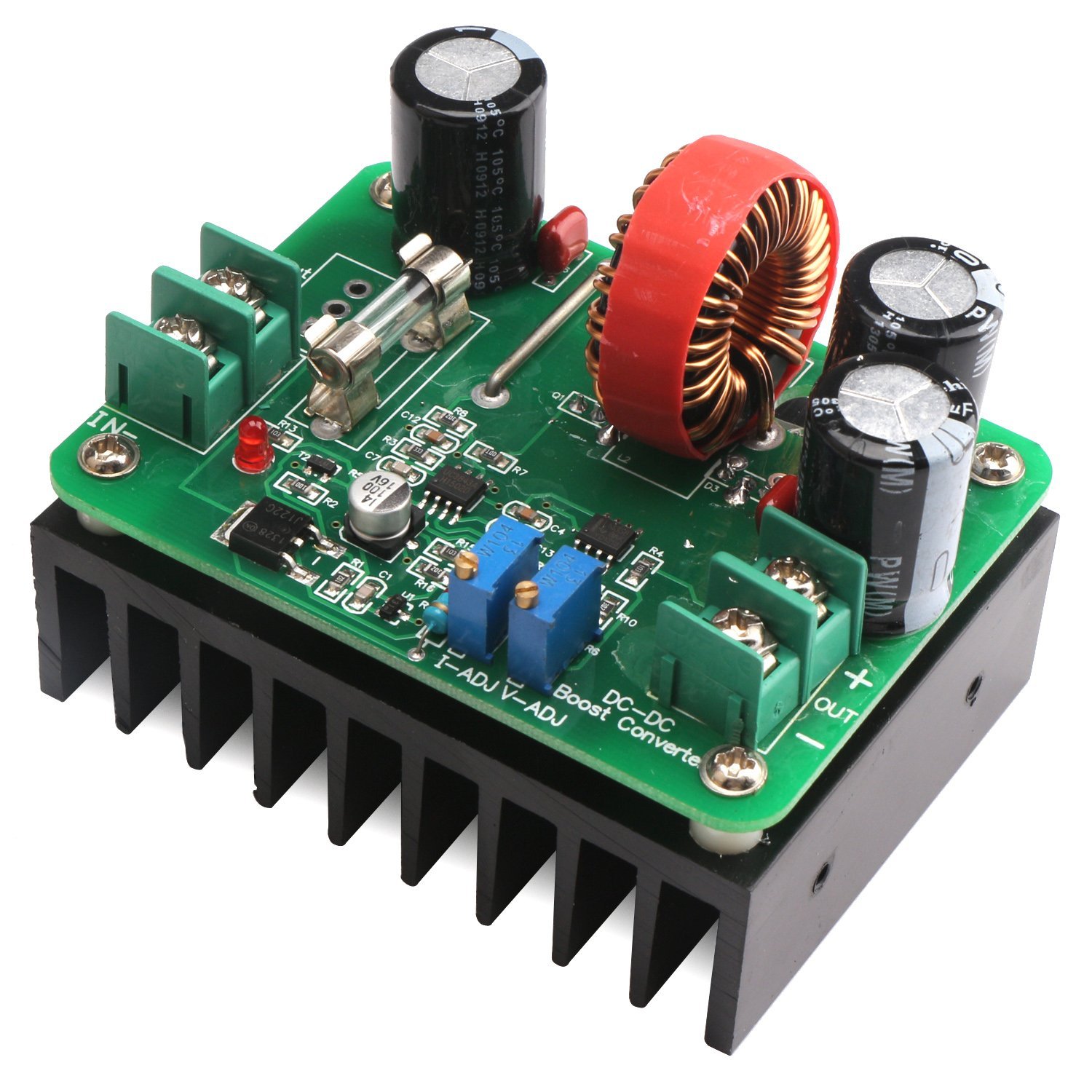

Here's a much lower cost alternative to a 60V SMPS, and may well be worth doing an A/B with a linear supply.
Siemens SITOP 24V 20A industrial power supplies on eBay can be had for around $100 each. These are very well built units for use with robots. I use them to drive my DC motors and they run 24/7. The best thing about them is that they are fanless. No noise, just heat. The not so good thing is that its ripple spec is at <200mVpp. To step it up to 60V rail voltage, just use a DC to DC converter. I found one for $21.66 on Amazon, with a purported 600W rating. It looks like it may even work as advertised: here's a YouTube review: https://www.youtube.com/watch?v=cUpJs6Z41YM.
So for $250 plus PS caps, this may be a good SMPS solution. The unanswered question still is: "but will it sound good"?

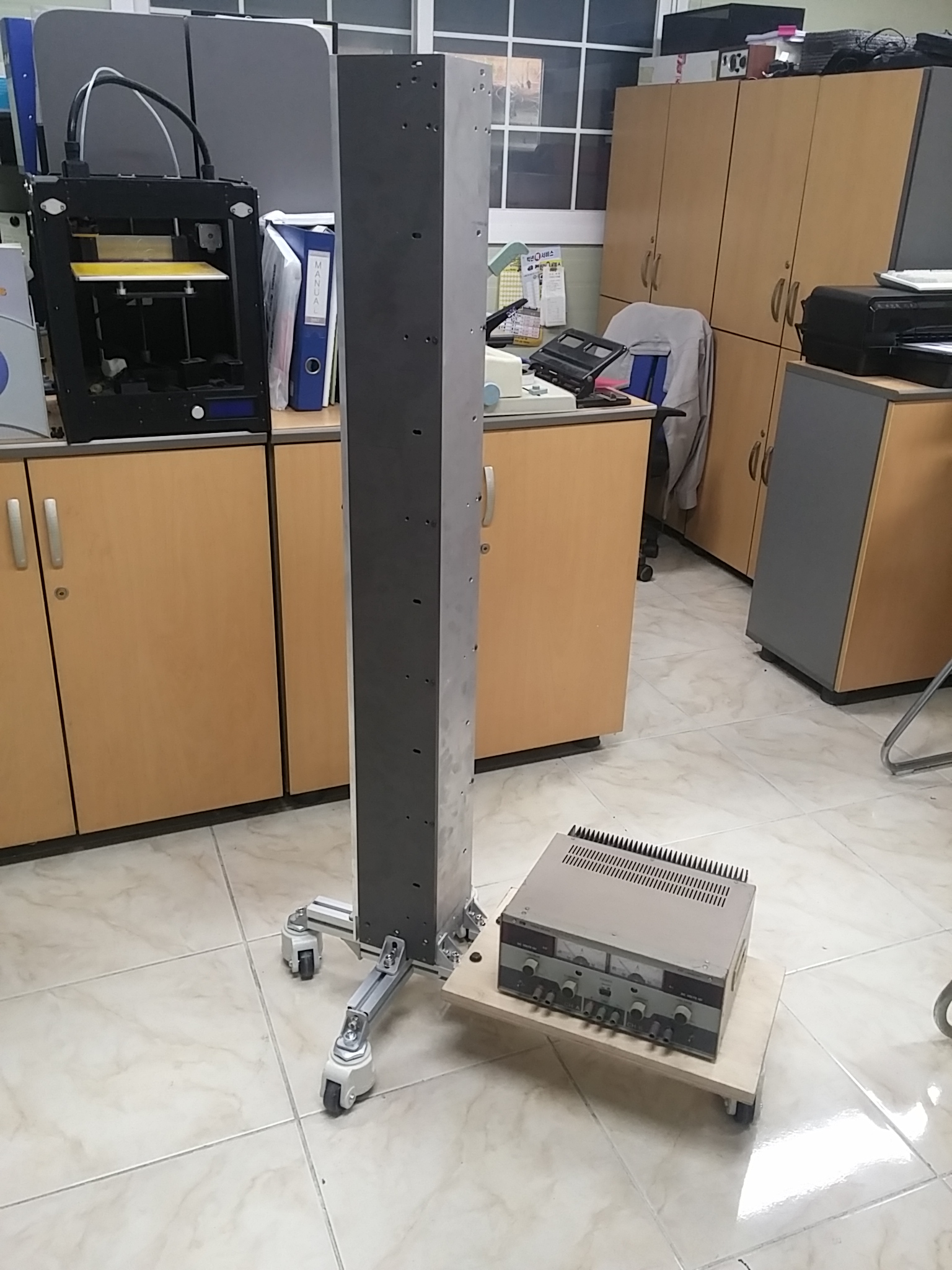

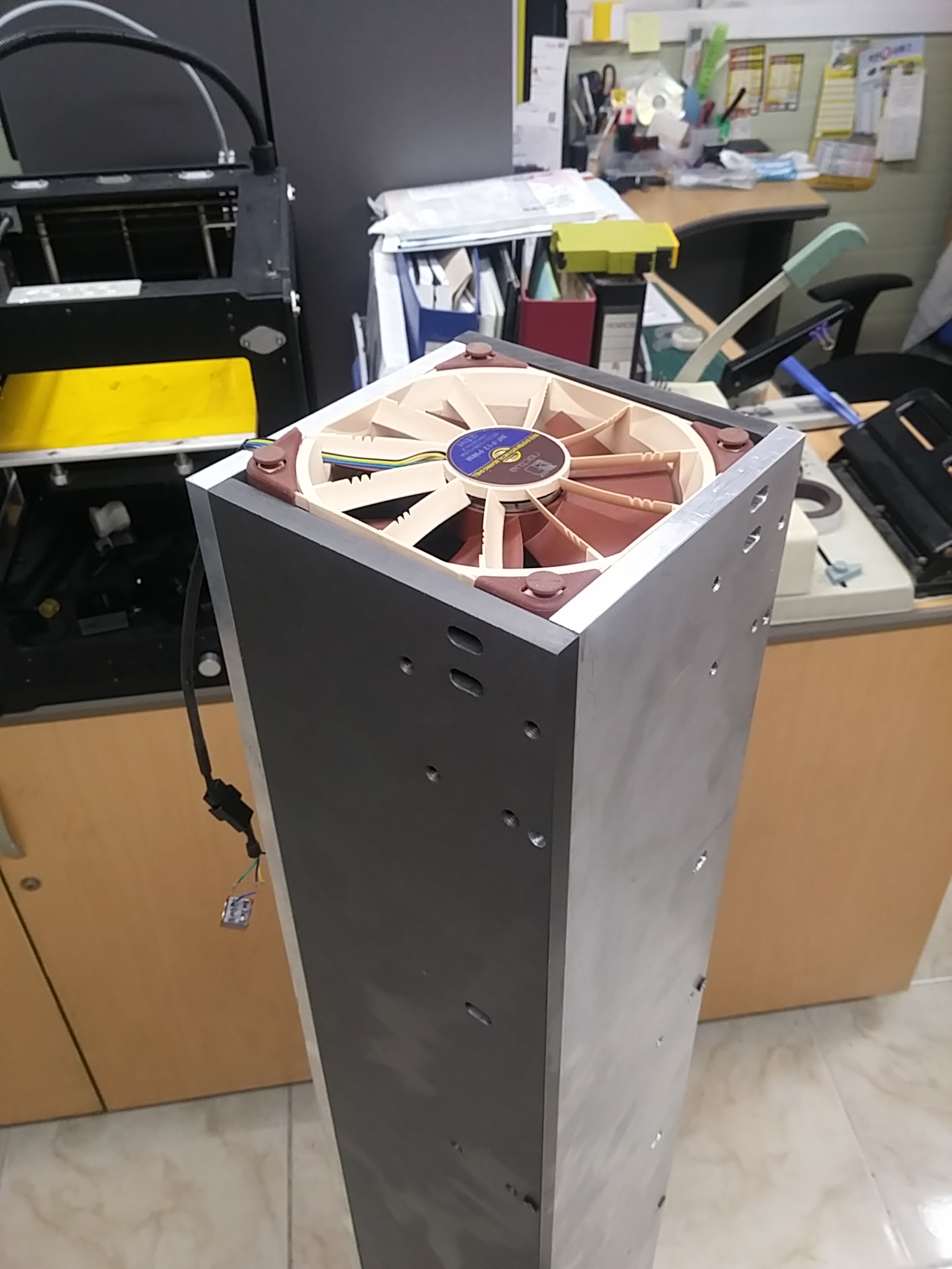

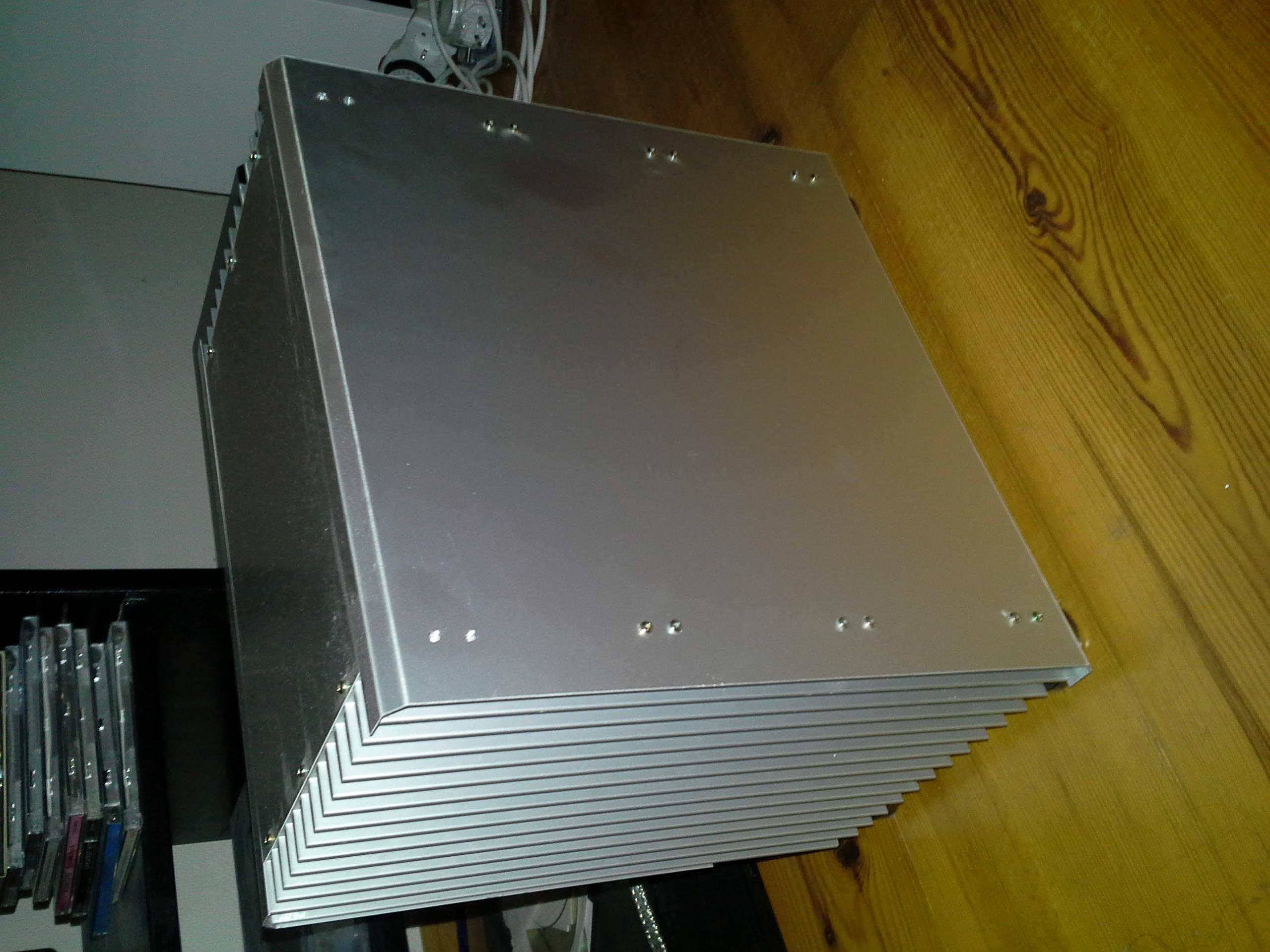

Hi all,
I have the attached case ready, with Noctua fan of right size and heat sinks to go inside the square pipe. I used this pipe for F6 for some days and it was more than enough.

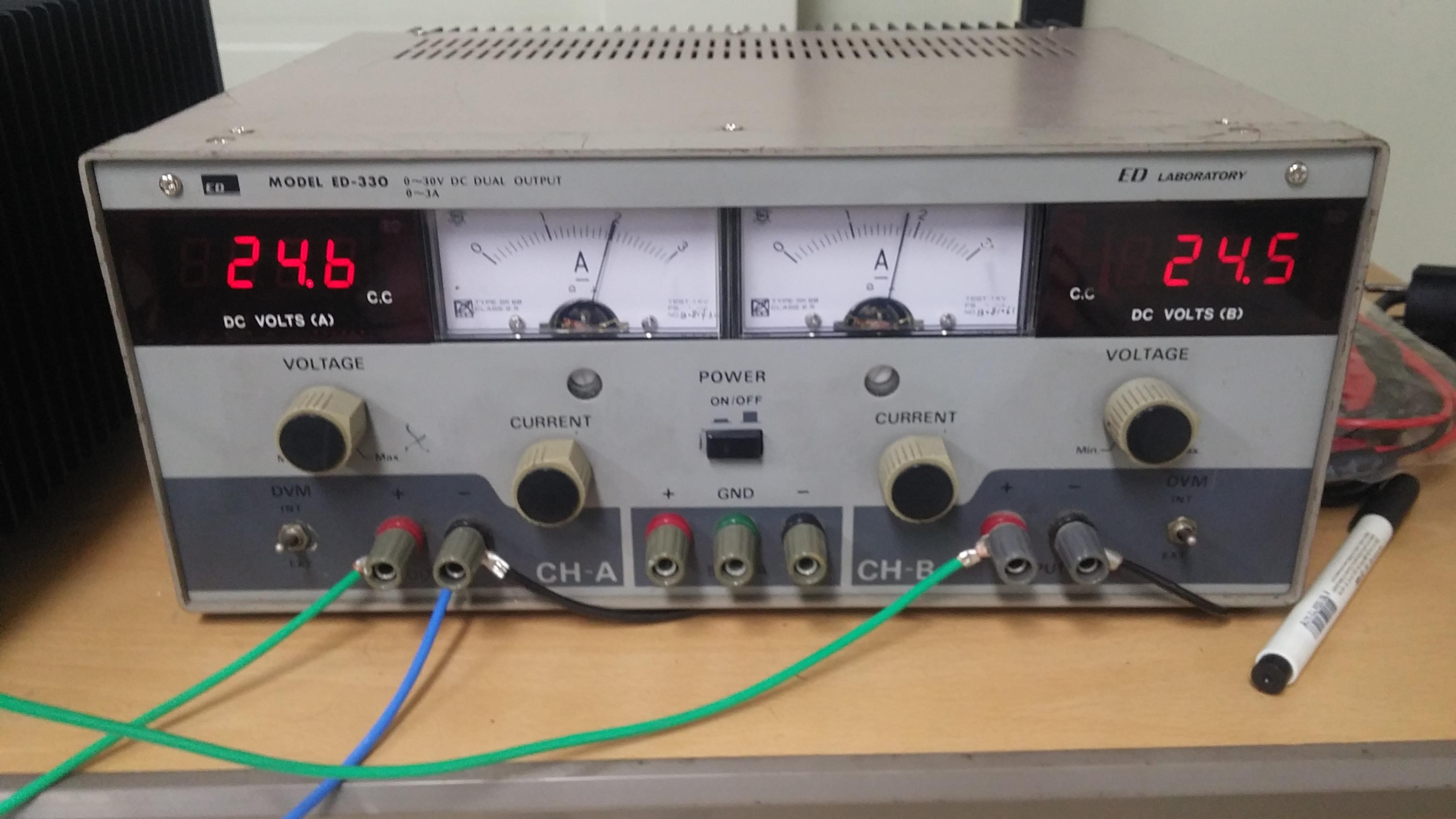

I have two power supplys that have two adjustable 30V 3A and in series can make two 60V 30A, just short of 3.2A. FETs are cominig soon from Mouser I am open to the suggestion of power supply.
I also have two 48V 16A SMPS which can be used with DC-DC converter that ci11 suggested? These can even go inside the pipe(120mmx120mm internal).
So help me try this amplifier cicruit with power supply idea. 🙄🙄🙄
