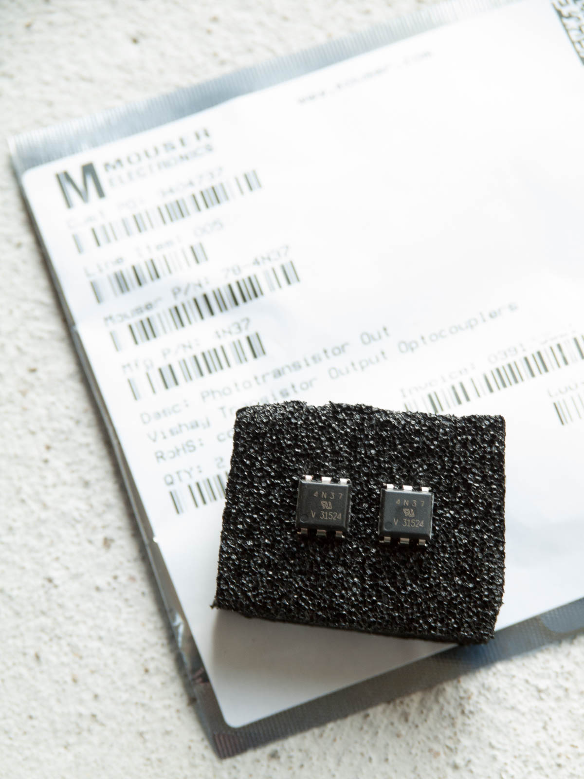

But what type of 4n37 ? There is a few types to chose between.
Any suggestions ?
I already have transformer, electrolytics, resistors, heatsinks...
Just the optos and the transistors missing !

Here is a picture of the 4N37's I got from Mouser, these are the only ones they sell.
