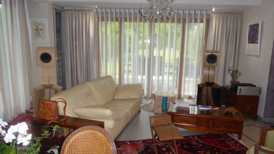

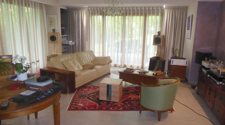

I use my Omega ripole mostly with my pair of MAGNEPAN SMGb speakers (efficiency 89dB/W/m), those beeing driven by a small McIntosh MC7100. The sub module I installed in my Omega Ripole is an ATOHM S-250 (class D / 250W) with its integrated low-pass filter set at 40Hz (minimal FC setting) @12dB/Oct. setting (instead of 24dB/Oct. setting).

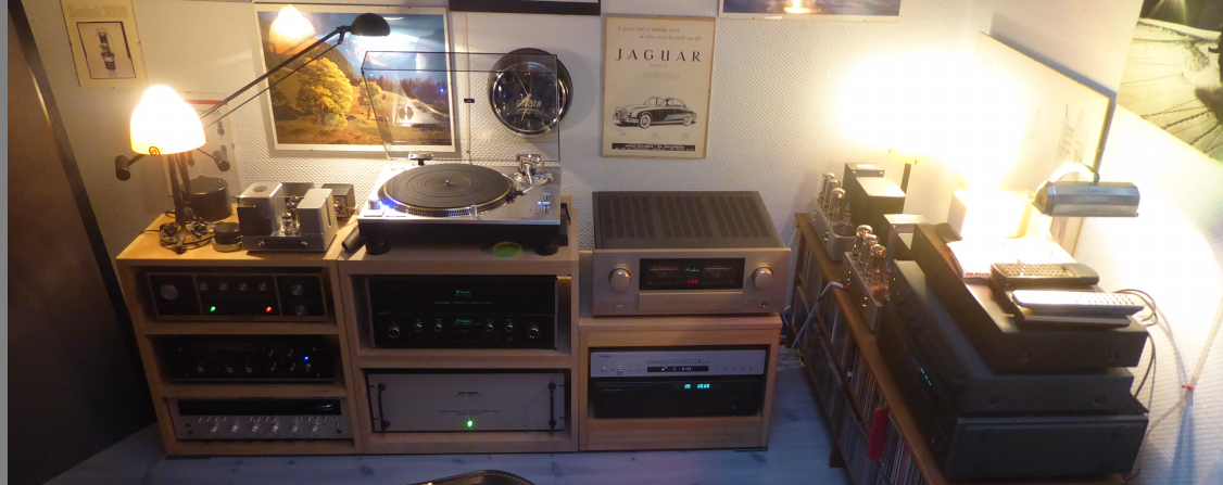

View from the listening position :
The rack - the MC7100 is under the turntable, with C712 preamp :

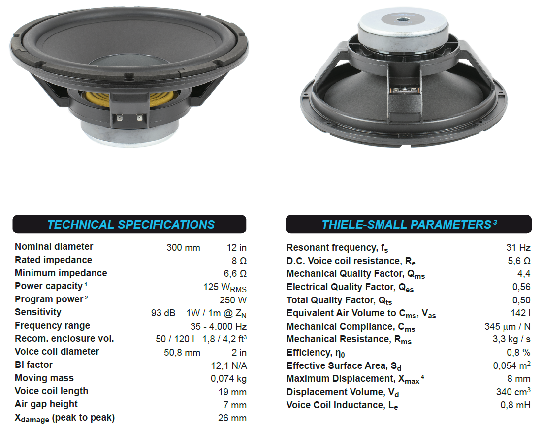

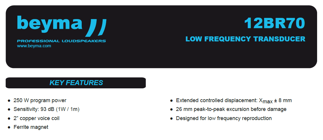

In terms of measurement, I only searched if the Ripole claimed resonant frequency minoration of "at least 10Hz under the speaker FS" was true or a legend :
Well, it's not a legend, given that the BEYMA 12BR70 speakers that I use resonates at 28 and 29Hz respectively. Below the level out of the test amp which drives the Omega ripole in RMS Volts under 4 ohms, and the matching resonant frequency obtained. In mV is the signal feeding the test power amp :
At 17Hz, the power driving the speakers was (4.68)²/4=5.5WRMS, and it was a very comfortable level, where you can think of turning down the volume after a while. Seated in front of my bench, I could not tell from where the infra bass sound was coming, no boxyness, but it was all around me, despite I was facing the Omega ripole, hence my term "floating"...

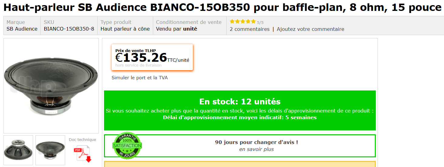

It's probably the right path to follow... In this case, a pair of SB Audience 15OB350 would be good candidates, at an affordable cost. At least, that's what my friend and I would choose for a 2x15" ripole.
https://www.sbaudience.com/index.php/products/open-baffle-drivers/bianco-15ob350/
T
@tubelectron Thank you for your reply.
The 18" look good but are way to big unfortunately. I might squeze in one 15". But not two.

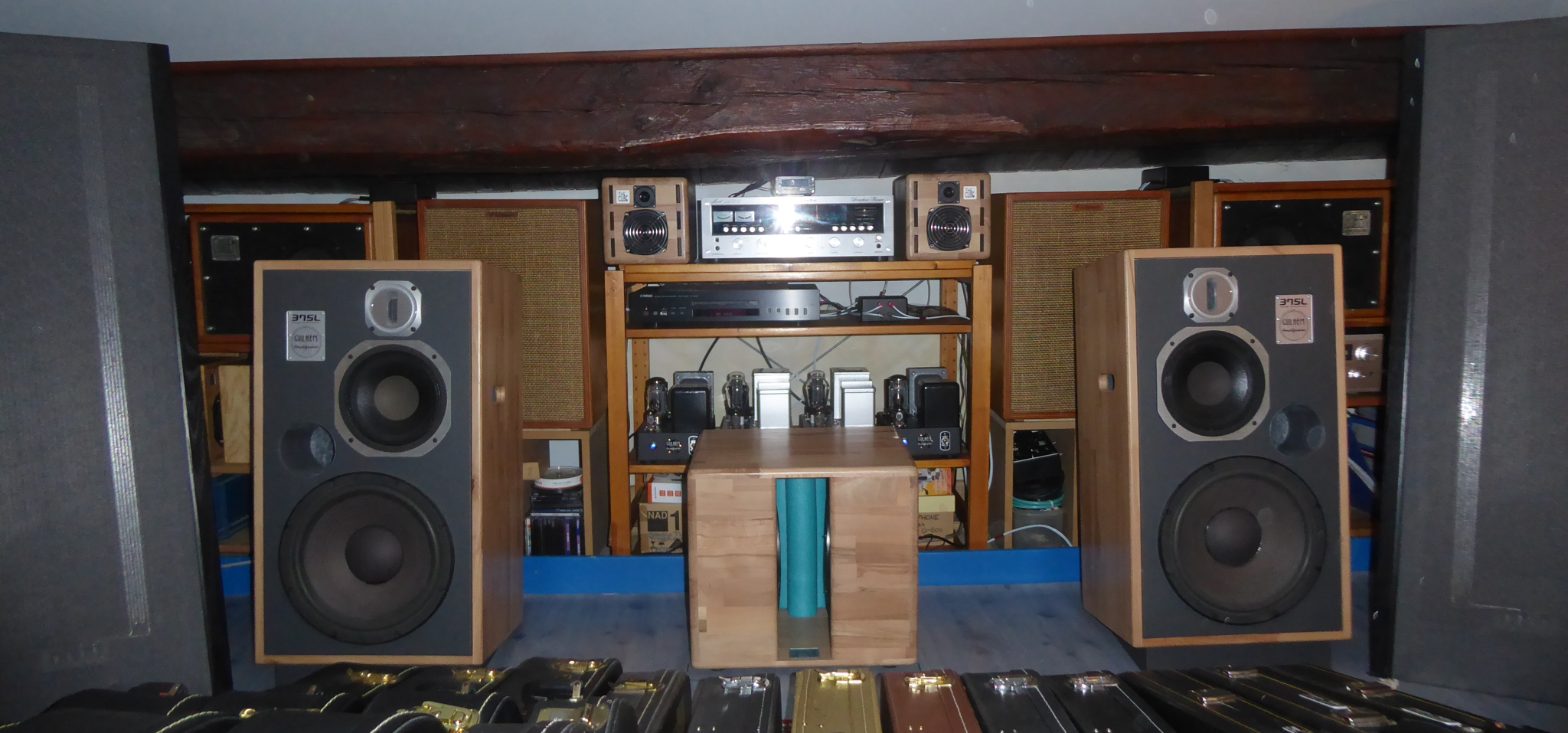

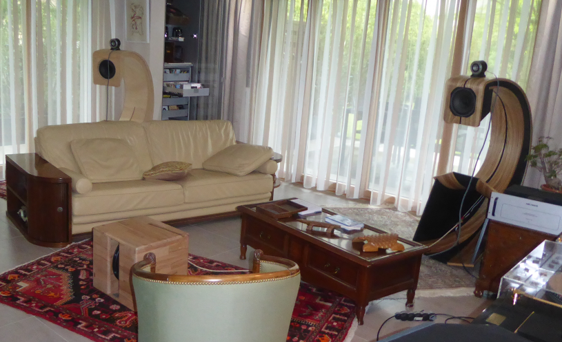

Aha @hjo : you use Open Baffles... That is to say a similar acoustic behavior as our MAGNEPAN speakers : plane baffle radiation.
You certainly know that Magneplanars (and Electrostatics) are considered touchy - not to say difficult - to associate with a subwoofer. This is what we experienced, my "Maggies Pals" and myself. I would not be surprised if Open Baffles obeyed to the same idiosyncrasies !
Below, the large Auditorium of one of them, a Real Maggie Afficionado : Tympani IV, MG3.5, etc...
He had two large MAGNAT 15" subwoofer but finally sold them for matching reasons. When we experimented my little Omega Ripole and its mere 2x12", indeed we could hardly sustain the high loudness of a demo... But at moderate levels, the "deep floating infra-bass" was there, unobtrusively filling the room, matching the planars sound...
And this is where the Ripole principle came to us "as a Savior" : the radiation pattern offered by the Ripole marry very well with the planars, statics and certainly OB speakers. My "Maggie Pal" here will opt for a 2x18" Ripole, to be large enough in loudness, custom built by one of his friend carpenter and cabinet maker.

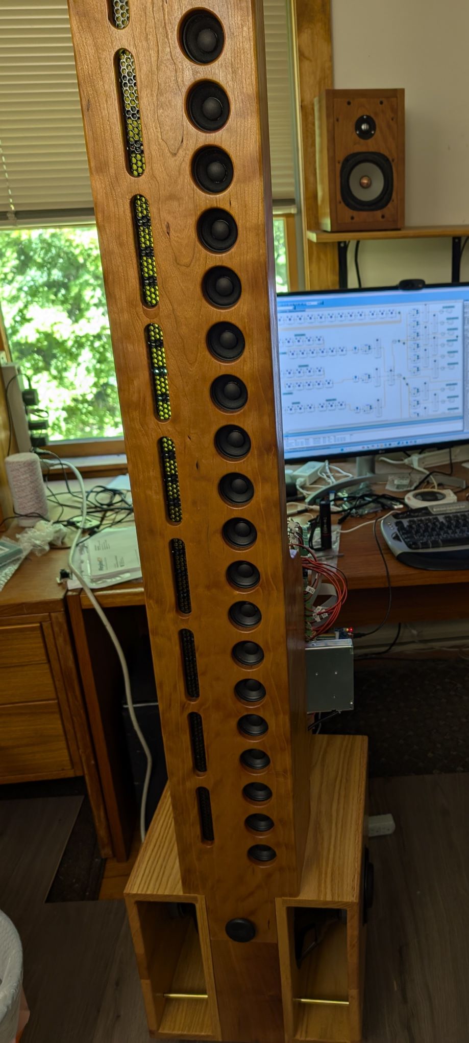

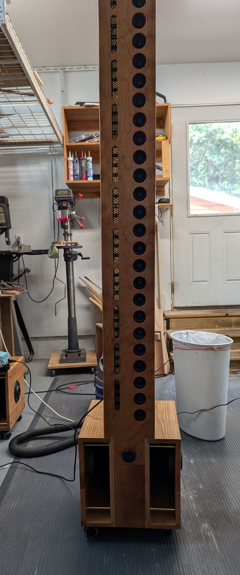

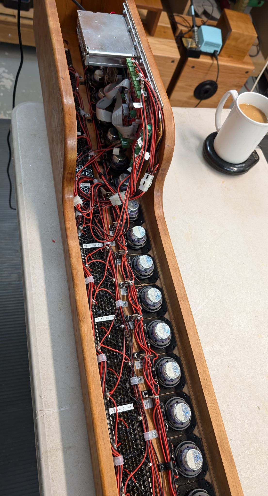

Yet another ripole. This line array is still getting worked (lots of software and lots of problems), but so far, the ripole portion sounds very good.
@Neil Davis thats a rather impressive array. I considered an array, but found it to much for my abilities. I love the dynamic of the multiple mids.

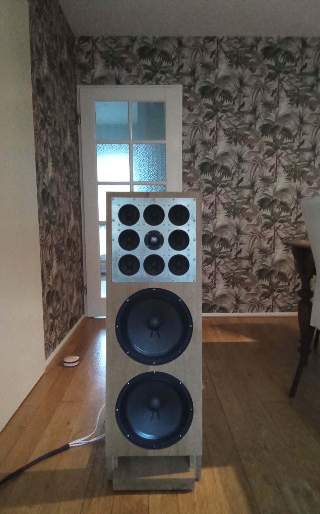

I went back to my mid-range array from the speakers for inspiration. Multiple drivers spread the load. Fast for dynamics and enough power.

That's encouraging. The Xmax of the drivers I'v seen is 10. With 22 as final. Just under the specs of the 18 and 15" Bianco's but better than the 12" OB 12ob150. Or the Visaton from the grand orgue. The sensitivity is lower, 91db. That might be a problem.
Quality might be the point though.
https://stx.pl/en/w-22-200-8-mcx-v2.html
I'm going to the drawing board..
Regards
Regards
Those STX have a really low Fs for an 8" driver!
A note of caution about Xmax--different manufacturers vary in how they list it. The STX's 10 mm is peak to peak, while I'm pretty sure the SB 15OB350 is around 11 mm one way. Or at least, that's how I read the datasheet! Would be nice if there were one standard. Also, depending on your needs the difference in power handling might be relevant.
I'm assuming you're rolling these off around 50-60 Hz so that cavity resonance won't be an issue?
@dayneger
The STX specs state:
Max. linear excursion - 10 mm (p-p)
Mechanical displacement range - 22 mm (p-p)
And the Bianco 15 and 18 approximately
Xmax ±10.93 mm
Calculated Xmax ±10.94 mm
Xvar, Xmech, Xlim ±30 mm
My wishful thinking is that the Mechanical displacement range is the Xlim.
But the p-p is new to me and disappointing. Thank you for the warning..
Yes, they will roll off at 50hz. So I don't think resonance will be a problem. Maybe some reinforcement in the chamber.
But I have to reconsider with the xmax....

Below you can see the distance at where my Omega Ripole is placed in my little auditorium (in the center lower) :
The distance of the back of the Omega Ripole is 20cm from the IKEA rack-shelf, but that said, it's not a wall... Wen we tested it at my friend's living room with his MAGNEPAN MG2.5, the distance from the back bay window was 50-60cm, and it worked fine.
If it is a similar design to my MICRO Ripole, 10 to 15cm from a wall would be fine.
