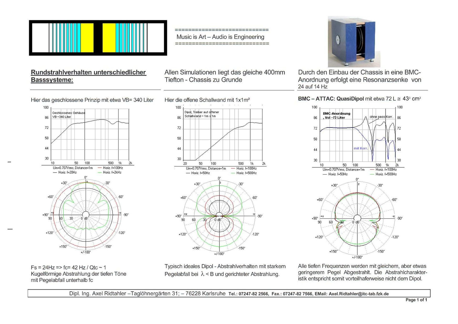

Here's an interview of Axel Ridtahler, published on the lautsprechershop.de website. Notably, Mr. Ridtahler describes the radiation pattern of the ripole principle, and its advantages on the bass coupling with the room :
The best explanations on Ripole subwoofers operation, given by the inventor himself... 😉

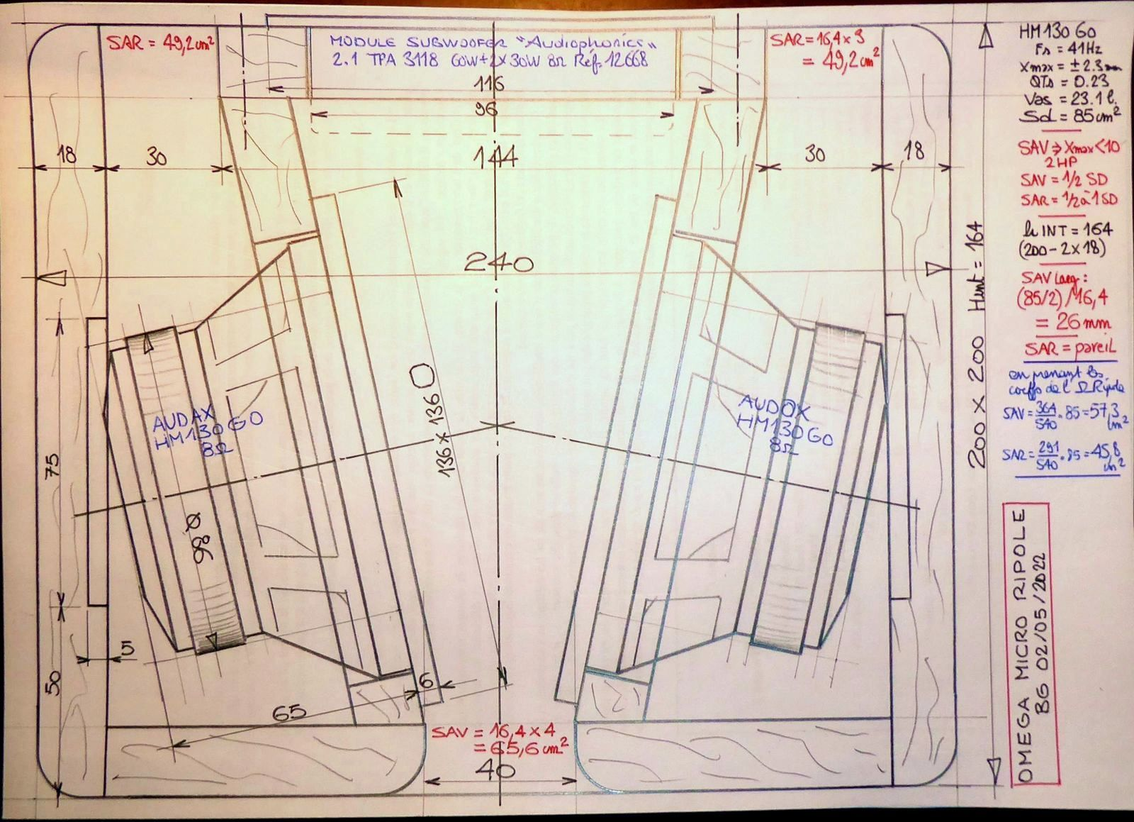

Here are the dimensions of my MICRO Ripole (mm). As you can see, it was very compact :
And it would have been a cool project, indeed, if not ruined by that poor and lousy performance LPF micro sub module - to avoid and discard, despite it had the perfect size... 😡 🙁
I know that a few years ago, a member on DIYaudioprojects followed my footprints by building a pair of my MICRO Ripole design, with a 3-D printer (yes !), and he told me that he met the expected success, because he had an external active Xover in his system, set to compensate the LPF flaw of the micro-sub module.

The problem with Axel's explanation is that the RiPol, (or "W Frame dipole") or whatever you prefer to call it does display the same radiation pattern as a dipole in the subwoofer range of operation.The best explanations on Ripole subwoofers operation, given by the inventor himself...

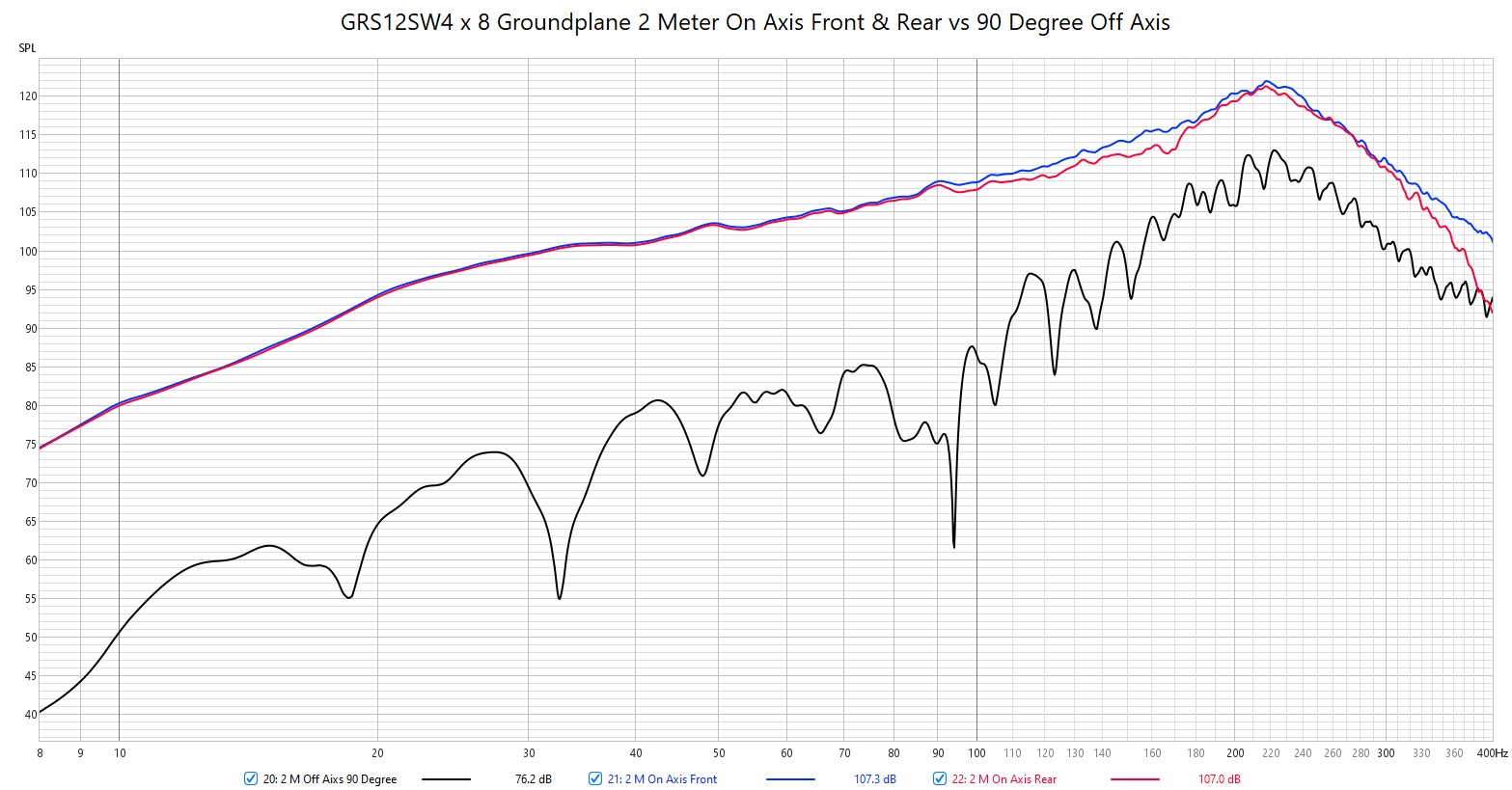

This can be clearly seen in MalVeauX outdoor measurements, the on-axis front and rear radiation of his subwoofer is virtually identical below 100Hz:

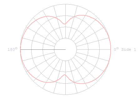

The 90 degree off-axis reduction in level show the clearly defined dipole RiPol "figure of 8 pattern".

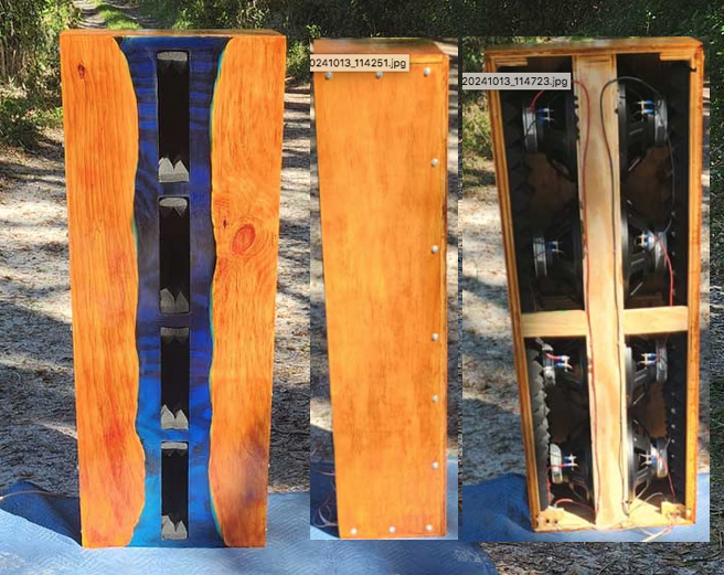

Perry Marshall's Live Edge Dipoles inspired me to study them with the aim of developing my own variation on the theme. To do so, I had to develop Vituix models for the dipoles and for the Uframe, which I'd like to share. Perhaps someone can compare model predictions against their speakers.
Dipole modeling in Vituix is well known but running the model made clear that with dipole coax drivers, the coax mid woofer cone was being used over a much wider range than done in multi-way open baffle speakers and that there were consequences to that.

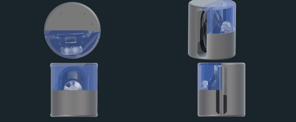

Having recently seen @tubelectron's micro and miniripole designs, it inspired me to play around with different variations to pair with my son's future bookshelf speakers, which are expected to be Zaph ZA5.2s (thanks for the midwoofers, @mordikai!) that could benefit from support below 80 Hz. I'm not looking for high SPL or shaking the whole house, but playing down (to ideally below 30 Hz) at modest volumes would be pretty sweet.
I'm swinging from cheap and cheerful to slightly better but still inexpensive drivers arranged in different ways. It seems that a downside is that...
Below, we have a comparison of a Sealed 340L, 1m² Open Baffle and 430mm cubic Ripole configurations :

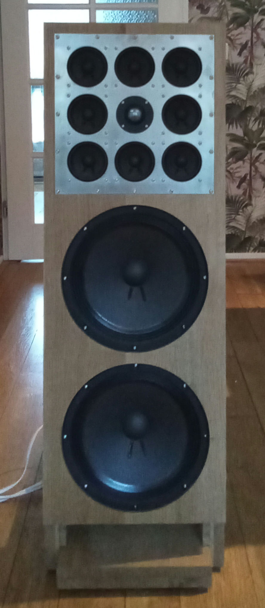

@hjo, to give you an idea about my Omega Ripole 2x12"
This gives the following ratios :
T
- one BEYMA 12BR70 speaker has SD=540cm2
- the common front opening is SF=364cm2
- one of the two back openings is SB=262cm2
- common front opening = 364/(2x540)=0.337 combined SD, so roughly 1/3
- one back front opening = 262/540=0.485 SD, so roughly 1/2
T

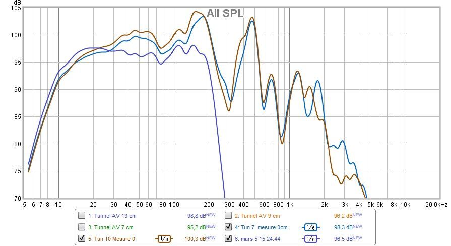

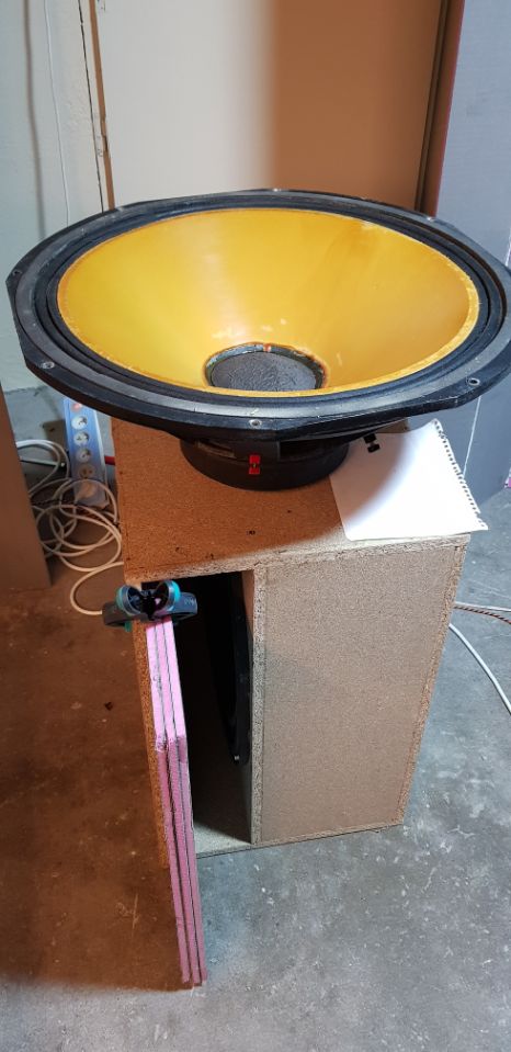

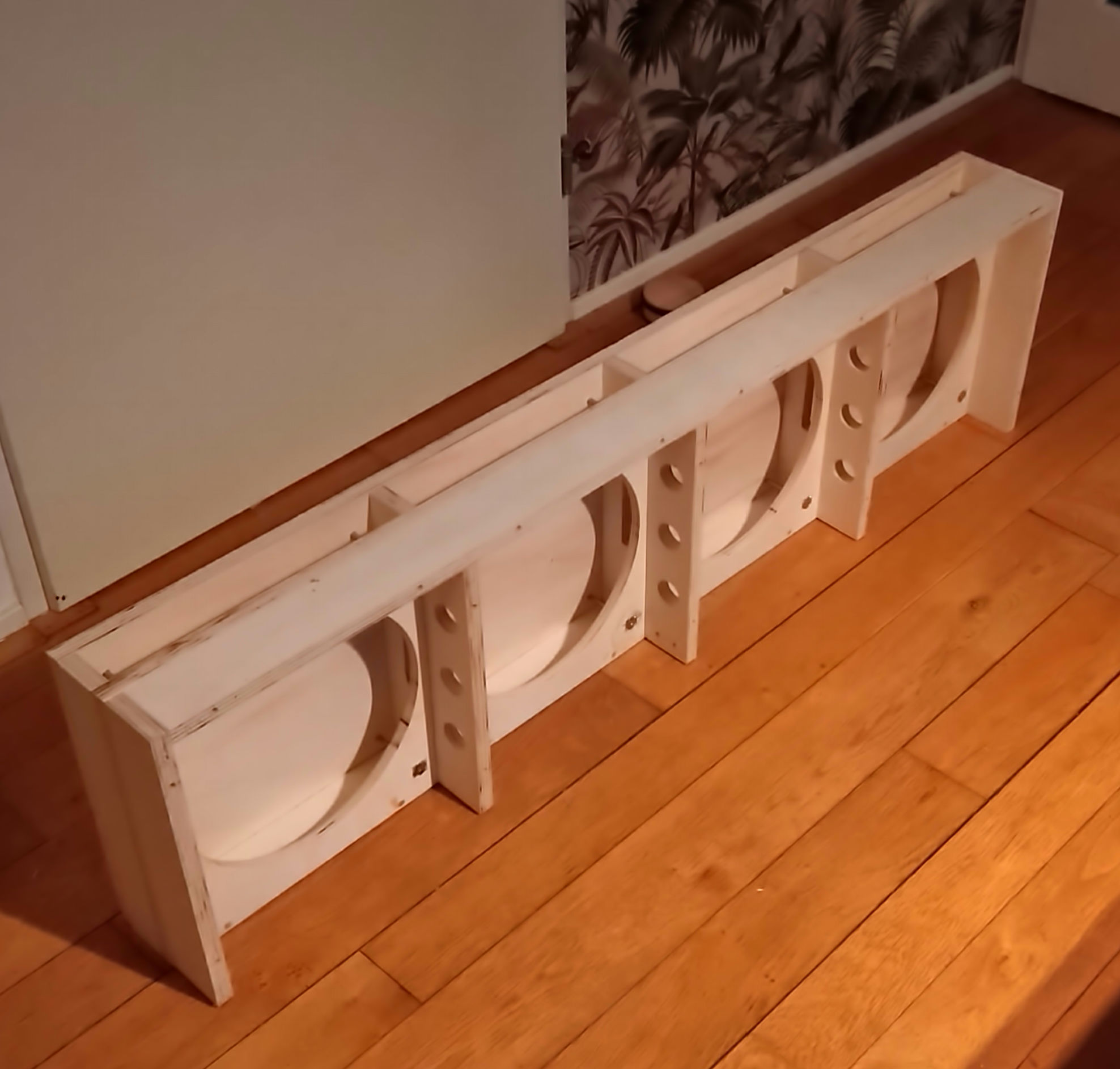

To verify this theory and optimize the dimensions of my Ripole, I built a prototype. I made measurements with the outlet reduced using rigid plates (in pink). Here are the curves for an opening varying from 7 to 13 cm here 7 and 10. The size of the outlet is not critical, unless we exaggerate. In blue, the curve with correction.

Pressure response and polar directivity pattern charts have been added to the ripole loudspeaker wizard. Post #13,283 refers.

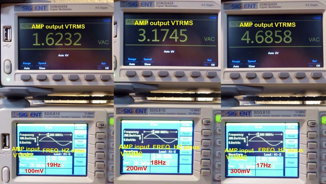

I noticed two points about that, during my experiments :
1 - if you increase the signal amplitude delivered to the speakers, the FS of the whole system lowers a few hertz.
2 - if you reduce the size of the openings, the whole system resonance FS also lowers a few Hz, and the efficiency in dB lowers too. Sorry, no pics...

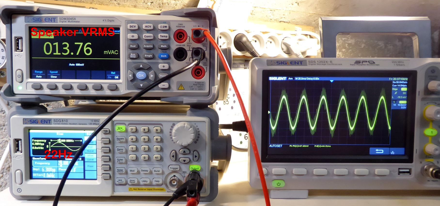

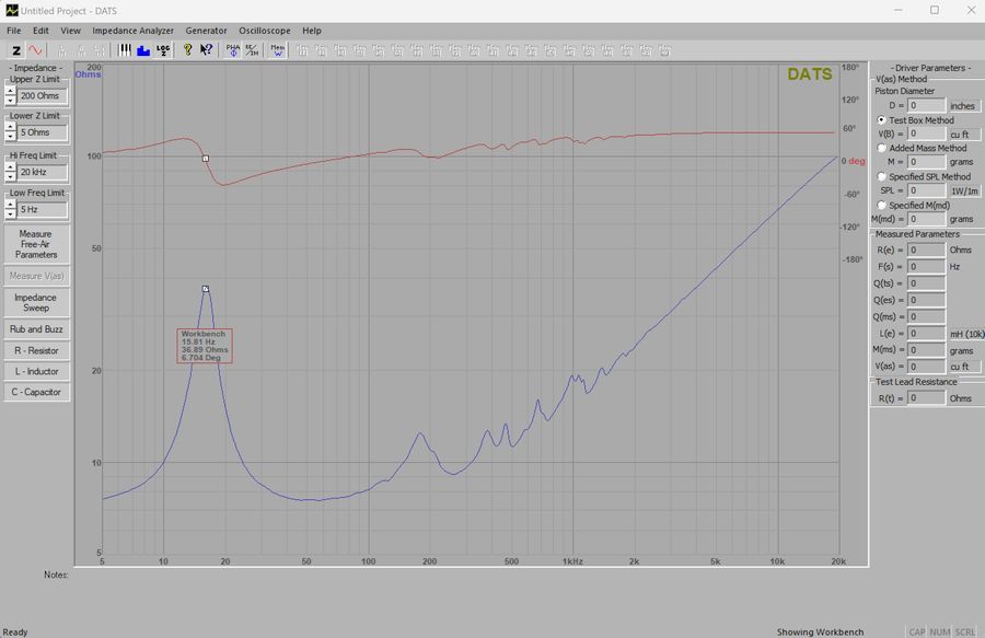

Here is the impedance curve of my Ripole, the resonance frequency is 15.8 Hz. We can see the resonance of the high cutoff at 180 Hz
Here are my TS measurements.
Re = 7.344 Ohms
F(s) = 21.13 Hz
Qts = 0.7007
Qes = 0.7944
Qms = 5.944
Le = 2.723 mH
Mms = 456.6 g
Vas = 503.3 L

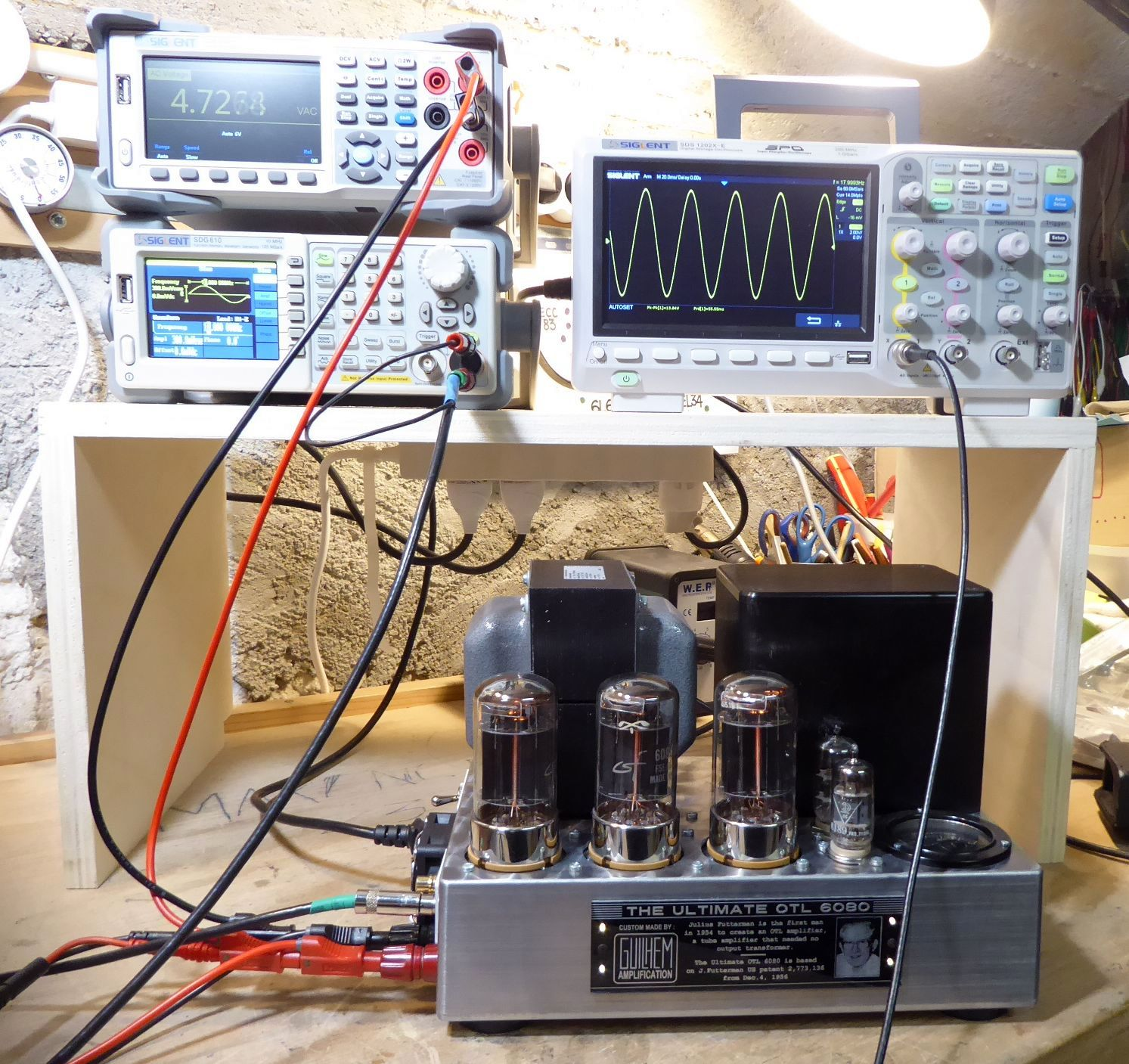

@tubelectron
The variation with the power level is perhaps due to the behavior of the OTL amplifier on an impedance peak, 36 ohms / 15 Hz at my place.

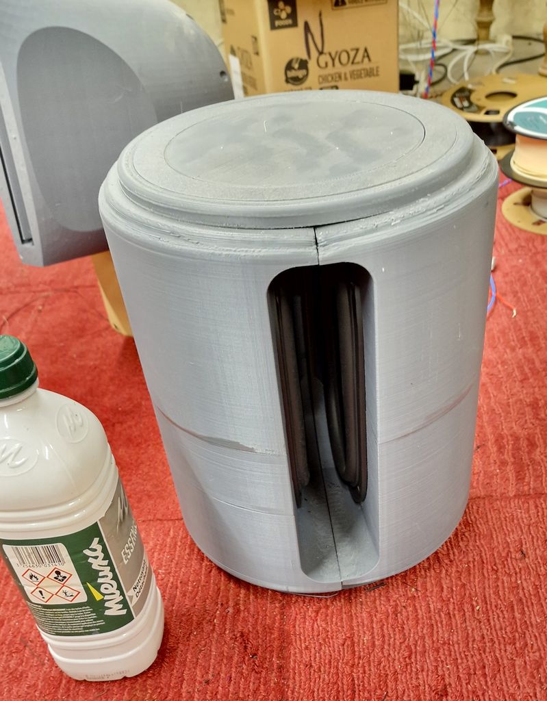

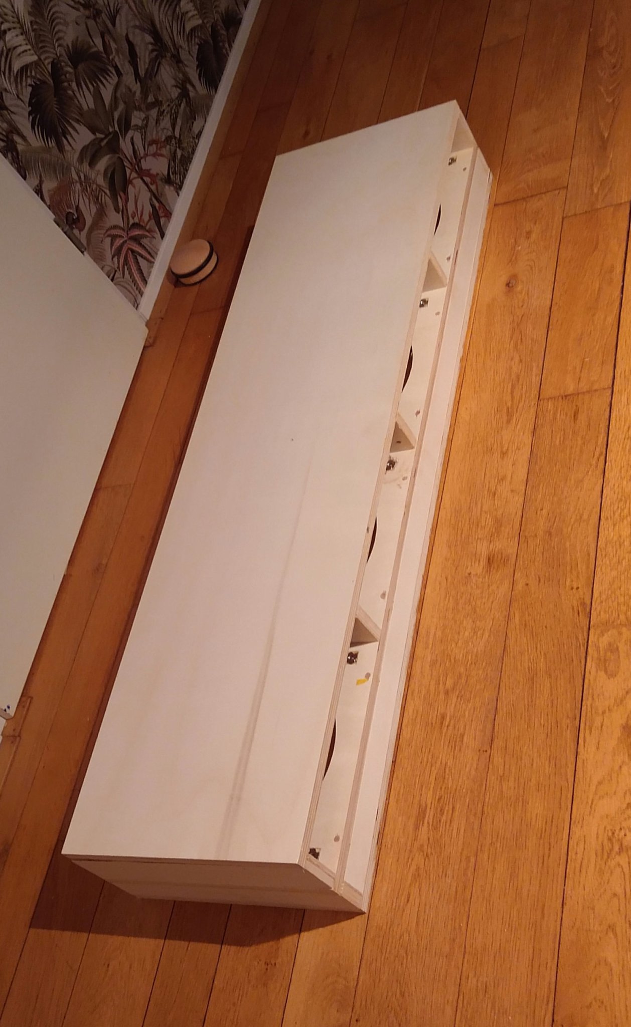

I made a mini Ripole in 3D printing with two rectangular HPs of 15 x 25 cm the SB Acoustics SB15SFCR39.
For the bandwidth, I go well below 30 Hz, but the efficiency is mediocre and if I push the volume, the speakers very quickly start distorting and bottom out for a banal sound level.

It is always idyllic to see things like this and to illustrate my point, I show you one of my completely failed achievements.
On the bass attacks, the rigidity of the speaker is not sufficient, despite its cylindrical shape, and I have unpleasant tonics.
Thanks to their output impedance at 20R, my U-OTL amps simply do not provide the usual damping factor to the speakers, which are then free to move and react "naturally", if I can say so.
That said, It is possible that this phenomenon of FS minoration with the increase in drive level may not occur with "normally" damped amplifiers - say 20 to 100 damping factor at 8R, while here with my U-OTL, the damping factor is nearly nonexistent at 4R/20R=0.2.
I also made a FS measurement at small signals (T/S method) :
For 14mVRMS on the speaker, I check a 22Hz resonant frequency, for the BEYMA 12BR70 spec announcing FS=31Hz :
The serial mesurement resistor of my little Z-Box is 1K, so there's no damping at all here, equivalent to an output impedance of circa 1K seen by the speaker - way over the 20R of my U-OTL.
With only 14 RMS millivolts, the FS reaches 22Hz, the highest FS value with the lowest driving signal...That's why I mentioned that decrease in FS occuring with increase of driving power.
But again, I did not tested here a solid-state amplifier with a factor of 40 to100, in order to check if this phenomenon persists, and it's certainly possible that a higher damping factor attenuate - if not null - this effect.

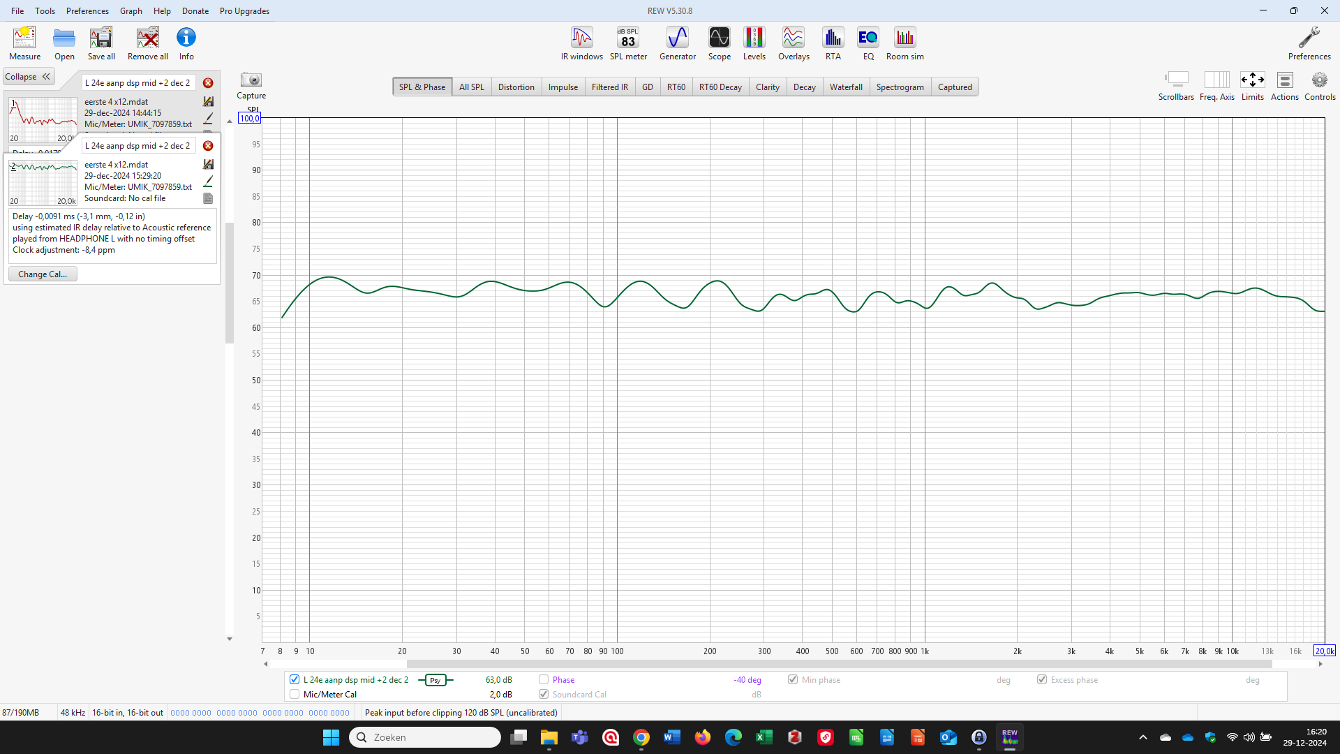

Dear members,
It has been quiet for a while. I'v taken all the advice in consideration and finally opted for a array ripole with 4 12 inch car subwoofers. Because they are very flat with a reasonable high xmax.
Last week I had time to start the build. It is good it will be under the couch. Didn't become as neat as intended.
But never mind, today I got it hooked up and could give it a try.
I'm very pleased with the first results. I need to spend time to improve the response curve.
I post e screenshot. From my listening position in a living room which is far from ideal for a listening room. But that's what it is.
Two pictures of the build. When it is finished I'll try to make a few more.
Everything above 60 hz is coming from these...
Thank you for all your advice!
hajo
