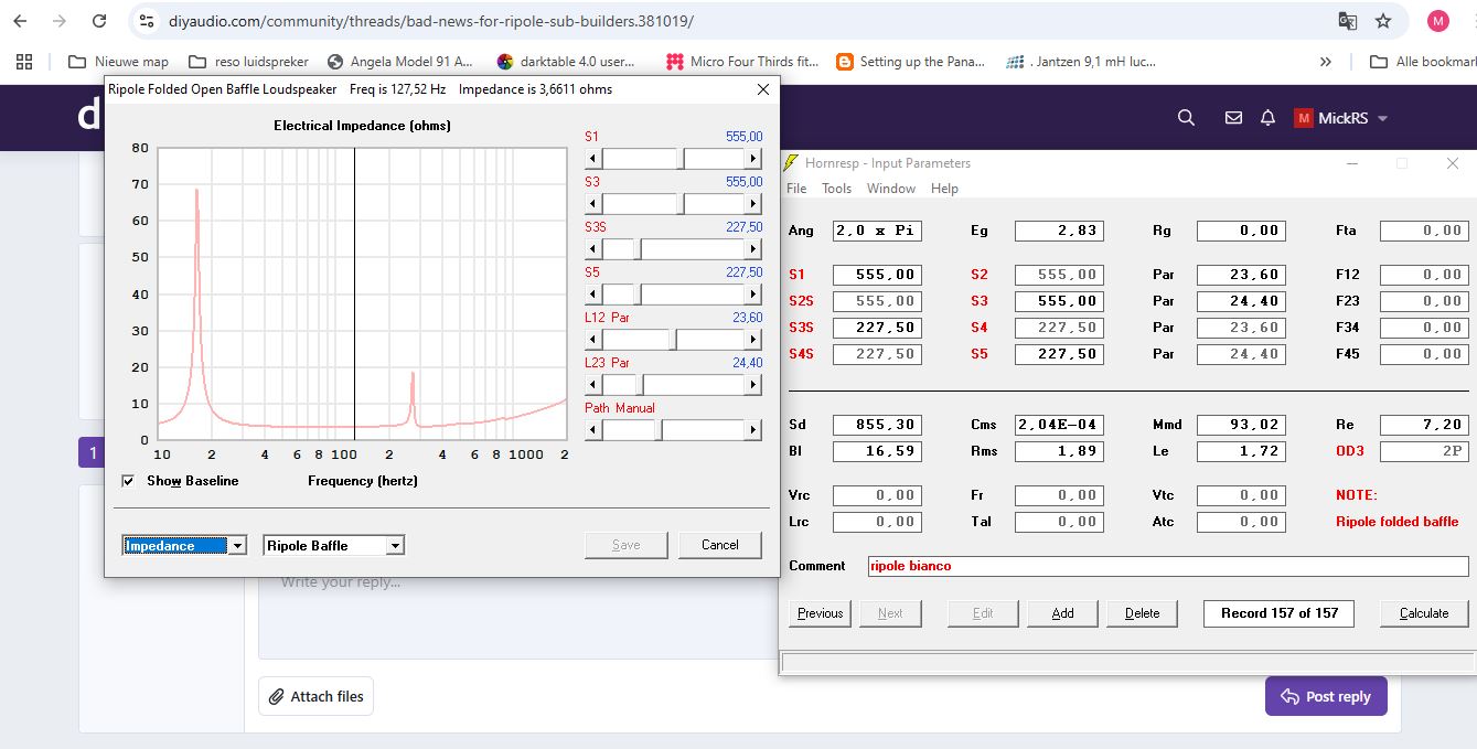

Just a short question about modelling ripole subs in Hornresp. Im playing with the thought of using my 15 inch Bianco's in a ripole. When I use Hornresp it halves the impedance of the driver. Can anyone explain why this is the case and do I need to keep this in mind when I use two drivers in parallel?
When you use two drivers, the options are half (P) or double (S).When I use Hornresp it halves the impedance of the driver.
You make the choice to accommodate the amplifier(s) you plan to use to drive the load(s).

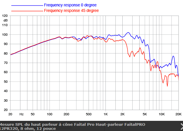

What do you think of that specs, please : Faital 12PR320 ? good enough for a ripole 35 Hz to 150 Hz (or less if resonances) with two units like @CharlieM sub?
Qts 0.38/0.4 / 92/93dB/2.83V at 100 hz / Xmax 7.5 mm / Fs: 45 Hz / Qms : 7.8 / EBP :108. : this is the more real numbers VS the datasheet

Yup, but I have already two 12PR320, that's why I ask. I have a doubt because the Qts is <= 0.40. I don't need too much low end < 35 Hz (no electronic music or organ, no HT).
The Mms is ligth so okay, Qms is within the highisch numbers, so okay. I just fear about too much drop, no flat spl because of the low Qts. I know the number wished is something Qts 0.5 to 0.6. But I wondered if some lived with a ripole with drivers at 0.4 Qts.

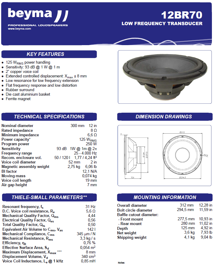

Exactly what I plan to use - did you like them?
I really have no complaint to make about the Beyma 12BR70 : affordable, consistent, ruggered and reliable.
They perfectly do the job in my Omega Ripole :
That said, I do not listen to HT effects at high level of loudness. If it was the case, I would have shifted to 15" or 18" speakers, or a Bass-Reflex enclosure... What I wanted is that deep, floating infra-bass extension suitable to notably reproduce Space Ambient EM, like this, for example :
And my compact (400x400x440mm) Omega Ripole is simply perfect... It combines extremely well with my Magnepan SMGb, naturally extending their bass.
I also choose the Beyma 12BR70 for my 475L ISOBARIC sealed enclosures, where they prove to be fine Woofers too :

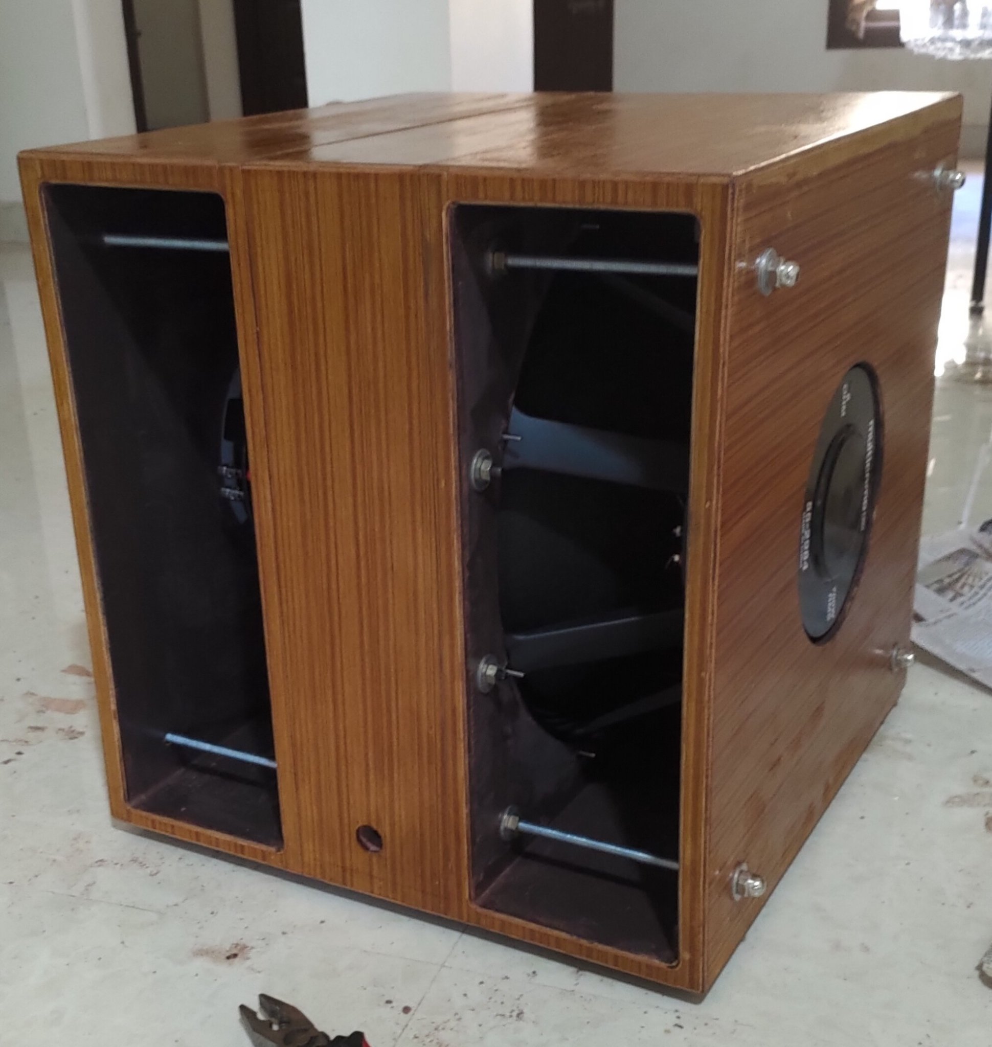

My 4 x 18inch drivers Ripole getting ready.
Had a brief listen. I like it especially below 60hz. Clean, well defined and non intrusive.
Will post more details once I wrap up and give it some work out.
Yes. That's exactly what for a Ripole is designed : that deep, floating infra bass tones... One of my good Audio Friends was seduced by the Ripole principle, after listening to my small 2x12" Omega Ripole. He buid a pair of 2x18" D-Ripoles :

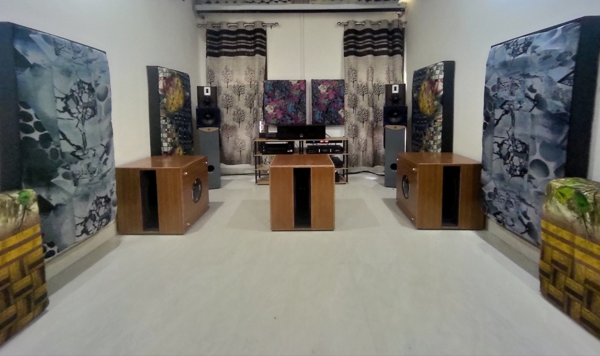

I am so excited as I listen more. I was building this for the planned music room. So for now, I just lugged these into my HT Room and started playing some music and movies. And these are incredible with how the lower register notes are presented even in my congested/small 5.4.4 channel HT room.
The seat to seat consistency(from hearing) is incredible. I hope no more the need of averaging over multiple seats. I will give Audyssey MultEq-X a spin to see how response in every seat looks like in coming days, as I rearrange all the gear back in place.
With first few minutes of Mad Max Fury Road, the sub-bass presentation was spine tingling. In some moments I could feel like cushion underneath move to-and-fro, in some sort of sinusoidal pattern.
At this point, I am even cancelling idea of music room. As its now sounding great for music across the entire spectrum in my moderately treated room. Better than ever, inching closer to the "perfect" sound I am seeking. This is not moving out of HT room 😎. In fact, I will build 1 or 2 more of these units just for the additional headroom(totaling 8x18inch if I do. :-O Crazy me), just in case if somebody tries to push volume knob higher than required 🙂. I guess I am going horizontal instead of vertical, as I desired to build one day.

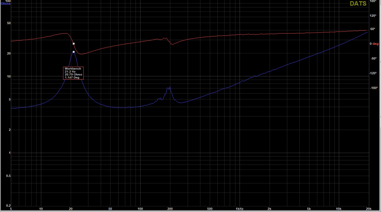

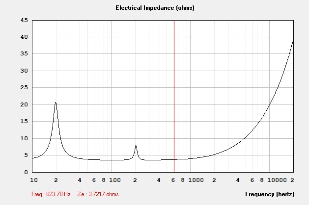

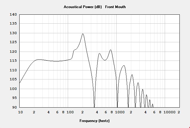

Here are some Hornresp simulation after measuring the MCM 55-2984 drivers using Dats v3.
Close enough to reality. But I notice little wiggles near resonance impedance compared to sims. Probably due to split and bolted construction. May be thin gasket in between the interface would help smooth things out. Resulting Fs is 1.33Hz higher in real.

I have finally settled with 3 ripol subs for now. I am engaging the middle one only in movies. Went with the 18sw450 for this new build.
