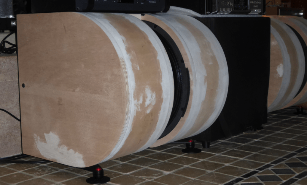

An Audio friend of mine "following me" built a pair of 2x18" Ripoles :
And found that the best for him was to cut at 60Hz 24dB/Oct. to marry suitably with his bass-mid 15" BR boxes.

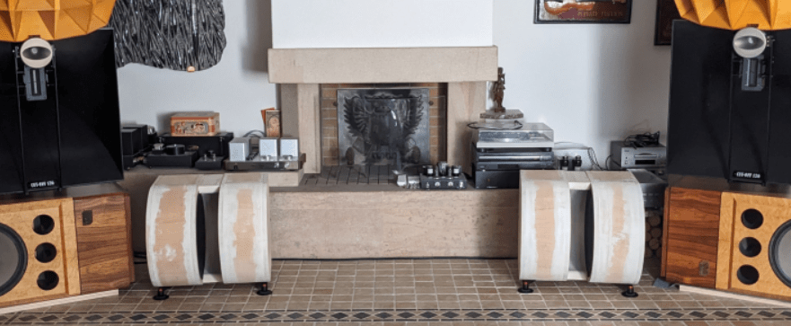

I use my Omega Ripole 2x12" (below, centered) with my Magnepan SMGb at FC=@40Hz / 12dB/Oct. set on my integrated Sub module amp :
The Magnepan SMGb goes to their natural bass FC (circa 50Hz), and then the Omega Ripole takes in charge the infra-bass extension.

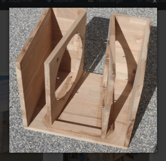

If you construct the cavity so it does not have parallel walls along its longest dimension they will play higher before resonances are an issue.
Yes. That's what I did on my Omega Ripole - the main reason of slanted internal panels being the Subwoofer amp module integration, though :
In theory, this non-parallel disposition should have an influence on the chambers resonances, but in practice, I don't think that it brings a very significant improvement, unfortunately...
T
That's a start but you would also need to put a curved rear wall in left and right chambers. I talked with a guy who used 12" drivers and made the back and sides non-parallel and he tells me his played up to 600hz without resonance issues...

Here are the two 2x18" D-Ripoles (hence the lateral shape in D) built by one of my Audio friends who choose to go for a "curved rear wall in left and right chambers", as you mention it, plus here we have the inside back rounded also :
No significant difference were noted vs. my Omega Ripole with its slanded internal baffles, in terms of resonances. My friend cuts its two D-Ripoles at 60Hz 24dB/Oct. , the maximum limit being circa 80Hz.
He expected to reach 150Hz-200Hz thanks to the rounded shapes, and after a quick test, we immediately heard that it was an idea to forget...
In absolutely no way we would reach as high as 600Hz without loud ugly resonances and woolf tones, with either of our ripoles ! The guy who told you he " played up to 600hz without resonance issues" is a mere confabulator...

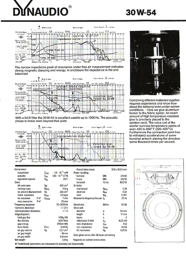

Hi folks , i have 4 Dynaud io 30w54 basschassis laying around with new surroundings . Are these usefull for Ripoles?
IMHO, the 30W54 should do the work well - beside being a premium speaker.
- the Xmax is at 7mm, and the Xdamage is at 25mm
- Fs is at 22Hz
- QTS is 0.36, which is not too low
Yes, at least they are worth a test, and may certainly be fine for a Ripole... If I had 4x 30W54 available 😎, for sure I would give it a go in a Ripole configuration !
But it's me, OK ? 😀 😉
with a Ripole design a too low Fs is counter productive.
The Fb will drop down into the subsonic range ... accompanied with a high amount of unuseable but large excursion levels if not controlled by a steep subsonic filter.
The small 7mm p-p linear stroke also doesn´t convince, if not used in a multipe driver design.
Combined with the soft suspension (Fs of 22Hz at just 41gr of mass) I´d rule out a Dipole design, let alone a resonance dropping Ripole design.
The Dynaudio is clearly built for a acoustic suspension/closed box design.
But then ... You can test it and if it makes you happy ...... 😉
