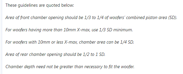

Hi Agent.5,
I've found no published calculators for modeling a Ripol, so I based the dimensions for mine on the guidelines posted by a respected Ripol builder on this forum, under the user name "Rudolf".
These guidelines are quoted below:
Area of front chamber opening should be 1/3 to 1/4 of woofers’ combined piston area (SD).
For woofers having more than 10mm X-max, use 1/3 SD minimum.
For woofers with 10mm or less X-max, chamber area can be 1/4 SD.
Area of rear chamber opening should be 1/2 to 1 SD.
Chamber depth need not be greater than necessary to fit the woofer.

how do you determine the size of the front facing slot and 2 back facing slots? Is it based on surface area of speaker cones x some number?
@agent.5 : see @CharlieM 's webpages under the name Jazzman. The links should be :
http://jazzman-esl-page.blogspot.com/2011/01/ripole-subs-are-underway.html
https://www.avsforum.com/threads/jazzmans-sls-ripole-subs.1487304/
You have all the explanations - they match with the informations given by Mr. Axel Ridtahler, the inventor of the Ripole principle.
Aw, sorry, you already reminded them @CharlieM !
I will just add that point, source of possible confusion - if you build a 2-speakers Ripole :
- for the single front chamber opening, you calculate with twice the SD of one speaker, since there are two speaker exhausting by that common opening.
- for each of the rear chamber openings, you calculate with the SD of one speaker only, since each speaker has its proper independent opening.

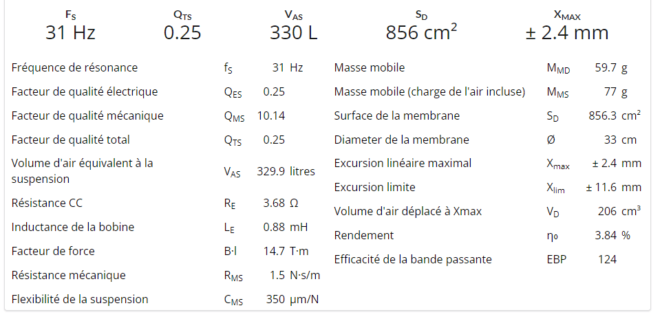

Do you have the drawings for this design?I'm not sure that the Eminence Kappa 15C would be the epitome for a Ripole subwwofer : Fs is fine, Qts is a bit low and Xmax is small, where you would need 8-10mm...
But OK, as usual it is a matter of test : build a cheap Ripole test box and see if it already works as you expect... As you already own the speakers !

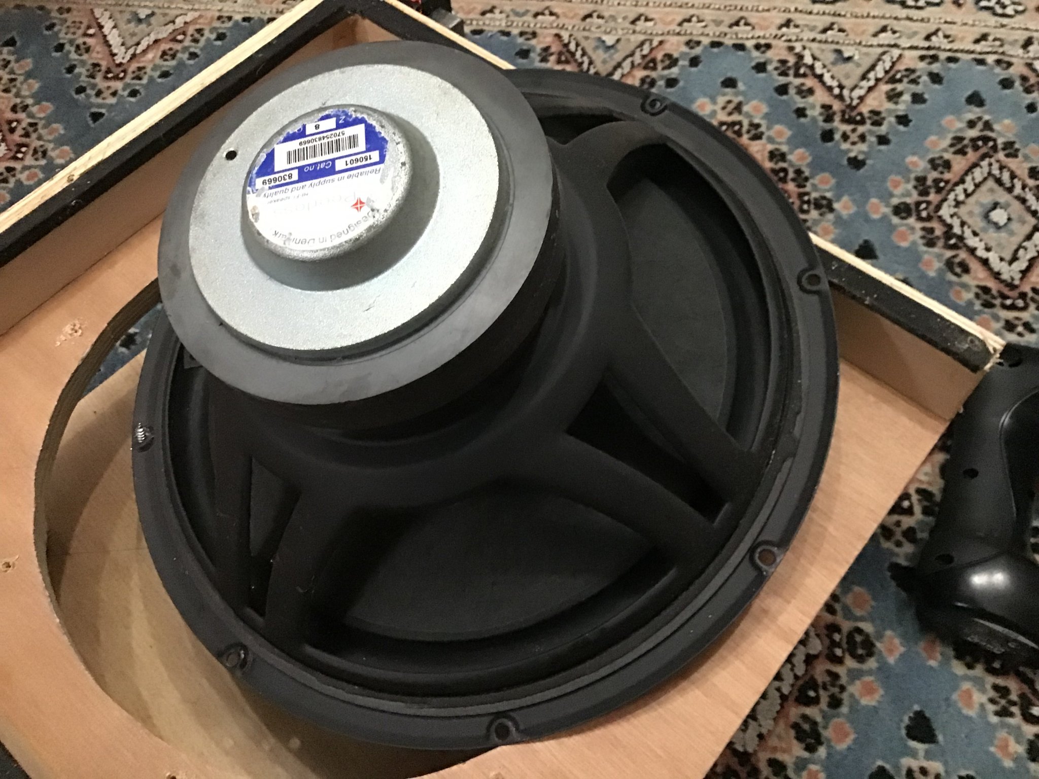

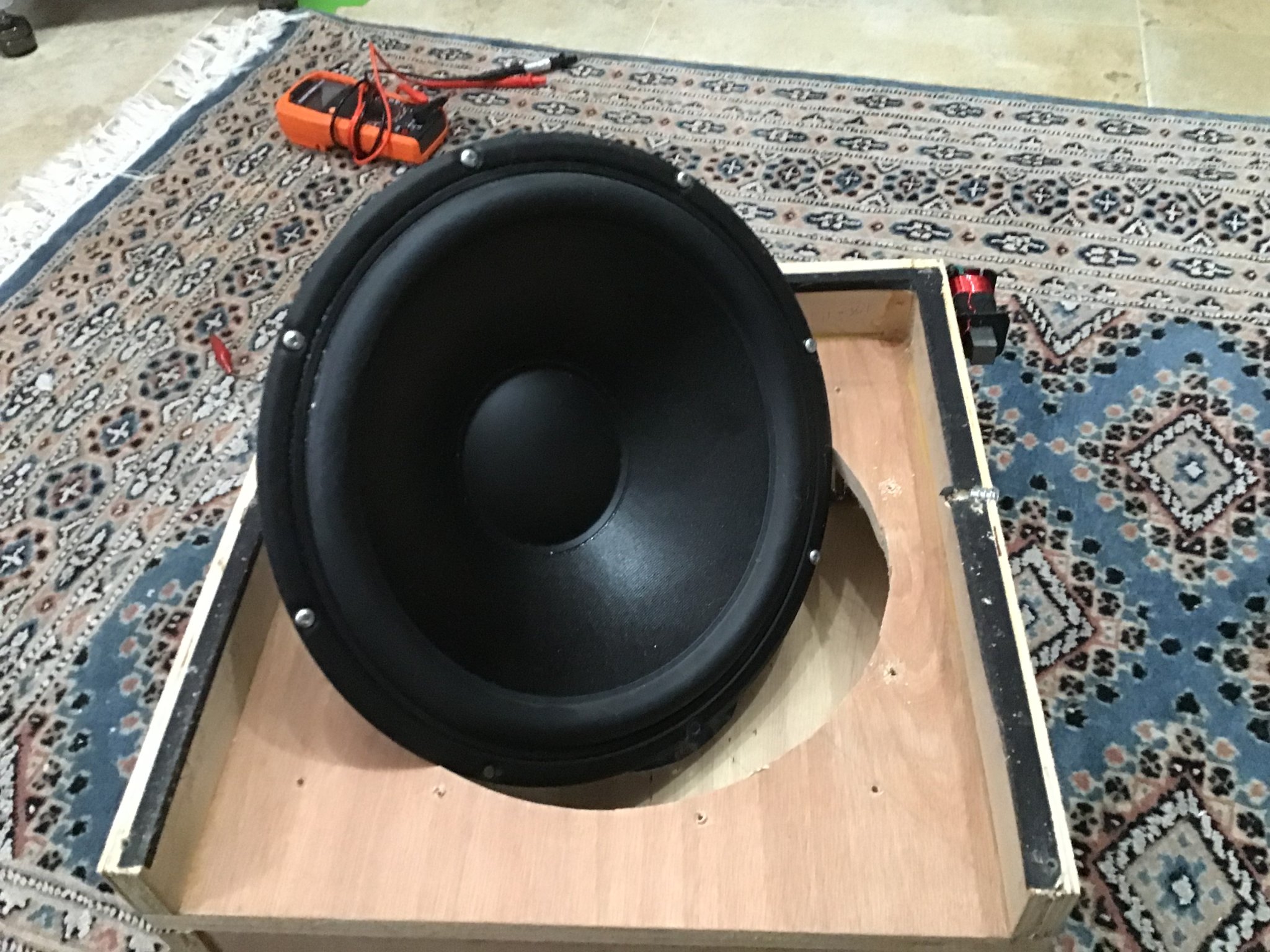

For my Omega Ripole (personal design), I used 12" speakers for a matter of available place. The speakers are two BEYMA 12BR70, which offer a Fs at 30Hz, a Qts at 0.5 and a Xmax at 8mm. Plus they are ruggered and very affordable units !
View attachment 1199775View attachment 1199776
I measured a Fs of the system at 16Hz for a 6WRMS signal delivered to the paralleled speakers, which is quite good for a 400x400x440mm box.
