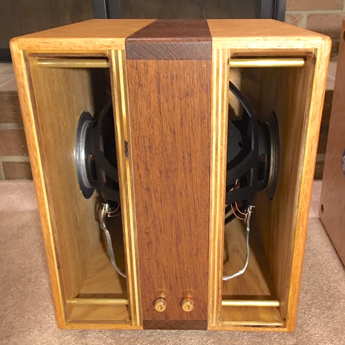

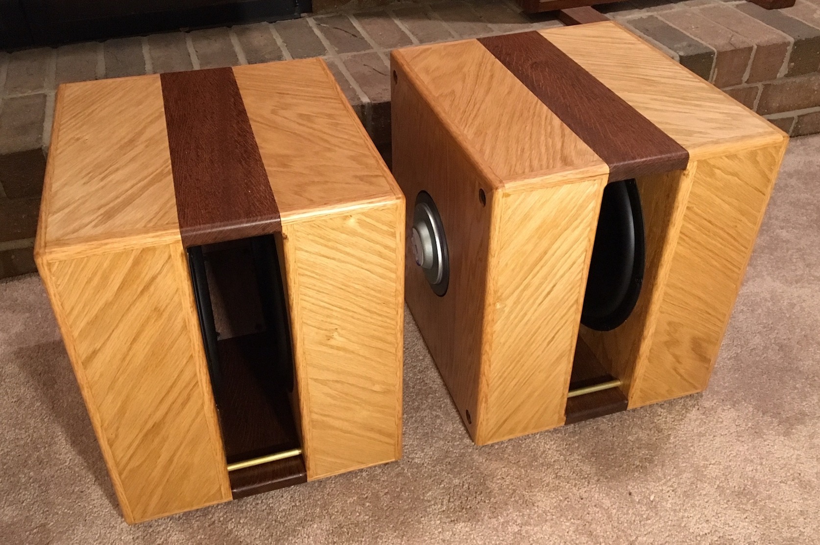

The form factor on Jazzman's build approx 15x15x13, with outboard amplification correct? Can anyone point me to where I might find out more about size/performance options....going smaller? I see threads on bigger, but smaller is lacking, and maybe for good reason. I'd be interested from the perspective of needing to blend with satellites that roll off at about 80db
Jazzman here,
I recently built a newer pair (below) that are 1/2" smaller in height & depth and 1/8" narrower width. That's not a huge change but it made a big difference aesthetically (much prettier). I haven't done any audio measurements to compare them sonically but I'm not hearing a difference. So--I'm thinking I could have made them even smaller without sacrificing much sonically.
I have a drawing and parts list if anyone wants them... just PM me.
BTW; the external dimensions of my previous version was a bit larger than 15 x 15 x 13.
The ones shown above are 13 1/8" wide x 14 3/4" depth x 15 1/8" height.
I may build some smaller ones if I get bored for something to do this winter.
With 12" woofers, the width needs to remain 13 1/8" (or smaller if the magnets can protrude further out).
But I see no reason why the depth and height couldn't be 1/2" smaller (max would be 3/4").

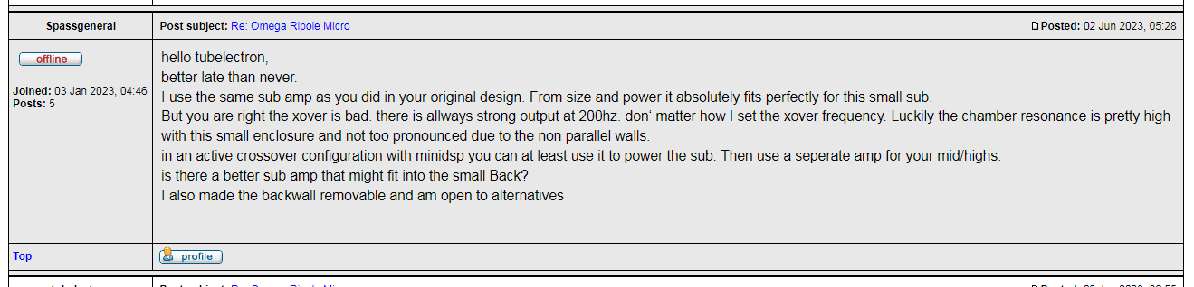

Thanks for your comment!
I've built two bass dipoles already: a simple U-shape open baffle with Visaton W400S that improved a friend's home studio (he's mixing a jazz band) and a W-dipole à la Linkwitz with a pair of Monacor 15". So I am well aware of the qualities of dipole bass units, and that's why I chose this concept as my subwoofer solution for the next build.
While the resolution and clarity of dipole basses are fun, I do sometimes like the punch and heft of monopole basses. If the music calls for it (rock/metal), it's just more fun. 😛

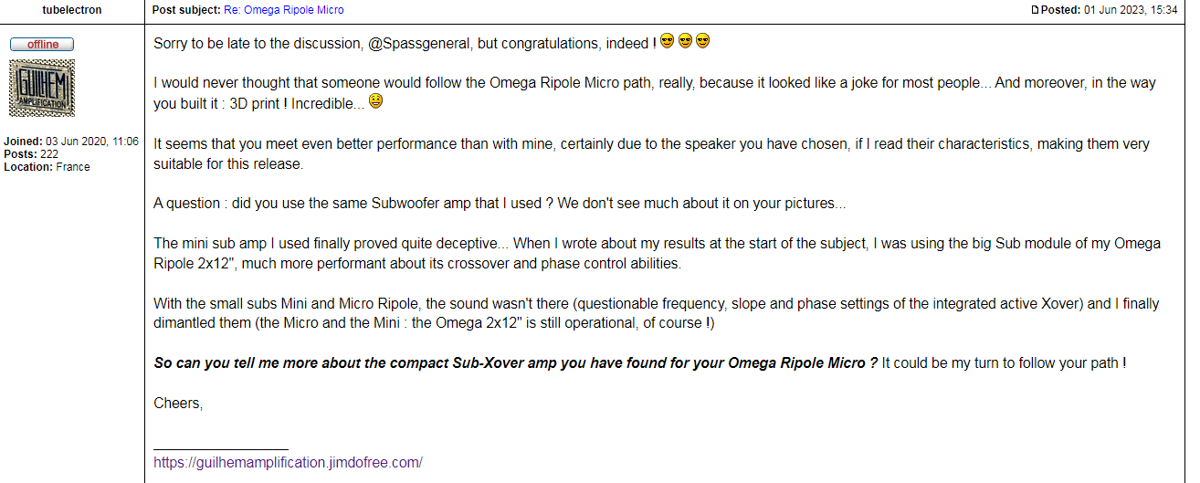

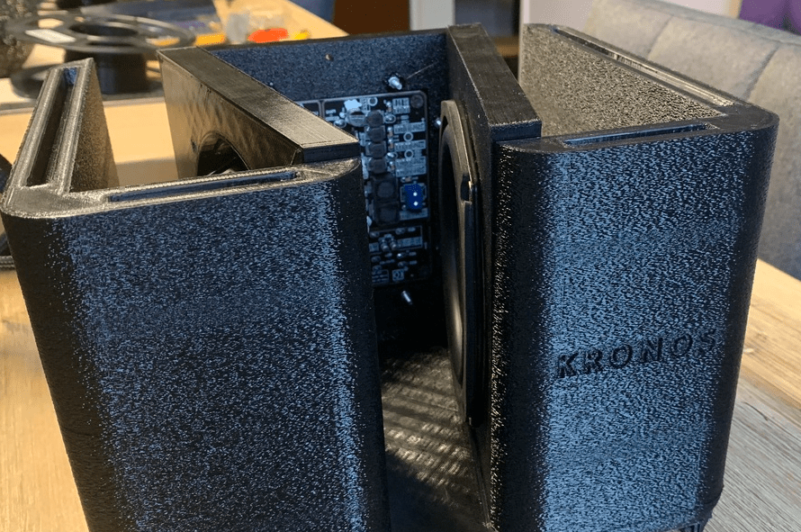

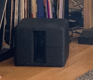

Aw @CharlieM... I already posted it ? OK I did not remember - my apologies !
Moreover, I noted that you are the Guy behind "Jazzman" : I went several times to your website when I was searching input about Ripole Subwoofers. The valuable informations I found in your web pages may be broadcast IMHO, so I quoted you and mentioned the link to your website on mine :
Well, I found more practical for me to have a standalone Ripole unit, just like any commercial subwoofer, so incorporate the subwoofer module was logical, in a way that would not increase too much the overal dimensions, hence that "omega" placement of the internal panels, and the name "OMEGA Ripole"... 😉
For this the ATOHM subwoofer modules are perfect, since they have their proper cap or cab to protect and make them tight from the acoustic chambers of the speakers, where high pressure exists, and may spread out by holes of the sub, making adverse noises...
