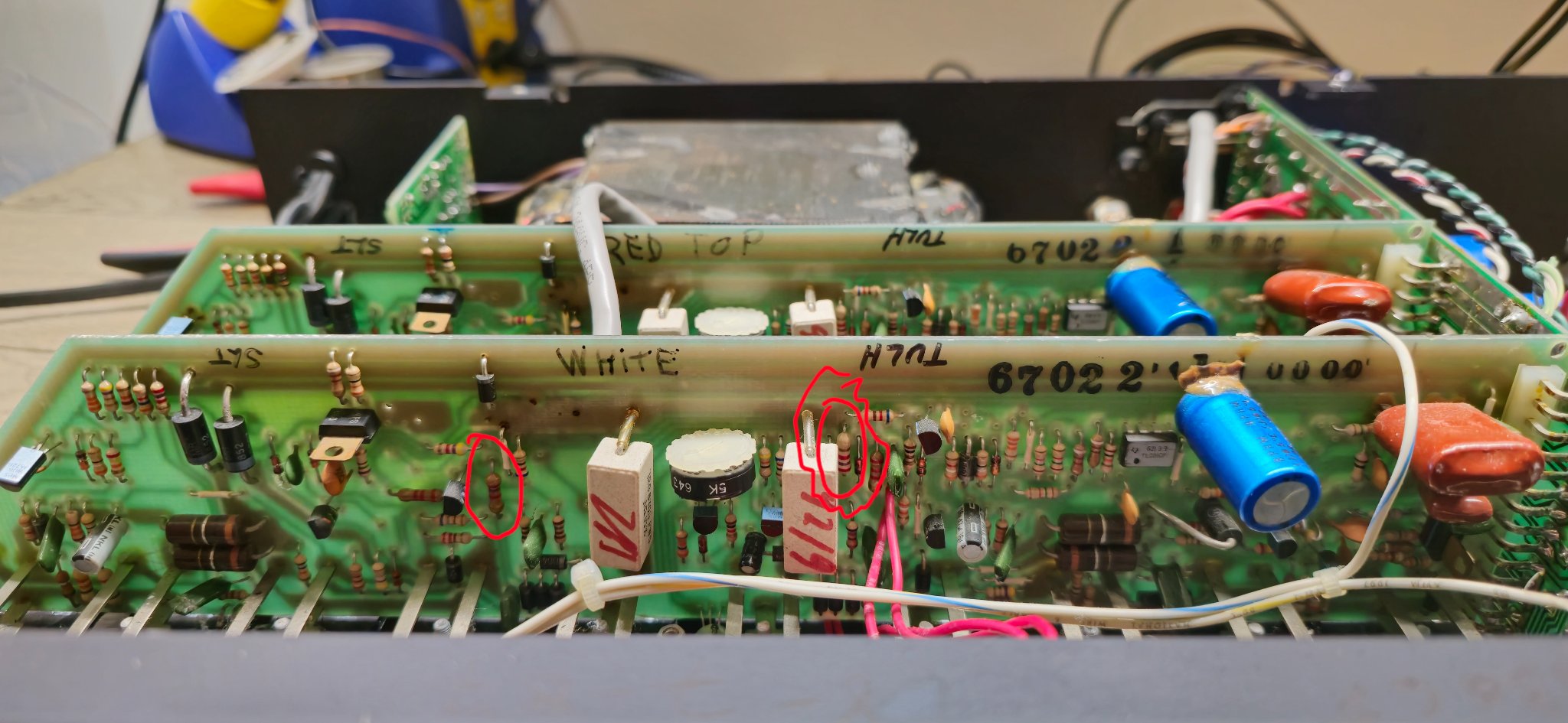

What are the values of those two resistors which are running hot? It seems that is the only difference between the boards. Maybe photo would be helpful too. I have few of such amps here around, I can open one up if needed to identify the resistors.

Attached is a pic of the resistors that were getting warm. They were about 150 deg which isnt all that hot i guess, but they are not on the board layout.
They are 2.7k value.
Not sure these are the problem though because both channels now seem to mearure from what i am seeing, identically.
30v across them resistors.

They werent hotter. It was an error on my part when measuring them. Both channels seems to be identical.

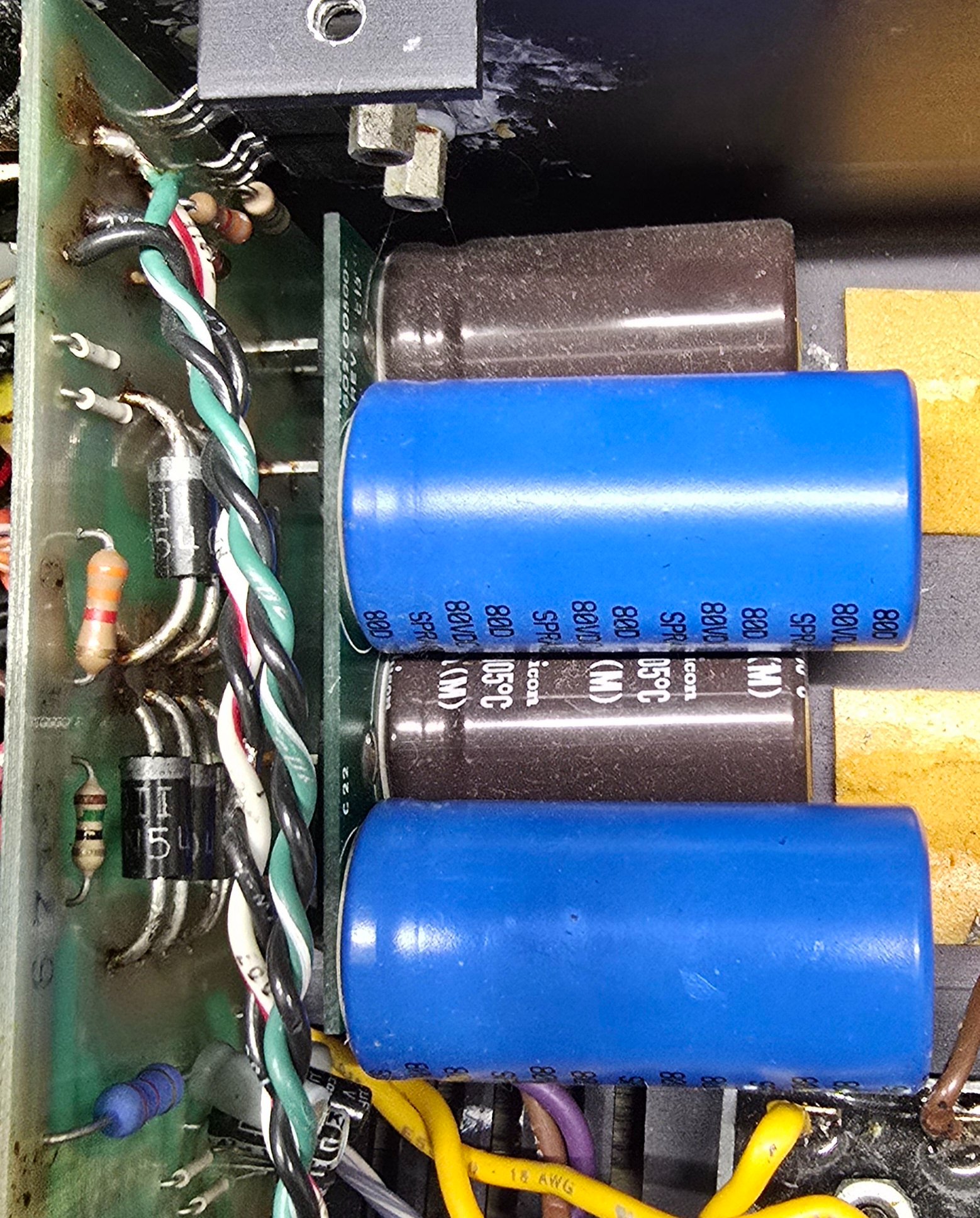

Those mag coils are noisy ones. Especially with the load it will buzz. If filter caps are bad it might be opening triac more trying to reach desired voltage but elcos can't hold it. It will cause mag coil to buzz even more. such case you can see the ripple on the scope. If those souble capacitors are defective that is quite some work to replace. There are boards available online where one board with 4 caps replaces those.
Resistors are R6 and R7

Those dual capacitors almost always fail. If they vent they make a heck of a mess. Bad caps will cause the mag coil to be noisy for sure.
Make certain the capacitors are name brand "snap mount" and the PCB attaches with posts and not wires. I've only ever seen cheaply made replacements. An insulator sheet between the PCB and capacitors.

What are R6 and R7 for?
I made my own with 2 oz copper, exact copies. I don't have spares unfortunately.
You're lucky. That appears to be a factory replacement kit. Mine looks the same. Notice the square pins to the PCB.
Normal radial caps and wire leads do not cut it.
