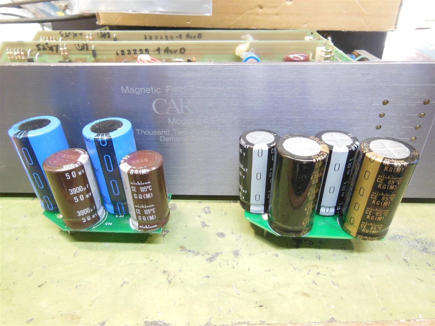

I recently did the recap of my Carver M 1.5t and being skilled manually it was easy to do. seeing the xray video made me wonder if the bias and voltage regulator are in their best configuration. I ask: mine is 230V, what value should the bias have if I measure it as per the video?

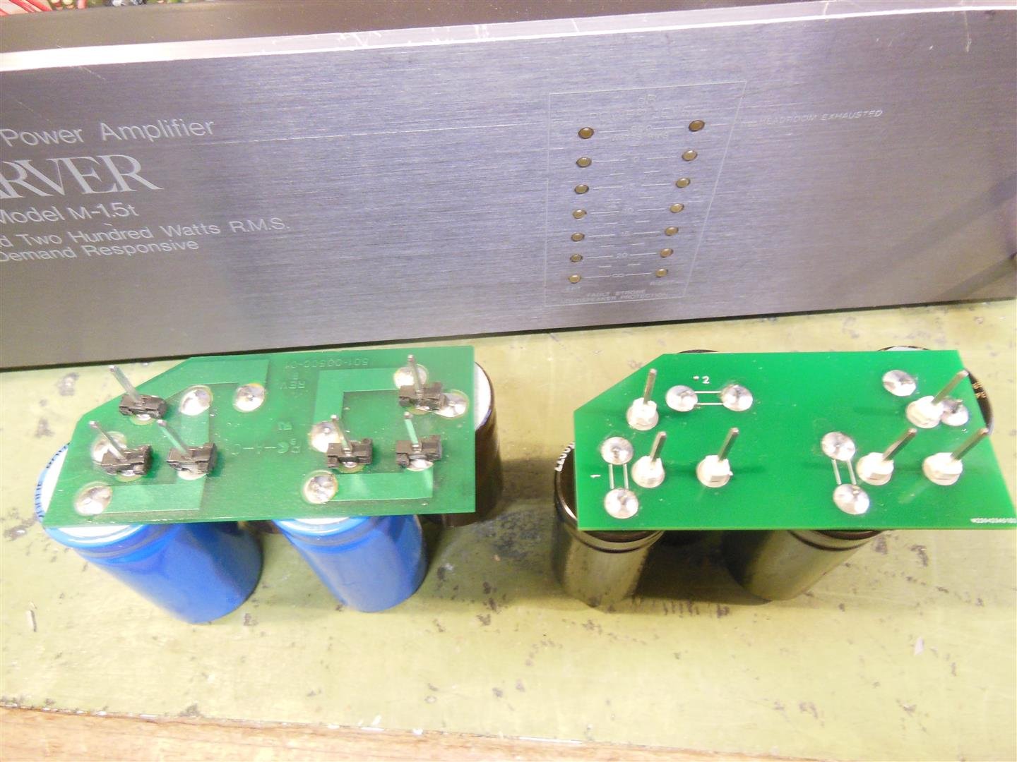

I was Canadian Factory warranty for Carver and still repair them.
Pics. One is original from Carver, the other is what I make.

Hi jeffrowland,
It is very simple. Build this highly engineered amplifier the way the factory built it. They created an extremely reliable amplifier, and it was teams of engineers who did it. Not one guy.
I'm sorry. I am not about to critique someone's build. I know how to build them properly, and improve them a bit as well. There are so many ways for these amplifiers to go wrong if you change them, I figured them out and know enough to tell you that improving one and making real improvements is an engineering issue. Your average audio improvement guru hasn't got a clue. I've had to undo enough hack work from these people to know.
Let's put it simply. In order to improve any amplifier, you have to know it at least as well as the team that designed it. That excludes most people for any brand. True, some brands are designed poorly. You still have to know at least the same amount as the people who created it in order to improve or comment on it. Those engineers were university trained and most modification angels are not.
