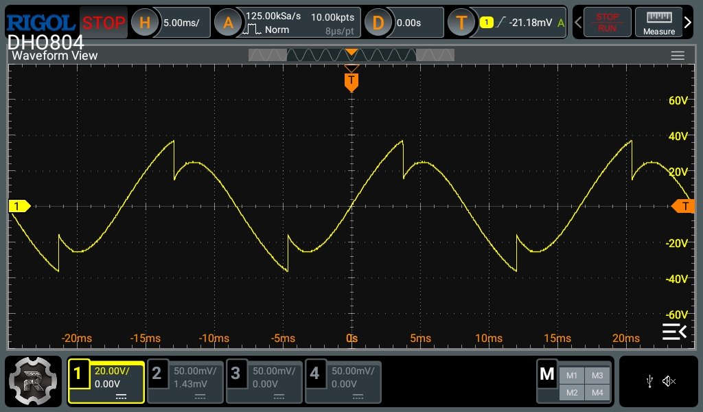

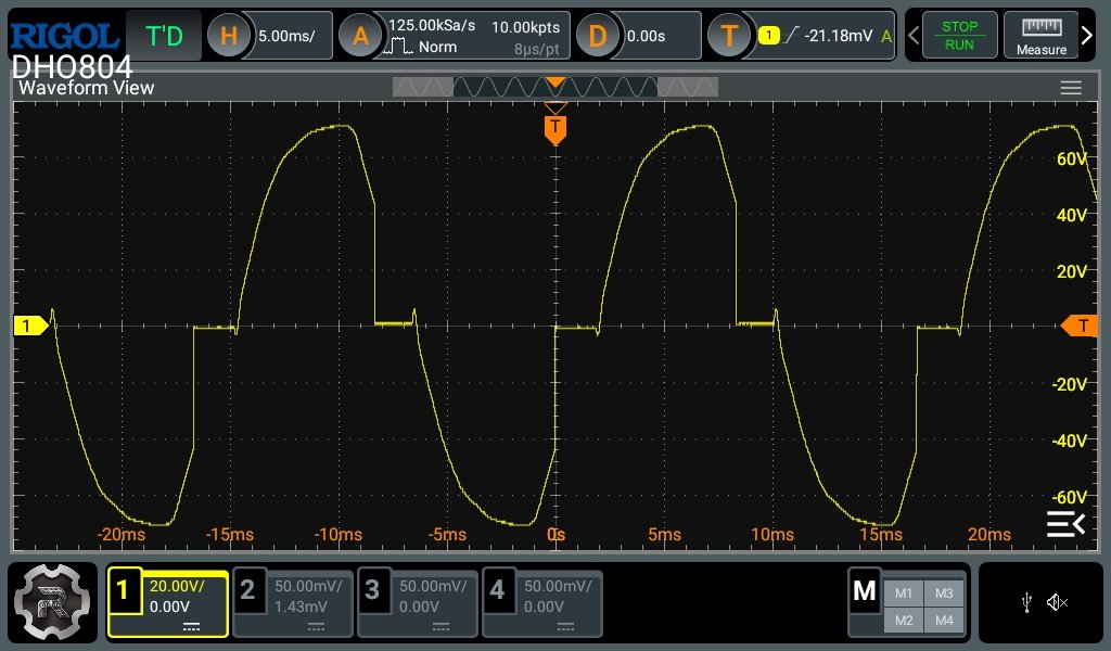

Im not sure what to do here. First check is the steering bridge. I checked them a while ago...de-soldered one side on all diodes and they checked good.
Next is checking the diac and triac but Im not really sure how to check these.
See attached screen shot.
This was taken across the diac....grounded on the triac gate, and probe on the other side, line voltage.
Looks nothing like the image in the service manual (Fig1). but then again, Im not really sure how to measure a triac and or diac with a scope.
Can anyone lend a hand?
Second Attached is the image of the triac, oscilloscope grounded on MT1 and probed on MT2.
They look nothing like the manual, but then again, I am pretty sure I am not probing correctly.
Thanks for all the help.

Probably output was shorted at full power, that caused overcurrent situation and if you look closely you will see those mpsu transistors must actually drive big TO3 drivers(Q8 and Q3). It does happen quite often (at least from the damage I've seen on some amps which I've bought and fixed) that outputs and drivers survive but actually those VAS transistors kick the bucket. After that one was shorted full rail(124V or whatever it was set) on bias network, killed Q17 and I would not be surprised if Q20 and R55 would be damaged too. That is npn VAS transistor and it's emitter resistor. I would also check drivers, outputs and commutators(that is all TO3 devices). You can usually detect shoted one in circuit. You can compare measurments between channels and see if something looks dodgy without actually pulling it out just at the beginning.
More to your question now. To me it looks like triac is opening all the time. It looks like really trying to build up supply voltage but it can't because there is some really high current draw from it. Have you confirmed all the rails are coming up? Nothing is shorted? You need to see 3 supply voltages. +-35, +-75 and +-124. That is roughly. I've forgotten which amp you are fixing. I'm looking at PM1200/1.5a service manual. Your amp might be a little bit different. I know some amps have lower rail at 50V and so on. But you get the idea.
I would short the triac maybe and open it just a little bit. I would be measuring all the voltages. Ratios between them should be roughly the same even at really low values or at least all should be comig alive. Maybe open variac to get maybe 5V at the lowest rails and that will give you something between 10 and 15V on the high rail which on those big elcos there. If one of the rails is missing or it is not really coming up you have either shorted elco or more likely shorted bridge rectifier. For lower 2 rails you have diodes there where trnsformer wires connect to the board. Those are pain to replace. If high rail is out there is bridge rectifier mounted close to those 2 big elcos. I've seen those shorted several times.
Do not open variac too much. As you know ''mag coil'' is not intended to run full throttle like that. But still it is just transformer and you should get a little bit of something on all rails and it should be more or less in the ratios like lower rail is the lowest there is something in between and high rail obviously is the highest. There will be current draw at low rail for 12V supply also, when things start to ''wake up'' at low voltages there might be that things will be off...but you get the idea what I mean.
I might be really off but that is how and what I would check. Also I apologize if number of parts are messed up or something. It is 6 in the morning here and I've just returned home from mixing late gig.

Bringing the amp up to higher voltage caused the headroom light to go out on the faulty channel.
I slowly raised the voltage while watcbing the 125v rail voltage and it got up to 120 before i was even at full line viltage 😬.
I ended up adjusting thr power board pot all thr way Clclock wise to minimise voltage as much as i could...raised the variac up to full volts and my 125 was in no danger of blowing up my main caps.
I took a leap of faith with the headroom light out at full voltage and decided to plug the amp in straigt to the mains while watcbing the current. (It wasnt high with the variac).
Plugged straight in, the current was abiut 1 amp. I dont have a signal generator so i need to fine a way to feed it a 1k signal. It was not at the less than half an amp draw, but its not the 7 i had before.
I know something is not right still because the one channel headroom light being on at lower voltage. Maybe now thats its able to power up and i have no dc offset, i can further test with a load and signal and hopefully that will point me towards what is still faulty.
Thank you all for the help this far. This has been a good learning experience for me.
As for the fireing of the triac,
Was i measuring it correctly?
Ive ready you need can only measure triac with dual channel scope.
