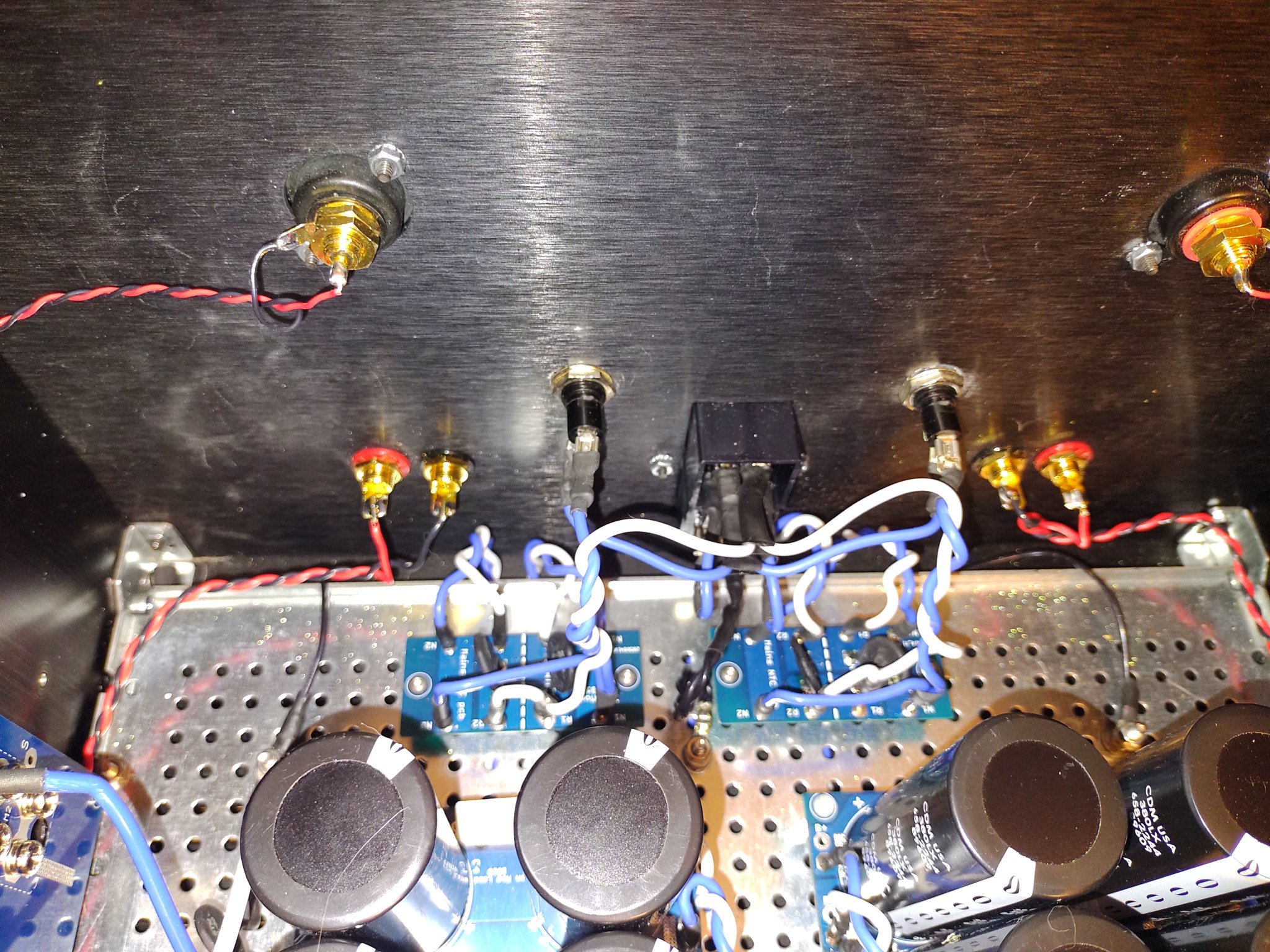

Couple thoughts before switch flipping, I rigged the input lines to board by leaving extra length on both the neg and pos inputs to board.
The negative input line goes in -input hole, comes back through from back side of Ground hole. This makes the permanent connection for
the negative in, as well as leave a post sticking up for the positive to temporarily ground to. Seems like the shorting plug in the input accomplishes
this, but such assumptions is where I mess up.
The other question is the beginning setting for pot that controls bias. Instruction is: " P2 set to max value - check with probes across unpopulated Rt, that one being in parallel with P2; that way pre-set is min Iq"
This is pretty plain, but just in case, I take this as set pot to highest value (ohms) for lowest bias reading, right? I once misread instruction not so plain and did opposite! Using a variac, so caught the sudden rise and corrected, but was a warning. This instruction fairly clean here!
Pots currently reading 240 ohms or so, needs set to highest value. Setting them up, they maxed out at .509k ohms and .487k ohms. Being dual mono and having put an extra fuse for each side at A/C input, I plan to remove fuse from side not being set so it can be performed channel at the time.

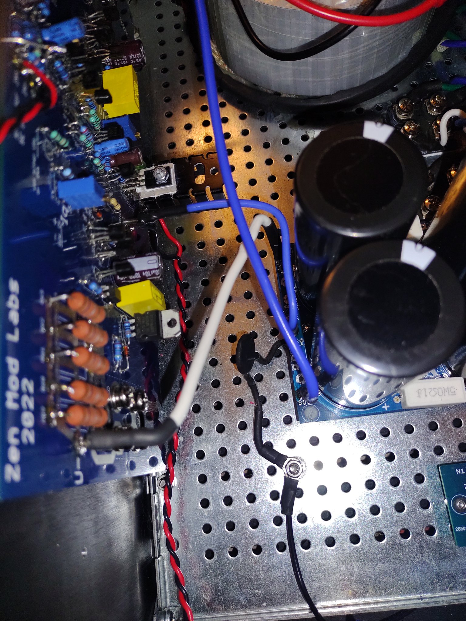

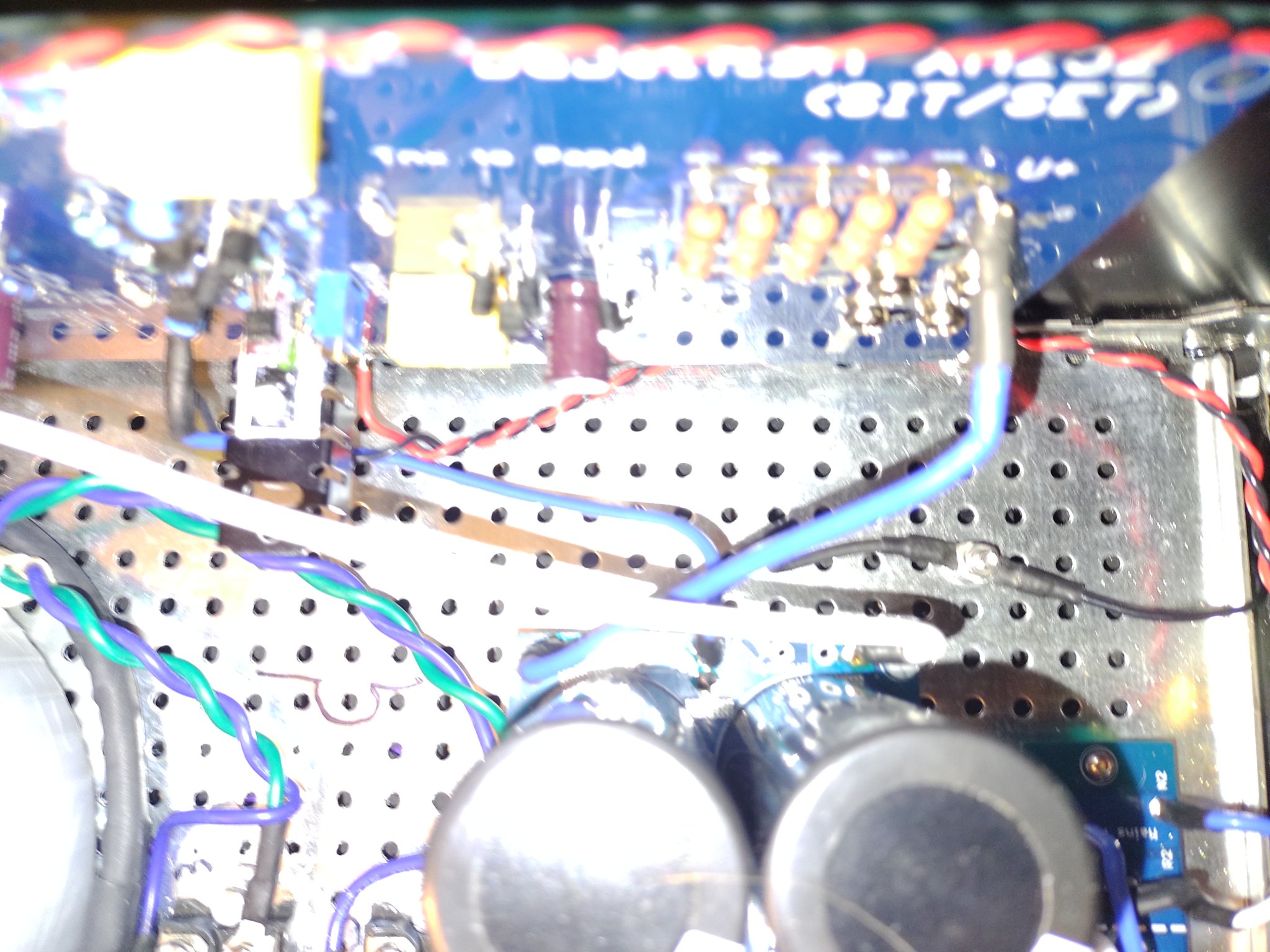

Well I have ooked something, power supply I think, or same error in both channel, tried both. Variac goes up, green lrd lights up, Bias not coming up very fast, but offset easily nulled. Then fuse blew, 70 volts or so from variac when it happened. Puck were about 30 degrees. One of the main fuses, 5 amp slo blo
Tried other side, same thing identical. All parts were heating up...oh well! Nothing burnt, got brow or smelled funny, hopefully minor issue.
Ideas welcome, dont know where to begin.

pictures of your setup could help
did you set Iq trimpot all the way CCW?
did you had DVM set to mVdc across 0R11 resistor group and what value you had there when fuse poofs out?
silly question - just pops out, you have pucks in proper places (not swapped)? No silly question in fact, I did it once on my T-Bed but luckily got it even prior mounting pcb on top of them
that's why I now have a habit using red marker on positive rail outputs and black (or blue) on negative rail outputs - just to prevent making same mistake
Will take some pics. What ever, same with both sides.
Pots were set to max, and was slowly coming up with variac, twiddling knobs, little more. Then the led went out.
As to outputs, I will check, but think I asked here and was pretty paranoid and was triple checking...on the other hand that would explain both sides. I have checked all the 3 legged small devices and they are oriented correctly (according to silk screen) but will check with light and helpers to make sure correct part in correct place.
And will recheck outputs. That would be just my style. Check, double check, ask, recheck and then screw it up anyway.

Oh, the bias. It was just starting to show, second time, really low .08ish, I think the first time I applied power I was around .7, I powered down and thought I would swap fuse to other side and if it acted same, fire up whole amp
Came back after re rereading other posts here decided, no I should get channel all the way up then the other, but fuse blew before or around 70 volts on the variac dial, so approximate

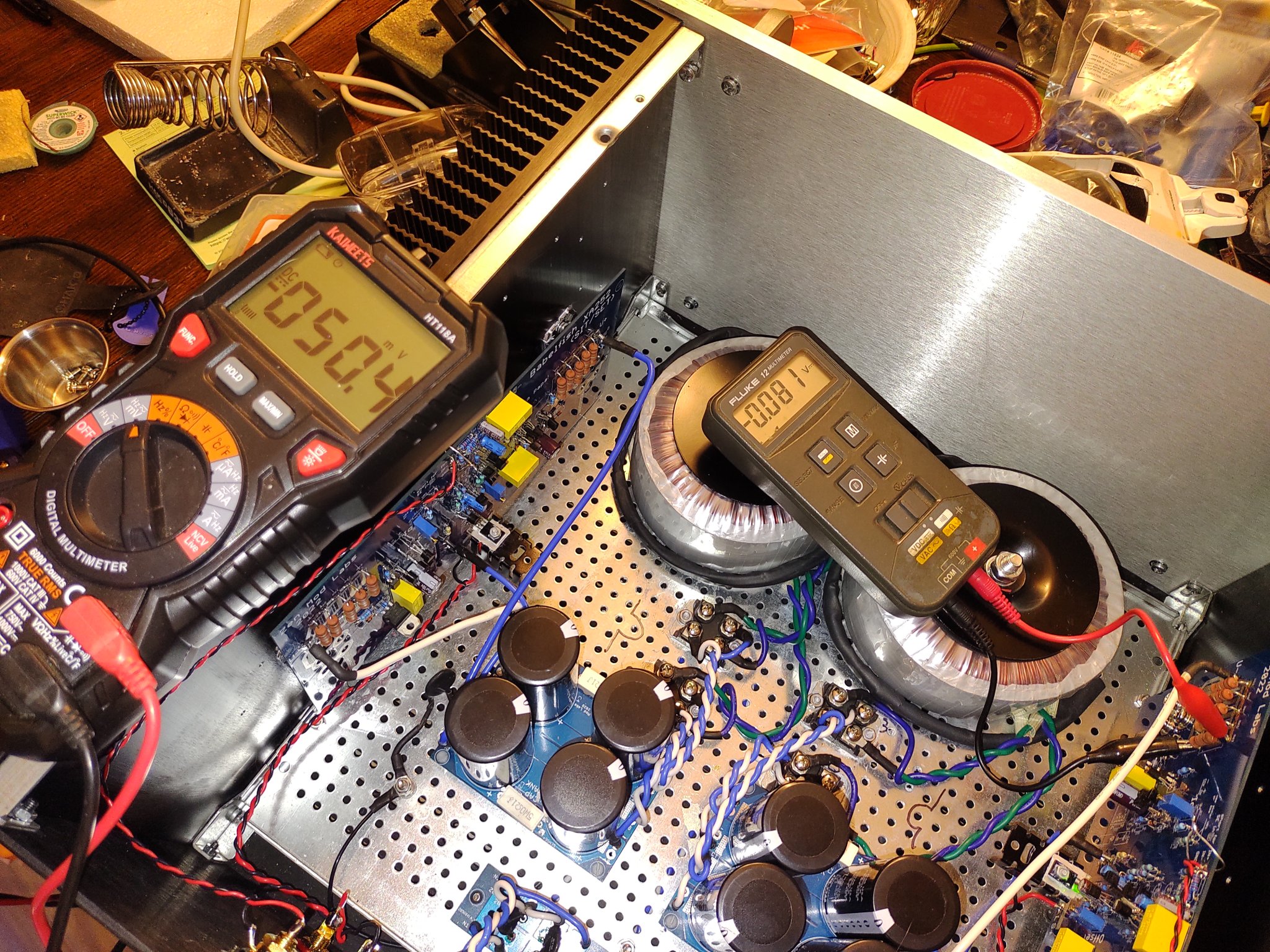

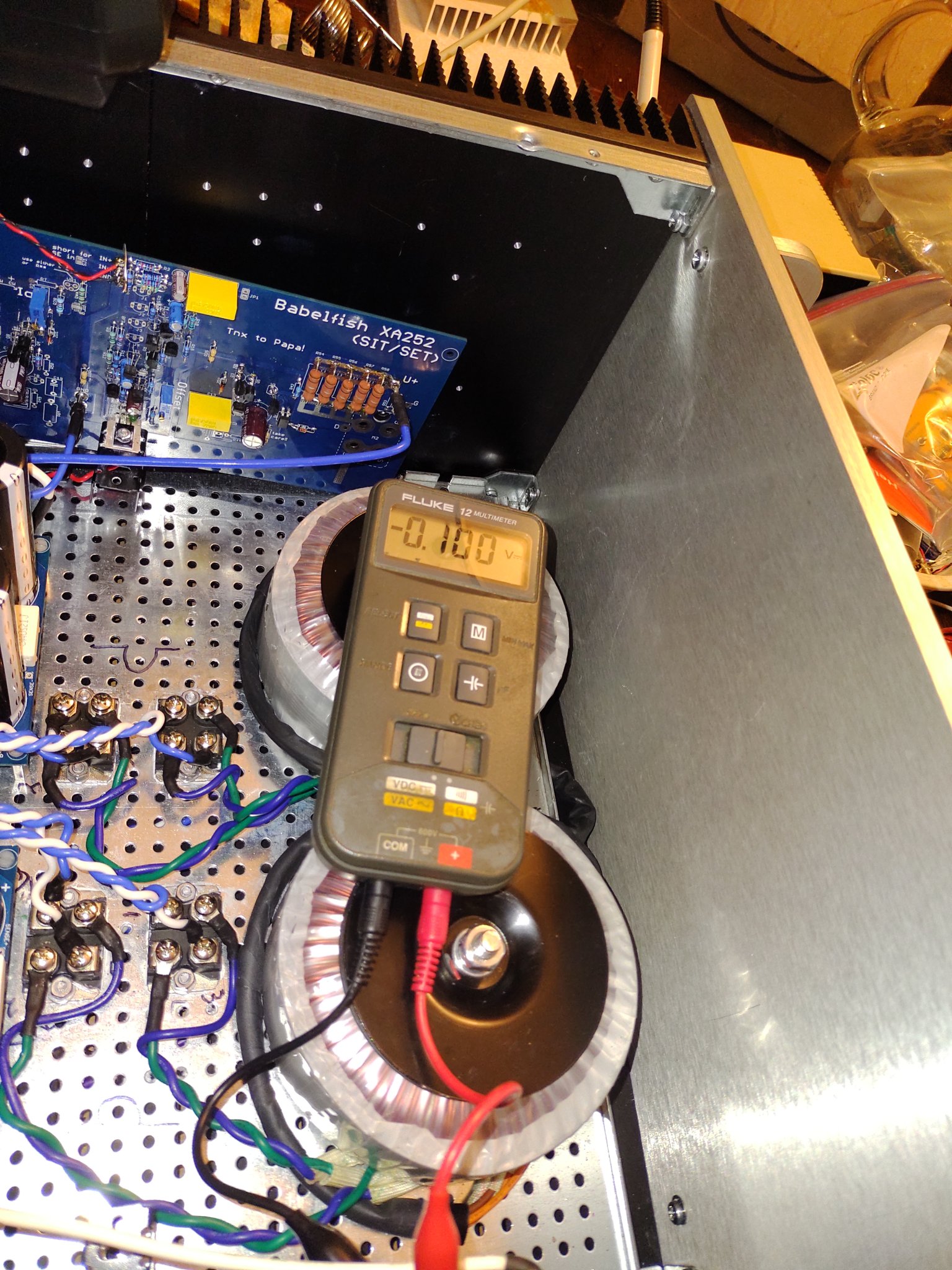

just remember that 1A across 0R11 resistor group is 110mV
so, preferred value of final Iq (1A7 to 1A8) is 187mV to 198mV
0R11 resistor group being 5pcs of 0R56 in parallel

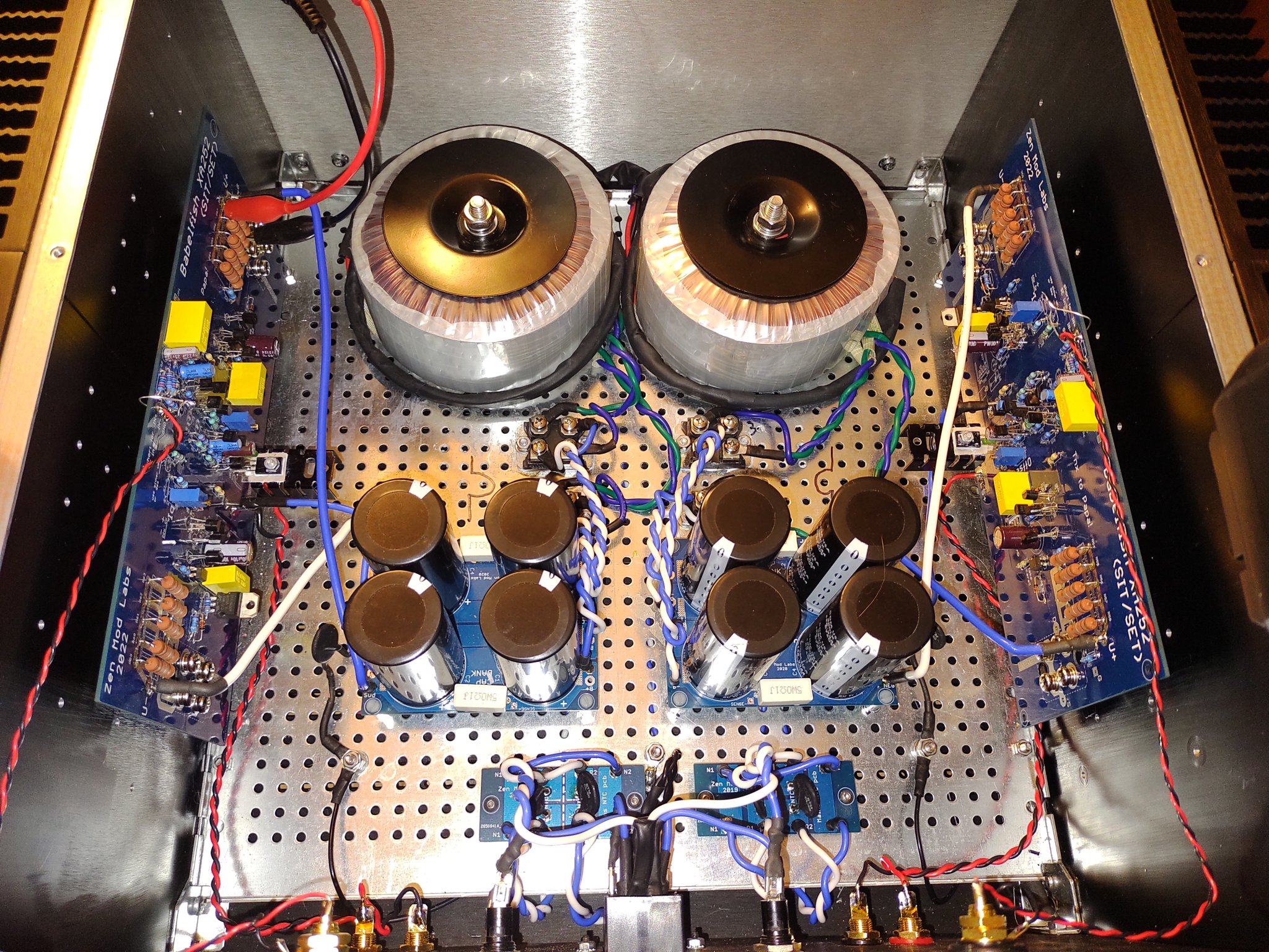

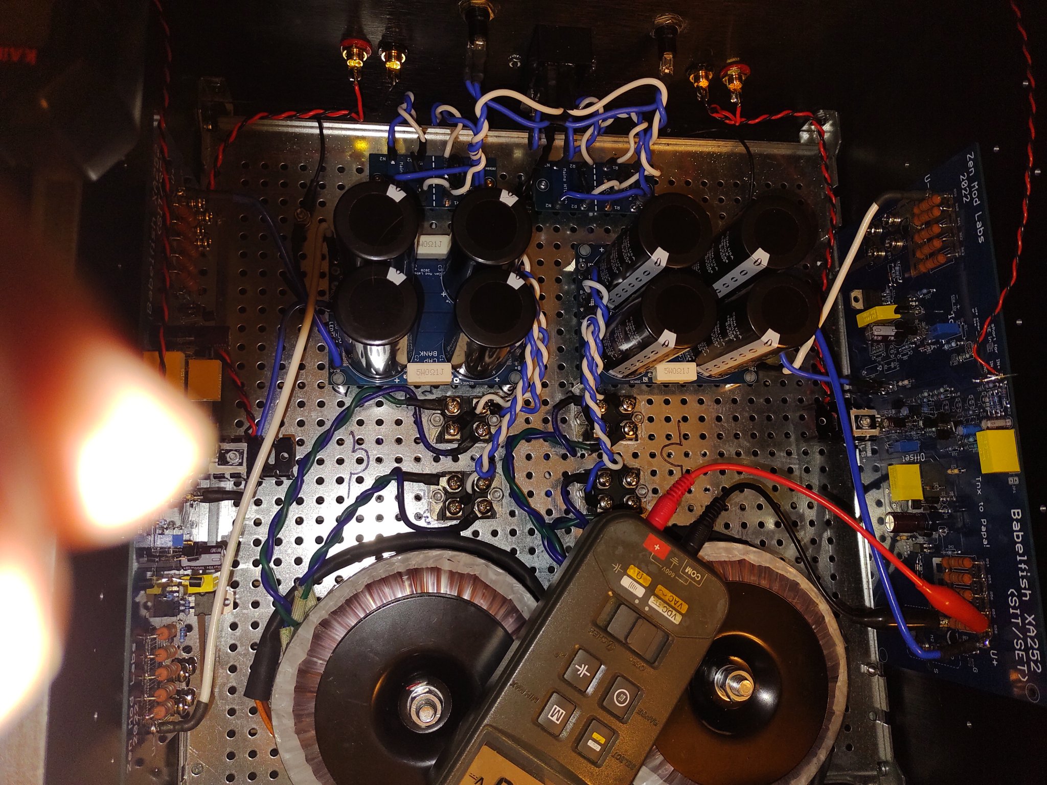

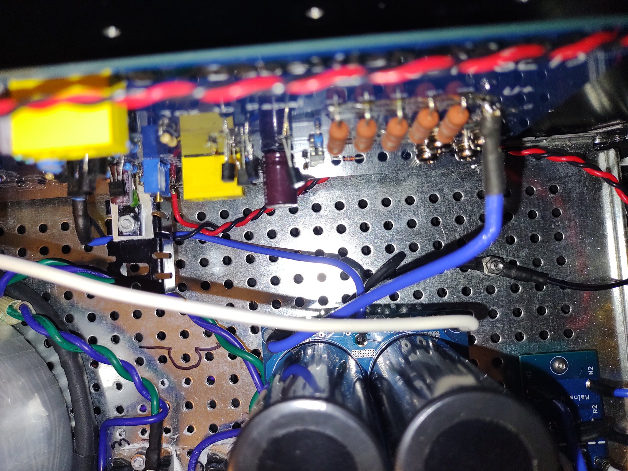

Ok, checked output positions, looking at board, the "30p" unit is on the right hand side, "50p" unit is on left. Looking at schematic, M2 = the 30p unit on the right, so I got that part right.

so, confirmed that you have N channel mosfets in positive rail and P channel mosfets in negative rail
rest of parts on pcbs - all in appropriate places? this is most important check I asked for
especially BD transistors not swapped positions?
Will check all positions, especially bd parts. I thought outputs was main concern. Are BD parts the two stuck together on heat sink?
Meter is showing .107. ideally, this should be up to .180, or am I way off and should be 180 without the decimal point? Outputs are at 32C right now, barely warm.
care to give some details now, except throwing numbers?
where is each DVM connected (Iq, DC Offset), and what is happening now - did you reach full mains voltage and amp is stable, or fuse popped again?
no need to fiddle with DC OFfset at all until you get Iq dialed in, and even then it is possible on lu with JP1 installed in place
so, please be clear with new info, I'm easily confused
