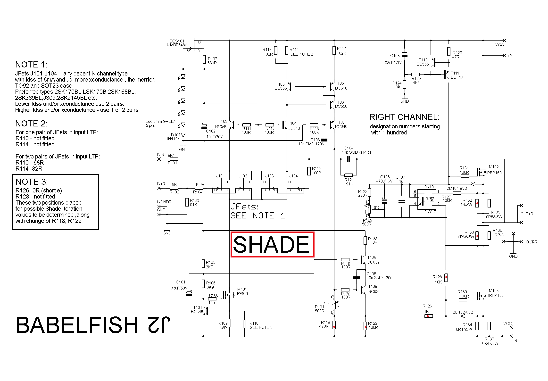

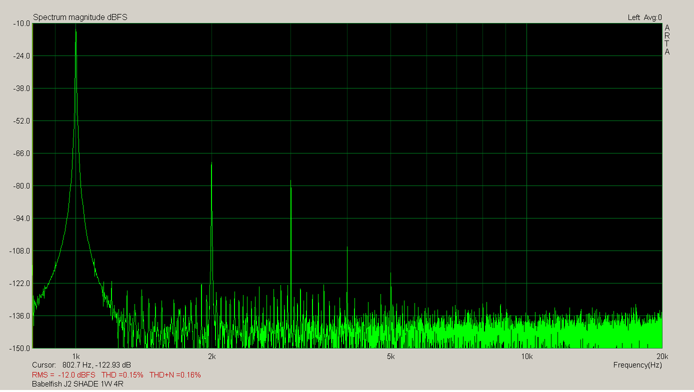

I tried to build an UGS similar to BBA3 but with feedback and an added buffer.
So a kind of Xs pre for a poor man. Buffer is added via a drain resistor.
Still trying to adjust h2/h3. At the moment sound is too brilliant.
Babelfish J2 Shade
hm ...... interesting ...... :clown:

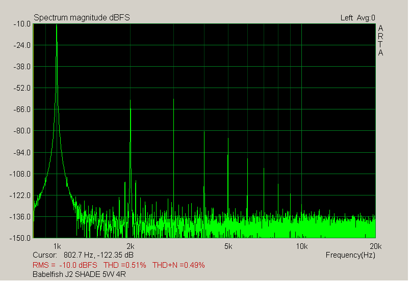

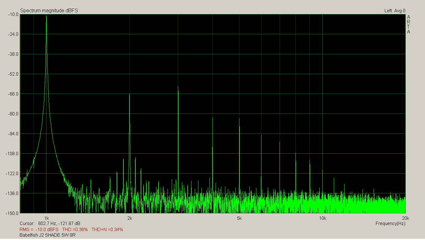

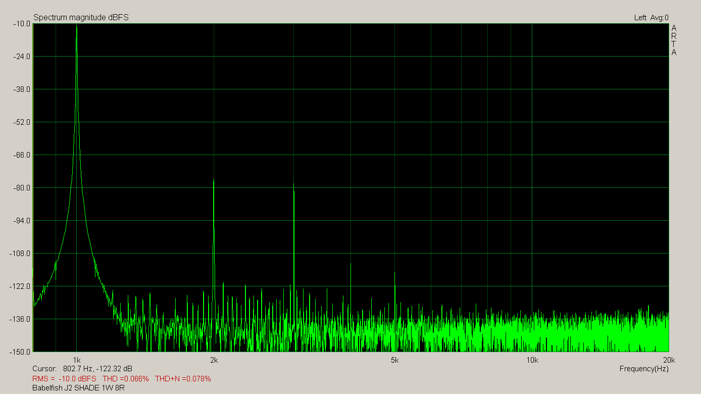

SHADE , 8R load

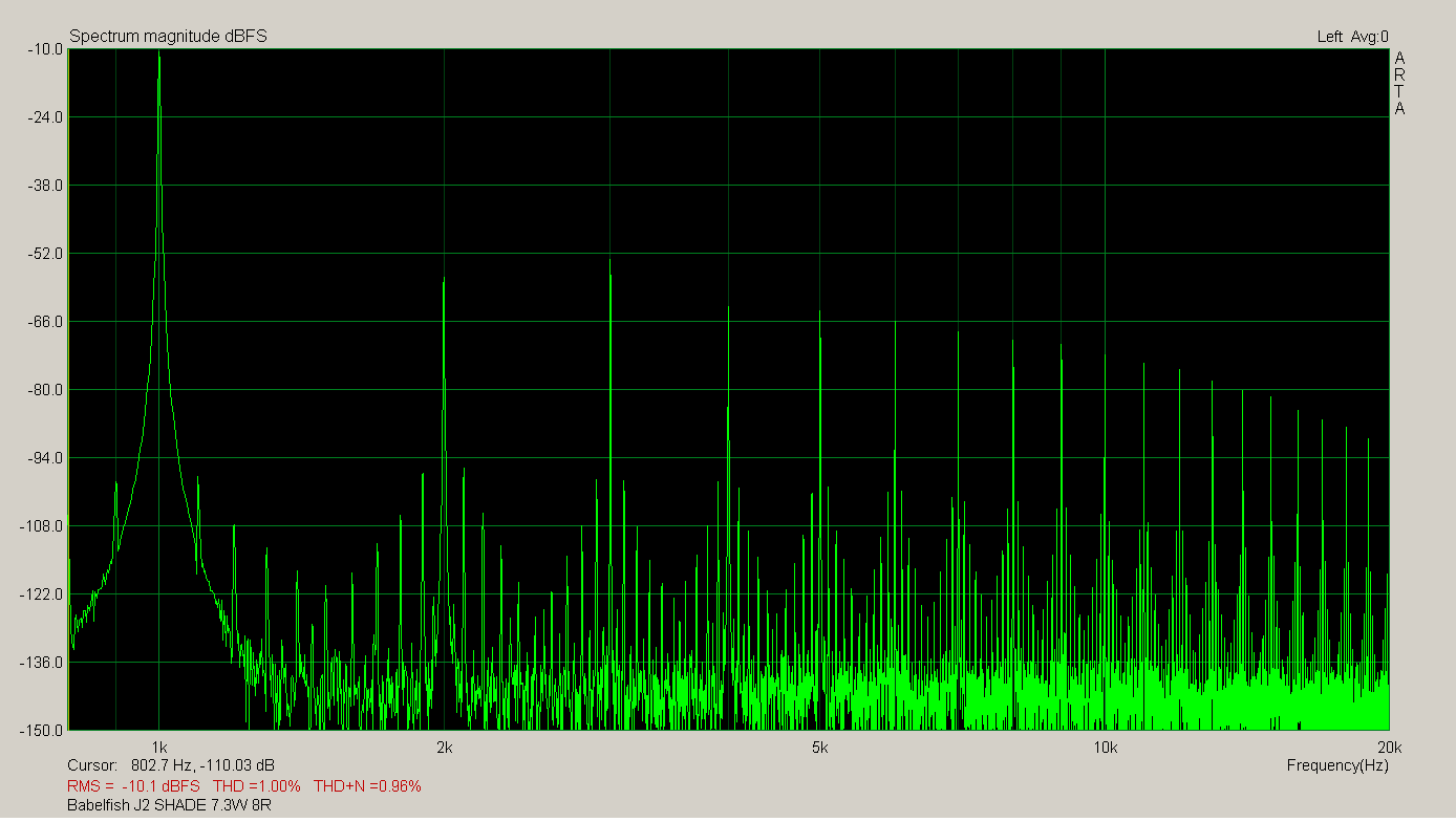

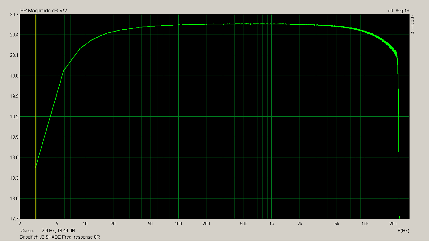

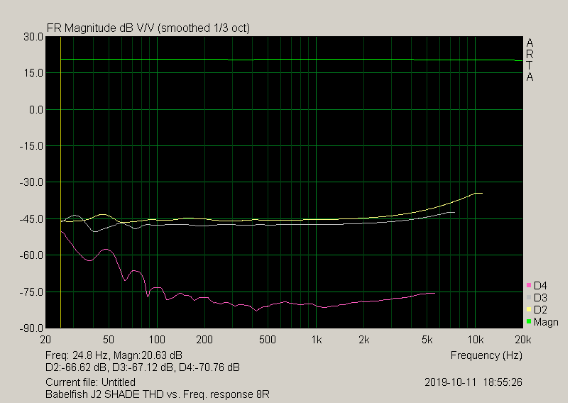

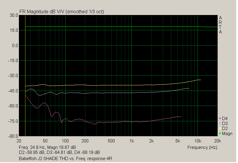

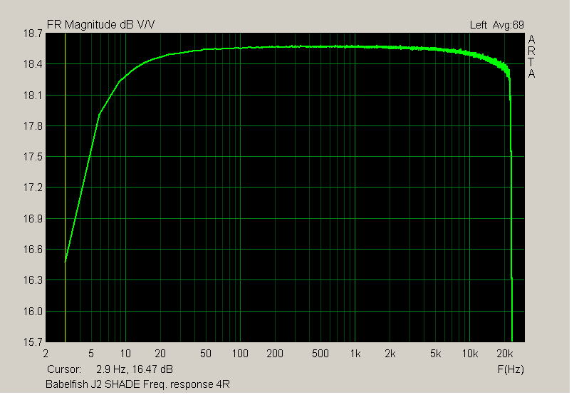

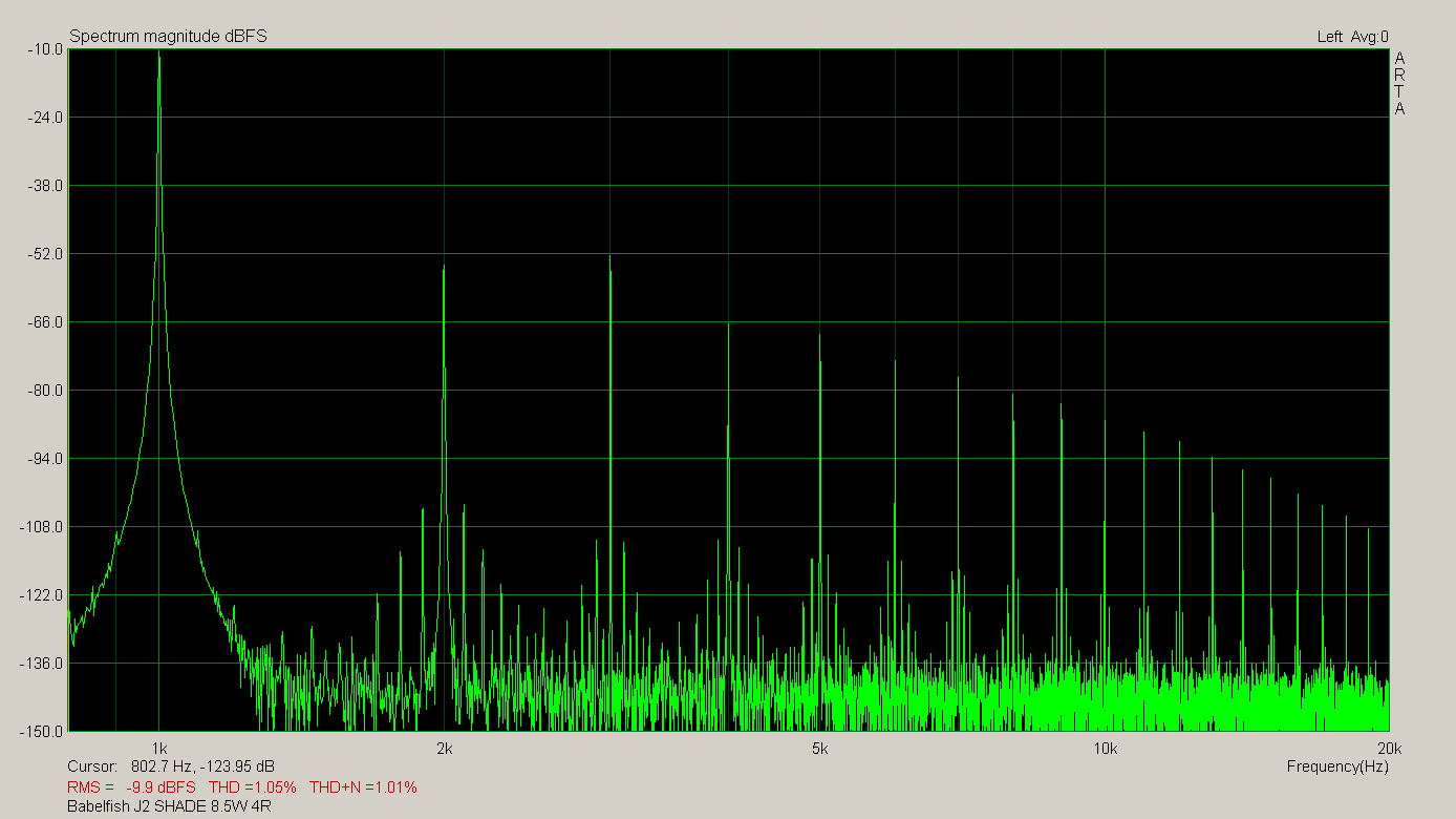

SHADE , 4R load
:rofl:
