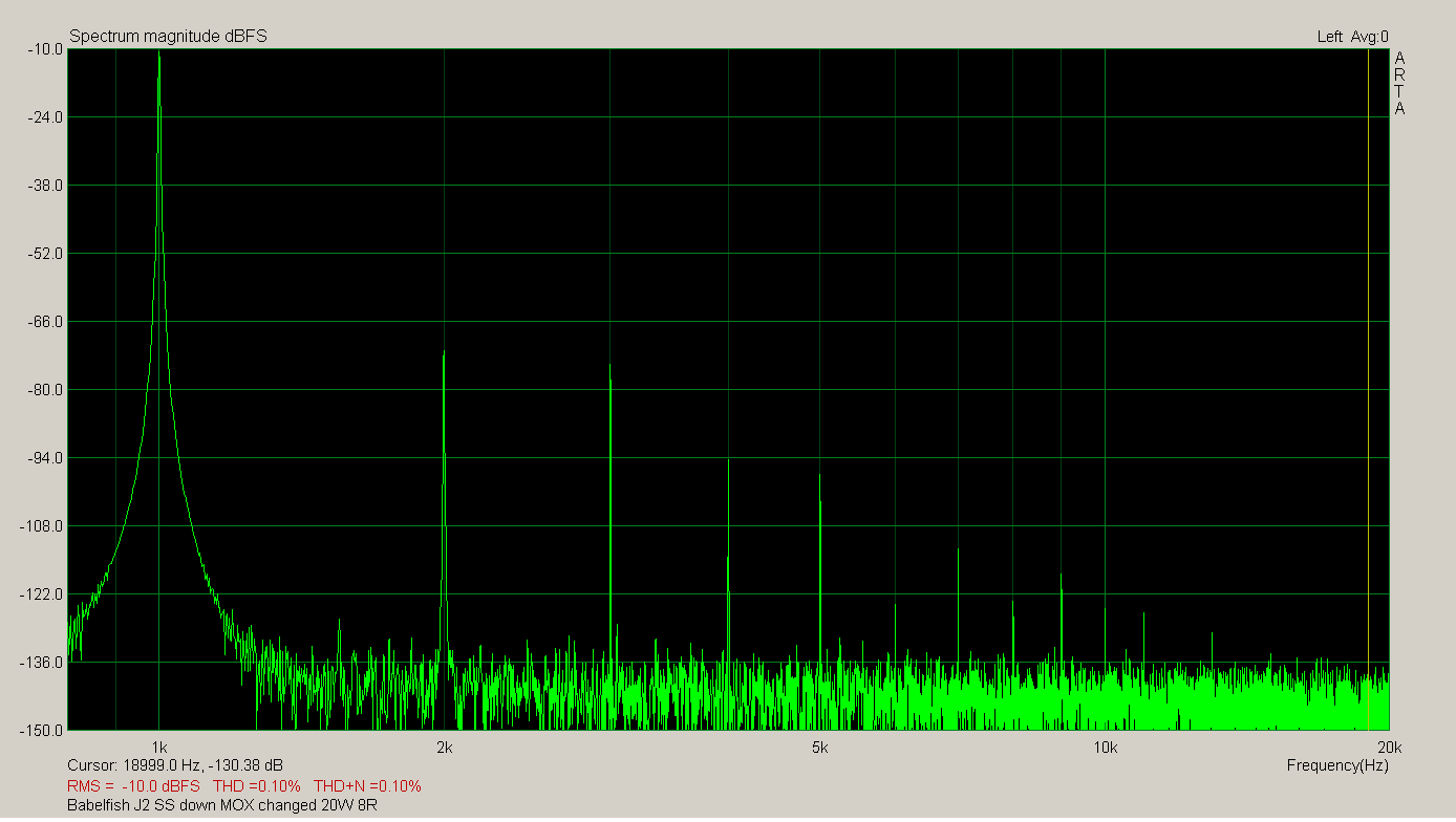

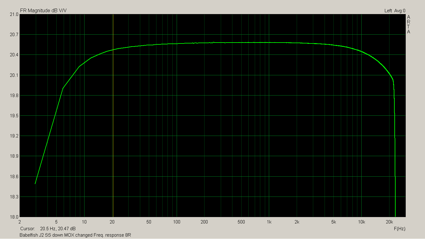

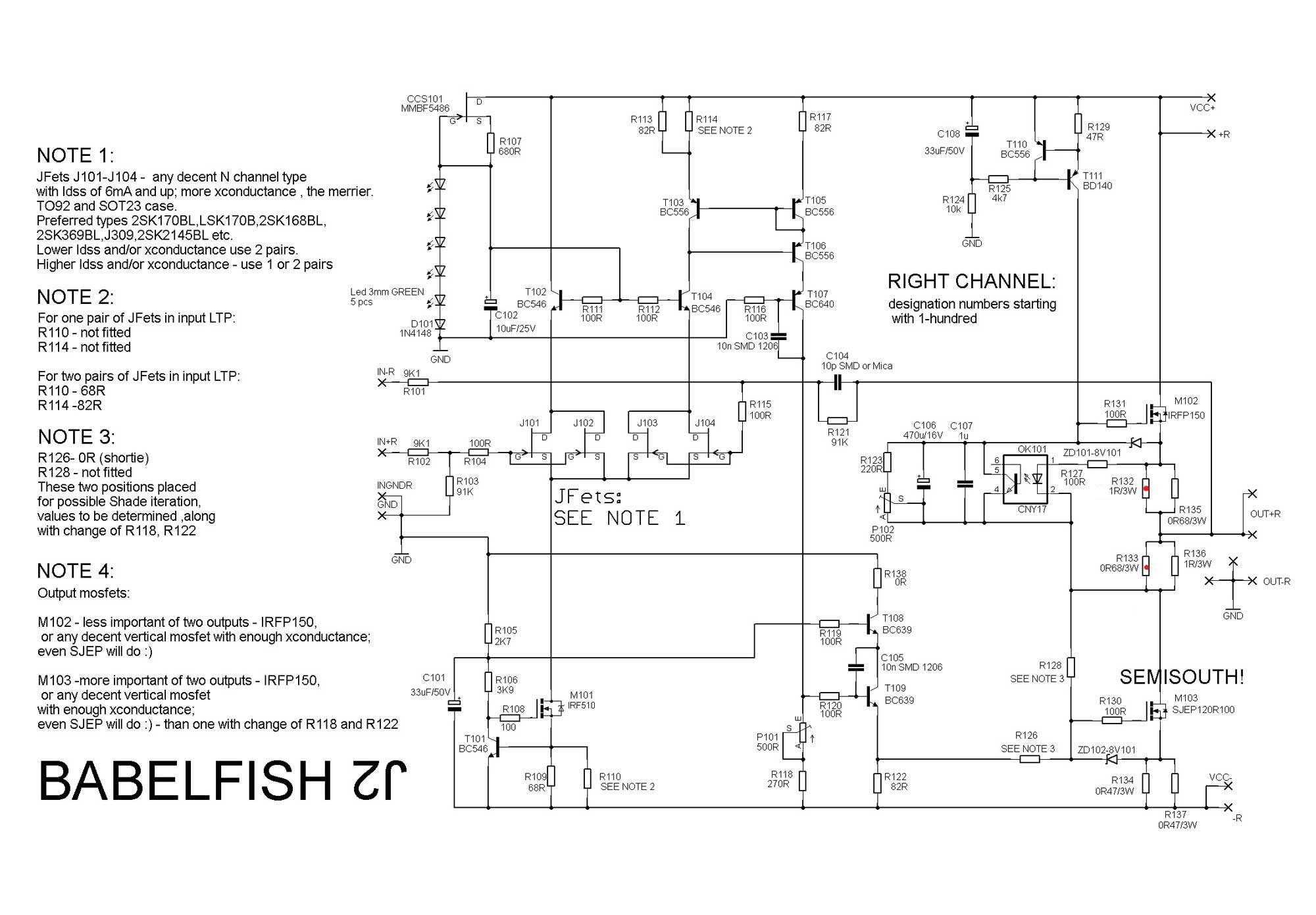

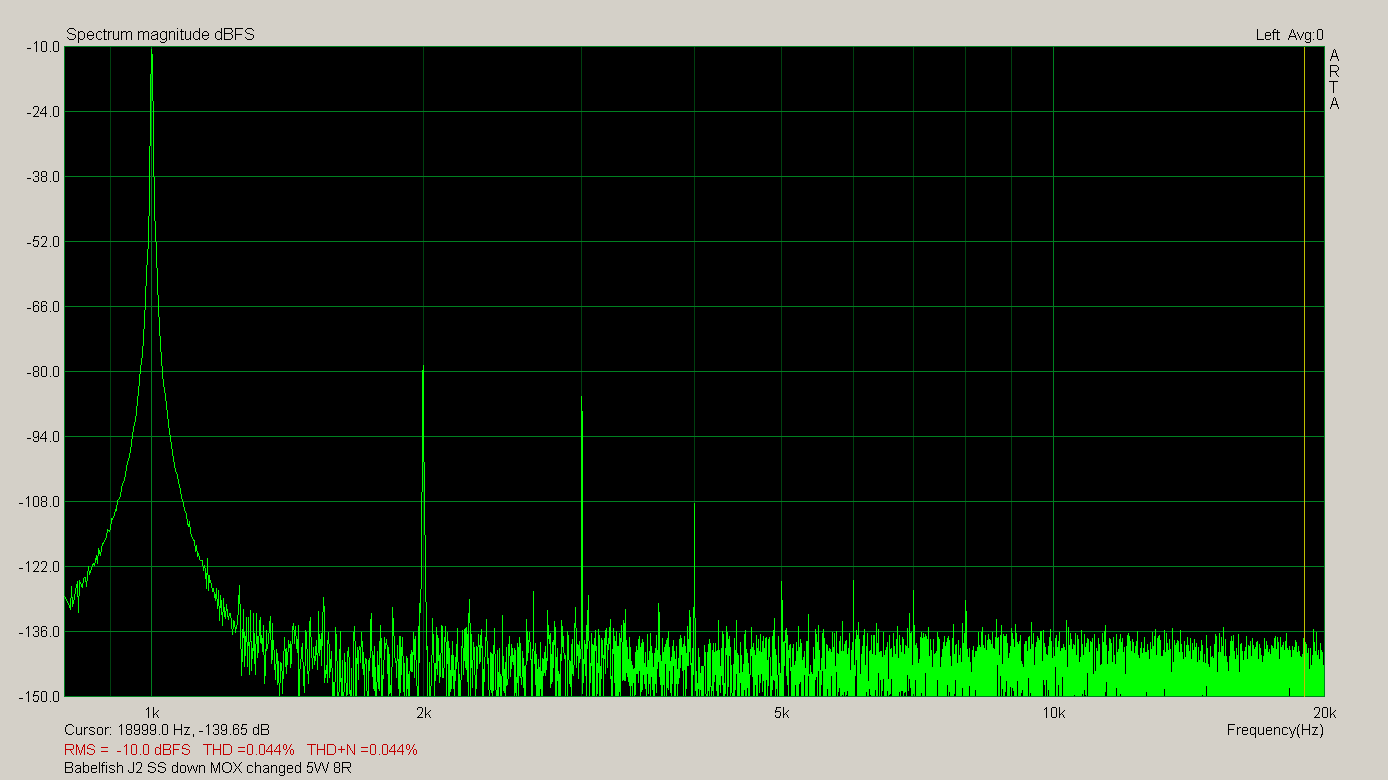

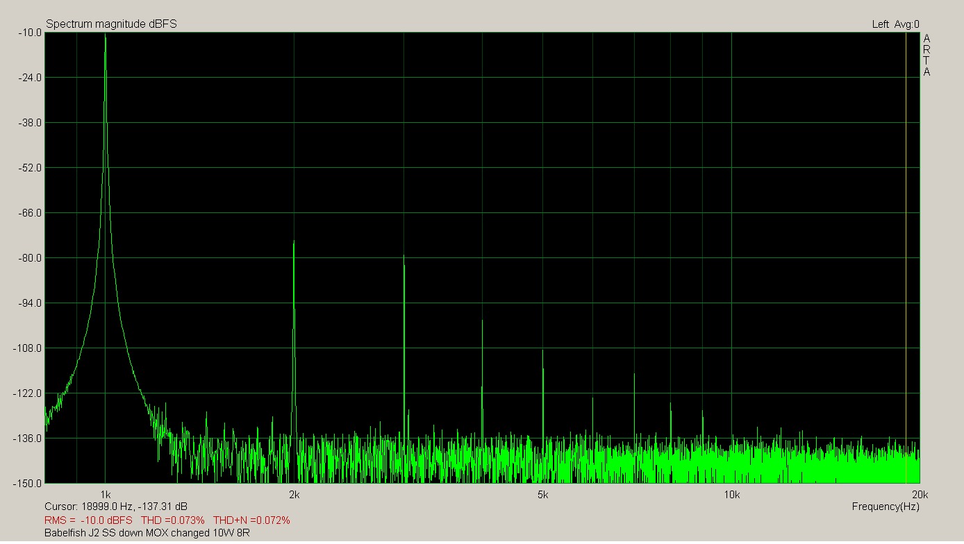

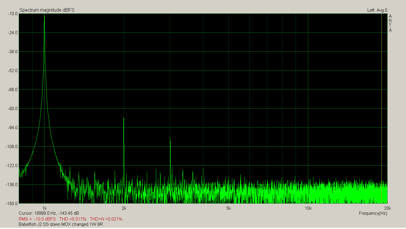

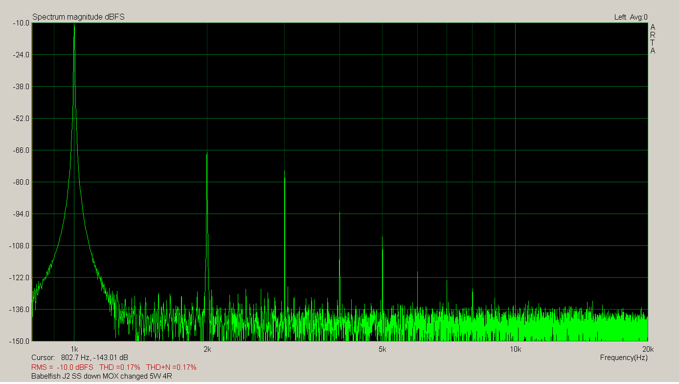

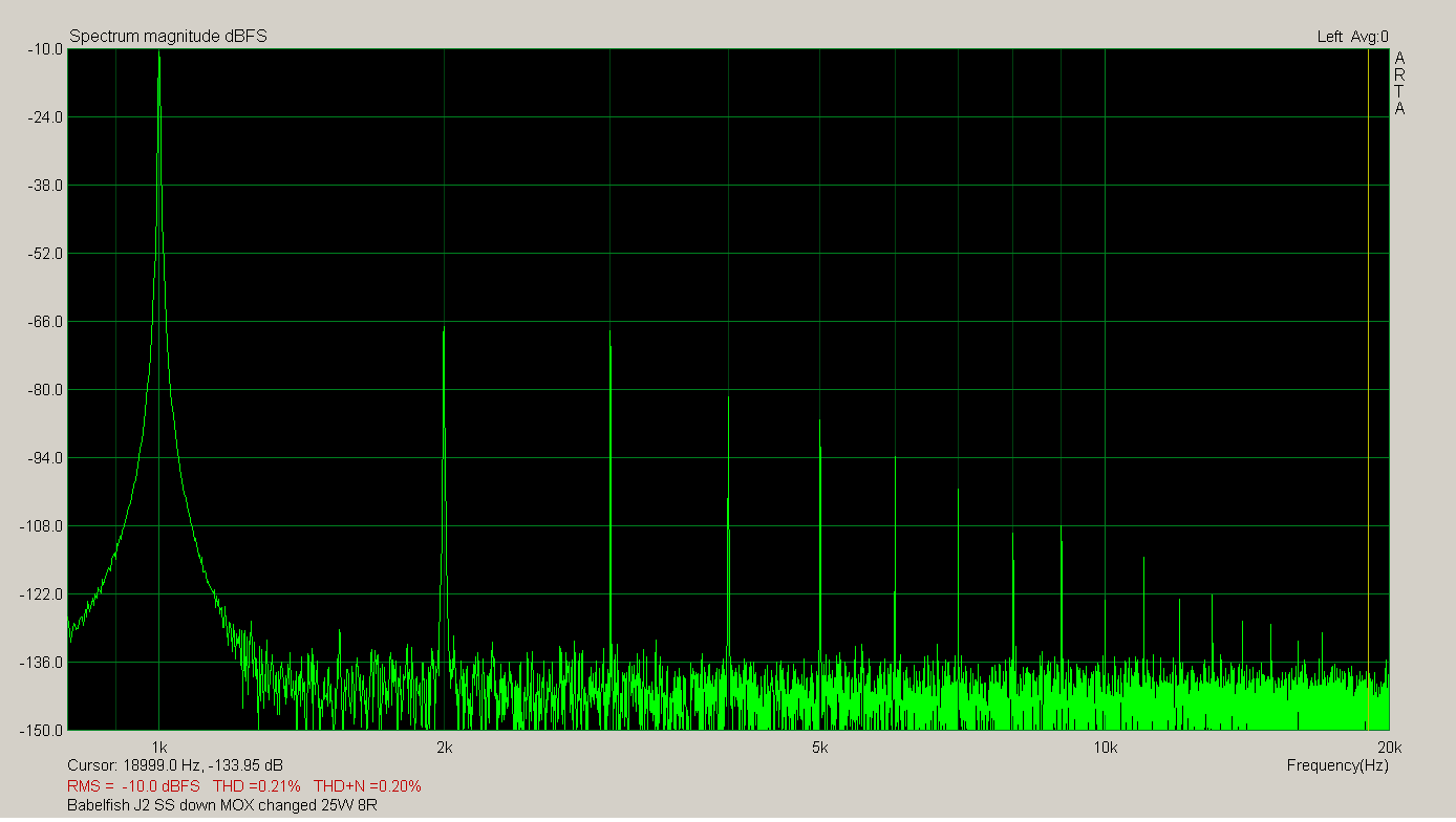

Semisouth down , MOX changed , 8R load
see two red dotted resistors ; comparing to previous sch. , these two resistors are swapped
so , looking at graphs and THD levels - still Pin(g)point Machine , more mellow

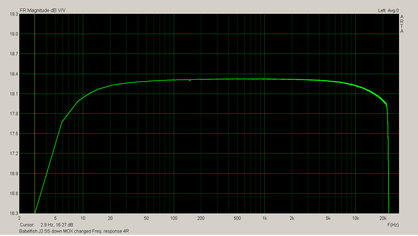

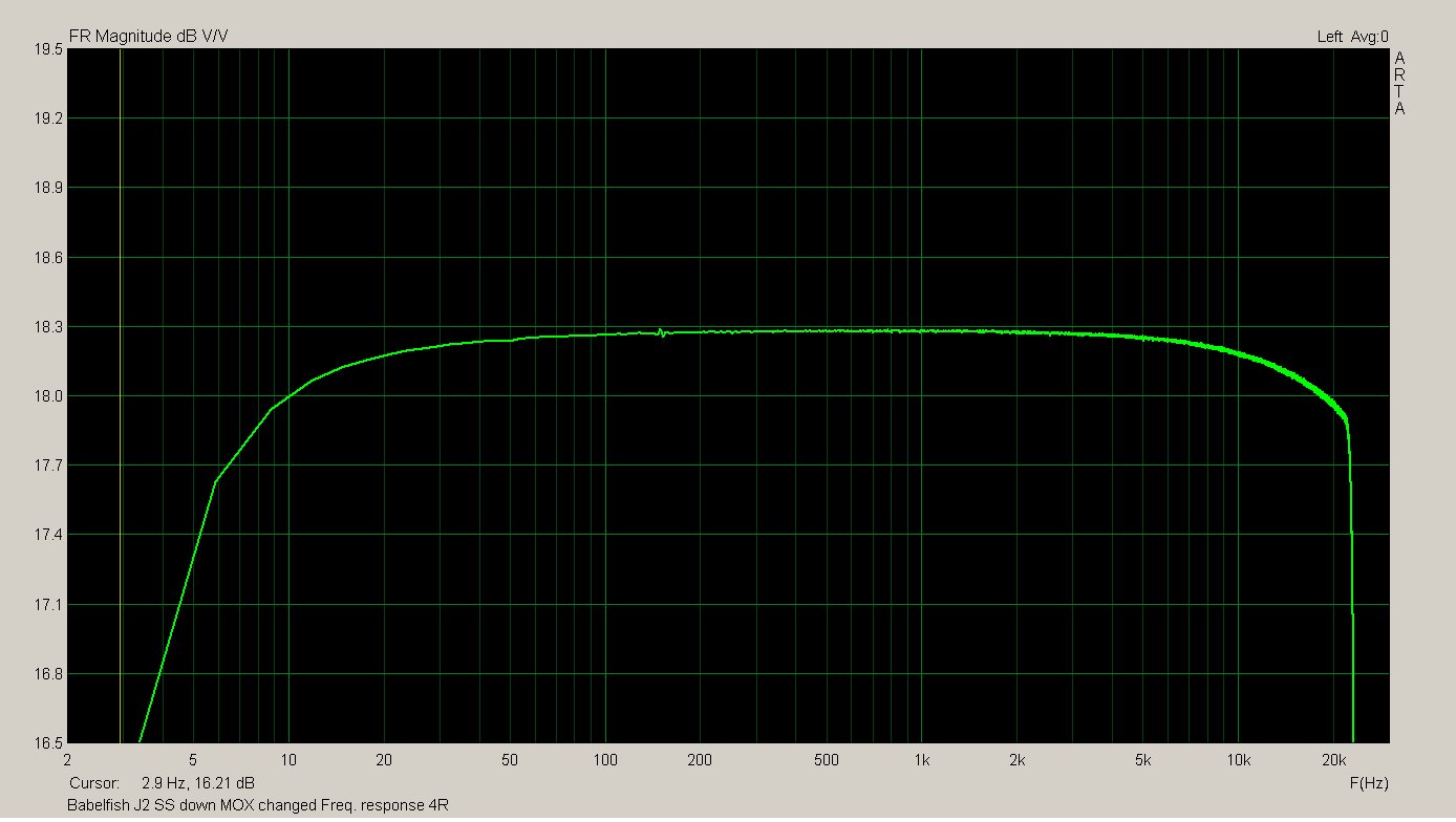

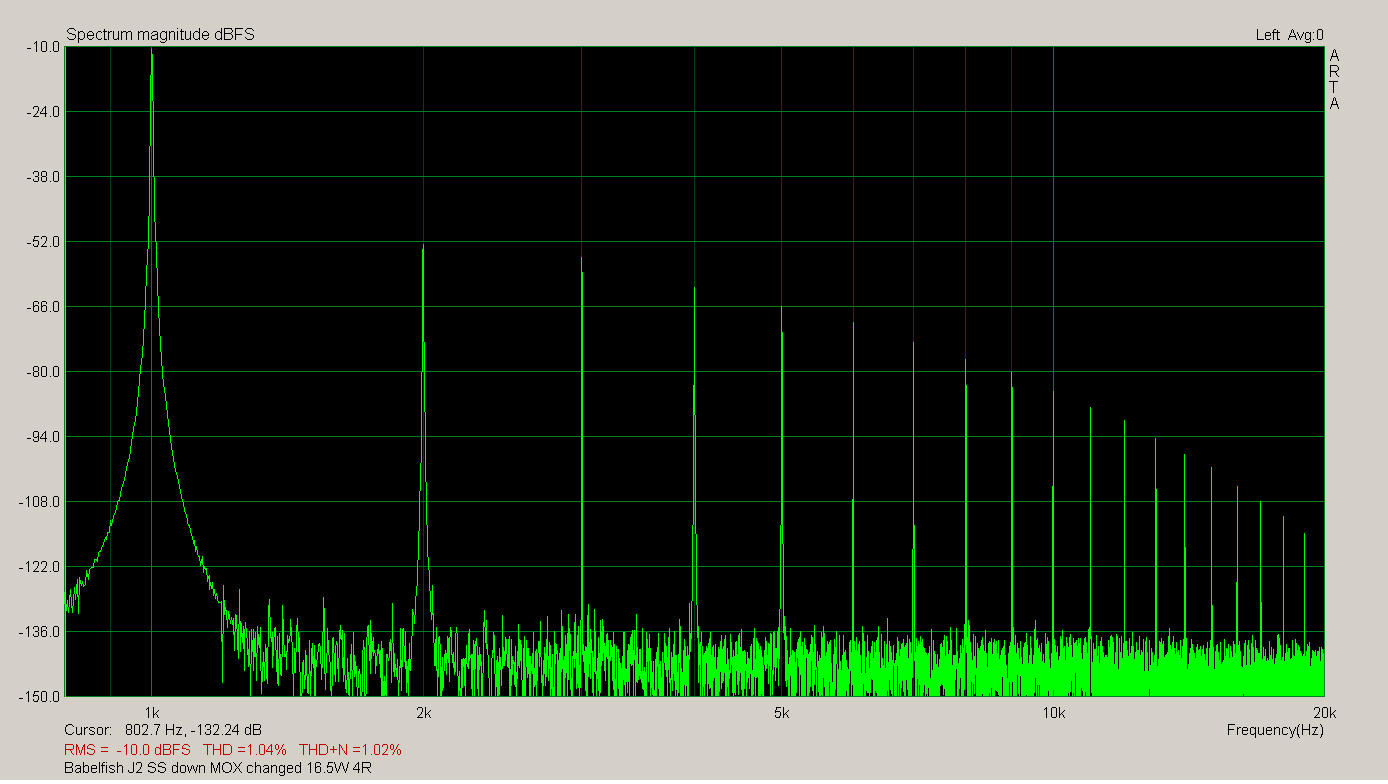

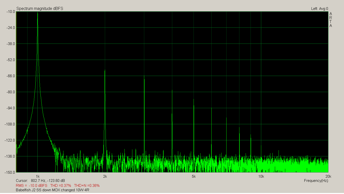

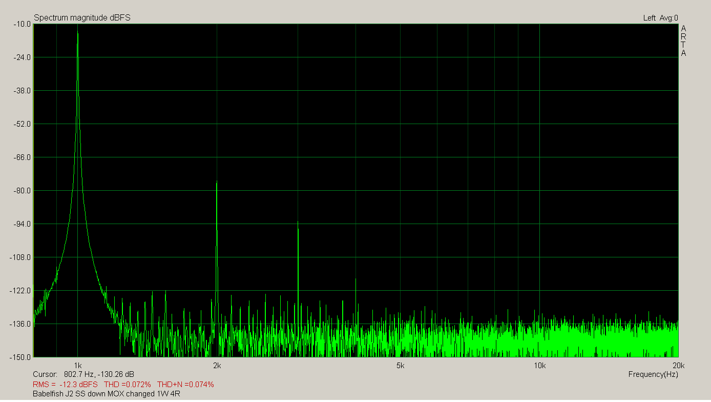

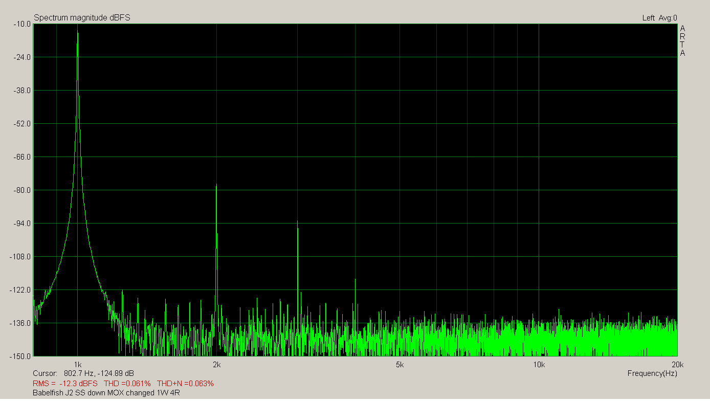

Semisouth down , MOX changed , 4R load
max power graph for 1% THD .......

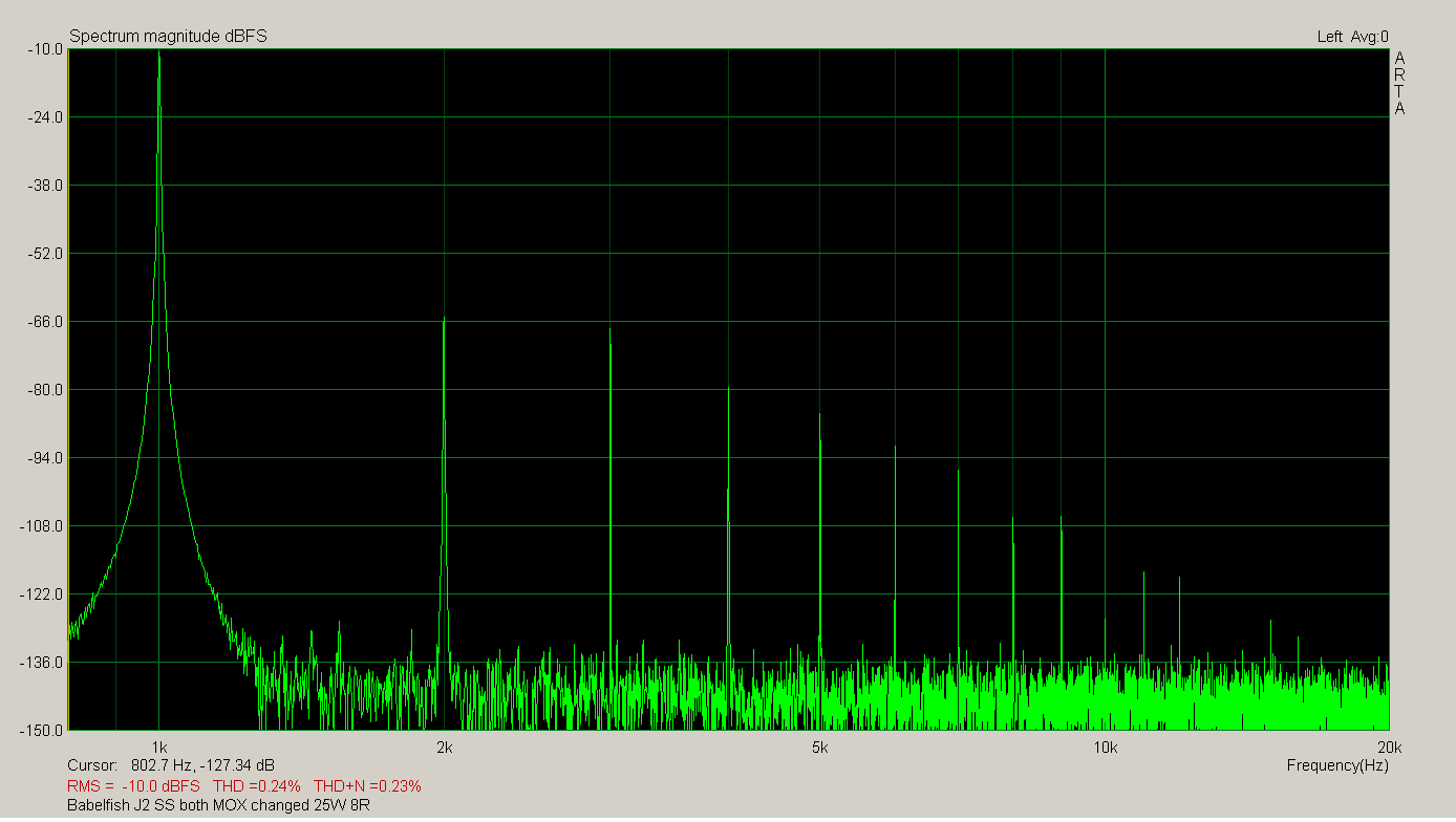

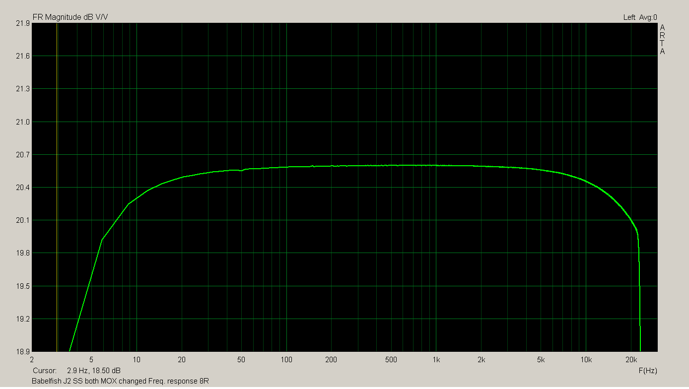

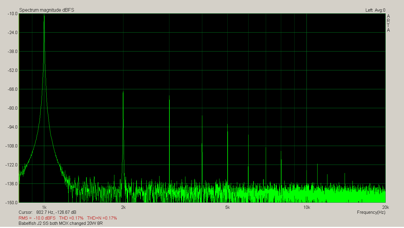

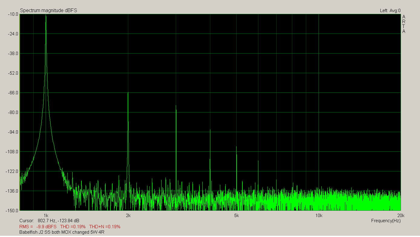

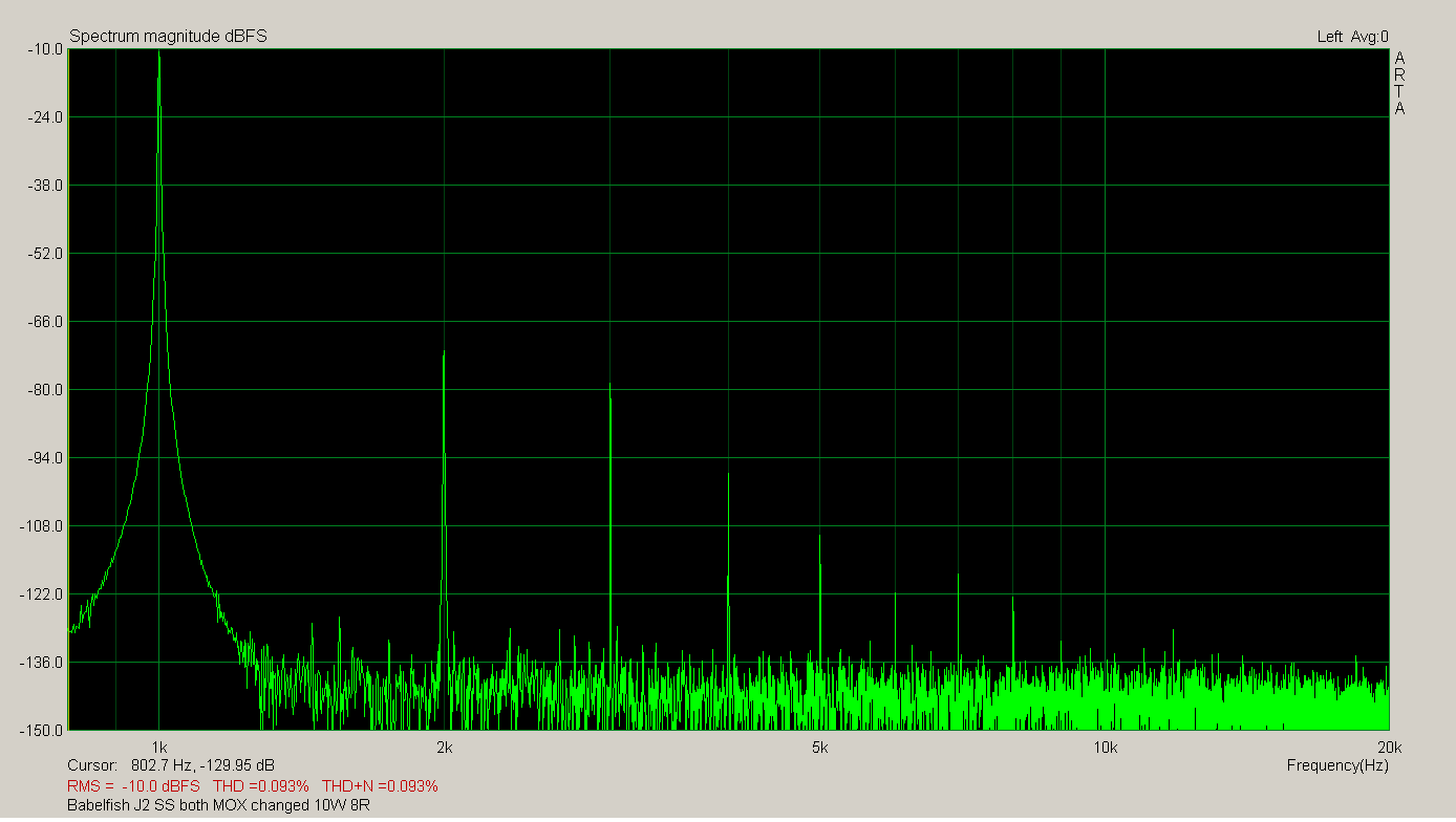

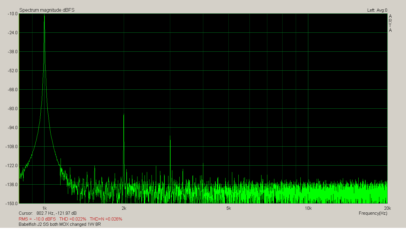

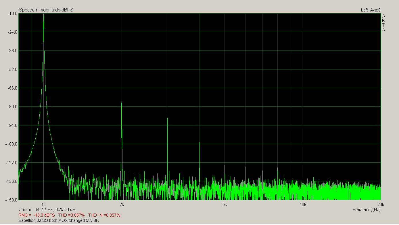

Semisouth both , MOX changed , 8R load
schematic same as previous , ignore IRFP150 title on upper output critter
this one even more mellow than "SS down"

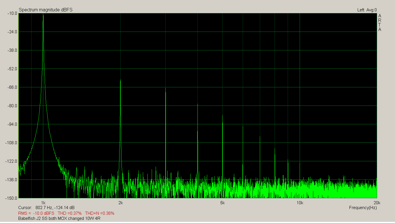

Semisouth both , MOX changed , 4R load

I enjoyed listening all- IRFP iteration more than 6 hrs today ....... typical (part of) long term test, listening while working 🙂
finishing my own SissySIT , so pleasure was ..... quadrupled
what can I say , without straining in FiFi vocabulary ....... let's say it as - didn't found sole thing to complain
details , dynamics .... and bass is super-layered ....
after few days of listening , I have nothing to add , except that my green is not around my entire head ...... now it is twice around my entire head , all that with full IRFP150 output
someone said - who needs Semisouths ?
as shown , if you have them, at least 3 similar but different enough amps are possible ; for someone having SSouths , I personally believe that iteration with SS down is most interesting , under condition of having sweet enough speakers per se
for Moi , even if having SSouths , full IRFP is still most fun
Hasta La Vista .... Make my day, Punk ....... Family is everything .... I Love the Smell of Napalm in the Morning ...... I'll be back ....... and I'm done with this amp.
