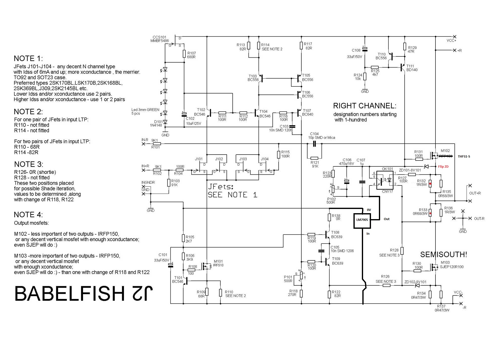

Got sort of crazy idea, a Sissy Babelfish Jᄅ SIT bstrd.
I pulled the trigger on 4 matched THF51-S, shouldn't be too difficult to re-jig the bias on the top IRFP150 (M102), and play with R132-R136.
Is it worth thinking about?![]()

Just thinking out loud, would the LM7905 0V need referencing to the output?
Oops, just realised, wrong thread.
it simply hurts , how lousy Mu Follower that would be
if anything , you'll have benefits of putting SIT down , not up
I saw my mistake, need to ref to top of M103.
I could put one up and one down, but what would I do with the Semisouth's?
