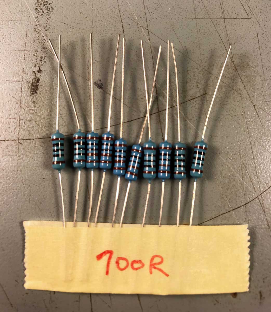

all resistors in Sissy and Babelfish M25 are regular 0207 size , meaning - your plain old good Metal Film resistor ...... nowadays being more like 600mW , not 250mW as in Yore
yup , I got several bags of 100R ones from my Vendor , sized more like 1W (somewhat bigger than 0207) , but I didn' made a fuss about that , simply because they are not too big - right enough to be put through holes without awkward bending of da legz
however , and this is important:
as I'm informed ( twice !) in last few days , it seems I had some strangers in my 100R bags , so please check all 100R buggers you got from me
blame is on me
(as always , and I'll blame Papa , as always) , that I didn't catch that and packed them and labeled together ...... but primary blame is on my Vendor - I know that they all were in same plastic bag , prior to opening it and pouring in plastic drawer ......
I got one sneaky one...
Not a worry ZM. Thanks for letting us know. Great reminder to measure EVERY resistor before stuffing...
Is it brown, black, black, brown, brown... or brown, brown, black, black brown? Hmmmmm?

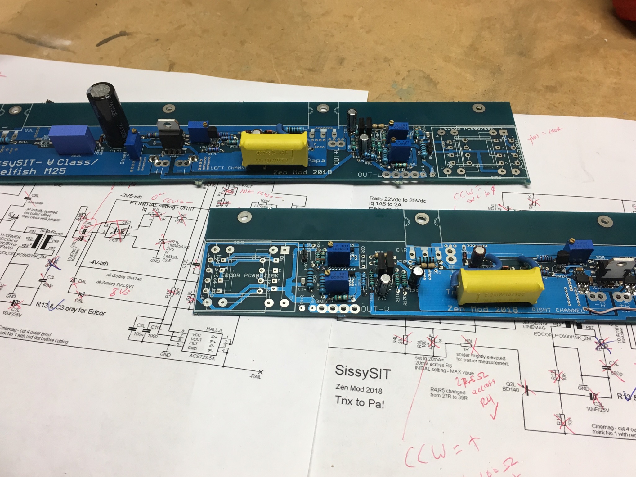

Finally got the chassis. Test fit of SITs. I have determined that I have zero skills for tapping. Went through 2 bits and a tap for 4 holes. Learning as I go...
If all things go well, I should have a dual mono PSU and new chassis set up for it tomorrow or Thurs 😀.

Use WD40 for drilling and tapping. Take it slow and gentle on tapping, back it out and remove the dreck often. Summary: slow, gentle, lube.
I learned the hard way on re-purposing some Rawson amp chassis by breaking a few taps.
By the way, tap jokes never get old (to me).

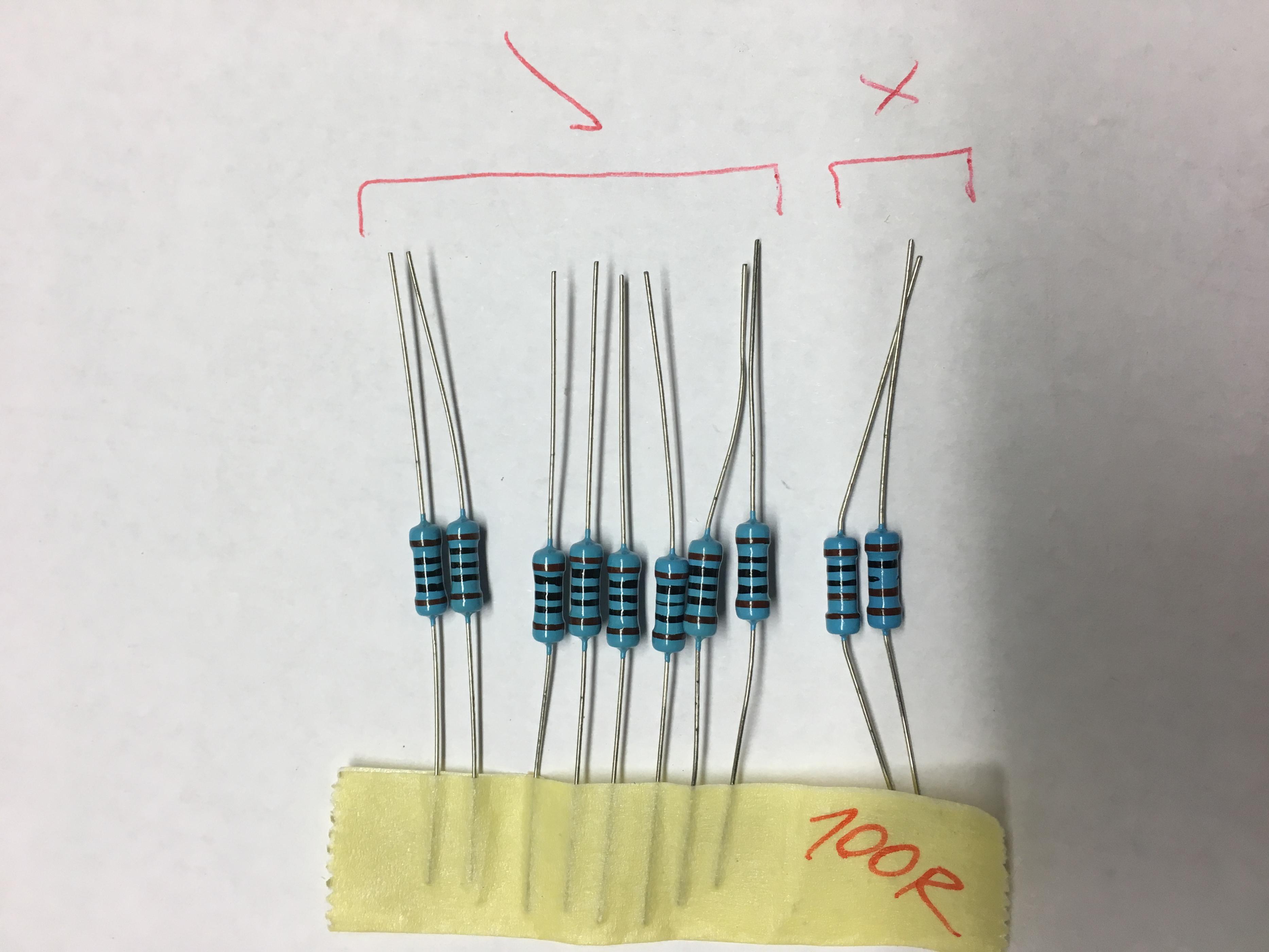

I cut out the R13’s after I saw the big note
Phillips caps installed.
Waiting for Cinemags...
I saw the note about 100R - it looks like a few stray critters made it into my shipment! One on each board. My habit is to measure first one I pull from a bunch. Oops. Easy fix, glad I caught it now. Early is much better.
