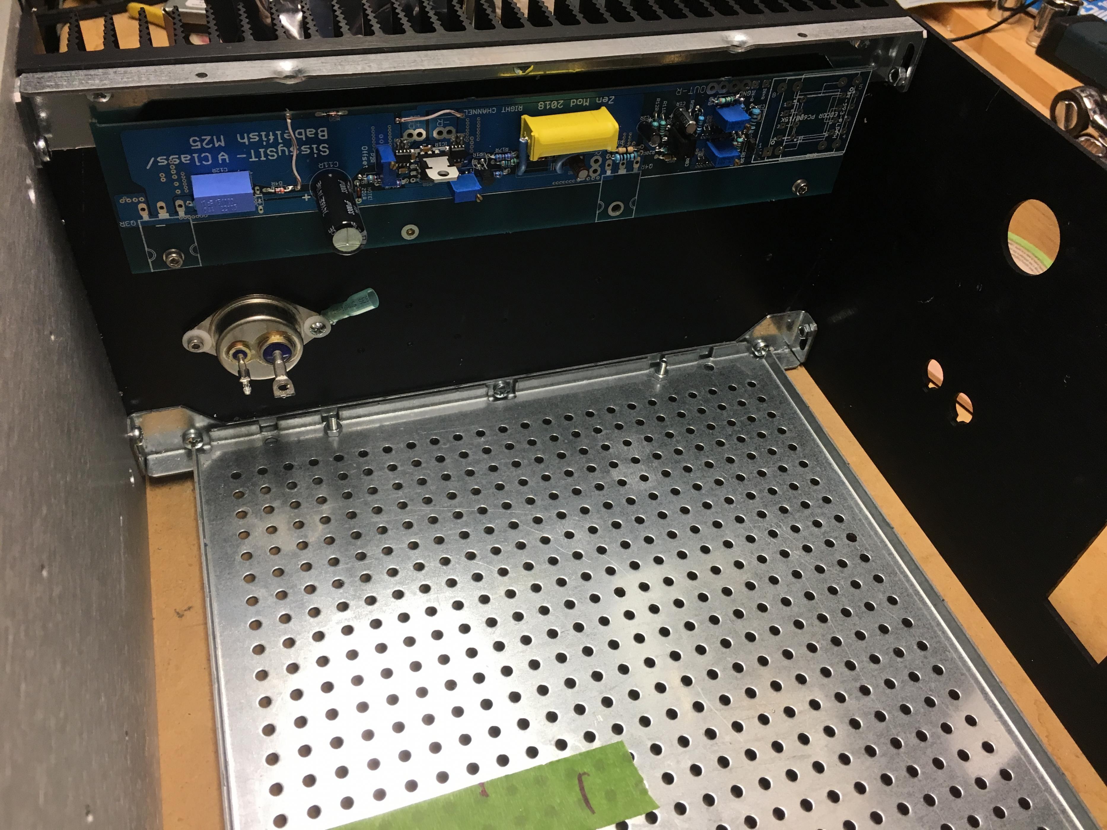

Thanks for the picture Cal! You made my life much easier!
I was initially bummed out when I bought the chassis and then realized there was a deeper version that I didn’t buy. I went to 4U deluxe and clicked order. A drop box for the deep version would be handy. In any case I was going to drill an L bracket and mount the board, then put the SIT up high. Your picture made a light bulb go on. I did a 6-32 tap and test mounted a channel. Left and right will be swapped to mount upside down - no big deal.

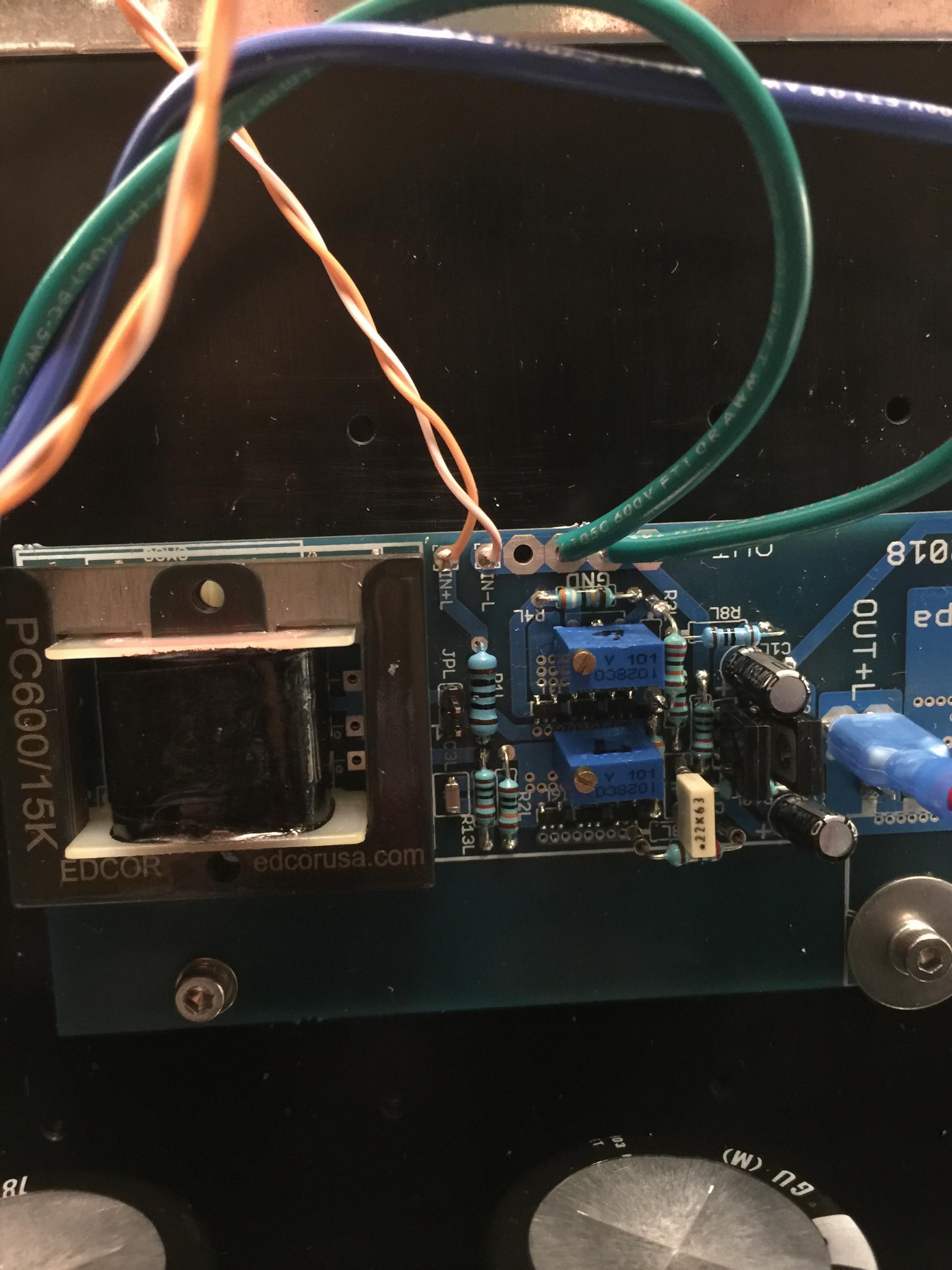

I need a bit of help troubleshooting, please.
I got one channel all the way through...
.... Quote ZM - "if you're in ballpark of - say- 150-160mV and nice offset , put lid on and wait 10min , observing readouts all the time
coffee or tea are nice to have in proximity , and use it ........"
I powered off and connected the second channel. It is not behaving, and I cannot determine why. The initial offset and voltage seem fine. However, when I go to increase the Iq, the voltage does not increase per the norm. The voltage stays the same at 9.1mV or so, but the offset increases steadily and more rapidly than the norm with each turn of P1.
Here are a few pictures of the board in question. Any help is greatly appreciated.

...... The voltage stays the same at 9.1mV or so, but the offset increases steadily and more rapidly than the norm with each turn of P1.
try fiddling with in same time with DC Offset trimpot ; can't see properly wires on SIT , so check did you wired it properly ..... need to tell that just in case
also confirm that you have proper 5V at output of 7805 reg

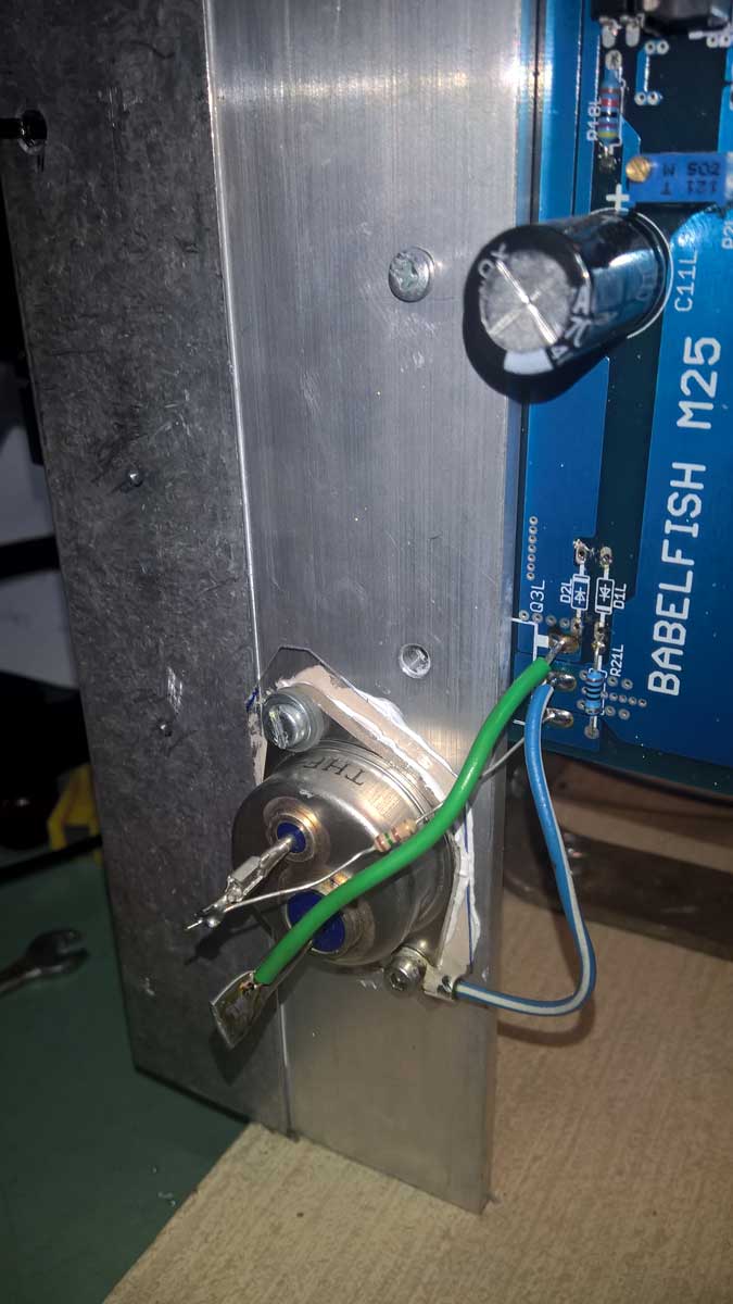

Looks to me like you've got your SIT connections backwards... I copied the wiring from ZM's image below. Center pin to the inside-most connection, ground to the middle, flying resistor to the outside connection:
I think you nailed it. I just got home, and I'm beat. I'll fix in the morning. Thank you! :cheers: :D
I tried to be so careful and look at the schematic. I did not notice that the left and right were opposite. I looked at the little "line" on the board. Hopefully I did not damage anything...
Edited to add... Left and right are wired differently, correct? Just triple confirming. Right set up perfectly... but I want to be super-sure.

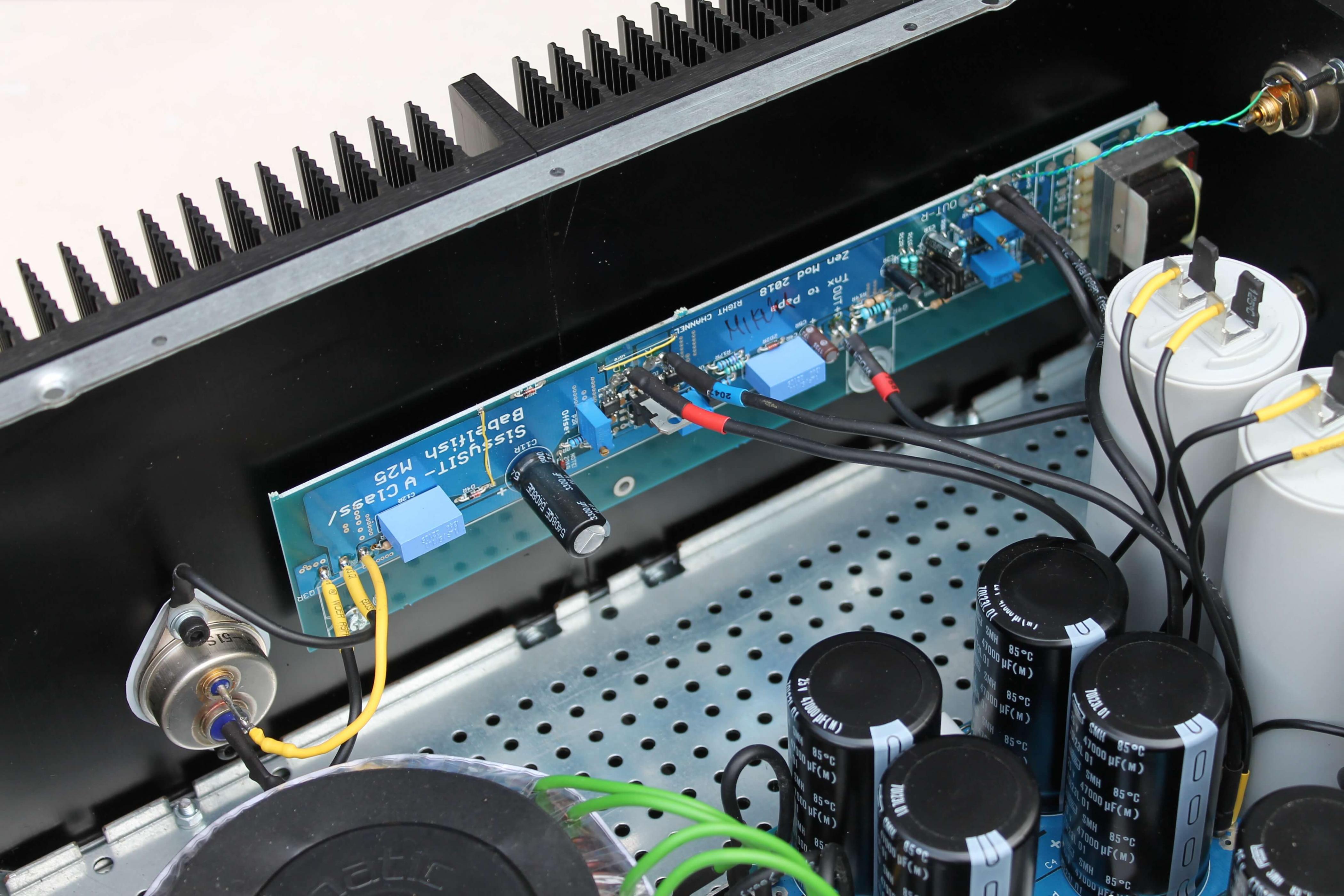

Yep. You can see the other channel in Zen's build for Miko in the SissySIT thread: SissySIT (photo lifted from there and attached below)

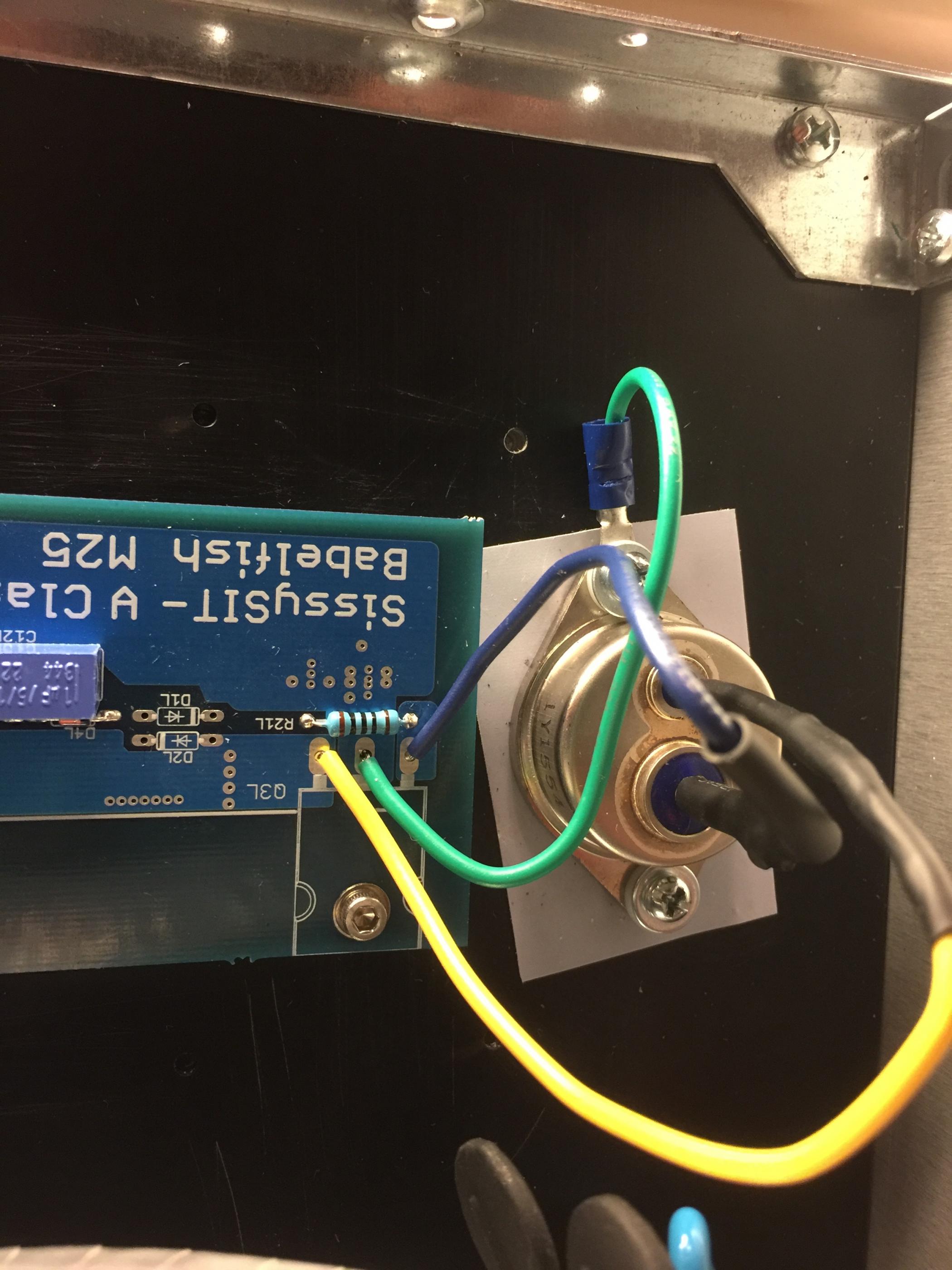

I need a bit of help troubleshooting, ......
........can't see properly wires on SIT , so check did you wired it properly ..... need to tell that just in case ......
wrote that this night , Today, 04:23 AM ........ forgot to power on that anti-mosquito thingie and had few harassing me , so I woke up ...... had a look at Greedy Boyz space ...... pretty much logical that I didn't saw clearly first pic - definitely miss-wired SIT
