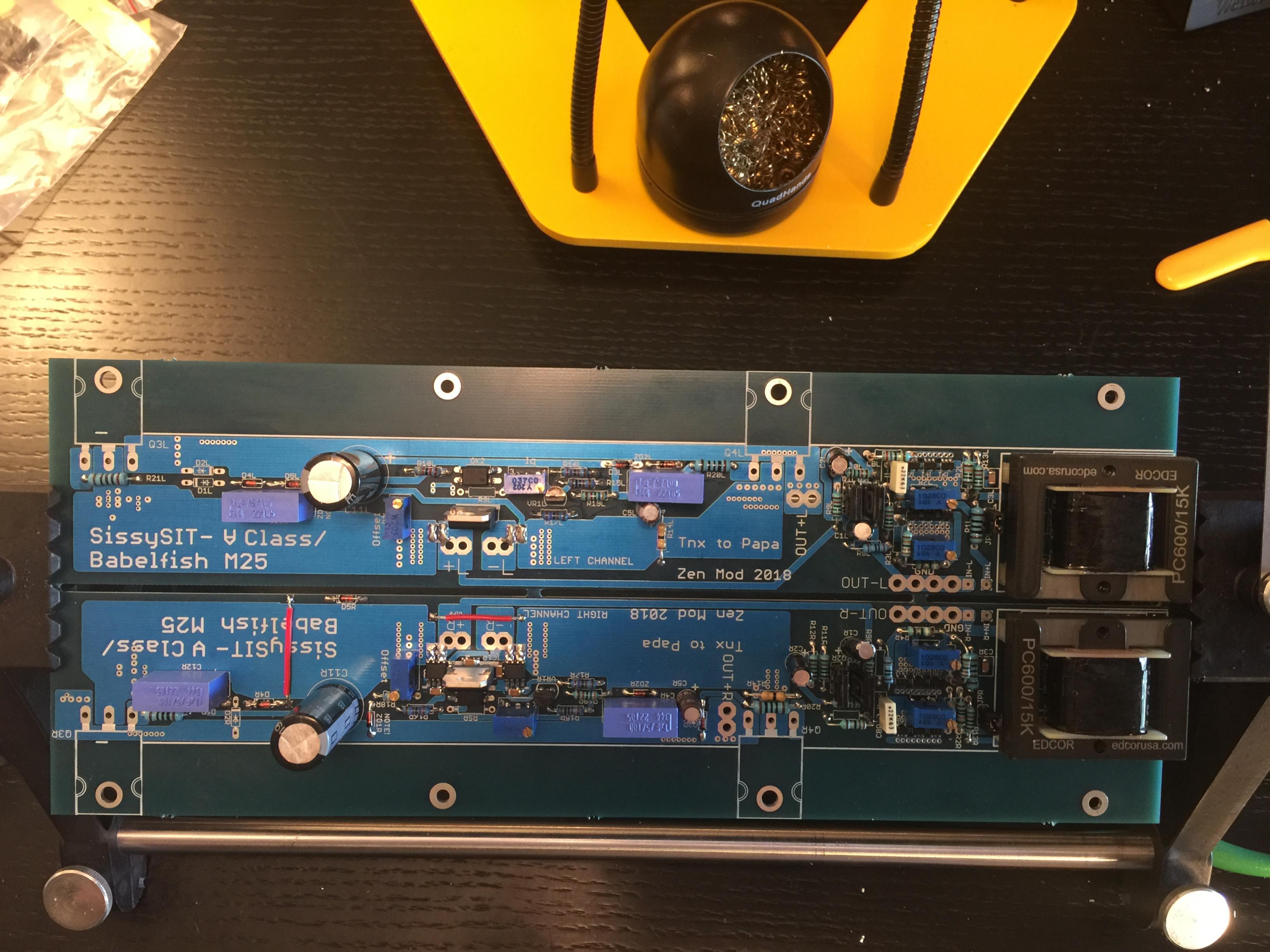

Got my boards today. They look great! That should be everything I need to finish the build. Getting my build sequence / process together now. Can't wait.

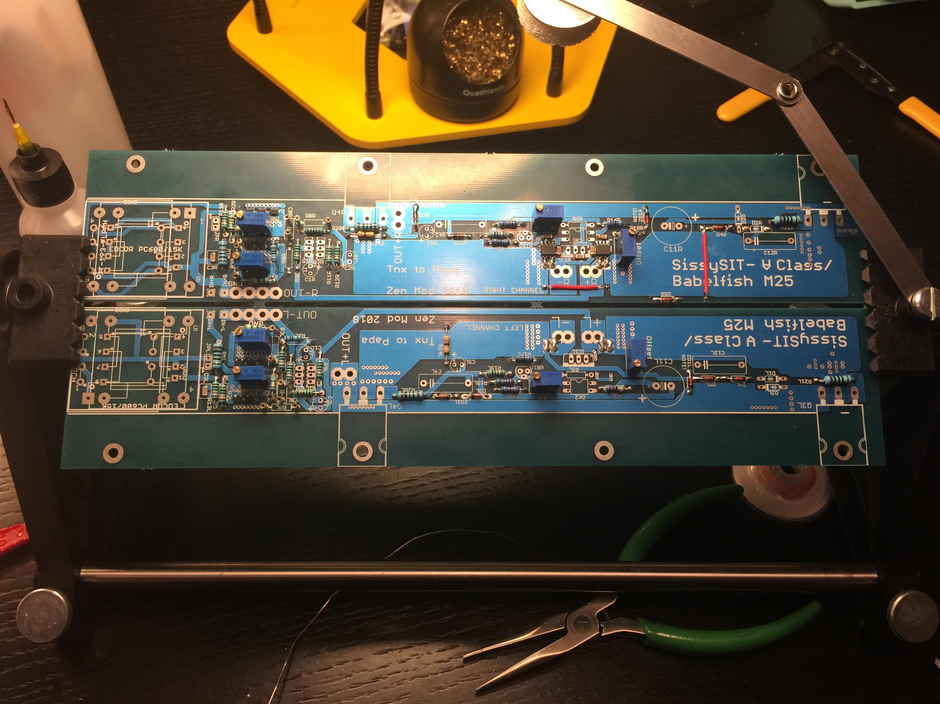

ZM - The board layout and your instructions are excellent. Thank you! Made 2 dodo errors (Installed D2 instead of D5 on one board and swapped R16 and R19). Fixed after verifying against schematic and the BoM I made.
Question. I am attempting to follow very closely for the setting of the Pots during installation. I have R6 and R7 set referencing R4 (28ohms across) and R5 (0 Ohms across) accordingly. I have P2 set to mid point at 10k even though it is not too important.
I am struggling with how to set the 2K P1 pot. In post #603 ZM is very clear re: how to handle R6 and R7. Then it is mentioned for P1 - "confirmed with ohmeter...whichever way you find adequate".
Could someone provide guidance re: how to properly set P1 to 0 Ohms? I have not found it in the thread, so please forgive what is most likely an obvious question. I have not installed VR1 or anything further than the pots in ZMs guide in post 1.
Much appreciated!

If you look at the schematic, P1 is located between Pin 1 of OK2 and R15/VR1. Put the ohmmeter probes at those two locations and measure. Adjust P1 back and forth to confirm that you are changing the resistance, and adjust P1 until you have zero resistance.
"whichever way you find adequate" was written taking in account possibility that pcbs are already on heatsink and that you're checking P1 fiddling with pins of neighbouring parts
that's usually tin foil hat time , needing some staring at goats and schematic , to decypher which parts and which leg of these are exactly connected to P1
in case when pcbs are still free to mingle in hands , simply put probes between solo pin and (now soldered together) pair of pins of P1
simple as that

It is the front of board answer and Zen Mod provided the simpler back of board answer.
"So whichever way you find adequate".
Zen Mod's doesn't require the tin foil hat, goats, and schematics though. 🙂

ZM - I should have thanked you too for the reply in #951. Silly me didn't see it from the phone. I should have looked at the traces on both sides of the board... DOH!
I am starting to get a much better grasp of the goat whispering required to understand a schematic. 😀 A bit of reading online and a few classes is serving me well to start understanding. Who says old dogs can't learn new tricks.
As I learn, the DIYAudio community has my gratitude for helping me not blow up parts or burn down my house. That keeps a happy wife and happy life.
Next step is to finish up the boards, get a proper set of taps, and maybe get the tool or something similar Ben Mah mentioned in #940 to mount the SITs. Sadly, until I get a different / new chassis and build another PSU, the M2x boards will be giving up their home to the SissySIT for a short time.
