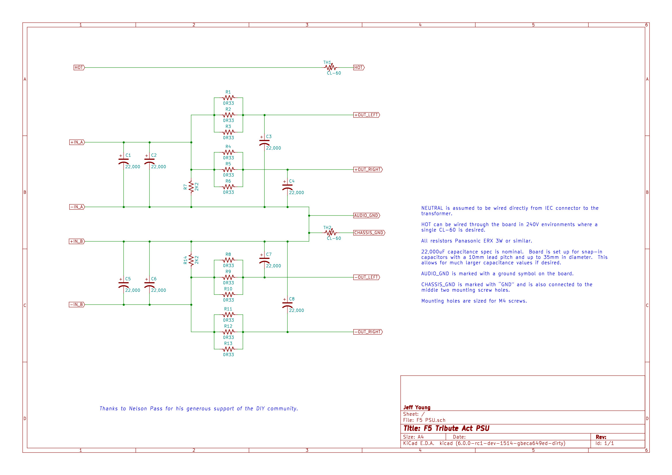

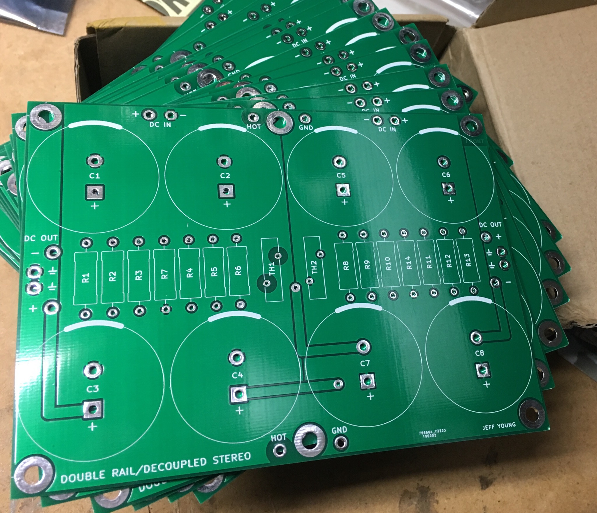

I'm planning to use a single power transformer for a stereo amp with dual bridges, snubbers, and CLC supply. The 2nd set of caps will be split for each channel using the boards in the pix.
Question: Will a single 300VA 18+18V Antek be sufficient?

If you are planning to bias at 180mA per channel like is suggested, I would go with a larger (at least) 400 VA and quad secondaries. Searching Antek's site, I don't see one close to the right voltages until you get to the 800VA with 4 each 20 VAC secondaries. Which is what I used and with my highish SIT right at 4.05 Vgs was over the limit of the of the circuit's biasing with only one channel hooked up.
It would be a lot better to use two 200VA Anteks at 18 VAC, like ZM says. (Or if you already have one 300 VA, buy one more for $41.) You can power each tranny individually, so trouble shooting each channel is less hassle.
Cost difference is only $23 USD and you can stack them using a longer bolt.
Thats what I would do if buying new for this project.
By the way, it is the best sounding amp in my stable at the moment. So worth the little bit extra to do it right.

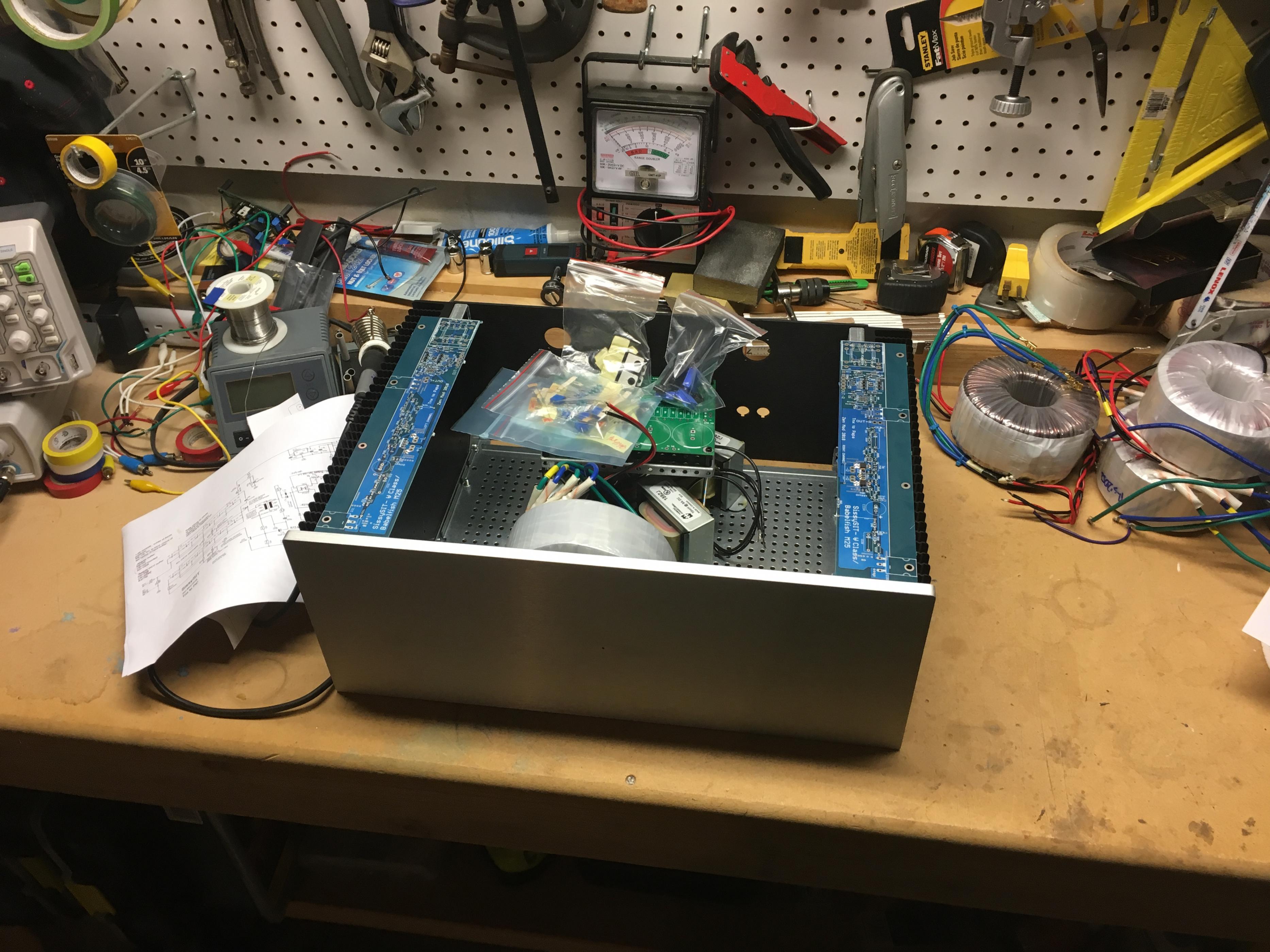

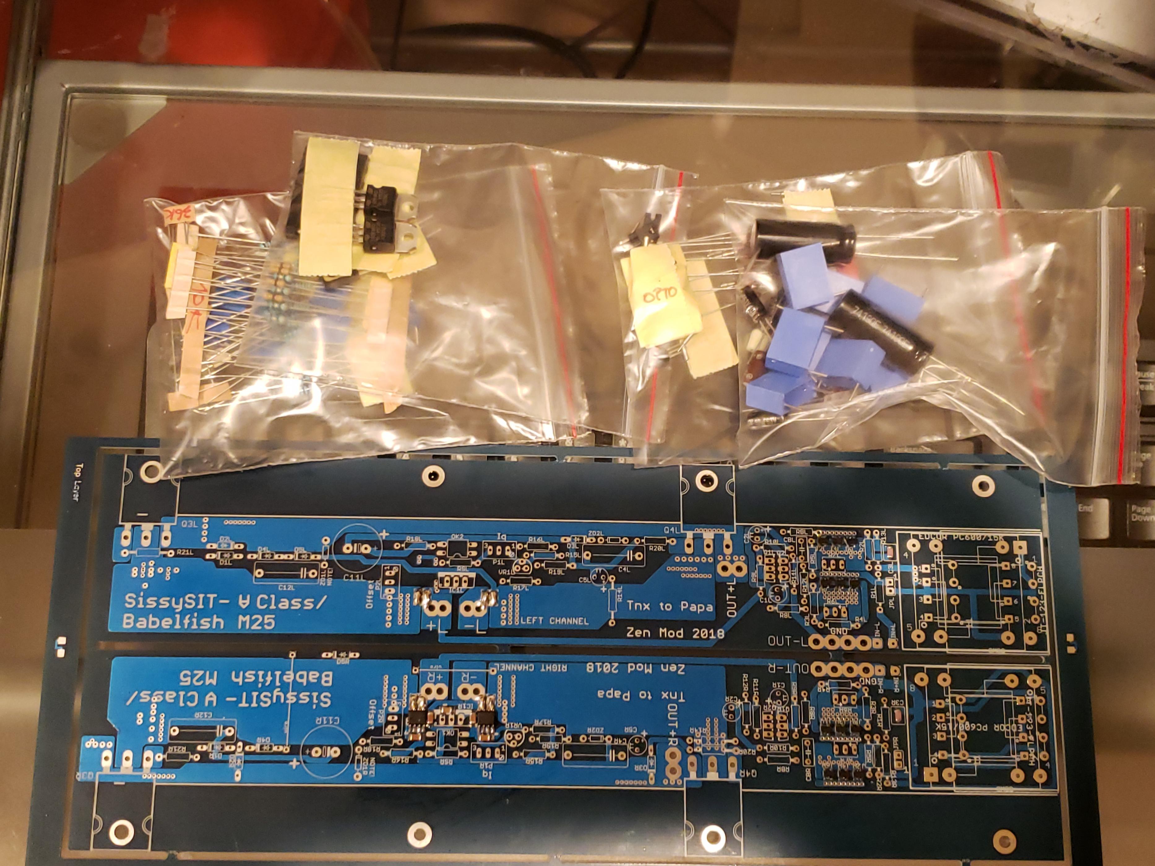

Crisis averted. AS-4218 exists. I'm getting one from Antek, and one from 6L6's library of spares. I'll continue with chassis layout. Waiting for ZM's boards (in transit, tracking daily), Cinemags (mfg yet? in transit?), and Anteks.
