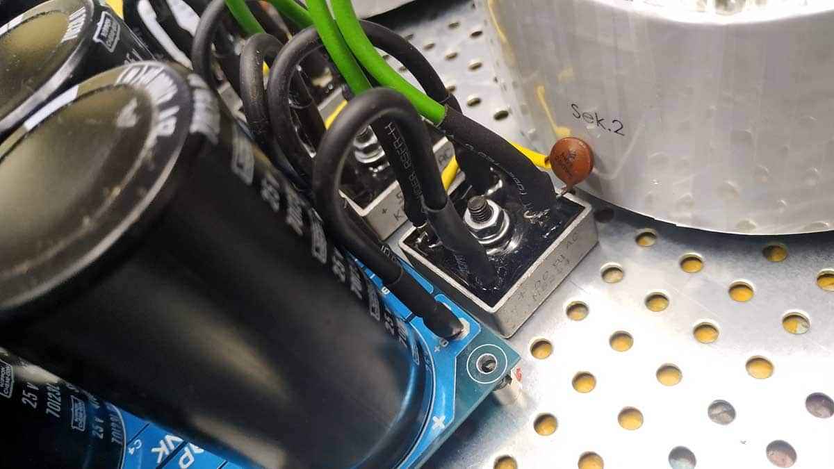

Hi Zenmod,
What is the value of the capacitor that you put across the secondary on the bridge rectifier on your Sissysit build. Is it calculated or first capacitor on top of the part bin?
Hubert
thumb of rule cell from Yore - 1K+1nF
didn't had time to make Quasimodo
go figure level of my laziness
Ahaha I was kind of lazy too that why I was asking

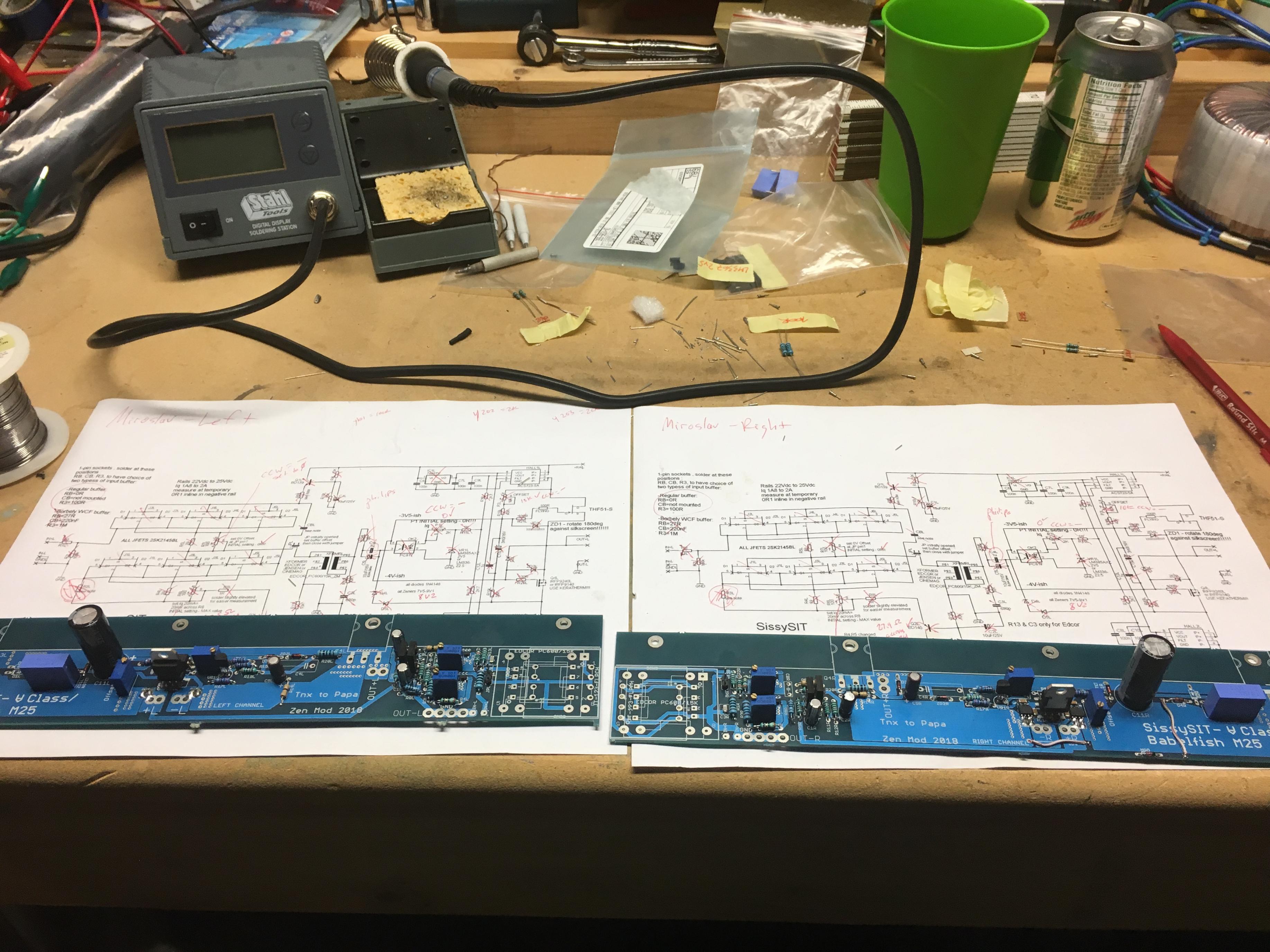

All the parts for the Sissysit are coming along, should be able to begin the assembly as soon as I received your boards that must be stuck at the Canadian border and... the cinemag trafo..
