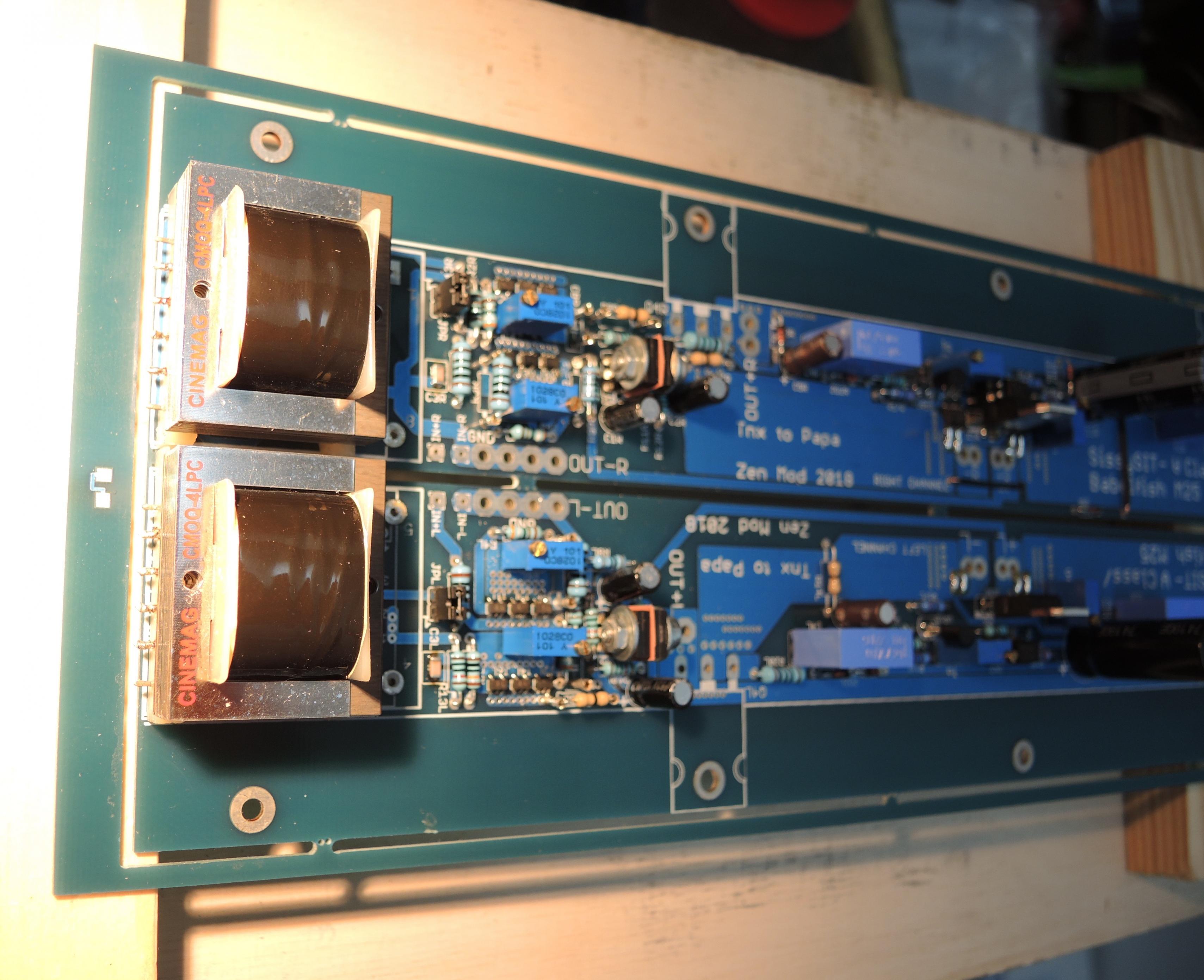

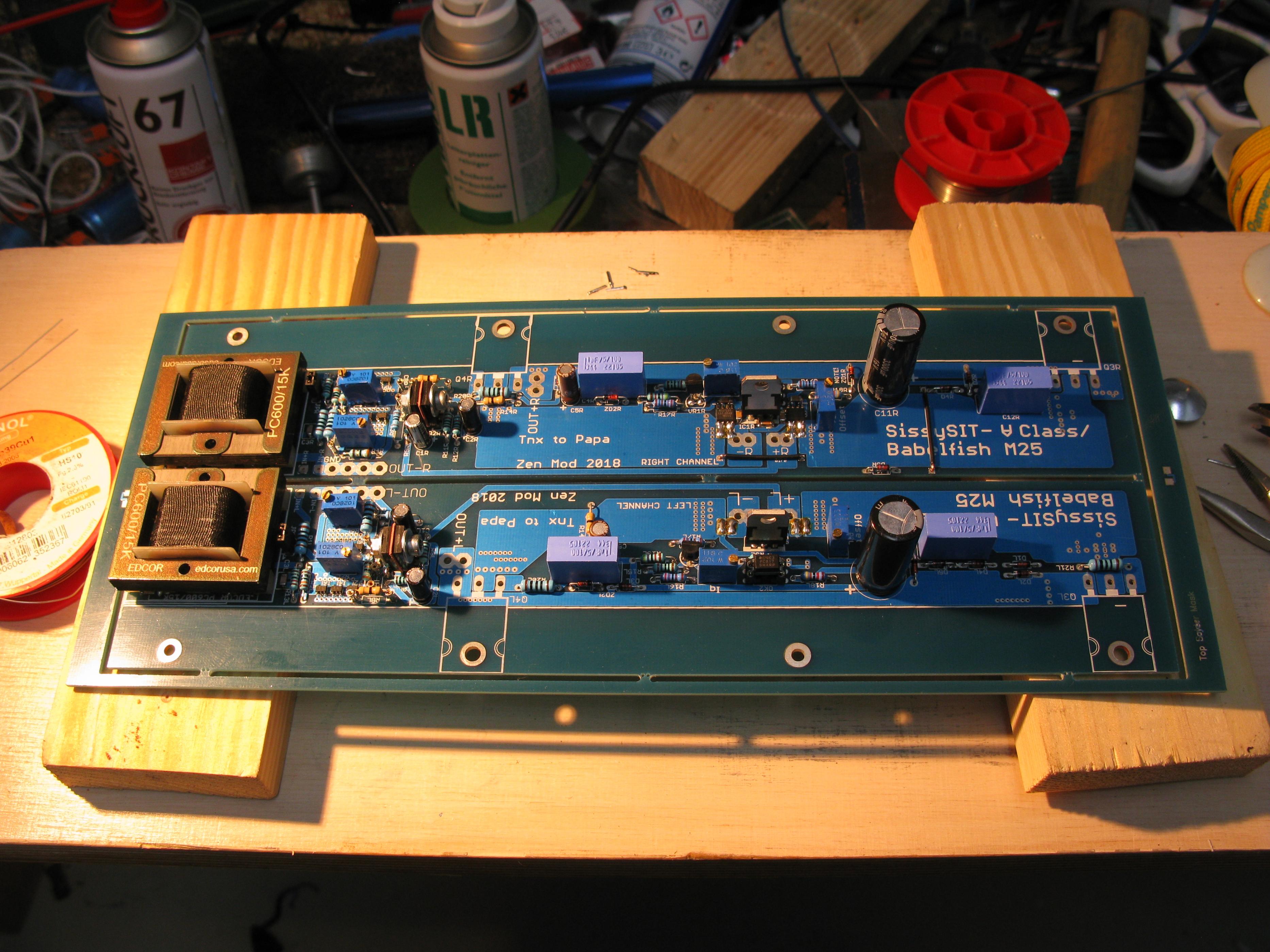

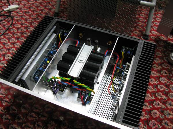

little progress on Babelfish M25 -
https://www.diyaudio.com/forums/attachment.php?attachmentid=771596&stc=1&d=1564524556
now I am to find a huge alutree to cut the case from.
btw: I' rather go with longer fins (7-10cm) than deeper case (< 35cm) by max 18cm height.
my M2 is only 30cm deep by 13.5cm height and goes only up to 60°Celsius.
I think that's within soa.
any objections?
cheers!
A.

M2 is Sissy , compared to SissySIT , or Babelfish M25 (in same manner) , regarding dissipation
just compare Iq and you'll see it
anyway - as you're living in De , I see that you chose to take Edcor from Don Audio ..... my advice would be to invest in more detailed sounding Cinemags
also , my advice would be to go with 4U/400 Modushop case - shipping is anyway just 25 EU Greenies between I and De
don't skimp too much - that drek deserves the best ....... even if it'll sound divine even with drek-iest parts and case you can find :clown:
edit: and yes , I can testify that those Alu Trees , growing in Italy , are perfectly fine ........ :rofl:
Hallo Attila,
I have the SissySIT in a Modushop 5U400 case, and it gets quite warm ... can keep my hands on the heatsink for 10 seconds when it is fully warmed, but I wouldn‘t want to have it in a smaller case.
Also, Iq and therefore dissipation is quite dependent on rails voltage.
That means, if your wall AC power is not stable in voltage, you have to make amends for highest possible wall voltage ...
And in my street, wall voltage is higher in summer than in winter, and gets higher as the evening stretches on, when I‘m listening mostly, so perfect storm temperature-wise ... 😡 - but with this case, not really a problem.
Also, I fully support what Zen Mod said about the Cinemags - I have CMOQ-4HPC in my SissySIT vs. Edcor in my M2, and the SissySIT sounds so much more detailed ... 😀
I ordered directly from Cinemag in the U.S., though that took a while to make them and send them here.
Best regards, Claas

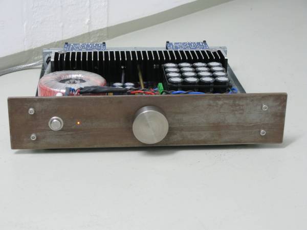

I built the first few cases myself as well ... 😉
(don‘t have a picture of my 2A3 amp with me at the moment, unfortunately)
But in the end, I figured that it costs a similar amount of money, and case building is by far the part of building an amp that takes the longest ... 🙄
At the moment, I am more in the mood of modifying and adapting commercial cases for my purposes. I definitely would consider building from scratch again if I want something special 😀

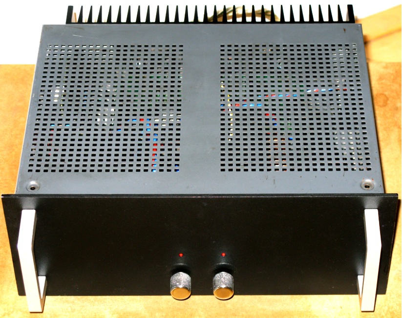

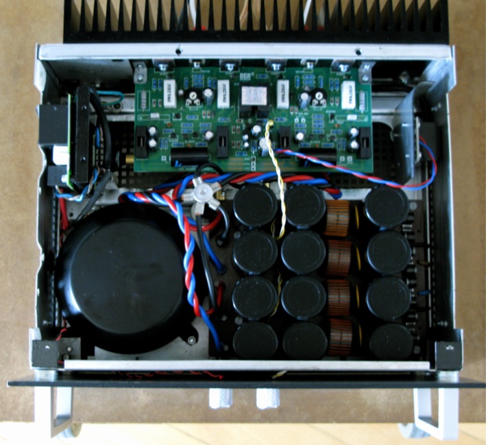

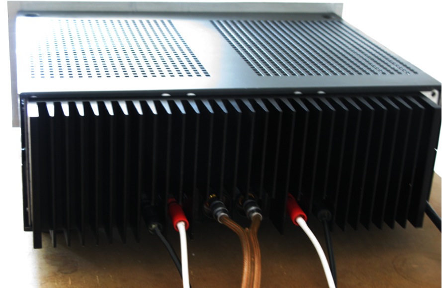

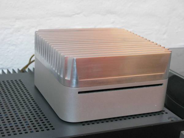

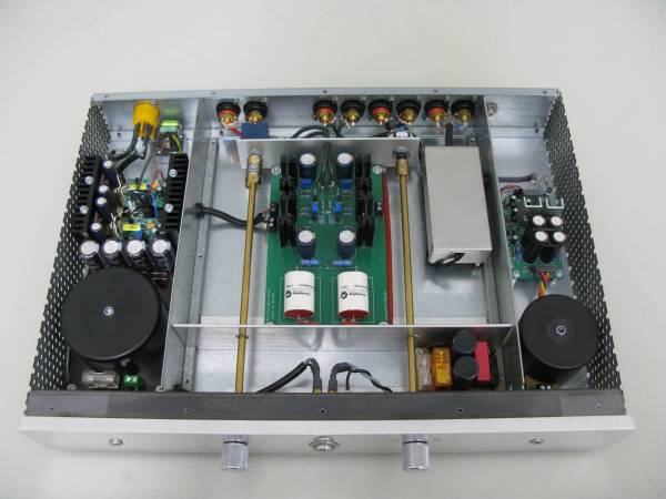

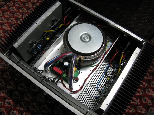

forgot my first: MosFet Citation 12 in old Philips ela chassi
watch the connectors in the fins
but lets close that subjekt for now (this is the wrong thread to become melancolic)
cheers!
A.
