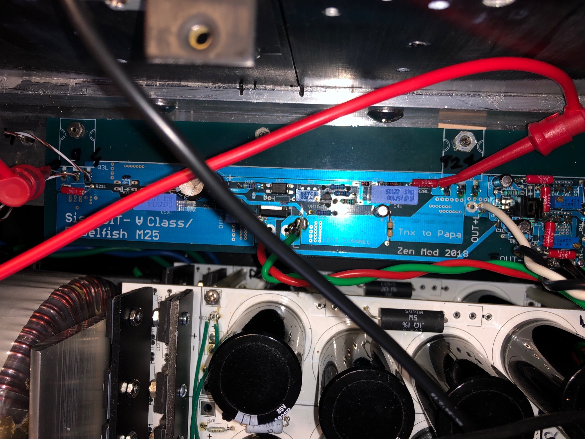

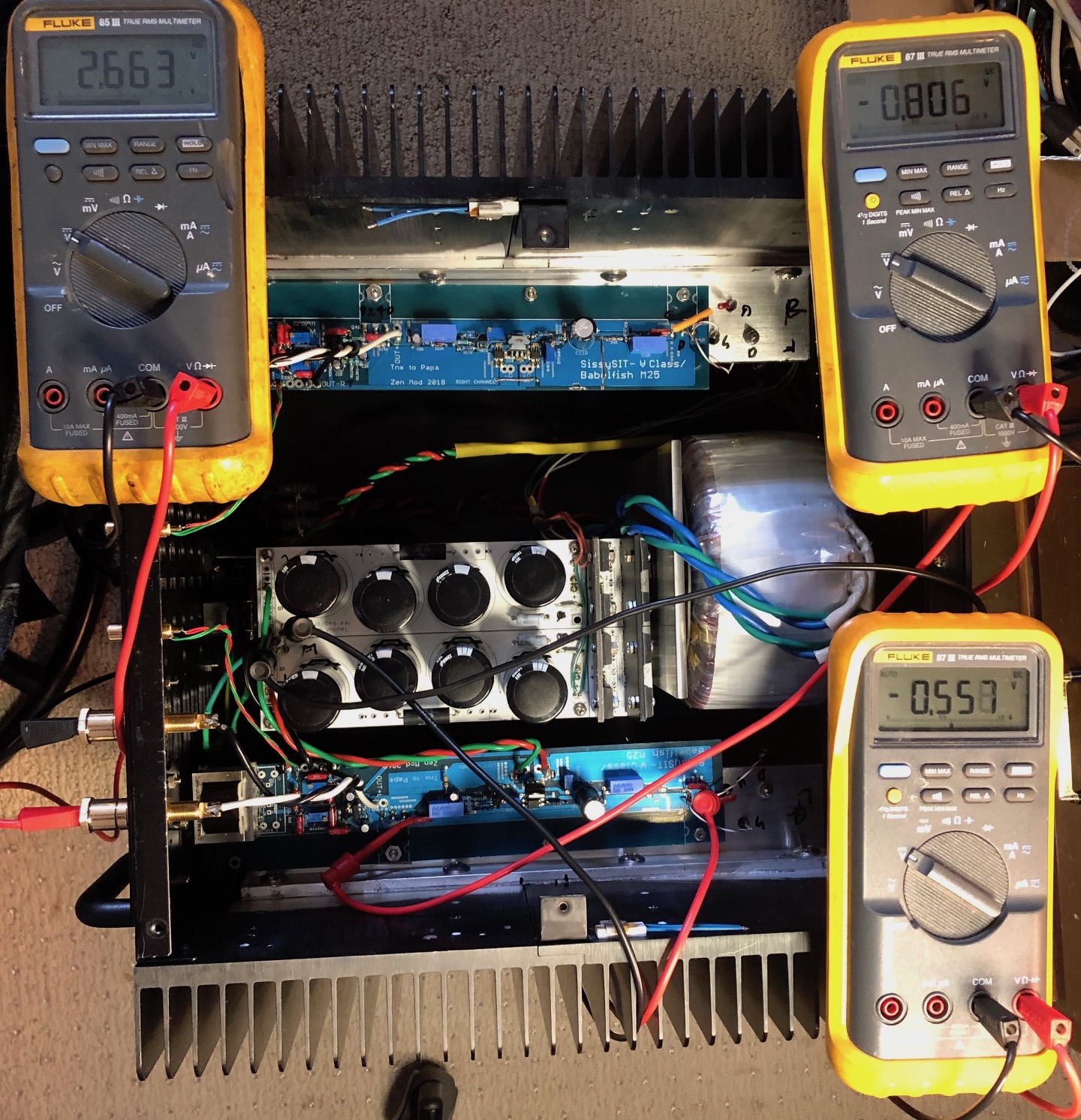

AMP is plugged into Variac, turning to only to 30 VAC, rails at +/- 7 VDC, 0.06 across 0.1 ohm resistor in CRC power supply. See photo
2.663 volts on output :-( bad)
Checked gate on SIT -.557
Checked gate on MOSFET -.806
So being the fearless Amp builder, I went to full tilt 120 volts for 30 seconds at a time.
At full 120 VAC, +/- 27 VDC rails, .271 across 0.1 ohm CRC resistor.
1.9 volts on output :-( still bad)

If I turn P1L, Voltage across CRC 0.1 ohm resistor goes up.

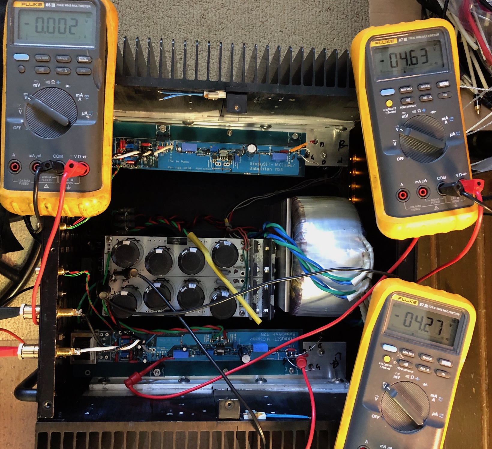

Turning P2L I was able to set offset to zero and checking gates: See photo
0.002 volts at output
Checked gate on SIT -4.27
Checked gate on MOSFET -4.63

oh boy , 27Vdc rail is tricky detail
what's happening when you dial Variac down , to have 22V5dc rails ?

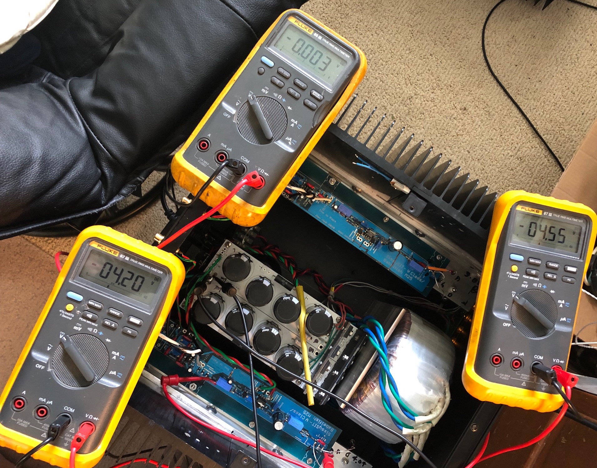

Had to reset P2L (it was 0.6 VDC at lower rails). I was able to set offset to zero and checking gates: See photo
0.003 volts at output
Checked gate on SIT -4.20
Checked gate on MOSFET -4.55
Now I have 0.199 across 0.1 ohm CRC resistor.
Still turning P1L increases current.

1A99 is good figure
problems you faced are there as combination of highish SIT Ugs and high rails
luckily , you also have mosfets with highish Ugs
now , you "only" need to find a way to have rails in range I prescribed , if not because of fact that everything is optimized there , then to keep mosfet dissipation in still sane range
I can't see any other way than to change Donut , for one having 18Vac secondaries
edit: now you clearly see what is what's called "resistive nature of SIT" ........ so changing rails voltage is resulting in huge differences in Iq with fixed Ugs ..... and what's really tricky is still having enough of voltage window for optocoupler

ZM,
How about a Cap multiplier, dropping 4 volts on each rail?

Or I could double up on MOSFETs, with small source resistors, like 0.2 ohm?
I happen to have two matching pairs: 4.66/4.65
If I have enough heatsink, and I think I do, which would be better?
Running 2.7 amps at 27 VDC, double MOSFETs or Cap-multiplier at 22.5 VDC and 2 amps?
Rush
I would go for Cap multi
Sissy is more like Ferrari than John Deer , better to keep it that way

I did go with the cap-multiplier, one for each channel. Thing is, that now that both channels are pulling juice, the raw supply rails are 25 VDC, not 27 VDC. I could have gone without Cap-multi after all.
The Cap-multiplier is dropping 4.5 VDC, so I am running 20.5 or so VDC per channel. I had to use the P1 to move the current draw up to 1.8 amps.
Having some offset drift with cover on takes about 3 hours before the offset settles down to +/- 0.010 VDC. Thats after I chase it every hour resetting it.

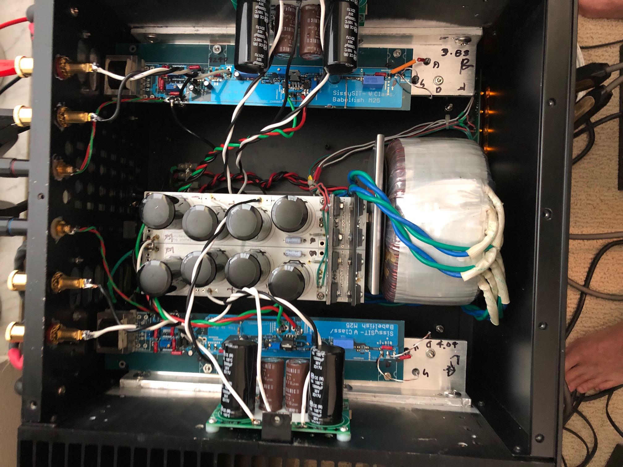

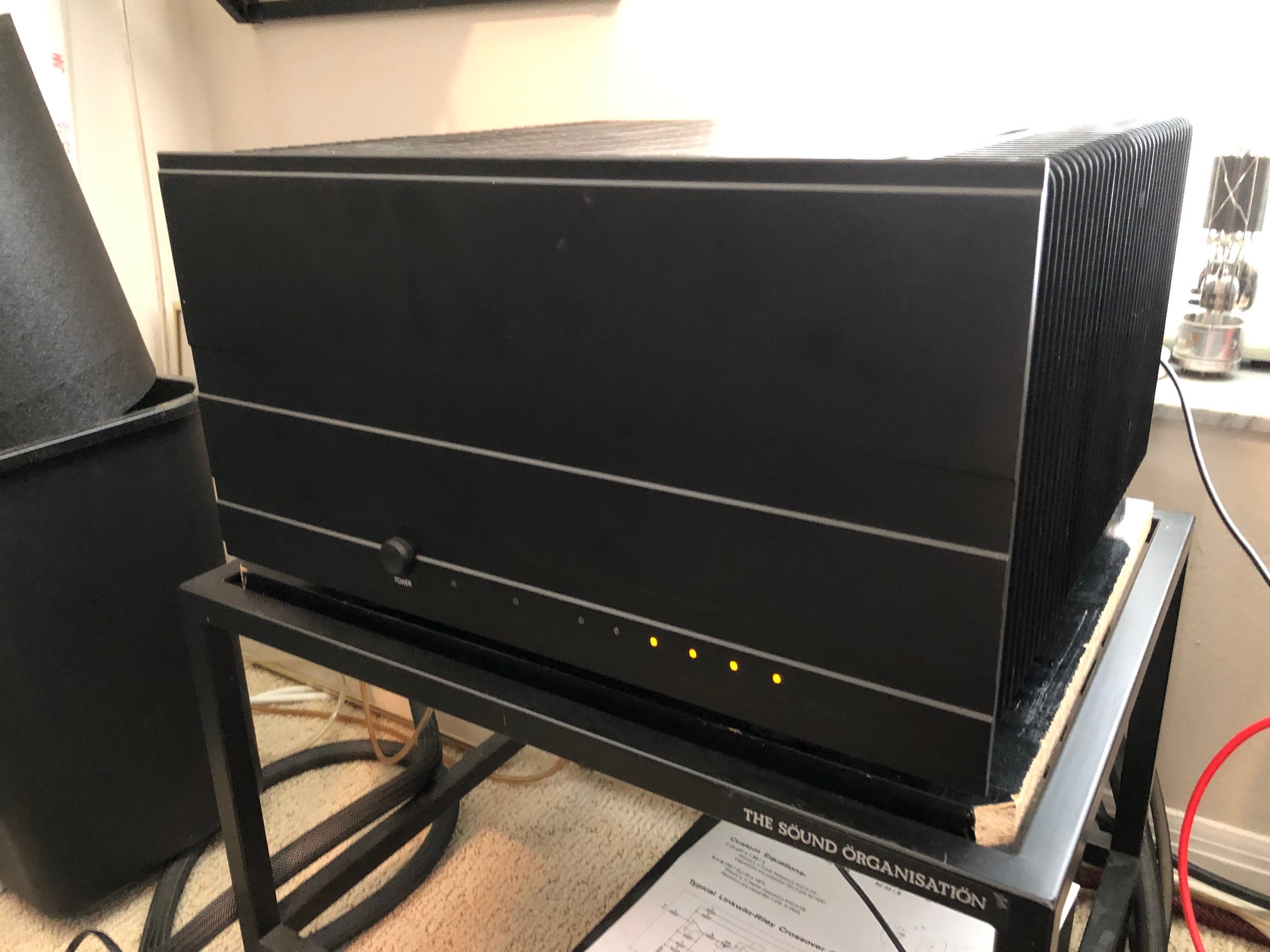

PS, pictures are of the Baby Sister, my repurposed case and the amp with Cap-multipliers installed.
