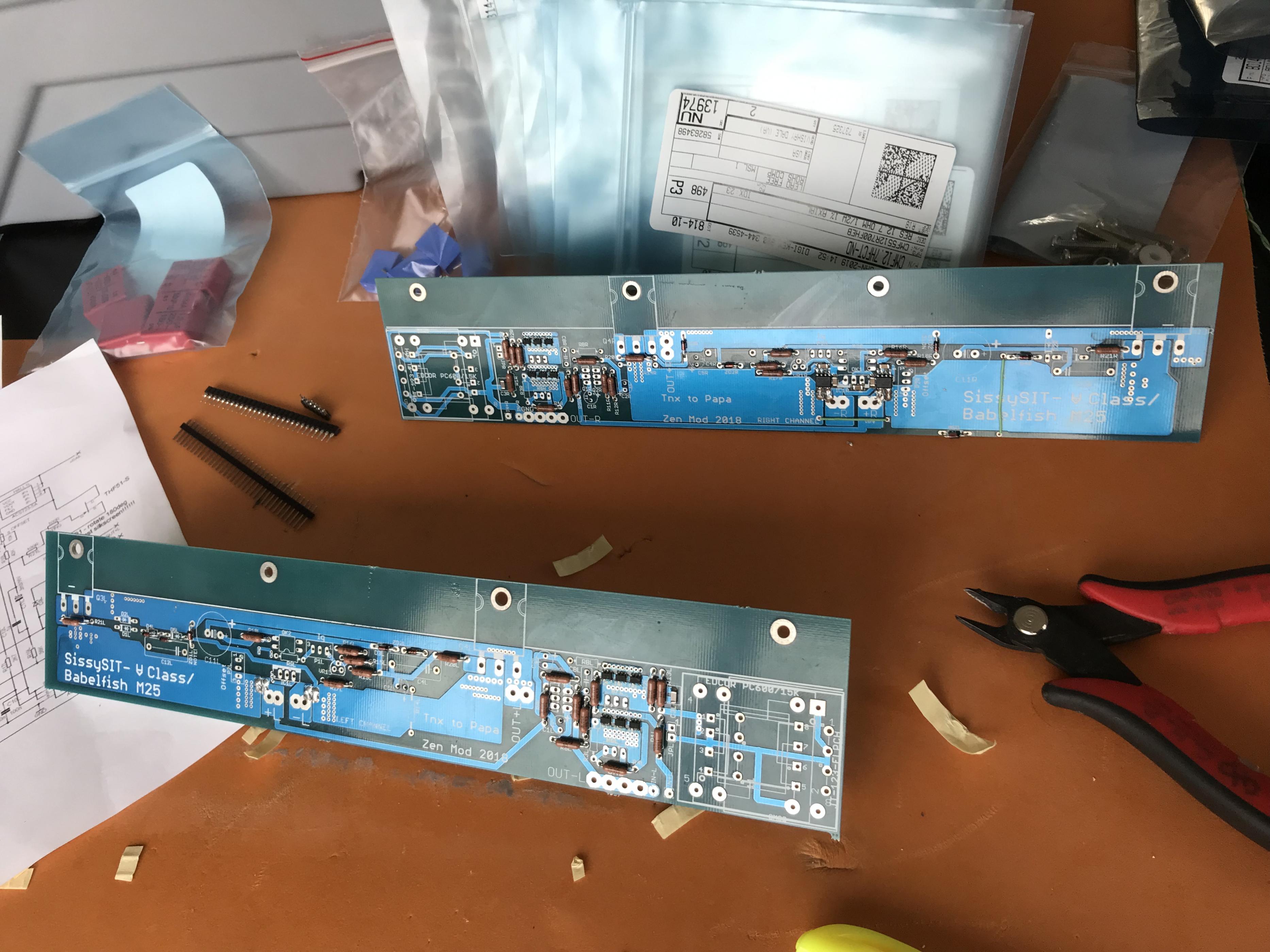

Backlog of projects as usual, but sontero you motivated me to phone in my Cinemag order today. I couldn't make up my mind over hi vs. lo nickel so I got both types to experiment with.

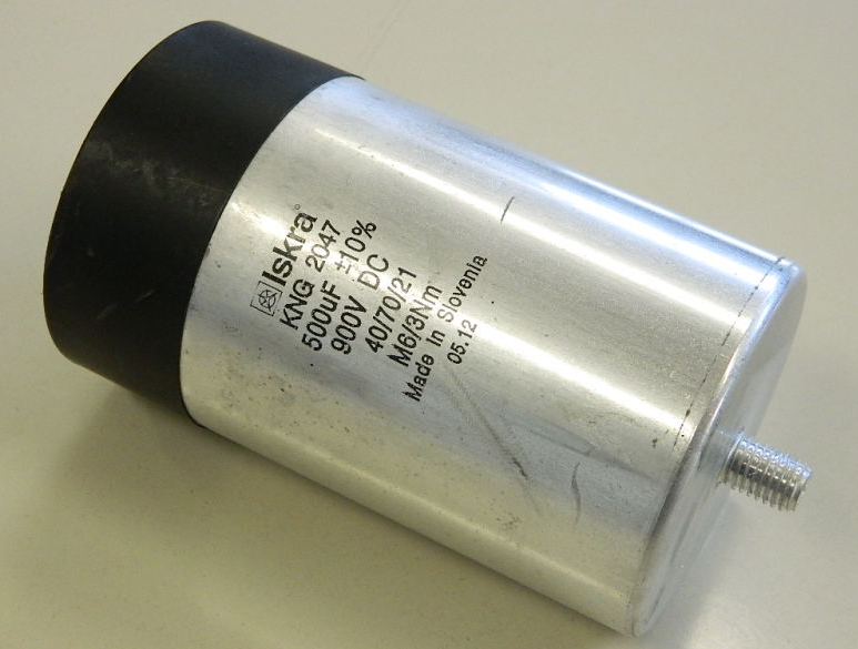

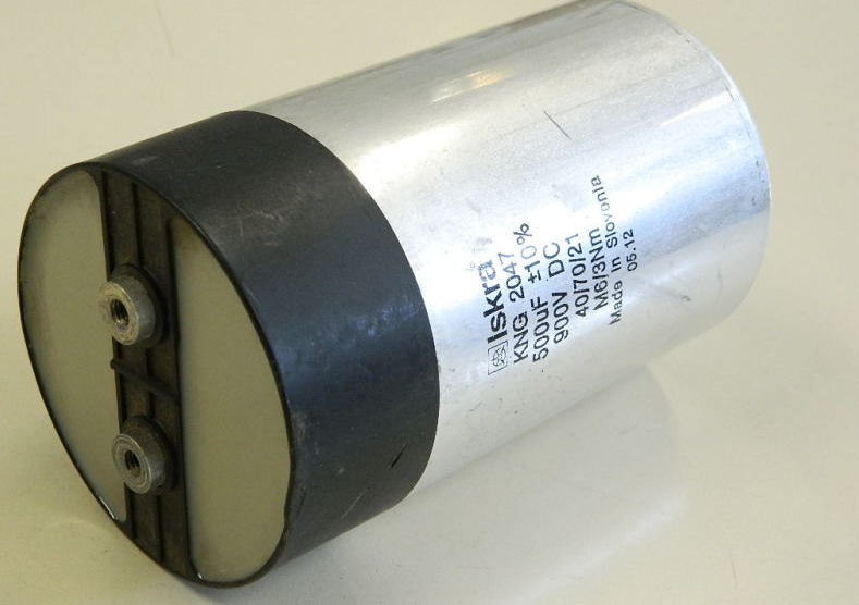

I have a number of these big PP caps from ISKRA (surplus material but in perfect condition). My intention was to try to adopt them on the Sissy (the problem is size, they measure 14 x 8.5 cm). The intention was to use them as decoupling Rail to Rail, so it would take two as it is a dual mono. So I should intercept the +24 and -24 cables near the amplification board. Does that sound like a good idea?
just connect their wires to last regular caps, or connect them as you said .... I believe there will not be difference
what is important - that they're in ......

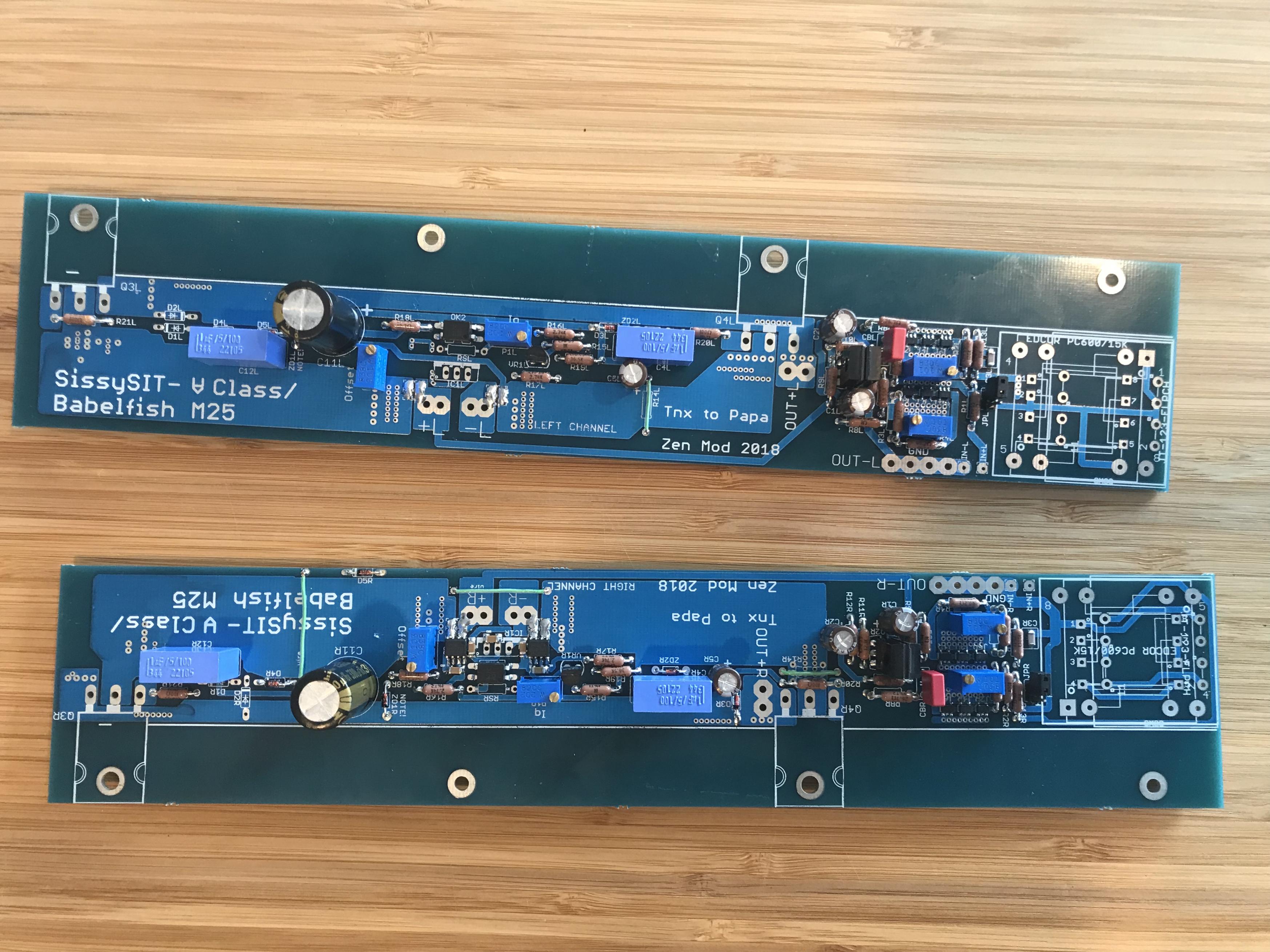

R13+C3 is (series) RC eq compensation only if you're using Edcor
I soldered smd C3
if you're using Edcor - solder R13 in
if you're using other than Edcor , don't solder R13 and C3 is left flapping in breeze (so you can ignore it)

First of all, thank you for a nice kit ZM!
There is (voltage ref?) LM358AXZ in schema, but LM336 in a bag. I pretty sure that it doesn't matter what to use, but would like confirmation?
lazy ZM 🙂
look at same position on Sissy schm
Ah, clear! It seems I'm blind since have been studying these schematics side by side almost all the time.
