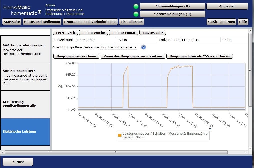

Also, I put an energy consumption measuring device between amp and wall socket yesterday ... and after fully heating up for a few hours, energy draw for the stereo amp maxed out at about 285W 😱 - I could still hold my hands on the heat sinks for at least 5 seconds, but I think I should dial back the bias a bit 😛

if that measuring device of yours is not overly optimistic, count on BigBadaBoom!!! anytime soon , simply because P channel mosfet isn't exactly made for almost 70W of heat!!!!!!

... currently heating up with current measuring resistors and energy consumption meter connected ... 😉
Will dial back tonight ... 🙂

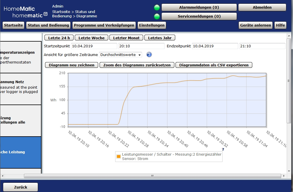

The diagram below shows the power curve over time for my SissySIT build after rebiasing.
Ignore the "short spike" to the left of the picture, that was just my boys playing on the Xbox ... 😀
You can see the bias rising with the warming through of the amplifier. After reaching steady-state, the jitter of the curve is due to fluctuations of wall voltage (and therefore rail voltages):
The unit on the y-axis should really be W instead of Wh, but that's a bug in the graphing routines of the house control system I'm using ...
Here is some transient detail of the starting phase of the amp:
You can see pretty well the action / time constant of the opto bias scheme combined with of the 3300 µF bias spreading capacitor. This regulates the bias rise in the first one or two minutes; after that, it's more or less due to the amplifier warming up.
