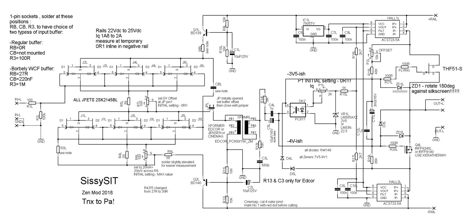

another issue covered somewhere in front ...... C3 is in series with R13 , and that RC cell used only for Edcor (be it M25 or Sissy, so applicable to both)
to save you few mm of solder wire ( in case you need it) , I presoldered SMD C3 , counting that you'll skip R13 if there is no Edcor
so , yes , leave C3 in , it's hanging invisible

What about tiny white caps? still searching schematic for them. Better check M25 schematic, must belong there, but not finding place yet on board.
I Think I've been staring through magnifier too long today, time to rest eyes!
Tiny writing on them says 22K.....maybe a resistor. the search continues.
Ahh, I think it is for use with Borbly buffer maybe?

left upper corner in both (M25 and Sissy) schematics covered main notes regarding Borbely WCF buffer iteration and yes , small u22 caps are for that
as clearly written on few first lines of post #1 in this very thread:

......... Better check M25 schematic, must belong there, .........
really , difference between M25 and SissySIT is sort of minimal ........ "just" upper output part , values of resistors from rails to output gates , few resistor positions around optocoupler and few diodes
so , everything left from optocoupler is practically identical between two amps
