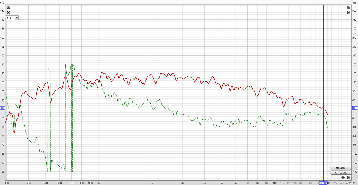

I just was clued in to an important factor...the horn I am looking at using falls of in the Hf....to compensate I have to cut with a shelf some -10db......putting the the un altered response at about 88db...so that would require more amps that I originally assume in order to reach max output goals of 115db. at 110db sens about 5-8 watts would do it...but at 88db sens I need more....I could boost the input signal after eq but then I'd have issues with thd above the shelf filter where the response is mechanically insensitive.

its typical of the type of horn (tractrix)...The Axi2050 is definitely "equipped" to handle 300hz to 20khz (if you want loading down low to allow proper low end extension this is what you have to deal with up top I think)....If I want to use this type of horn its what I have to deal with....at 18.9 sens is 90db so I guess I'll start there? sounds like I might need 110watts unless you know something I don't.

A shelf filter cutting about -10db gets me to something around +/2.5 db FR... from there I only expect a mixture of cuts n boost of 1-3db if any at all...to try and iron out the FR as flat as possible

Now that I think about it that filter might only work with the response I took measuring at the mouth...this latest measurement at 1 meter looks like a another filter, maybe a really low q peak filter to invert the response to something flatter will do....either way, its not that hard to get there.

if you have shelf filter cutting = to get you so-so flat , then there is no need for further rising equalization, needing extra power for that
though - if your intention to cover that broad spectrum with one driver- one amp, then investing in beast of an amp is cunning plan
