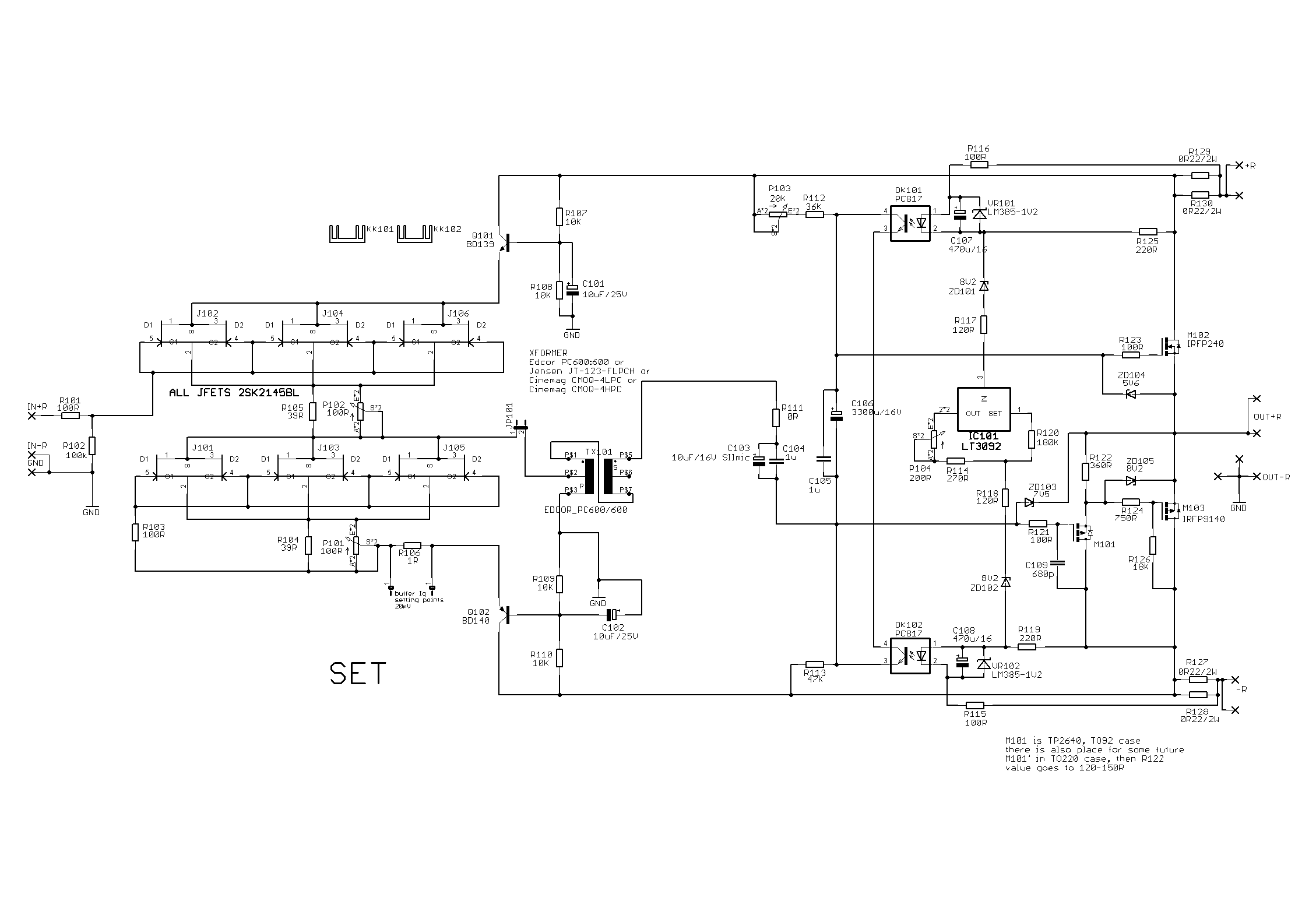

Yes I saw 600:600 in your schema and then saw the M2X schema with a 600:15K connected a bit differently (smaller primary winding, bigger secondary winding maybe to achieve the same gain?)
What would be the best solution?
of course it depends on the output impedance of the input buffer, input impedance of the output stage and desired gain.
well, dunno what proper answer is ....... 🙂
my thingie is routed for Edcor 600:600
both Edcor 600:600 and Edcor 600:15K are good xformers
use Cinemag, then no need to worry about difference between two Edcors
I tried them all, and it is not difficult to choose from
it was just matter how many different xformers I could squeeze in same pcb space, so Greedy Boyz can choose which one they prefer
and then, 4 of them ...... no way, must stay with 3 max, so I did chose between two Edcors with same footprint
regarding gain, there is really not much difference between 4V/V and 5V/V

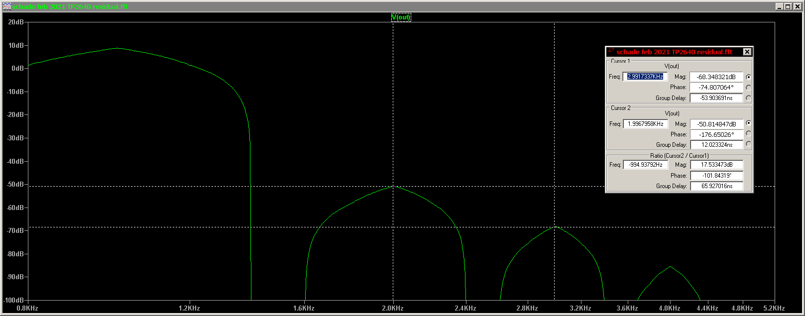

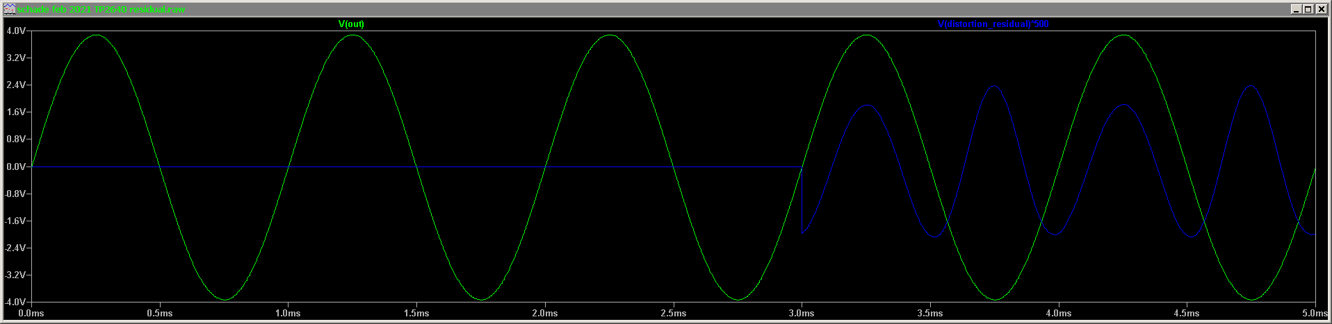

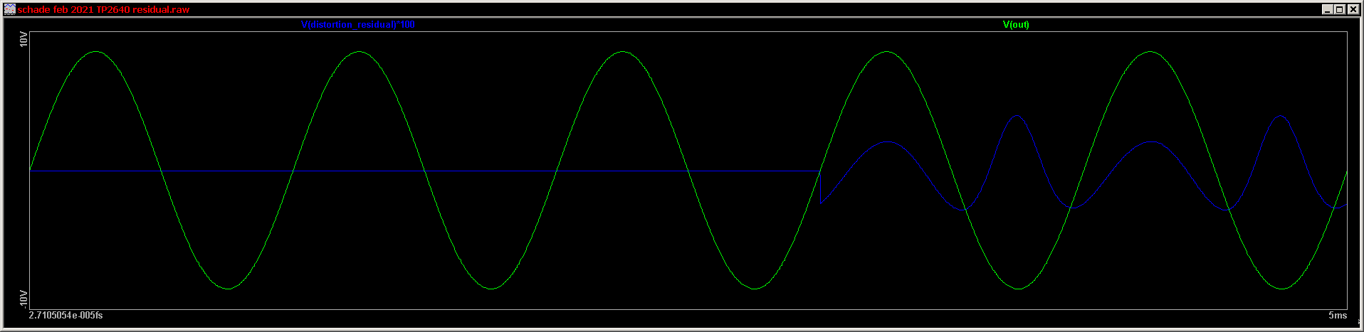

I think LTSpice XVII report is weird. 😱 Phase of H2 on inverting circuit is correct, but shows negative when it is actually positive on non inverting circuits. You can actualy plot distortion residual in sim using jcx attachment at Spice simulation thread post#361 to confirm.LTSpice sez neg
It's positive phase H2 with H2/H3 a bit better than 25 dB?
sorry, it was not 1W@8R sine
here it is
Code:
Harmonic Frequency Fourier Normalized Phase Normalized
Number [Hz] Component Component [degree] Phase [deg]
1 1.000e+03 3.907e+00 1.000e+00 -0.08° 0.00°
2 2.000e+03 4.110e-03 1.052e-03 -89.55° -89.48°
3 3.000e+03 5.531e-04 1.416e-04 7.76° 7.84°
4 4.000e+03 7.575e-05 1.939e-05 95.27° 95.35°
5 5.000e+03 1.135e-05 2.904e-06 -169.58° -169.50°
6 6.000e+03 1.458e-06 3.732e-07 -100.81° -100.74°
7 7.000e+03 2.688e-07 6.880e-08 167.90° 167.98°
8 8.000e+03 4.094e-07 1.048e-07 177.92° 178.00°
9 9.000e+03 3.654e-07 9.352e-08 -179.88° -179.80°
10 1.000e+04 3.212e-07 8.221e-08 179.45° 179.53°
Total Harmonic Distortion: 0.106159%(0.106160%)
my brain in this moment not set at analyse of wigglygiggly ( never really stopped enough to understand Papa's explanation of his pics) and especially let that issue down the river, when I read Pa's claim that you can flip it with simple overall phase flip
so, I'll trust you , whatever you say about phase 🙂

another new bone
Wow, another nice amplifier, it's getting difficult to keep track of all the new amps 🙂
Is the SE version compatible with the Semisouth SJEP120R100 ?
on paper yes, but didn't tried
all of Arrakis Spice I wanted, I got from Schade connected IRFP9140
save your SJEP for another amp, where it is going to be main Spice ingredient
