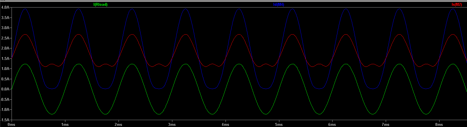

one of interesting things - of all lately seen amps, only this one is having same current distribution of output parts as real DEFiSIT is having - up to clipping point of more active part, parts are working in antiphase , fighting each other..... and only at and after clipping, lesser acting part ( one with lesser xconductance) is hel;ping other onee
see attached - graph from sim, but confirmed in vivo....... though, easier to post this than capturing scope screen ..... counting on fact that I have a scope from Lee De Forest time, but before triode invention
sim shown from output sine of around 20Vpp @ 8R load
biggest sine - upper mosfet current
smaller sine - current through load
smallest sine - Schaded mosfet current

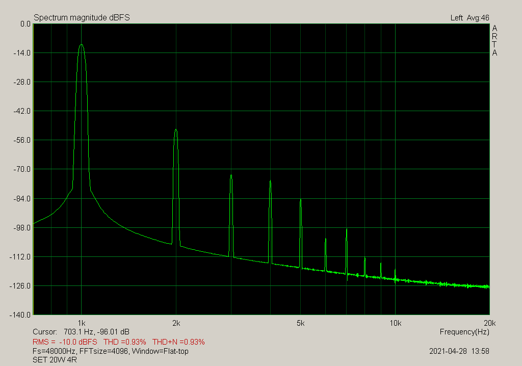

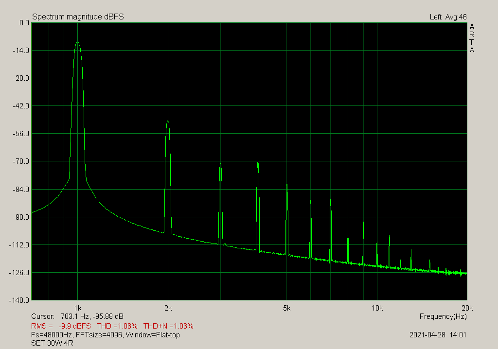

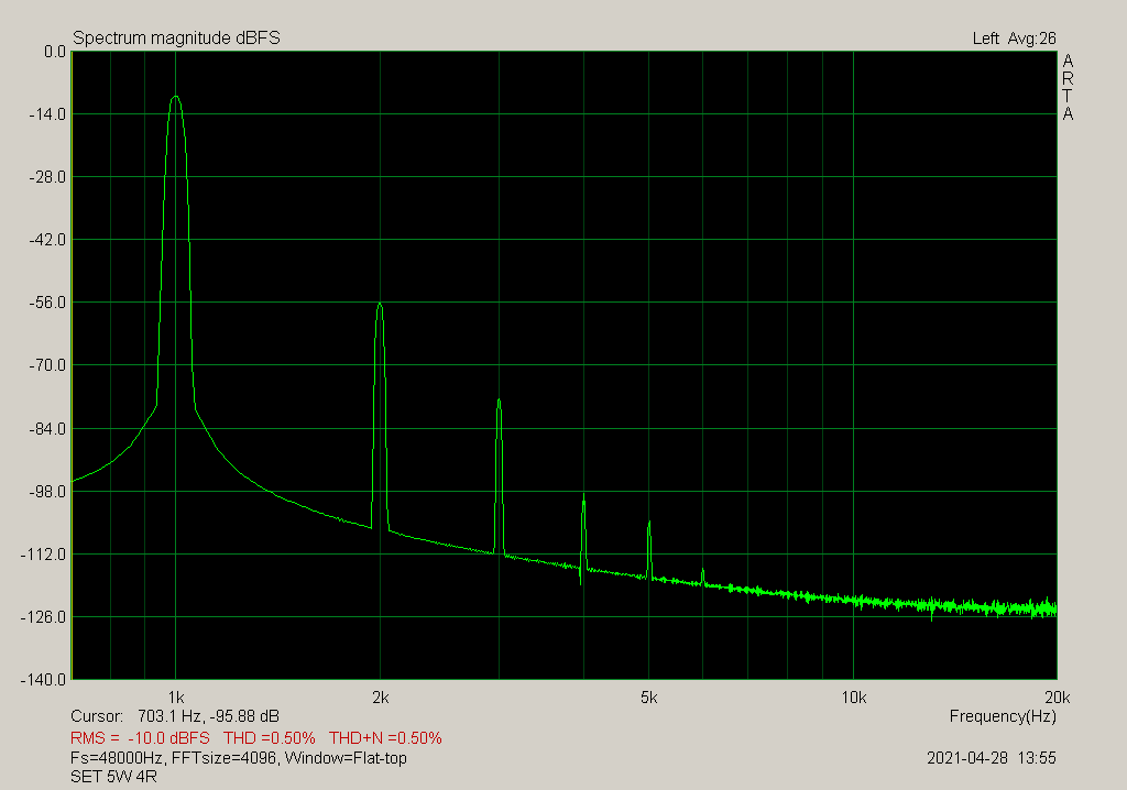

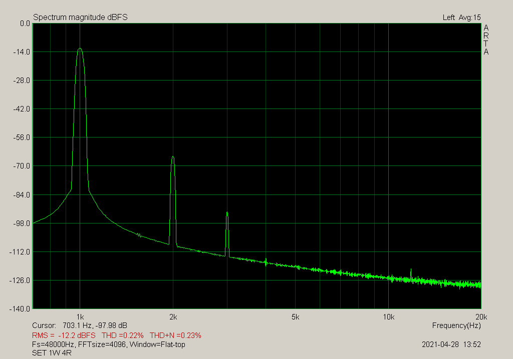

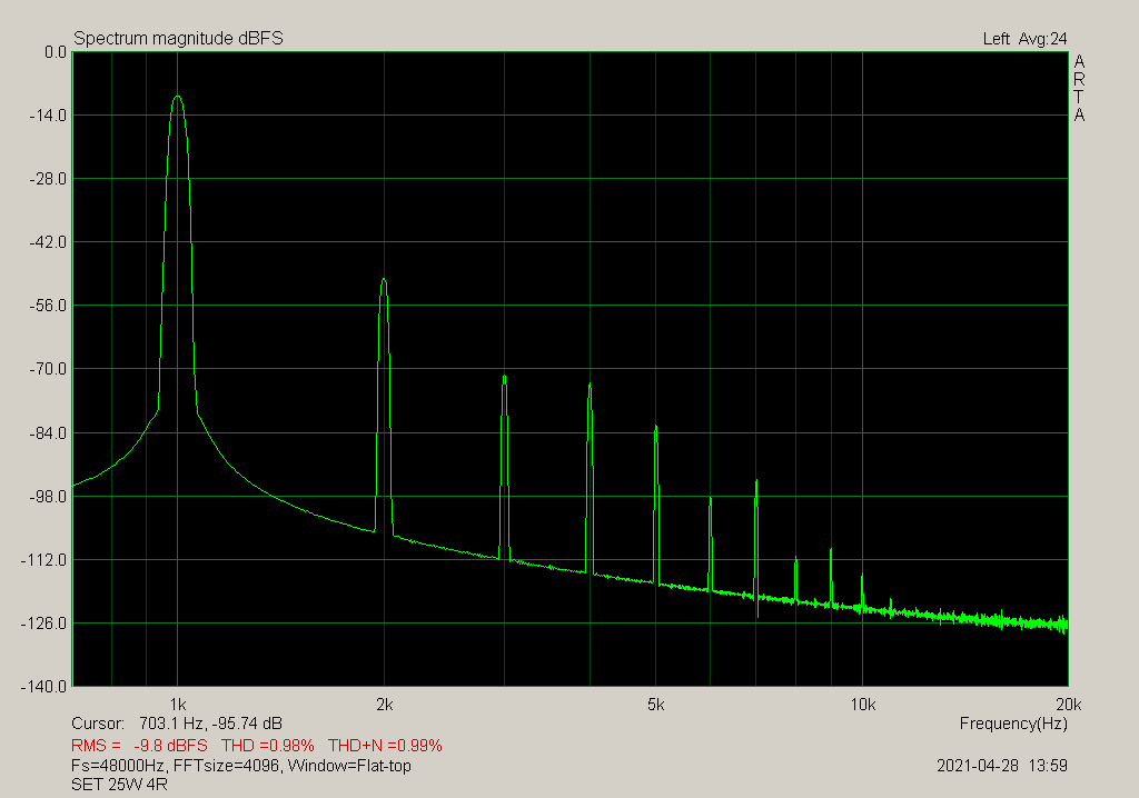

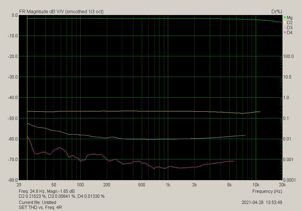

Hard facts

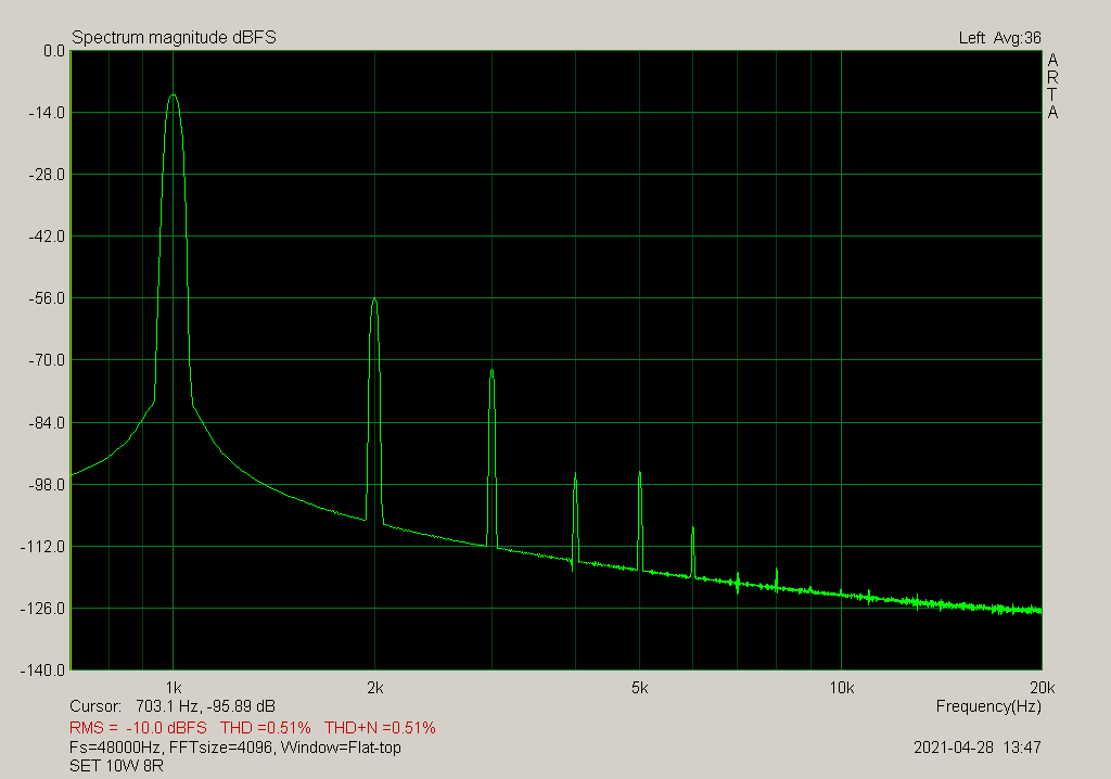

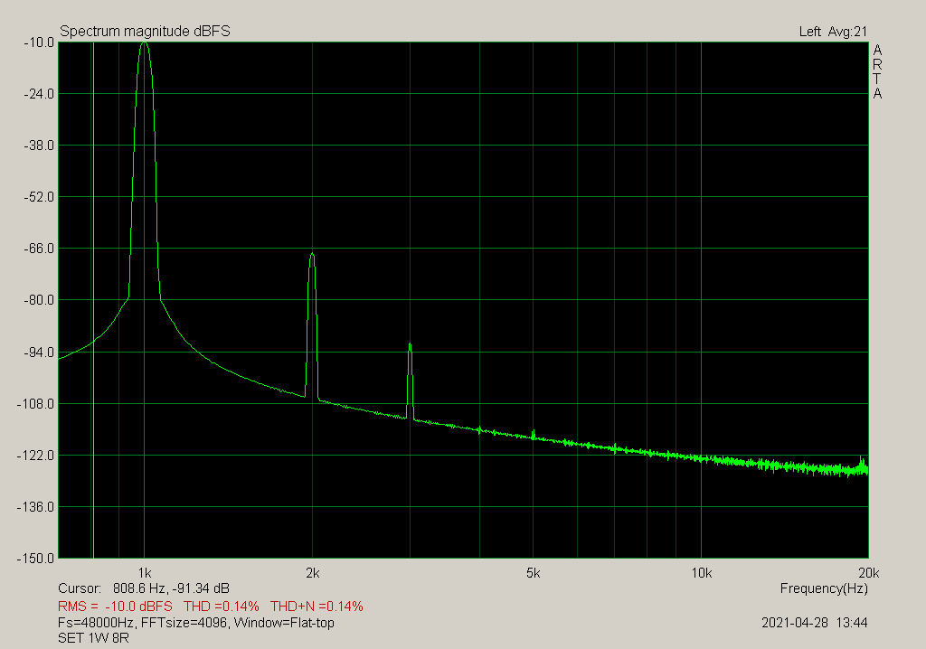

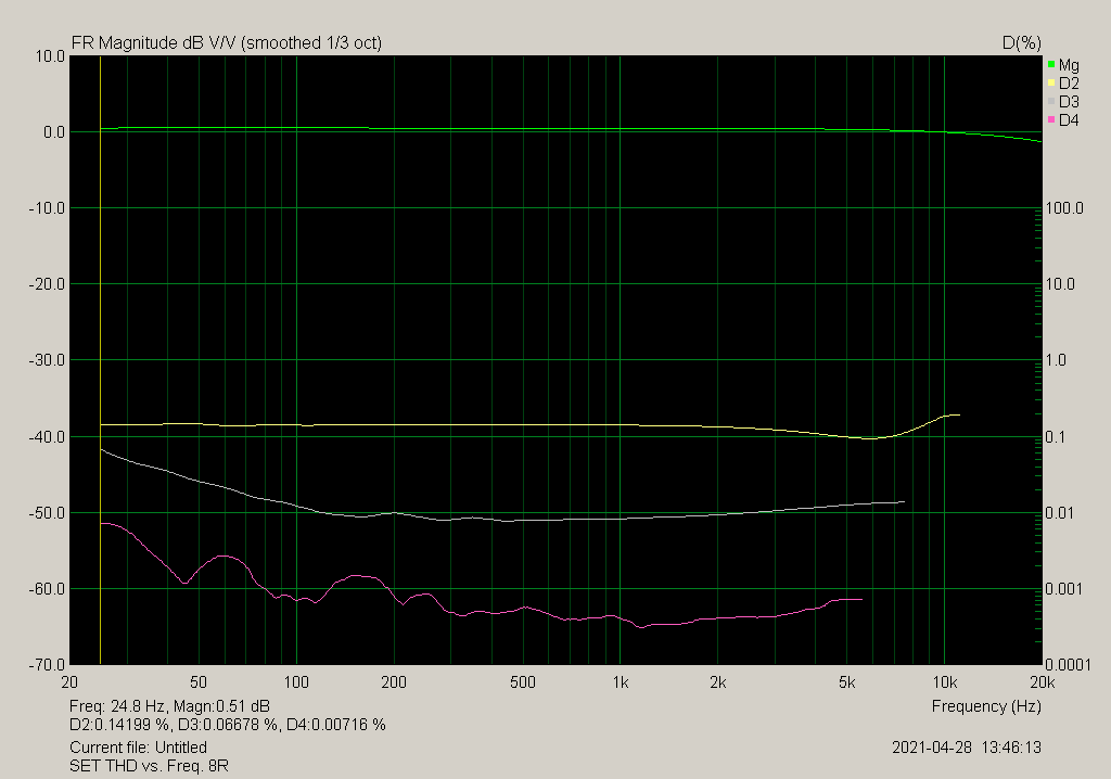

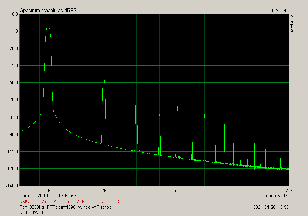

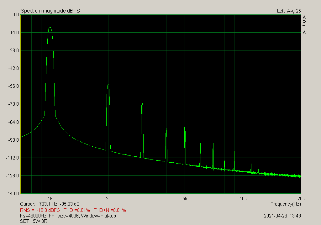

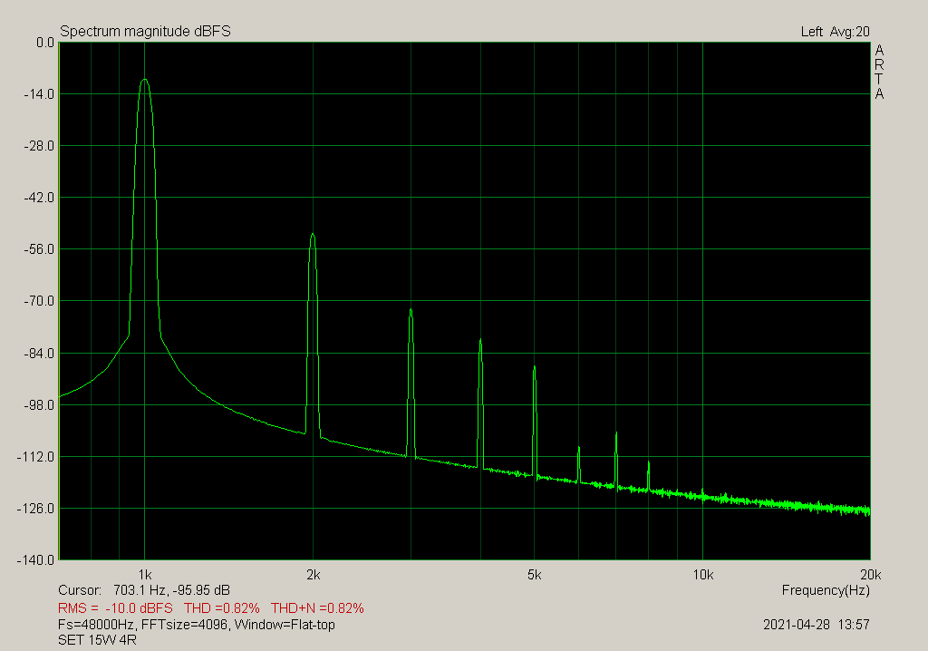

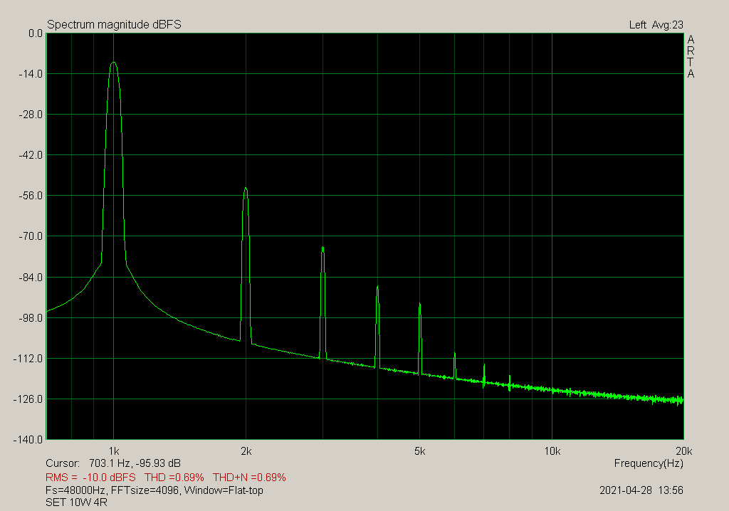

THD measurements
+/-24Vdc rails, Iq 1A5 , 8R Load
THD measurements

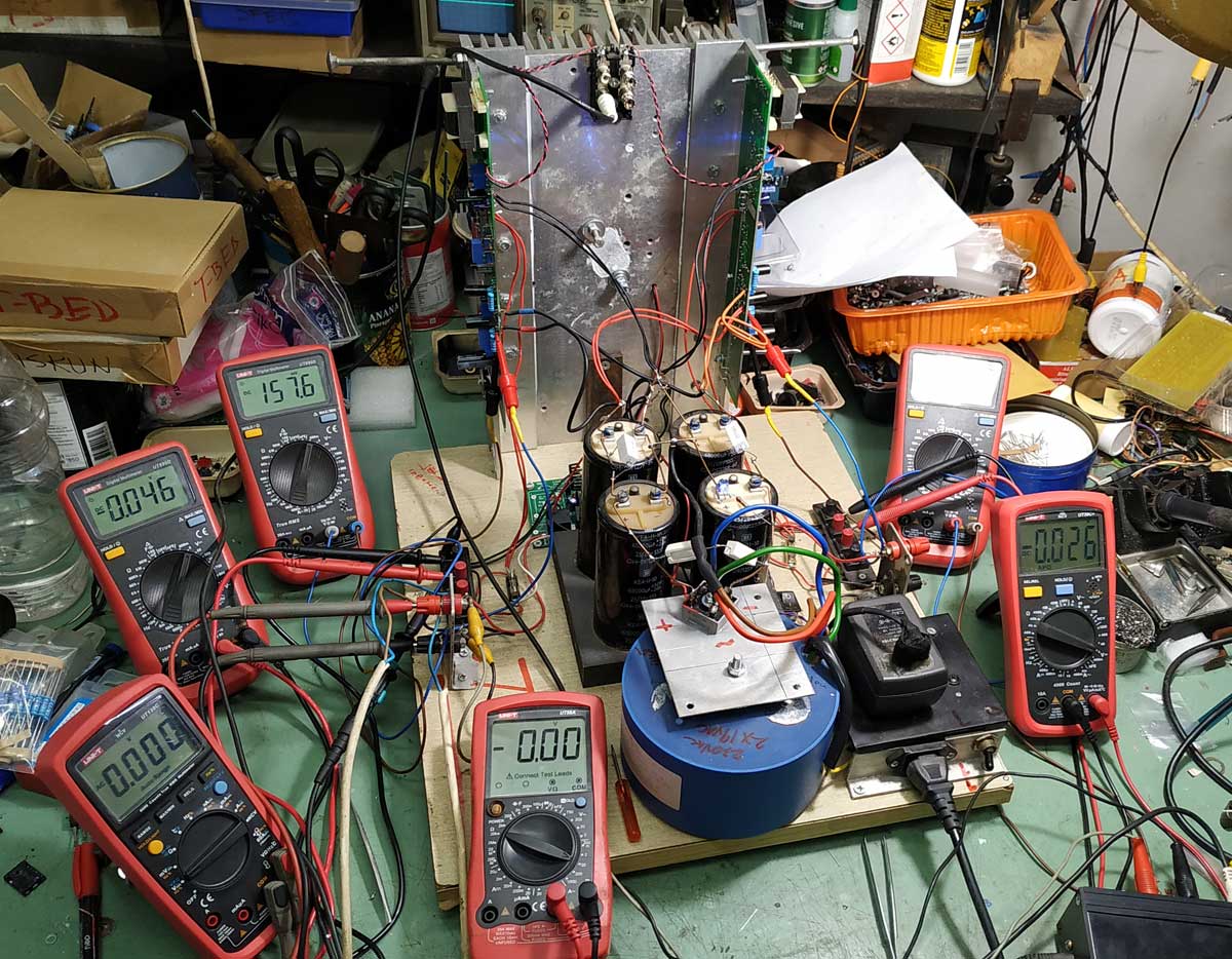

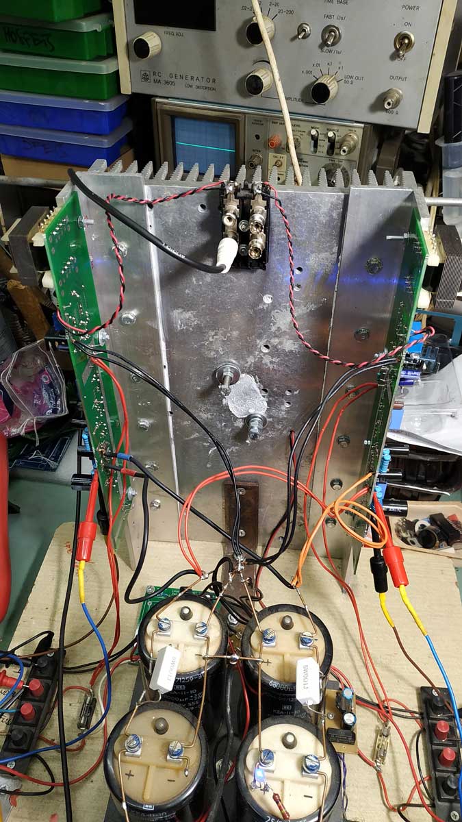

some funny porn, as proof that I changed something
when I made those few changes from Babelfish M25 R.2 ( few resistors, TP2640), after flipping power switch - Iq came to same value as it was set for B. M25
all what was needed is to correct DC Offset, for 400mV or so

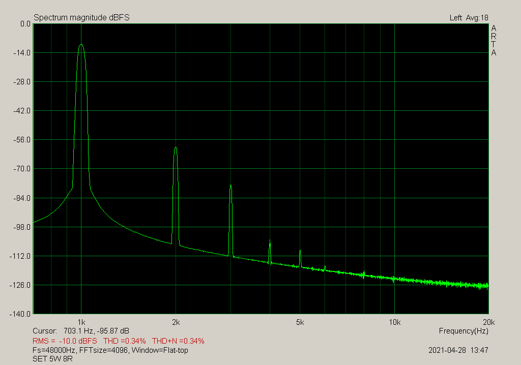

THD Spectra comparison with SissySIT - go to #7 in SissySIT R.3
I'm gonna toss all my precious ( 'till today) SITs and VFets to OPLDF bin, cruncher is gonna work these days anyway .....
Good enough to be true, any better and it becomes too good to be true.THD measurements

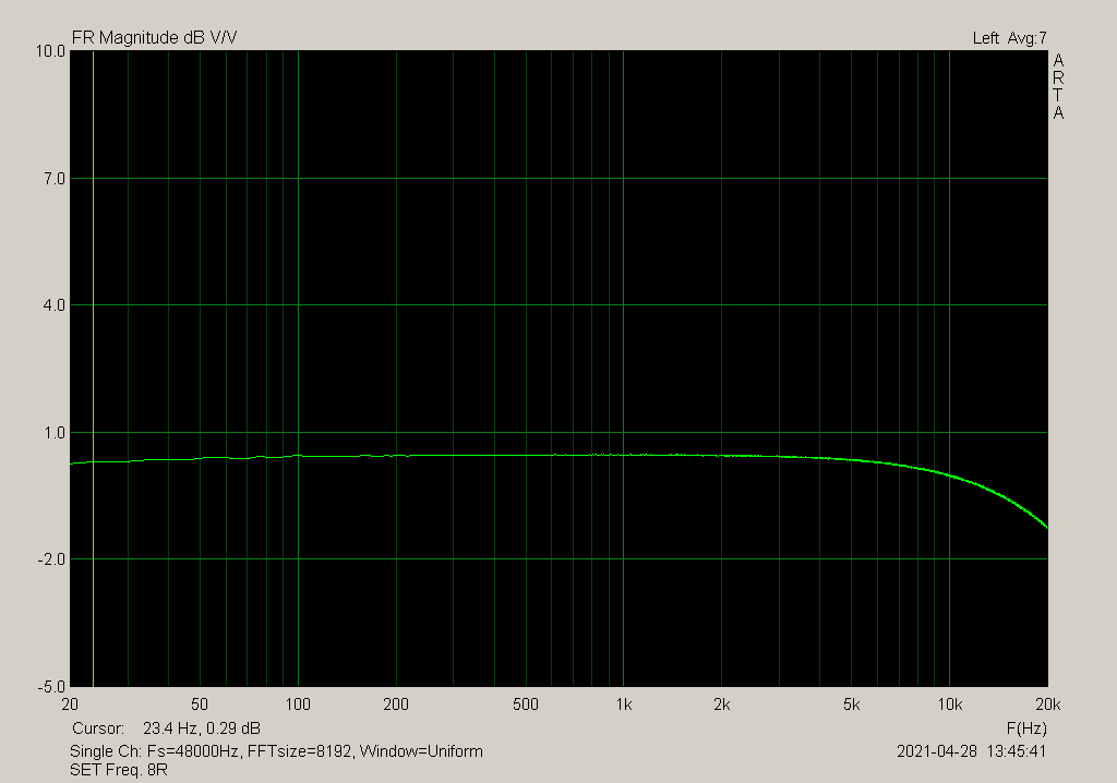

LTSpice sez neg
I'm not measuring that:
- QA400 I have can't do that (or I don't know how)
- EMU1212 which I use routinely is having problem with other channel, and you need duplex for Phase
- have no time/will/energy to make/obtain another gadget with notch filtering, even if Pa simply adores comparative wigglywiggly pictures
I simply leave by ear preferred speaker polarity; when I'm in special mood, I even succeed in getting same polarity of both speakers
interesting, LTS is not erring much, comparing to real life
