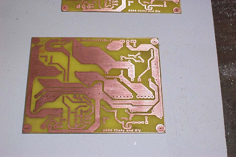

Anyway my brother is finished with babbelfish-mini-j 🙂
Dual-mono, +/-16V, CRC 60000uf each side, 3.2A bias total.
Only issue is that we hade to rais R13 to 100K to reach desired bias..
The babbelfish sound is just magnificent... So smooth and lean.. It's just fantastic.. Probably the sound stage is better with my brothers as he use dual mono..
Everything I miss in my aleph30 is there with the babbelfish-j.
We have not have the time to try difference between ceramic and silver mica feedback compensation cap..

Can someone explain what the 2 pots are for? I'll guess that one is to adjust the DC offset and the other is to set the bias, but which one is which, or do I have this all wrong? For the record though, I built CVILLER's JFISH version. Yes, I have to admit, my stuffed boards are just sitting there waiting to be mounted to heatsinks (and waiting for matched IRFP240s) ...
Thanks,
Stephen
Thanks,
Stephen

trimpot on input side CCS is in role of R106 shown in this pdf file
when my vision goes back to normal, I'll try looking again
Should I measure across the source resistors (3W - the big ones right?) to set the bias? What should I be setting to, is it according to my heatsink size?
Have pity on this stupid newb
twitchie said:
Should I measure across the source resistors (3W - the big ones right?) to set the bias? ...........![]()
Yep.. If you use 0.33Ohm you should have around 0.66Volt for 2A bias for each side... adjust according to heatsink yes 🙂
