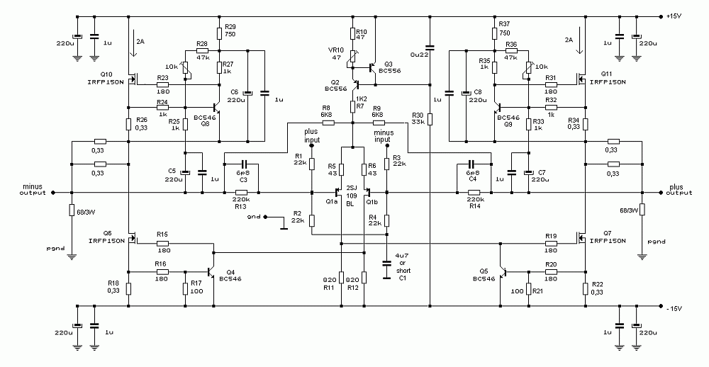

Hi Zen Mod (or other clever ones),
Could you educate me a bit:
In your "Convert your lousy Aleph to a Babelfish" guide, you talk about the 4u7 (C2) capacitor acting to block DC.
There is a similar capacitor in your final Balanced Version.
I cannot understand how this capacitor protects against DC.
However, I CAN understand how it works in this EARLIER Balanced version, because it is in series with the Negative Input.
(All of these files are from this thread.)
Please, could you explain this to me, so I might be able to understand something of what I am doing when I build this circuit?

Re: 4u7 Capacitor Education
point is in your exact level of paranoia.........
SE input - you use that cap in feedback chain if you aren't confident in your just finished amp,regarding oscillations and temp drift ; so -if you are confident,just toss it out ;
balanced input : keeping that cap anywhere in chain is same issue as in previous paragraph ,or just laziness to toss it out ; that "previous balanced version " was just quickie for someone asking for universal convert.......so that Babelfish is probably half a day catholic,half a day protestant..... and all night long just poor bstrd ,with one leg longer.......
point is- with balanced outputs (where your Babelfish will look in first llook...........in fact in half look ......other half of look is on spkr side......Babelfish have 4 eyes,as me
) ....ahem: any decent box with balanced outputs is certainly dc-offset free,so you can couple it DC with Babelfish,without fear...
'nuff?

Thanks, ZenMod. I was just checking to make sure I was not going nuts. My pre- will be Aleph-P1.7 or Jfet-CCS-X-BOSOZ from your other thread, so it should not have DC offset ... it all depends where it is better to put my capacitors.

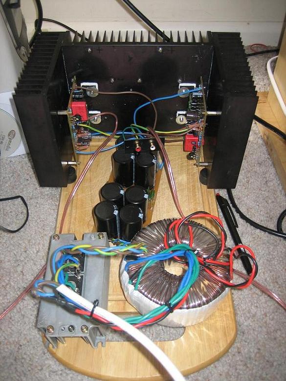

If the others are all ugly mine is attractive.
Had to have a listen to see what the fuss was about.
Got a 4.7K in place of a 47K in r13 so had no current D'oH, once I realised this (it was all cold and clipped / distorted easy) I cut r13 out and the magic began to happen. due to the size of the heatsinks and components I had on hand I have 0.47r in place of the 0.33r, running full throttle (no r13) I ended up with 1.5 amp bias. after 45 mins the heatsink was 62deg C 49 over ambient so need to bring this down for extended pleasure. I only wanted a listen before I go any further.
Dc was around 105mv per side
The transformer is one of the antek 115 - 115 -- 20 - 20 but running 240 over the primary with the pair of fish as loads gives me +-28.6v. talk about getting close to the edge.

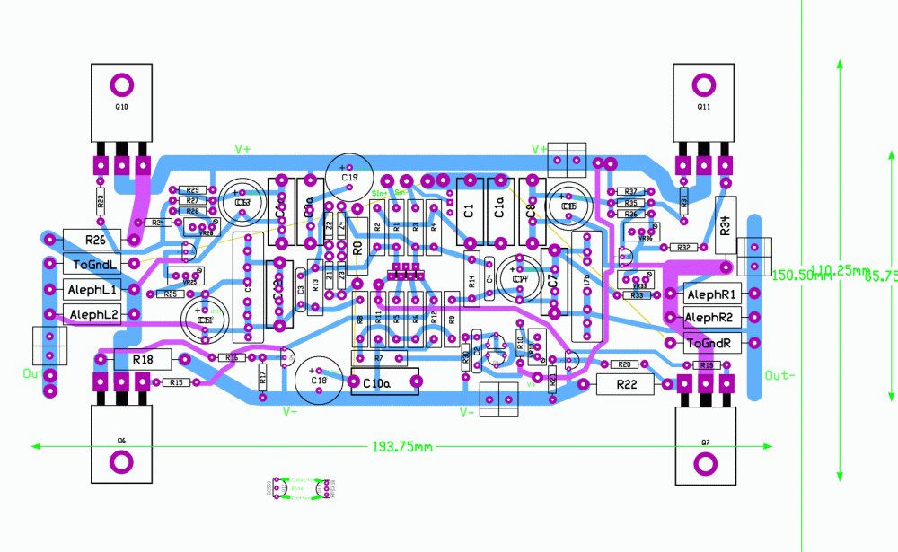

Who will be kind enough to send me the board files for a dual output fet version?

Had to give you guys a picture as it brings a new meaning to "breadboard" build.

Re: If the others are all ugly mine is attractive.
If you want this layout: http://www.diyaudio.com/forums/showthread.php?s=&threadid=100258
you can send me an email. I also have a single layered version which twitchie showed a few posts ago.
almost as from some Marvell book.......reminds me on funny character in Silver bath - suit 😉
Request for editorial assistance
Hello Folks,
Do you think you could have a look at this PCB plan. I have checked for terrible wiring errors, however an extra pair of eyes is always helpful. I am also for advice if I really should re-route anything of any major importance. It is designed to fit on my 150mm wide * 350mm long heatsinks.It has lots of options incorporated: different capacitor sizes, and the R0 and input protection zeners from the Aleph-X. It is sort of an "experimental or developmental" board so I can play with components and the circuits.
1. I plan to use a Ground Plane or a "starry" tree of Ground connections on top copper side.
2. Numbering is based on the numbered version of Zenmod's circuit diagram ... see next post.
3. It will be made with toner transfer process (home grown version) so there are a couple of vias which are just to join top and bottom planes. I haven't double checked that I have put in all the ones I need, yet. Don't worry about that ... I can do it.
4. Some of the resistors (the "important ones") have the leads under the component in case I ever want to put in (Texas Components') Vishay bulk foil resistors. They sell individual components to people like you and me.
5. Also could I have some advice on this: R25 and R33 have little trimpots. It seems that these resistors are the ones to adjust (on the Zen diagrams, anyway) so as to adjust the AC/Aleph gain. Is this a somewhat independent of the adjustment of the overall gain using R28/VR28 and R36/VR36. I can see that what the resistors do is totally independent if, for instance the Aleph feedback loop is removed, or if the R28 and R36 resistors are removed. Essentially, should I just get rid of the VR25 and VR33 trimpots and save space and components???
6. I apologize that pad names do not show up. I have tried for years to get this to show up when printing, but no luck 🙁
Anyway, if you could give me some feedback, I would be happy.
Regards and thanks,
George.
P.S. I have done lots of variations of "normal" aleph type boards, and they very nearly all turn out to look the same ... they are never as pretty as other people's look. I have even started with other people's vastly different designs, and by the time I have put in my own requirements (LTP components together; on board or off board power mosfets; short signal paths, especially at the input ... they all end up looking like all the others I have done. Sigh.
