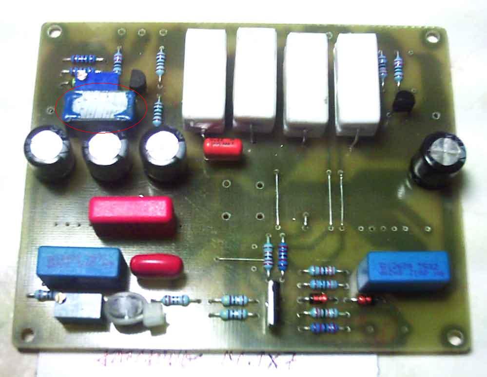

exact ,or preferred, Ugs at needed Ids , what else -same as for mosfets when you choose them for exact role ;
Thank you - this is what was a mystery for me - I thought they were way different beasts.
hehe- gimme more direct question - what you wanna achieve and where - to find sub for 2SJ109BL or what?
Well, yeah, I'm probably gonna have to sub it BUT my question was really general on purpose. I'm just trying to get a feel for them so I can get smarter than you:D

for gate stopers use whatever you have from 150 to 330ohms ;
47E resistors ........... "don't touch my circles" !!
4V7 zeners - you can omit them if you are always sober when you pull or put cables in da amp
use 0R33 source and speek resistors and use those dreky big mosfets
in fact- what voltage and current you want to have here?
edit- you can use mpsa instead of BC........use whatever little critter you have in drawer ........withsame polarity ,off course,and be careful with pinout

Yes, All of the above I assumed correct- I was :clown:-ing you.
Voltage ~ +-16 to +-18v, current less than stock. I'm building a mini version for big long heavy tweeters:)
So, I guess I wanna keep it at maybe 1/2 to 3/4 amp - just enuff to roast some smaller fets...
What type of cap is this? ...and how good is it?
I just farmed a bunch off of a board...
Thanks!
