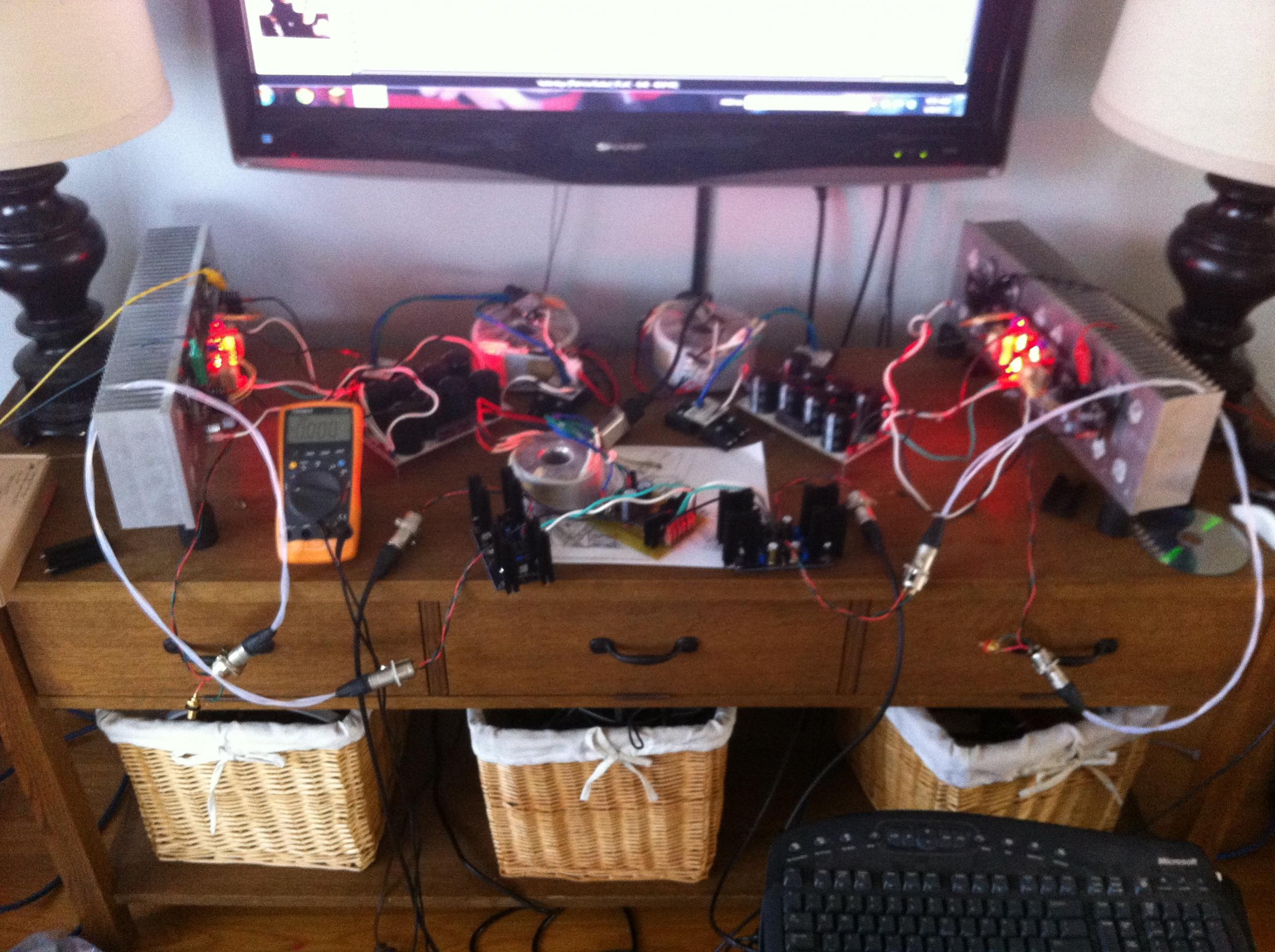

Will not get to that this weekend. Gotta start etching shinty clone. Dual mono for this and later versions. Too much gain, so will either get rid of it on FE or feedback. Bass is punchy and this with wimpy dual 6" woofers.

The BA-3 without P3 correction seems to have much k2, so big bass is present......!
Balanced killed some of it, but you can tell some remains. In truth the final version will probably be trimmed for lowest distortion, or st the least, similar 2k and 3k. Don't have time to fiddle for a while. Just wanted to get it playing. Right now have 100R between sides. I will bump that to 150-200. Little more degeneration of FE. The final version will probably have ZVP/ZVN4424 in the output. Look at the curves. What big transistor does it remind you of?

?..........The final version will probably have ZVP/ZVN4424 in the output. Look at the curves. What big transistor does it remind you of?
So you are going UGS way.....
But the ZVN/P cannot be driven with the same current like the Toshibas
This project will branch into power amp FE and preamp. Preamp might be standard SUSY or other options, like no feedback folded cascode. Haven't decided really. My thinking is that I want the preamp as low noise and distortion free as possible without clamping the sound. Thinking I want the power amp to provide the color.
The Toshibas can take a lot more heat with these sinks. It will be interesting to watch THD spectra varying VAS bias up and down. BA3 seems to be pushing character of amp onto VAS. Intentional or even true, dunno yet.
